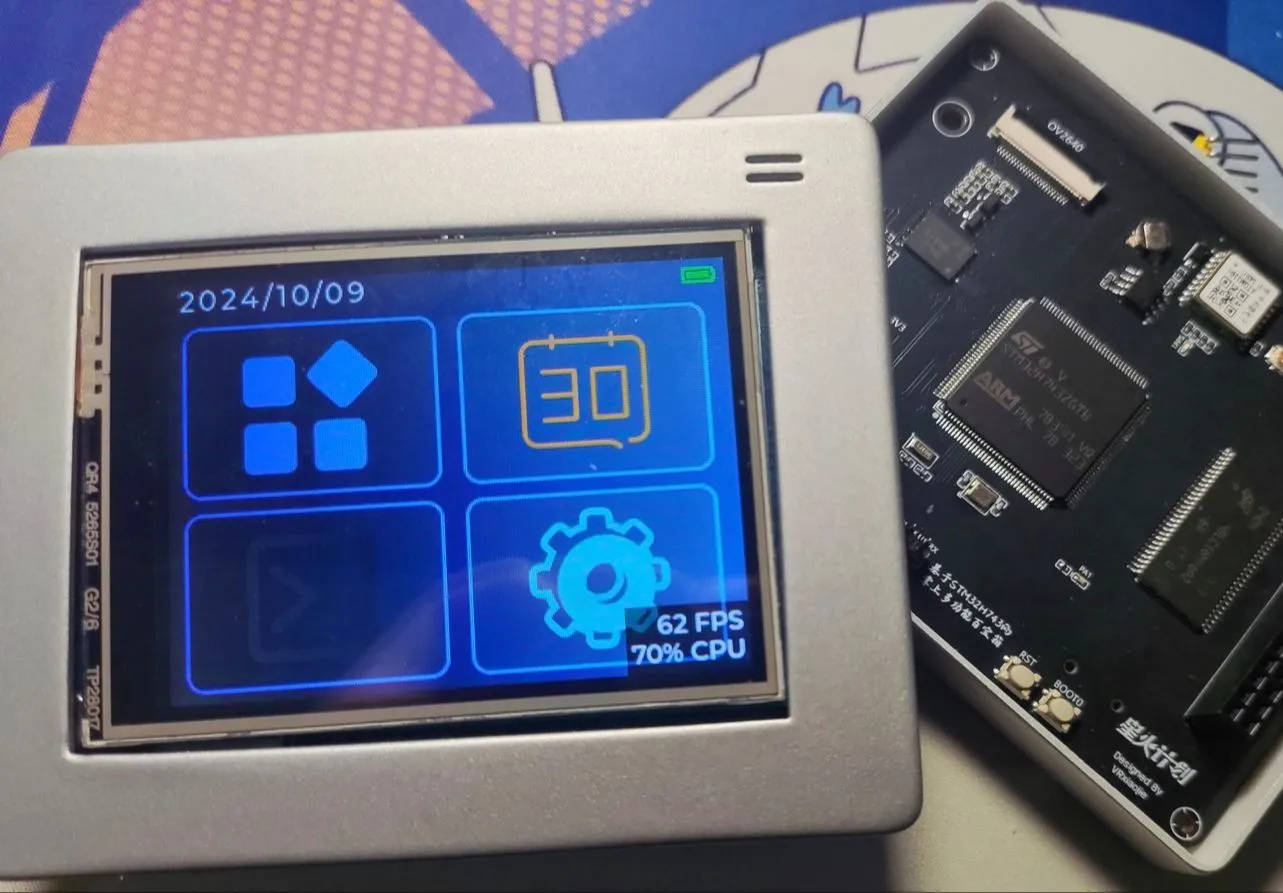

A handheld multi-functional toolbox based on STM32H743
1. Project Title:
A Handheld Multifunctional Toolbox Based on STM32H743
2. Project Introduction:
I recently attended an STM32 offline seminar and experienced the charm of STM32 in AI applications and GUI acceleration. The STM32H743 is a new high-performance MCU in the STM32 series. Currently, there are very few projects about the H7 series on open-source platforms, and most are development boards. To fully utilize the performance of the H743, this project plans to develop a human-computer interaction interface based on LVGL. The accompanying 2.8-inch touchscreen can eliminate the hassle of button operation and improve the user experience. At the same time, the H743 has many GPIO interfaces, allowing for the connection of many peripherals. This project will use the OV2640 camera, ATGM336H positioning module, SHT40 temperature and humidity sensor, BH1750 ambient light sensor, etc., to implement the corresponding functions for each sensor.
Because this project has many peripherals, is based on a touchscreen for extensive development, and is only palm-sized (slightly larger than a 2.8-inch screen), it is named "Handheld Multifunctional Toolbox." Users can continue to modify and add new functions based on the open-source software code of this project.

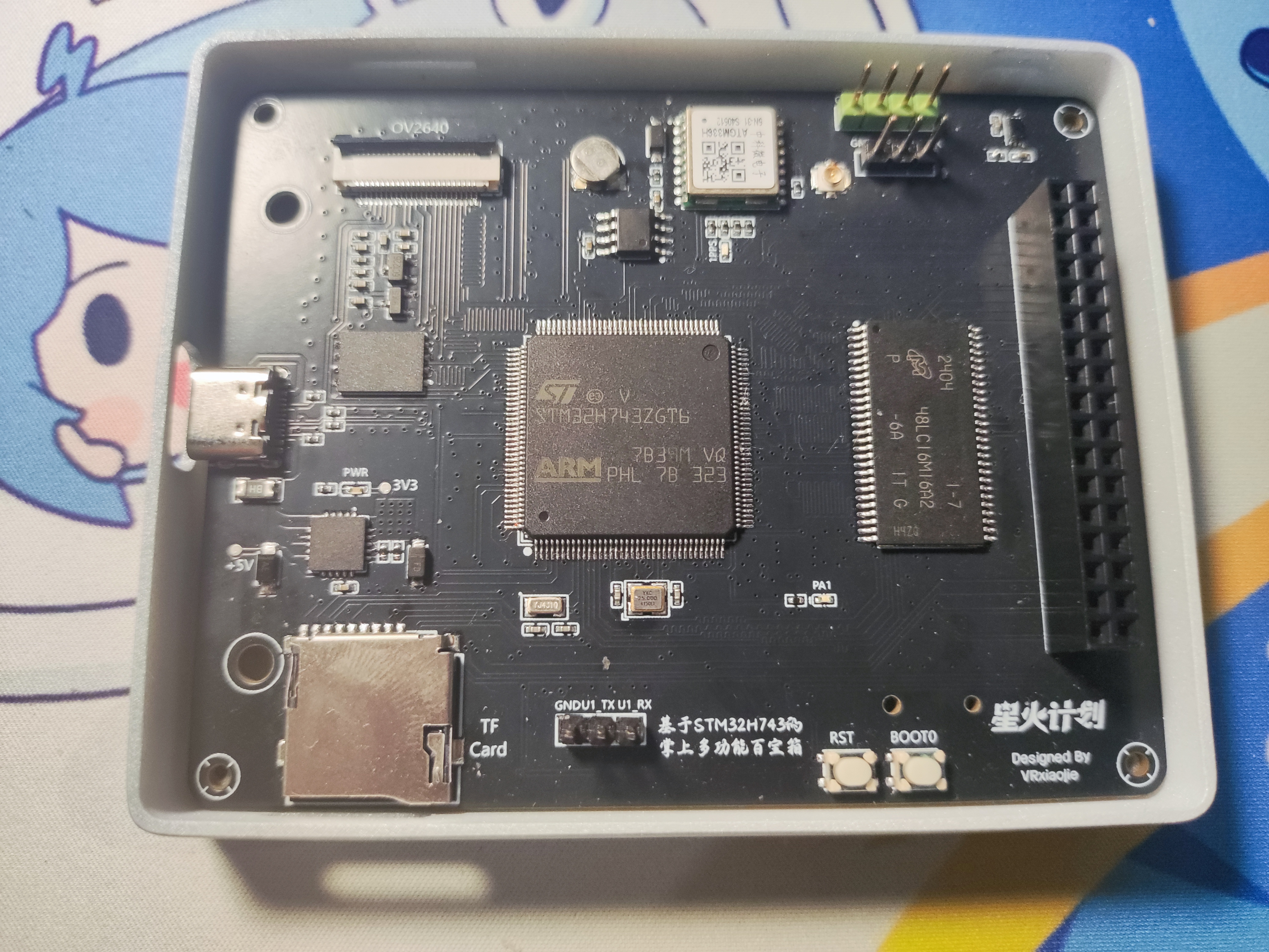

3. Hardware Module Introduction
3.1 STM32H743ZGT6 Main Control Chip The
STM32H743ZGT6 is a high-performance MCU in the STM32H7 series, using an ARM Cortex-M7 core with a main frequency of up to 480 MHz, and built-in 2MB FLASH and 1MB RAM. This gives it excellent performance when handling complex tasks, making it particularly suitable for applications requiring fast response. Its rich peripheral interfaces make peripheral connection and control more flexible.
In addition, the design supports DFU download, and programs can be downloaded directly to a computer via USB using STM32CubeProgrammer.
3.2 Expanded SDRAM
This project uses 256Mbit MT48LC16M16A SDRAM (equivalent to 32MB), which is mainly used to store large temporary data and dynamic arrays during runtime. Due to the limited internal RAM capacity of the STM32H743, the addition of external SDRAM significantly expands the system's available memory. When displaying high-resolution graphical interfaces or processing camera images, SDRAM provides ample cache space, laying the hardware foundation for future development of more complex functions.
3.3
The project includes a 256Mbit MT25QL256ABA1EW9-0SIT QSPI FLASH for storing system files and user data. The QSPI interface offers fast read and write speeds, meeting the demands of loading large resources. A reserved MT29F2G01ABAGDWB is used as a backup FLASH for future expansion.
3.4 The external EEPROM
JSM24C02 is a 2Kbit EEPROM used as the storage unit for setting parameters in this project. It primarily stores user preferences, system configurations, and important operating parameters. Compared to FLASH, EEPROM has a longer read/write lifespan and supports multiple write operations for small amounts of data, making it ideal for scenarios with frequent updates but small data volumes. In the event of a power outage, the EEPROM ensures the persistent storage of configuration data, thus preventing data loss due to power failure or restart.
3.5 ATGM336H Positioning Module
The ATGM336H is a high-precision GPS positioning module that can quickly acquire the current location and provide accurate geographic coordinates. In this project, the positioning module is mainly used to implement path tracking, motion trajectory recording, and other functions. Combined with the touchscreen interface, users can view real-time location information. The ATGM336H supports GPS and BeiDou satellite positioning and can obtain stable positioning signals even in complex environments.
3.6 OV2640 Camera Module The
OV2640 is an image sensor with 2 megapixels, supporting photo and video functions at various resolutions. In this project, the OV2640 camera will be used to capture images and combined with the AI ​​library officially released by STM32 to develop artificial intelligence applications such as gesture recognition.

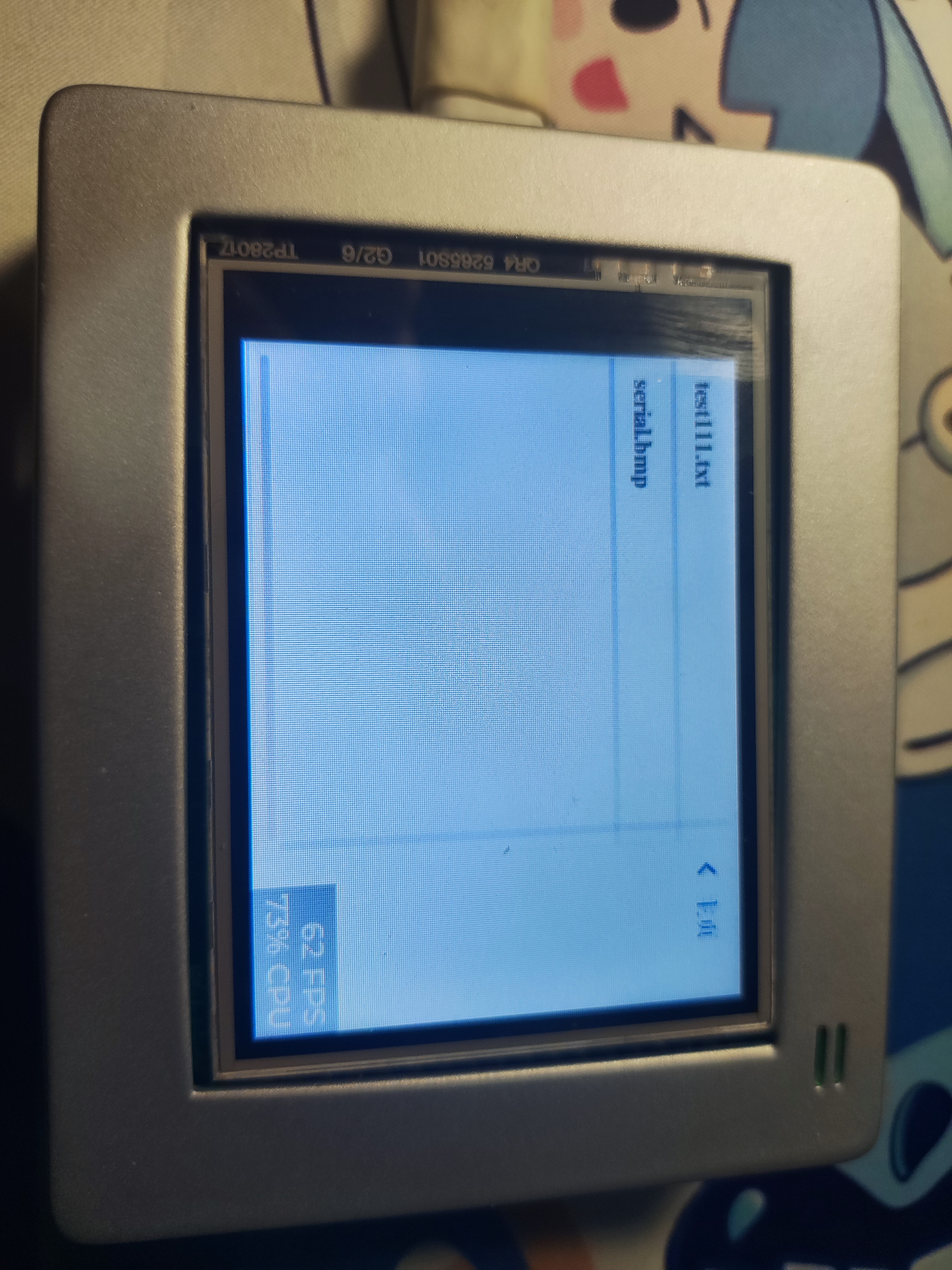

10.9
LVGL File Browser Beta Development Completed
10.10

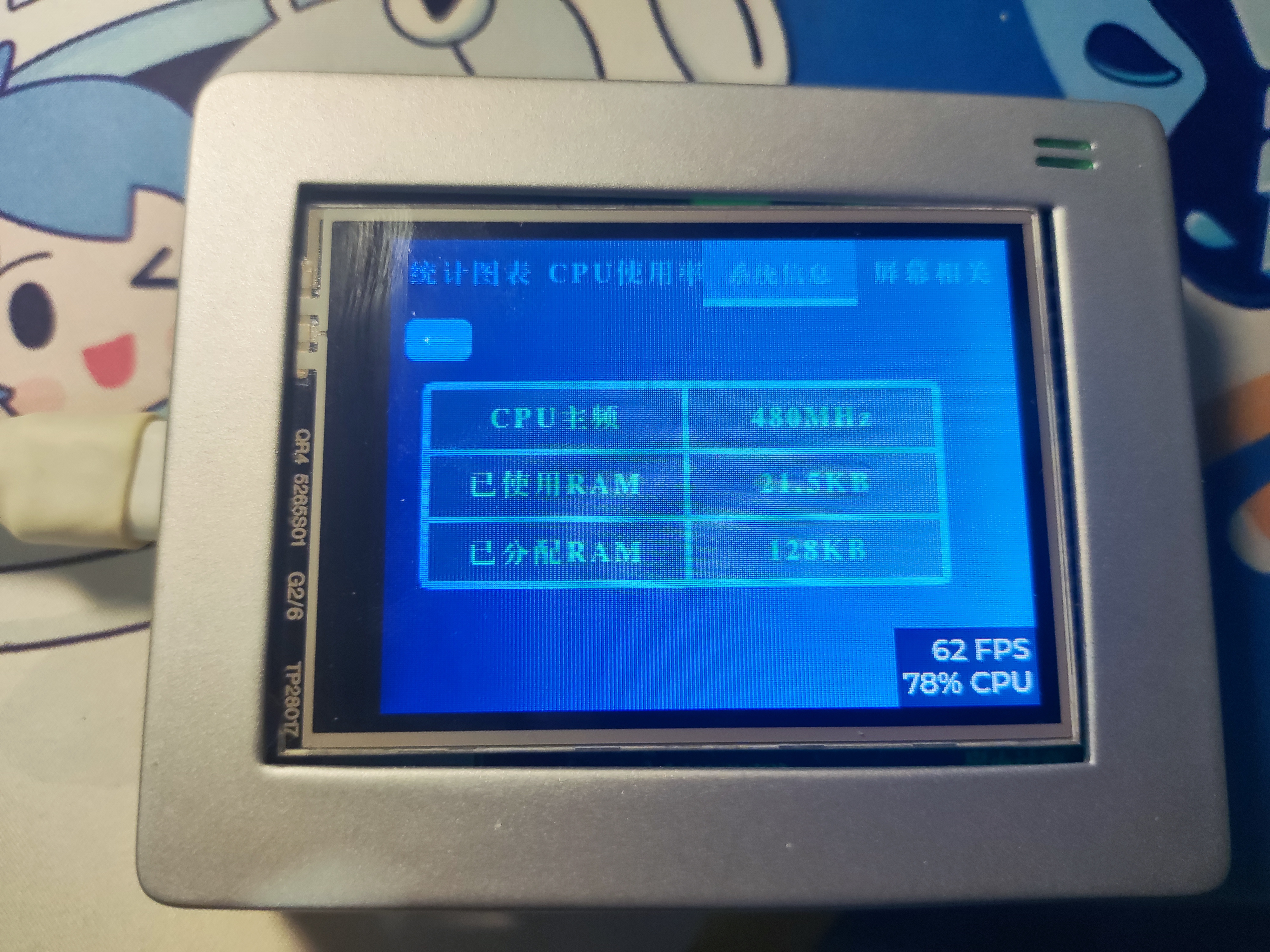

5.1 LVGL Performance Report
Thanks to the H7 series' built-in cache and large RAM, the size of the buffer array and the ability to enable buffering can be increased without restraint. Below is the LVGL performance test table:
| Combination | Frame Rate | CPU |
| Single Buffer 10320 + Screen Driver's Built-in Drawing Function | 43 FPS | 97% CPU |
| Single Buffer 10320 + DMA + DCache OFF | 103 FPS | 89% CPU |
| Single Buffer 10320 + DMA + DCache ON | 214 FPS | 87% CPU |
| Double Buffer 20320 + DMA + DCache ON | 440 FPS | 83% CPU |
| Double Buffer 100320 + DMA + DCache ON | 997 FPS | 57% CPU |
| Double Buffer Fullscreen BUFFER 240320 + DMA + DCache ON | 1152 FPS
Based on the performance test results, considering the 62% CPU usage, to maintain a consistent 60 FPS without sacrificing too much performance and resource consumption, a double buffer (100*320) + DMA + DCache ON was chosen

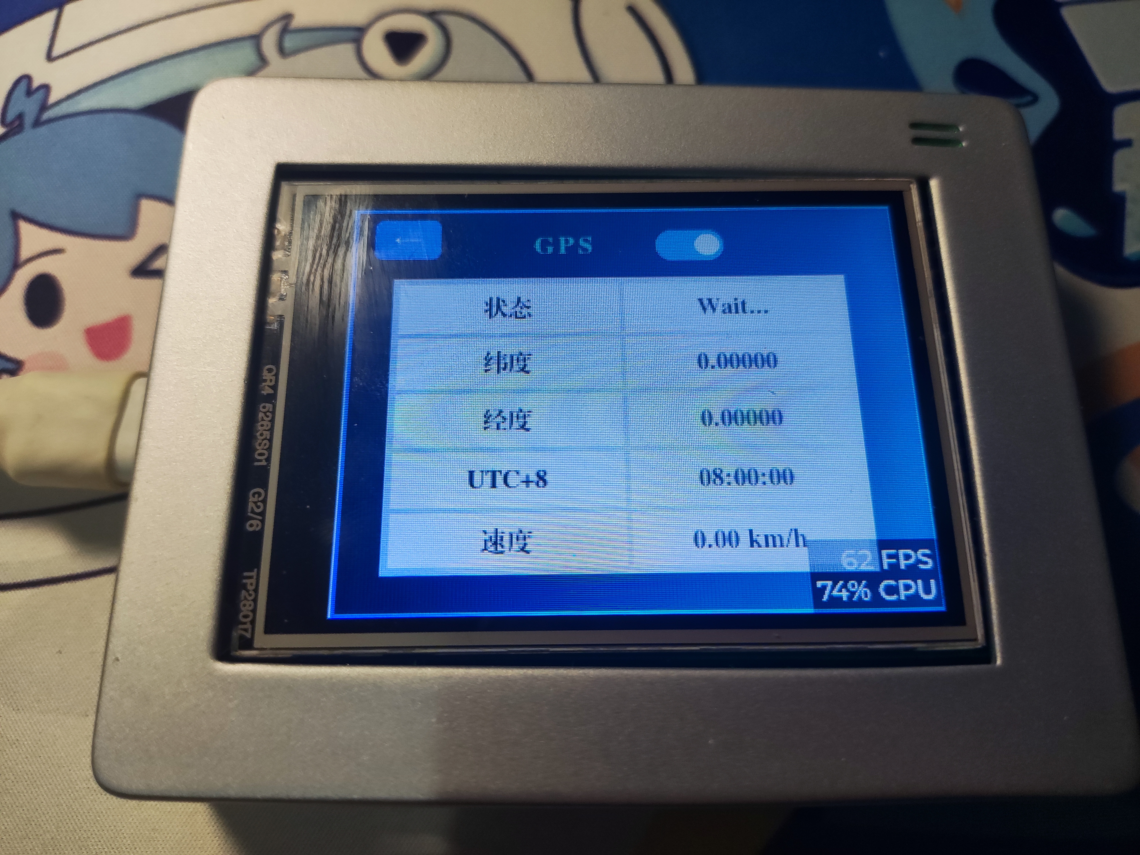

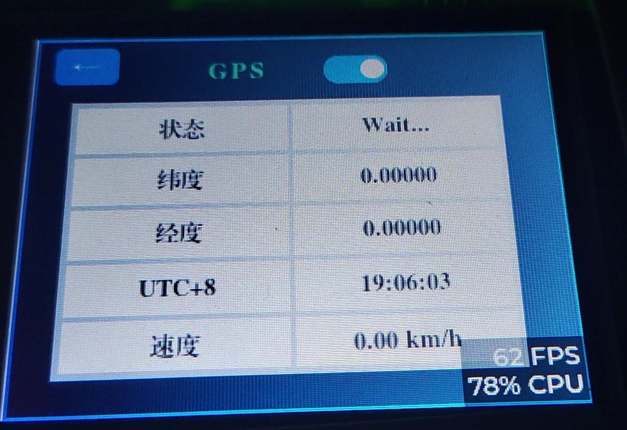

5.2` Regarding the development of the GPS module
, a dedicated interface was developed to display GPS-related information.
After receiving the message via the serial port, the GNRMC data transmitted by the GPS module is decoded:

Then display in the table
void update_gps_info(lv_timer_t * timer){
#if !LV_USE_GUIDER_SIMULATOR
HAL_UART_Receive_IT(&huart5,(uint8_t *)UART5_temp,REC_LENGTH);
char t0[20],t1[20],t2[20],t3[20],t4[20];
//Check status code
if(UART5_Rx_flg==1) {
UART5_Rx_flg = 0;
if(gps.UsefulFlag=='V')
strcpy(t0,"Wait...");
else if(gps.UsefulFlag=='A')
strcpy(t0,"OK");
lv_table_set_cell_value(guider_ui.app_screen_table_gps,0,1,t0);//status
sprintf(t1,"%.5f",gps.latitude_d);
if(gps.N_S=='N')
strcat(t1," N");
else if(gps.N_S=='S')
strcat(t1," S");
lv_table_set_cell_value(guider_ui.app_screen_table_gps,1,1,t1);//Latitude
sprintf(t2,"%.5f",gps.longitude_d);
if(gps.E_W=='E')
strcat(t2," E");
else if(gps.E_W=='W')
strcat(t2," W");
lv_table_set_cell_value(guider_ui.app_screen_table_gps,2,1,t2);//Longitude
sprintf(t3,"%02d:%02d:%02d",gps.UTCTime_int/10000,gps.UTCTime_int/100%100,gps.UTCTime_int%100);
lv_table_set_cell_value(guider_ui.app_screen_table_gps,3,1,t3);//UTC
gps.speed_d = strtod((const char*)gps.speed,NULL);
sprintf(t4,"%.2f",gps.speed_d*1.852);
strcat(t4," km/h");
lv_table_set_cell_value(guider_ui.app_screen_table_gps,4,1,t4);//speed km/h
