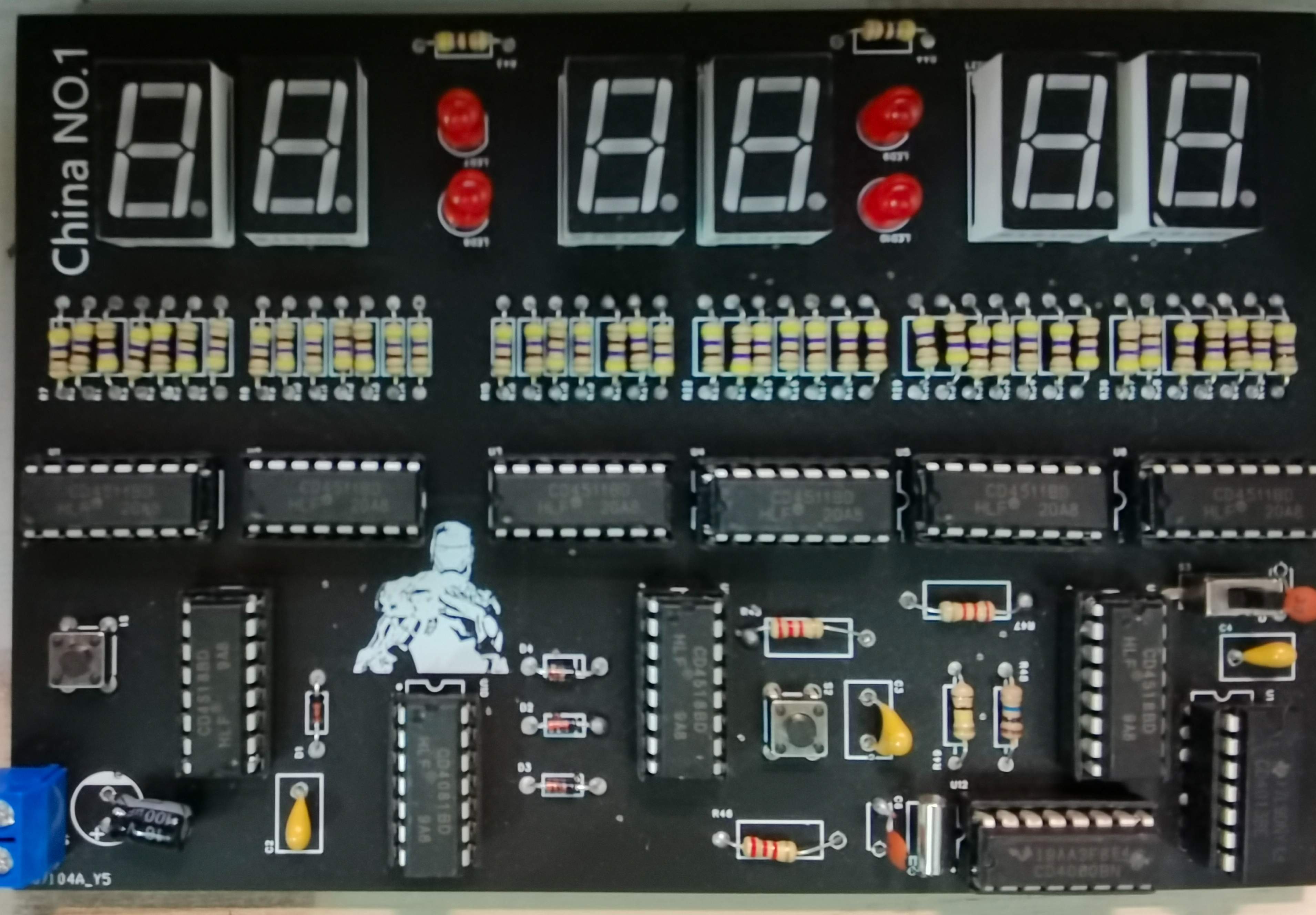

Digital clocks based on CD4511, CD4518, CD4081, CD4060, CD4013, and 36.768kHz crystal oscillators can display hours, minutes, and seconds, using a CD4060 frequency divider to generate the clock's time base. Below, I will explain the principle in detail:
1. Clock Signal Source:
A 36.768kHz crystal oscillator is used as the clock signal input source. This frequency is one of the commonly used standard frequencies for clocks, providing accurate clock pulses.
2. Clock Division:
The 36.768kHz clock signal is input to the CD4060 binary frequency divider. The CD4060 contains a 14-bit binary counter and several division output pins. By configuring the CD4060 pins, the corresponding division factor can be selected.
An appropriate division factor is selected as needed to produce the desired clock refresh rate. For example, to refresh the clock once per second, an appropriate division output pin can be selected, with a frequency of 1Hz.
3. Clock Counting:
Connect the divided clock signal to a CD4518 parallel-serial hexadecimal counter. The CD4518 converts the 4-bit binary counter value into BCD code output and can control whether it returns to zero.
Configure the CD4518 to count from 0 to 59, corresponding to 0 to 59 seconds of the clock.
4. Hour, Minute, and Second Display:
Connect the BCD code output of the CD4518 to a CD4511 BCD-7-segment LED driver. The CD4511 converts the 4-bit BCD code into the required level signal for a 7-segment LED display.
Connect the output of the CD4511 to the 7-segment LED display to display the hours, minutes, and seconds.
5. Setting Function:
Use a CD4013 D flip-flop to provide setting functionality. D flip-flops can store and transmit data.
Connect the flip-flop output to a CD4081 gate circuit, and input data into the flip-flop by pressing a button or other triggering methods. The input data can control the clock settings, such as adjusting the values ​​of hours, minutes, and seconds.
The CD4081 gate circuit is used to detect the input signal and switch between clock setting mode and counting mode according to its state.
Based on the above principle, a digital clock based on digital integrated circuits can be constructed using CD4511, CD4518, CD4081, CD4060, CD4013 and a 36.768kHz crystal oscillator. This design can provide accurate hour, minute, and second display and allow users to adjust the clock time. In the actual implementation, the design and implementation of the digital clock requires a detailed circuit connection diagram, input/output configuration, and corresponding timing and state control.
