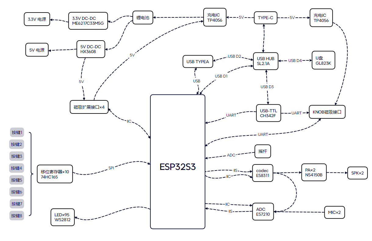

Design Principles:
1. The main controller is the ESP32S3, which integrates WIFI, Bluetooth, USB, ESP-NOW, and IIS.
2. The audio section uses the ES7210 as the ADC and the ES8311 as the DAC. The power amplifier is the NS4150B (referencing the ESP-BOX hardware design).
3. The download circuit uses the CH342F, which has two channels for USB to TTL conversion, corresponding to the keyboard and knob controllers respectively.
4. The USB hub chip is the SL2.1A, and the emulator chip for the USB flash drive is the GL823K.
5. The magnetic interface supports IIC communication. To avoid environmental influences on the IIC bus, each interface has a protection circuit that disconnects the exposed contacts from the internal bus when a valid device is not correctly identified.
6. Key detection uses a shift register method, referencing Zhihui Jun's Hanwen keyboard project.
7. The keyboard key backlight uses the WS2812, and the grille lighting on the back of the keyboard uses a horizontal LED driver IC with LED strips.

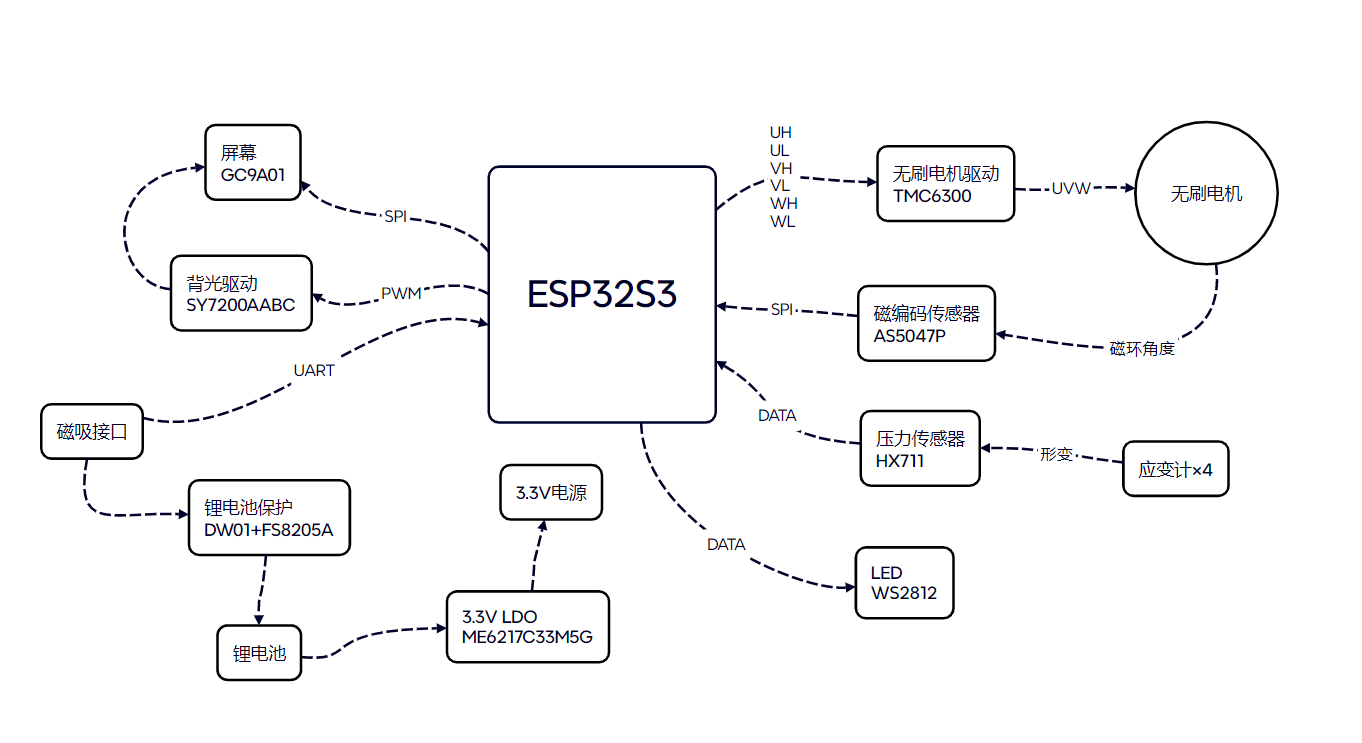

8. The knob screen driver is GC9A01.
9. The knob motor driver is TMC6300, and the magnetic encoder is AS5047P.
10. The knob pressure sensor is HX711 with a strain gauge.
The keyboard hardware block diagram is shown below:
The knob hardware block diagram is shown below:

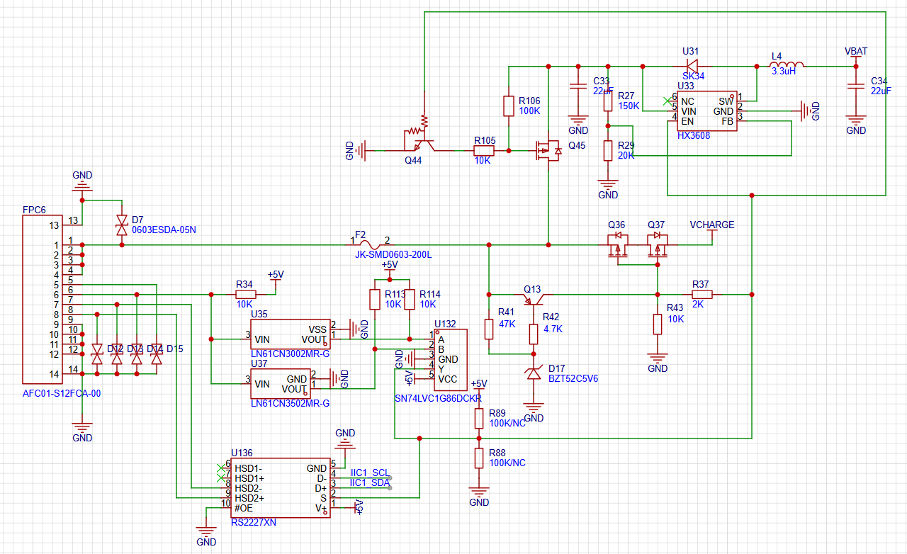

2. Keyboard Expansion Interface Circuit:
The main function of the expansion interface is to establish power and data connections with expansion modules. It supports powering expansion modules, and power-type expansion modules can also charge the keyboard. The keyboard and expansion modules can exchange data via the IIC bus. The circuit supports expansion module identification. Two voltage monitoring chips, U35 and U37, monitor the voltage on pin 6 of the FPC in real time. When a 20K resistor is connected to GND at pin 6 of the FPC on the expansion module side, the voltage at pin 6 is 20K/(20K+10K)×5V ≈3.3V. At this time, U35 is at a high level, U37 is at a low level, and pin 4 of the XOR logic chip U132 outputs a high level. At this point, the entire expansion interface circuit disables internal charging, enables external power supply, and opens the IIC connection, allowing connection of a numeric keypad expansion module, etc. When the FPC pin 6 resistor on the expansion module is left floating or connected to GND with a resistor of other sizes, in short, when the XOR logic chip U132's pin 4 outputs a high level, the entire expansion interface circuit is enabled for internal charging, disabled for external power supply, and disabled for IIC connection. At this time, the charging expansion module can be connected. The expansion interface circuit is shown in the figure below.

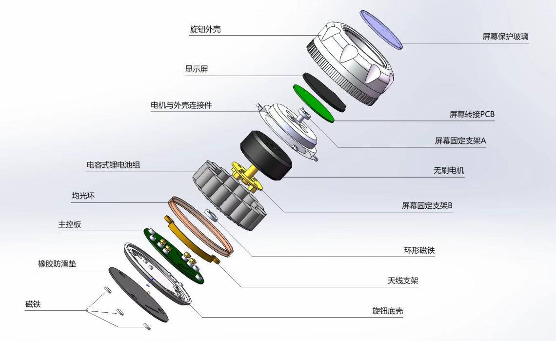

Structural Assembly Diagram:
1. Knob Part:
2. Keyboard Part: No
