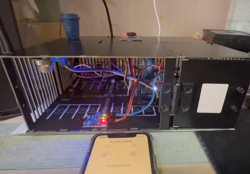

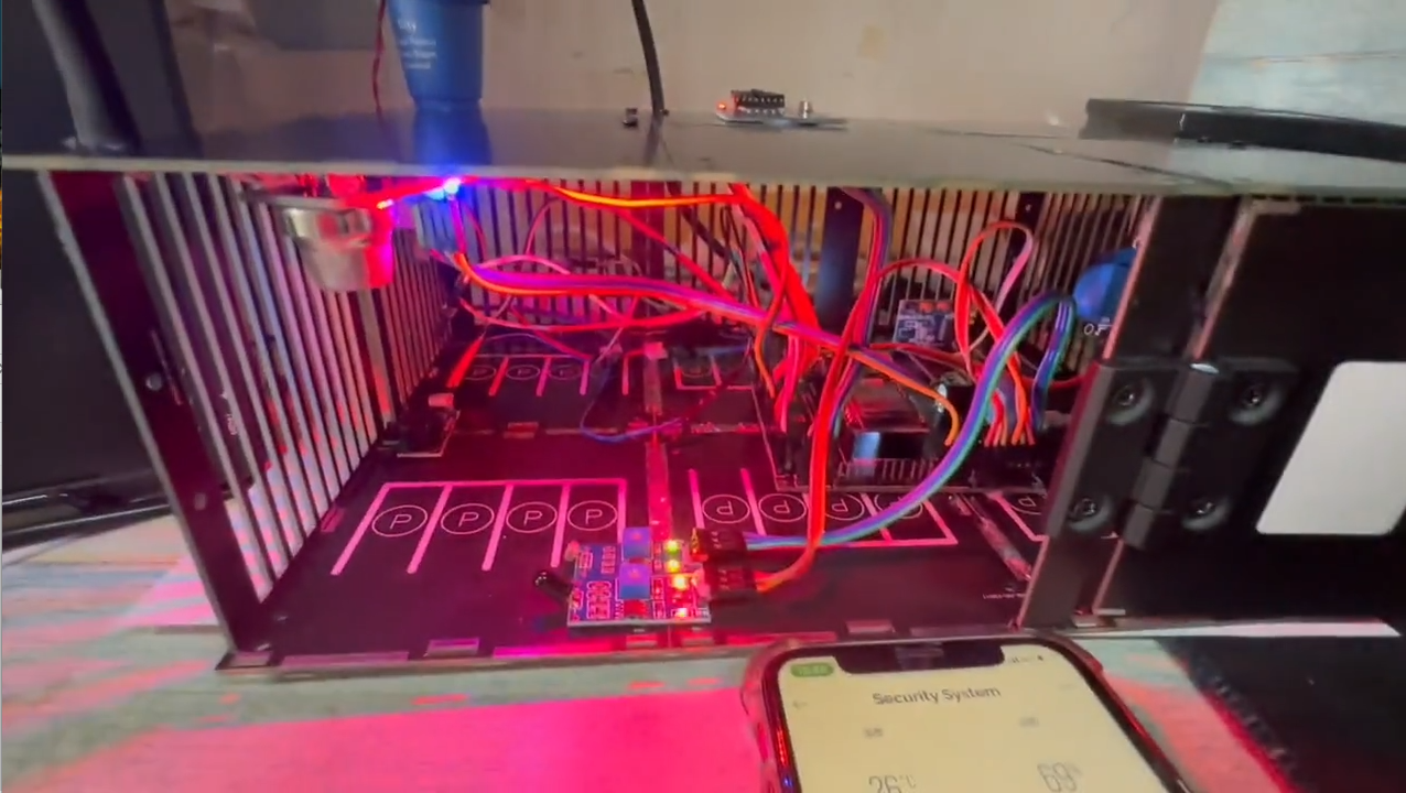

This ESP32-based bicycle electronic fence features multiple functions:
1. Anti-theft: Intrusion alarm, RFID card unlocking;
2. Fire prevention: Dispensing cooling liquid upon detecting flame (simultaneous response of flame and combustible gas sensors);
3. Remote control via APP: Real-time temperature and humidity display, and control of access control;
4. Automatic light activation upon detecting light or human proximity;
5. Fan ventilation: Automatically activates ventilation mode when temperature and humidity are too high.

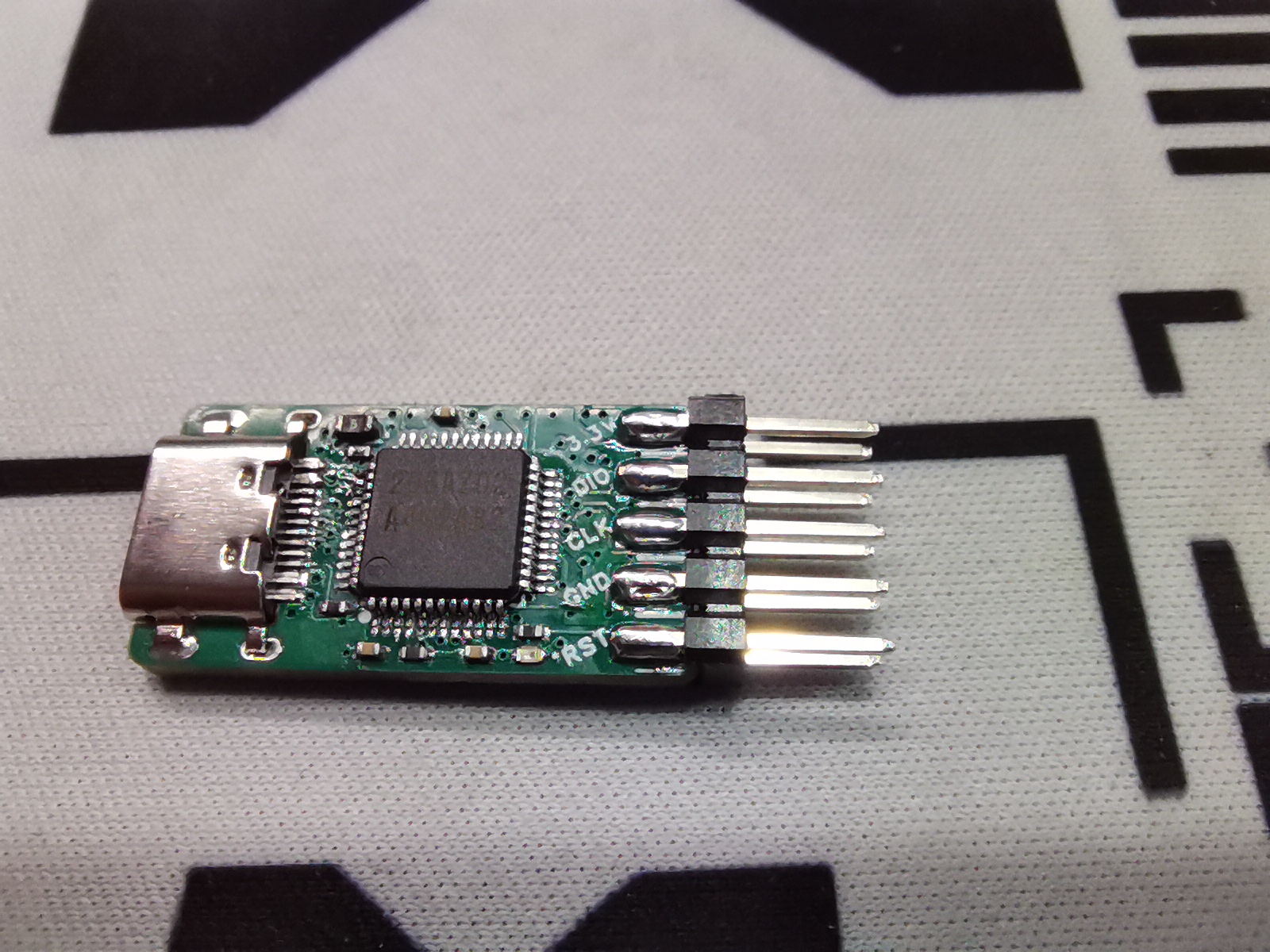

J-Link-OB-RA4M2 (Jlink OB)
J-Link-OB-RA4M2
Attention!!!
Select the 7628 stack.
Since the RST pin of the chip is not exposed, it is best to modify the SN and LICENSE before flashing the firmware. Otherwise, you will need to expose the RST pin or erase the chip before re-flashing the firmware.
Project
dimensions: 25mm * 13mm.
To maintain consistency with the J-Link Base V9 interface, TDI has been removed, therefore JTAG download is not possible.
Please refer to this project for firmware:
https://oshwhub.com/lsanor/j-link-ob-ra4m2_v1-1_24-06-04
Note:
Special note: H7 in the BOM does not need to be purchased.
The component is difficult to solder; please check carefully.
Downloading requires 1.27mm pitch probes, which are provided in the J-Link Base V9 project.

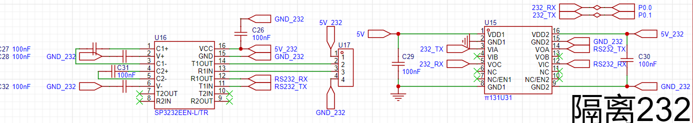

RS485 Isolation: Prevents damage to the main control circuit due to incorrect RS485 interface connection
. RS232 Isolation: Prevents damage to the main control circuit due to incorrect RS232 interface connection.

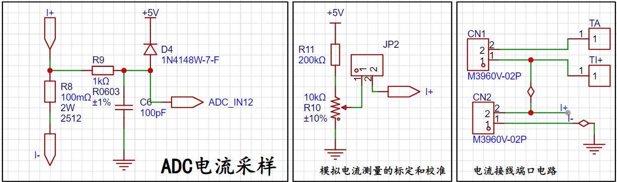

4. Current Sampling Circuit
This project uses a low-side current sampling circuit for current detection. When learning the common ground between the low-side of the sampling circuit and the development board's meter interface, please do not solder R0!!!
The design analysis
for this project involves a sampling current of 3A, and the selected sampling resistor (R0) is 100mΩ. The selection of the sampling resistor mainly needs to consider the following aspects:
the maximum value of the pre-designed measurement current;
the voltage difference caused by the 3A current sensing resistor in this project; and
the power dissipation of the current sensing resistor, which should generally not exceed 0.5V. A suitable package should be selected based on this parameter. Considering the power dissipation (temperature) issue under high current, a 1W metal wire-wound resistor package was chosen
. The voltage amplification factor across the current sensing resistor is also important. Since no operational amplifier is used to build the amplification circuit in this project, the factor is 1.
The current sensing resistor value can then be calculated using the above parameters
. Since no amplifier circuit is used, a larger sampling resistor is needed to obtain a higher measured voltage for measurement.
However, considering that a larger resistor would result in a larger voltage drop and higher power consumption, an unlimited selection of a larger resistor is not feasible .
This project uses a 1W package resistor, corresponding to a power consumption of 1W.
Based on the above data, a 100mΩ current-sensing resistor was chosen. According to the formula, 3A * 100mΩ = 300mV, 900mW.
To handle different operating environments, especially high-current scenarios, the R0 resistor can be replaced with constantan wire or a shunt. The appropriate alternative can be chosen based on the specific application scenario. For safety and educational purposes, this project will not discuss measurements exceeding 3A, but the principle remains the same.

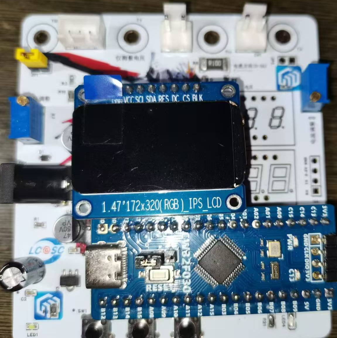

Procurement Link: 1.47-inch LCD display, high-definition IPS 172x320, ST7789 driver LCD screen, high-definition LCD display
data download link: https://pan.baidu.com/s/15OWpndYzyW8kFPqmfKNfxQ
Data extraction code: 8888
2. Specifications
Operating Voltage: 3.3V
Operating Current: 90MA
Module Size: 30(H) x 37(V) MM
Pixel Size: 172(H) x 320(V) RGB
Driver Chip: ST7789V3
Communication Protocol: SPI
Number of Pins: 8 Pins (2.54mm pitch header)
The above information can be found in the manufacturer's data file
. File path

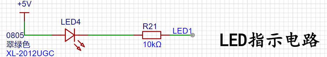

This project additionally designed a power indicator and an IO working indicator.
LED1 is the power working indicator .
Since the chip I/O often has a sinking current capability greater than a pulling current capability, LED1 is designed to be I/O low level active (on).
To reduce the current consumption of the LED, some LED brightness was sacrificed, and the number of device parameters was reduced. The current-limiting resistor for the LED was chosen to be 10K.

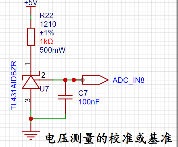

8. TL431 Circuit Design for Voltage Measurement and Calibration:
This project adds an extra TL431 circuit to provide a 2.5V reference voltage. This can be used to provide an external voltage reference for the chip to calibrate the AD converter. From a product design perspective, due to the inherent ADC performance advantages of the CW32, this circuit is not necessary. This circuit is designed on the development board for learning the relevant application principles.
The TL431 is a relatively "old" device, very classic, and widely used; it is still found in many electronic products today.
Many beginners may be encountering this device for the first time. We will briefly explain the principles of this product to help everyone better apply the TL431.
TI defines it by its name as a precision programmable reference. On the first page of the references, we can focus on several key characteristics.
**Precision:** Precision indicates its highly accurate output voltage. The TL431 I used has ±0.5% accuracy, and at room temperature, it measured 2.495V on the board. This is a world of difference in accuracy compared to common Zener diodes. In application circuit diagrams, the TL431 is internally represented by a Zener diode symbol. **
Adjustable Output Voltage:** The adjustable output voltage is between Vref and 36V. In our project, we use the output Vref voltage, which is approximately 2.5V. Therefore, we use 2.5V in the description, which is approximately equal to Vref. **
Sinking Current Capability:** This refers to how much current the output voltage pin can provide. This is greatly influenced by the resistance value (R13) in the application circuit. It should not be less than 1mA. If there is no need for sinking current, do not design the current too high, as this will cause unnecessary power consumption.

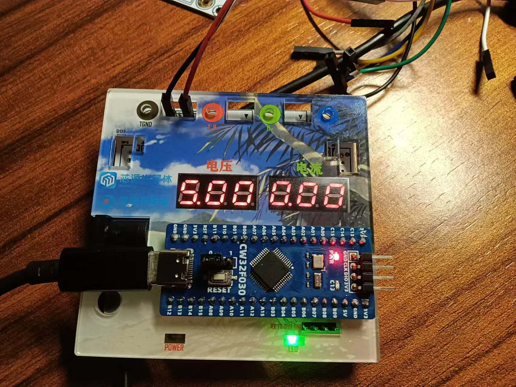

IV. Physical Images
1. PCB Image
2. Physical Image
V. Some Notes
Due to oversights in the initial PCB design, the distance between the LCD screen and the digital tube is too close, making it impossible to simultaneously accommodate both. Therefore, in this project, only one display device can be selected.
Regarding the image extraction tutorial, relevant information is provided in the porting documentation.
