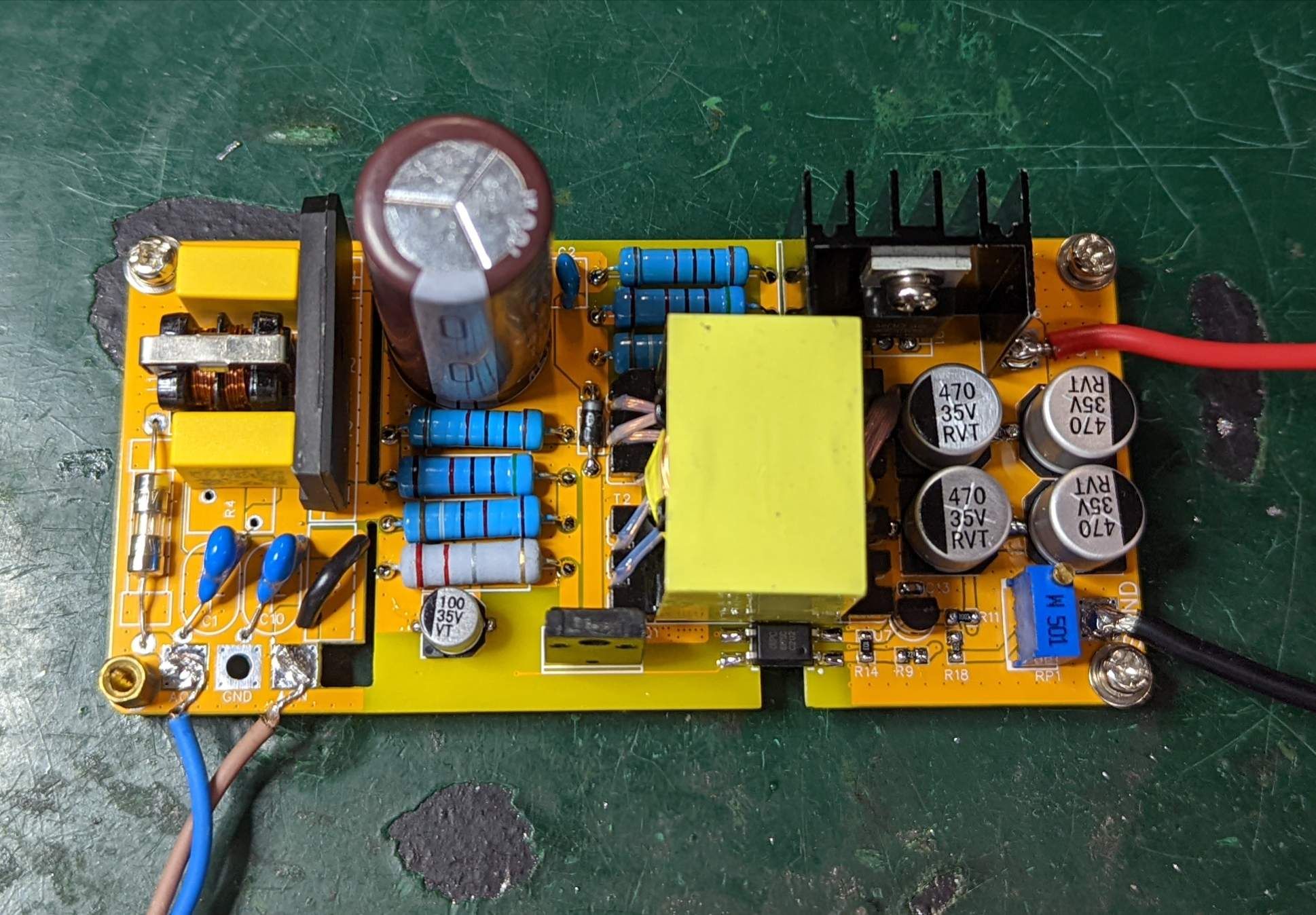

UC3842 flyback switching power supply design
Additional information: This project has an advanced version: Switching Power Supply Experiment - LCSC Open Source Hardware Platform (oshwhub.com)
UC3842 Switching Power Supply
Design Parameters:
VIN = 220V Frequency = 50Hz Vacmin = 85V Vacmax = 265V
Vout = 12V Iout = 5A Pout = 60W
Operating Frequency fs = 100KHz
Efficiency = 80% Pin = 75W Some random thoughts

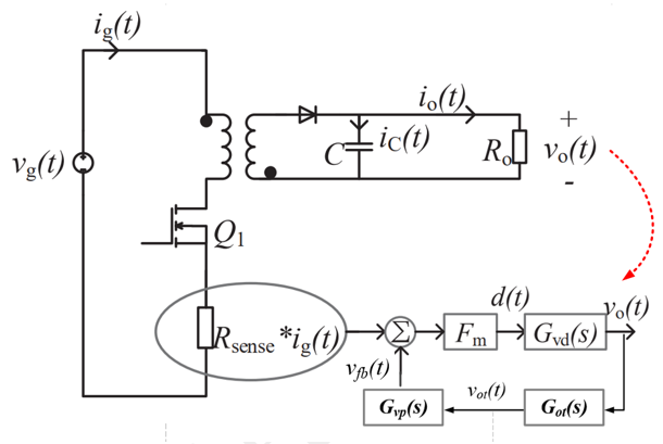

following diagram is a block diagram of the peak current control transfer function of the UC3842. To understand how to design the peripheral circuits and optocoupler feedback circuits of the UC3842, it is essential to understand the relationships between these functions. The specific principles will not be discussed further here.
The transfer function for peak current control of the flyback circuit is

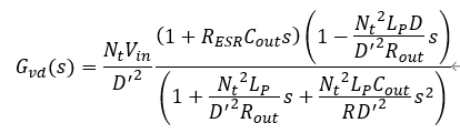

Gvd(s), which is the transfer function from a specific duty cycle d(t) to the output of the flyback circuit
, where Nt = 1/Nps, Cout is the output capacitor, Resr is the esr resistance of the output capacitor, Lp is the magnetizing inductance of the transformer, D is the turn-on duty cycle, D' is the turn-off duty cycle, and Rout is the output load.
The output voltage, after passing through the sampling feedback circuit Got(s) constructed with optocouplers and TL431, generates a feedback voltage Vot(t) that has a specific relationship with the output voltage. This signal is fed into the designed voltage loop transfer function Gvp(s), which, after voltage loop operations, generates a current loop reference current signal. The primary-side current sampling resistor Rsense converts the current into a voltage signal, which, along with the current loop reference current Vfb(t), generates the control duty cycle d(t). The duty cycle d(t) acts on the flyback transfer function Gvd(s) to output the specific voltage Vot(t).
From Gvd(s), the transfer function from Vfb(t) to Vo(t) can be derived as:
where Ak = 1/3, and other values ​​are given below:
For the peak current transfer function, wz is the zero generated by capacitor Cout, wrz is the right half-plane zero under peak current control, and wp is the output filter pole.
Next, according to the UC3842's internal peak current protection point of 1V, the maximum output current we need is 5A, so Rsense is equal to 1/5 = 0.2R.

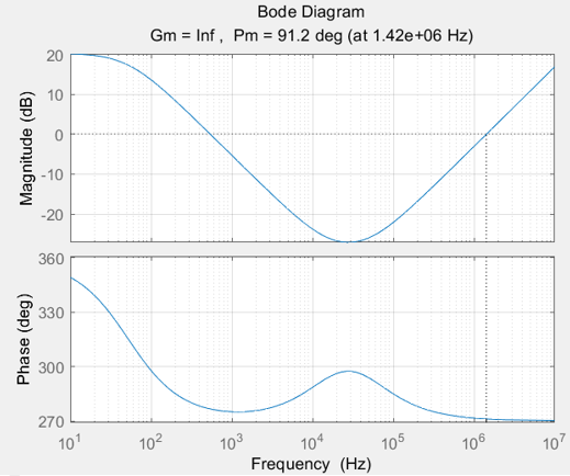

Using MATLAB, we can obtain the Bode plot of the power supply before compensation:
From the image, we can see that there are two crossover frequencies, one at 500Hz and the other at 1.4MHz, but its gain curve curves upwards in the high-frequency range, indicating an unstable system.

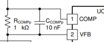

The compensator
first performs voltage loop compensation.
A compensation pole is needed at the frequency of the right half-plane zero or ESR zero (whichever is lower). Calculate fesrz using wz (the capacitor's ESR zero), and then set the resistor to 1KR to obtain a capacitor of approximately 10nF.
Based on these parameters, the voltage loop transfer function from input to output can be obtained as follows:

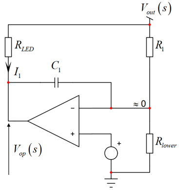

Then, the transfer function of the optocoupler and TL431 is calculated.
First, assuming the primary current of the optocoupler is I1(s) and the output voltage of the TL431 is Vop(s),
the relationship between Vop(s) and the output voltage Vout(s) calculated according to the op-amp working principle is:
Substituting into the above formula and simplifying, we get I1(s):
Then, based on the CTR parameters of the selected optocoupler, i.e., the primary-secondary current ratio, which can be found in the manual, the voltage Got(s) across the secondary pull-down resistor Rplludown can be calculated as follows:
Substituting I1(s) into this formula and simplifying, we can obtain the transfer function from Vout(s) to voltage Got(s) as follows:
In this formula, the unknown parameters are Rplludown, Rled, R1, and C1.

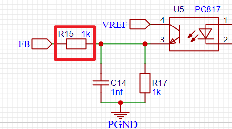

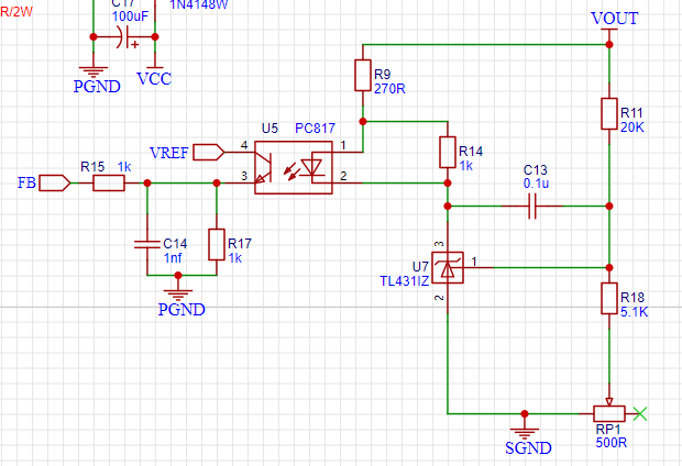

In this diagram, the parameters that need to be set include R11, R18, RP1, R9, R14, and C3.
When the output voltage is 12V and the reference voltage Vref of the TL431's R port is 2.5V, let's assume R11 = 20KR. Using a resistor divider, we can calculate R18 = 5.253KR. Therefore, we choose 5.1KR for R18 and 500R for RP1. R14 is the minimum operating current setting resistor for the TL431. Here, we set the minimum operating current of the TL431 to 1mA, while the voltage across the primary diode of the optocoupler is 1.2V. For ease of selection, we calculate the operating current of the TL431 as 1.2mA, so R1 = 1.2/1.2m = 1KR. To obtain a better phase margin, let's assume the pull-down resistor R17 of the optocoupler transistor is 10KR and the feedback capacitor C13 is 100nF.

obtain the equations of Got(s) (remember to substitute the known data) and Gvd(s), which allows us to calculate R9 = 287R.

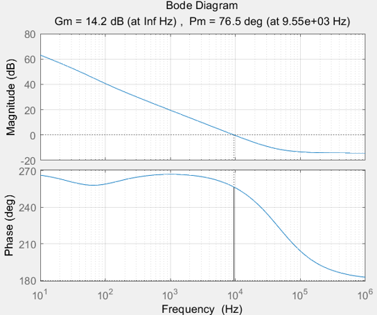

The Bode plot is calculated using MATLAB, as follows:

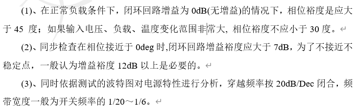

As shown in the figure above, the crossover frequency in the compensated closed-loop transfer function is 9.55kHz, very close to the designed 10kHz. The overall phase margin is 76.5 degrees, the gain margin is 14.2dB, and the gain at 100Hz is 40dB. The system exhibits good stability characteristics and also effectively suppresses the 100Hz bus ripple voltage. It should be noted that this design uses an iterative method. If the phase margin of the obtained flyback closed-loop transfer function is not greater than 45 degrees and the gain margin is less than 7dB, it indicates that the aforementioned parameter assumptions are inappropriate. The initial parameters related to the voltage loop, such as R14 and C13, need to be adjusted until the phase margin and gain margin of the generated closed-loop transfer function meet the requirements.
Typically, the criteria for the closed-loop stability of a switching power supply are as follows:

AC-DC converter with an oscilloscope, it's important to note that the oscilloscope's GND pin is connected to one of the two mains power lines. Therefore, it cannot be directly connected to the UC3842's GND pin, as this will cause a trip. The solution is to add an isolation transformer.

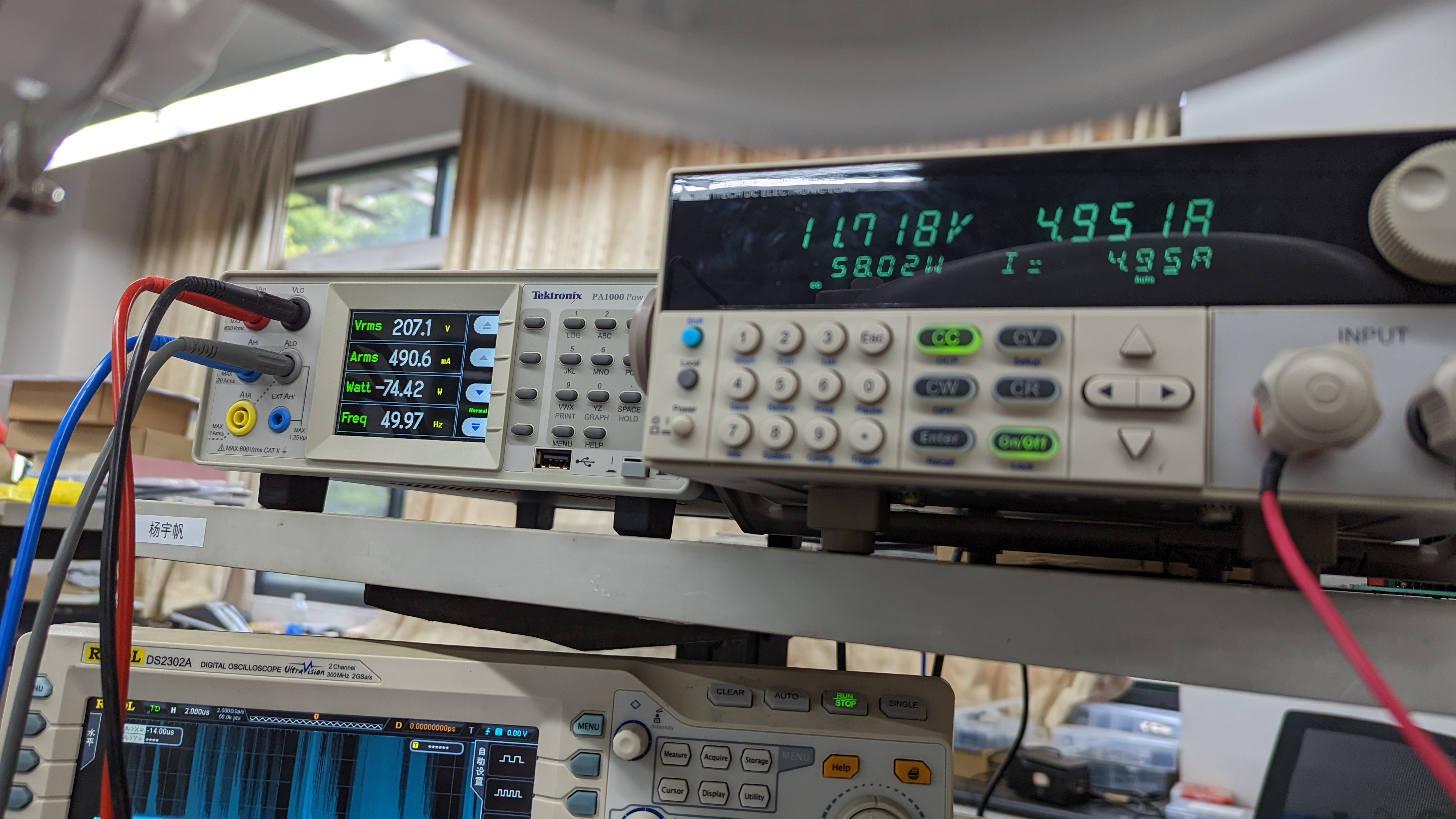

Efficiency testing (which also shows voltage regulation) revealed that
the output voltage wasn't very stable. My MOSFETs didn't have heatsinks, which may have caused excessive temperature drift. However, the efficiency was around 80% in calculations and also around 80% in the actual circuit, indicating relatively stable performance.
Ripple testing showed the dynamic drive output
during startup – source-drain voltage (these tests will be supplemented later). Some design flaws (some cited and commented on): The safety clearance on the PCB is insufficient. It's fine for casual testing with an isolation transformer, but connecting it to mains power is not compliant with regulations. Why is it drawn so compactly? Because if the board were larger, LCSC would charge a prototyping fee. The ACN and mounting screw holes are too close together; they should be designed with more space. Most flyback power supplies in industrial products have a withstand voltage of 650V. Generally, the withstand voltage of the MOSFET used is 90% of the voltage specified in the MOSFET datasheet. Taking a 650V MOSFET as an example, 6500.9 = 585V, and 585V > 470.017. 650V MOSFETs are relatively easy to buy, and their internal resistance is acceptable. Choosing a 900V MOSFET results in alarmingly high internal resistance. An isolation probe can be used to test the actual peak voltage of the MOSFET's drain-source (DS) to check for potential breakdown risk. Avoid copper plating in the high-voltage section and design a safety X capacitor discharge resistor (two approximately 1MΩ resistors, 1206 packages, connected in series and then in parallel across the safety X capacitor). The startup resistor doesn't need to be very large; a 0603 resistor is sufficient, as it doesn't handle large current. Please feel free to comment on any unreasonable or problematic aspects of my design. I will add them to this section for reference and supplementation . The transformer winding information is in another project; those interested can take a look.
