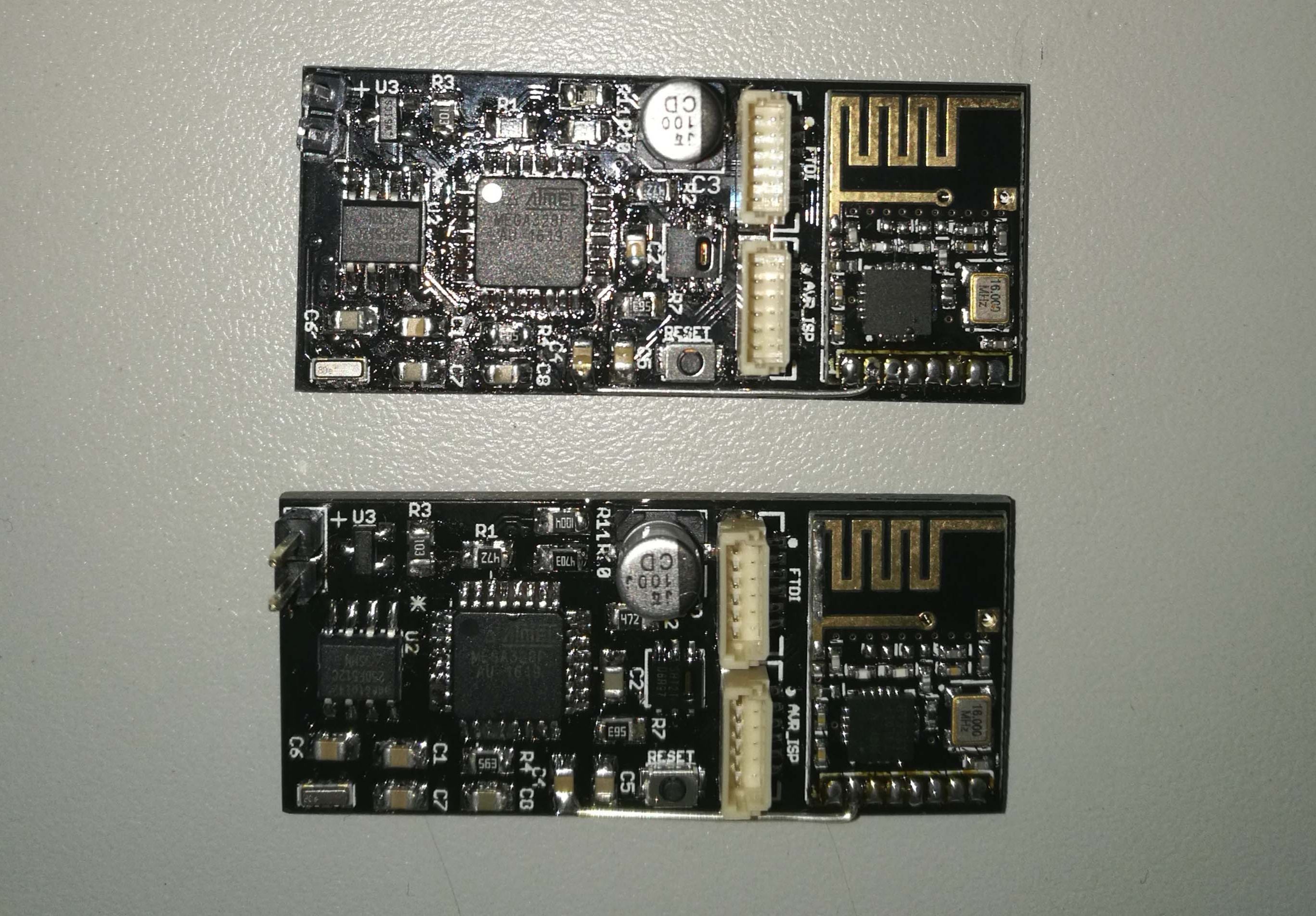

Temperatur Humidity Sensor SHT21
This is new small Temperature/Humidity Sensor.
General
Powered by 2 AA Batteries Size 20 x 45 (mm) Almost SMD 0805 Atmel328p
TQFP32 NRF24I01 smd ATSHA204A chip FLASH for OTA FTDI, ISP SHT21 Sensor
The Sensor works directly on two AA Batteries or Ni-MH
Settings
Use Sensebender Micro
bootloader Set Fuses before upload bootloader FUSES: L: 0XDE // H: 0XD2 // E:
0X07 (disabled BOD/8Mhz external clock) Set Fuses again, arduino IDE will
override it with the default sensebender fuses or modify the board settings in
Arduino IDE
