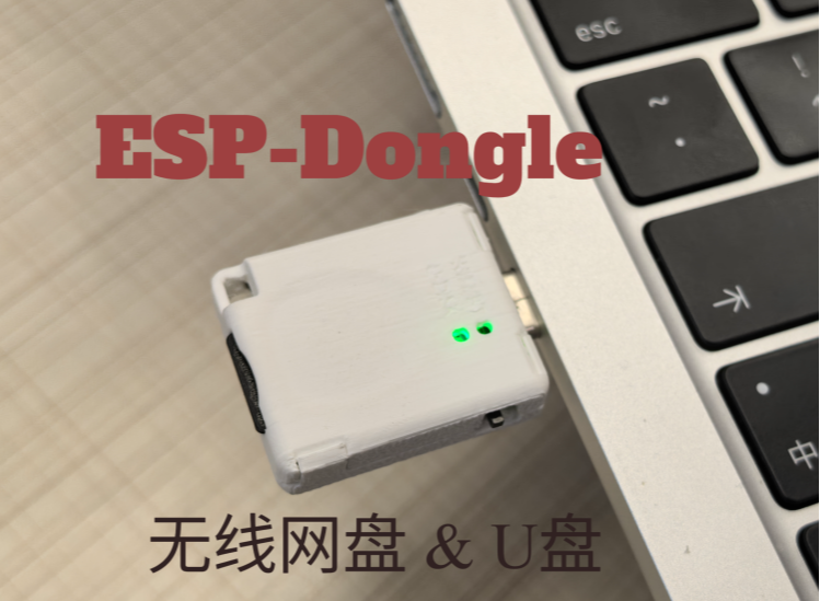

Project Introduction:
The ESP Dongle is a multi-functional USB device solution developed based on the Espressif ESP32-S3 microcontroller. This project seamlessly integrates the functions of a USB MSC wireless flash drive and a USB wireless network adapter into a single device, switching between these functions via a sliding switch.
In USB MSC wireless flash drive mode, the device acts as a wirelessly accessible USB disk, allowing users to access and manage data on the onboard flash memory or SD card via USB connection. Simultaneously, the device provides a built-in file server via Wi-Fi, supporting file uploads and downloads, thereby improving the flexibility and convenience of data management.
In USB wireless network adapter mode, the device acts as a network adapter, allowing the host to establish a wireless network connection and featuring hot-swapping capability, further enhancing operational flexibility and convenience.
Physical Product Demonstration:
The physical product image
is shown below.

The sliding switch allows users to switch between USB MSC wireless flash drive and USB wireless network adapter functions.
In USB MSC wireless network drive mode, ensure the device and ESP32-S3 are on the same local area network. Users can access and manage the SD card content on the ESP32-S3 via a browser by accessing 192.168.4.1.
In USB wireless network adapter mode, the device can be used as a network adapter. Users need to pre-configure the room's Wi-Fi SSID and password. When the device is connected to a computer, the system will automatically connect to the pre-configured Wi-Fi network.
