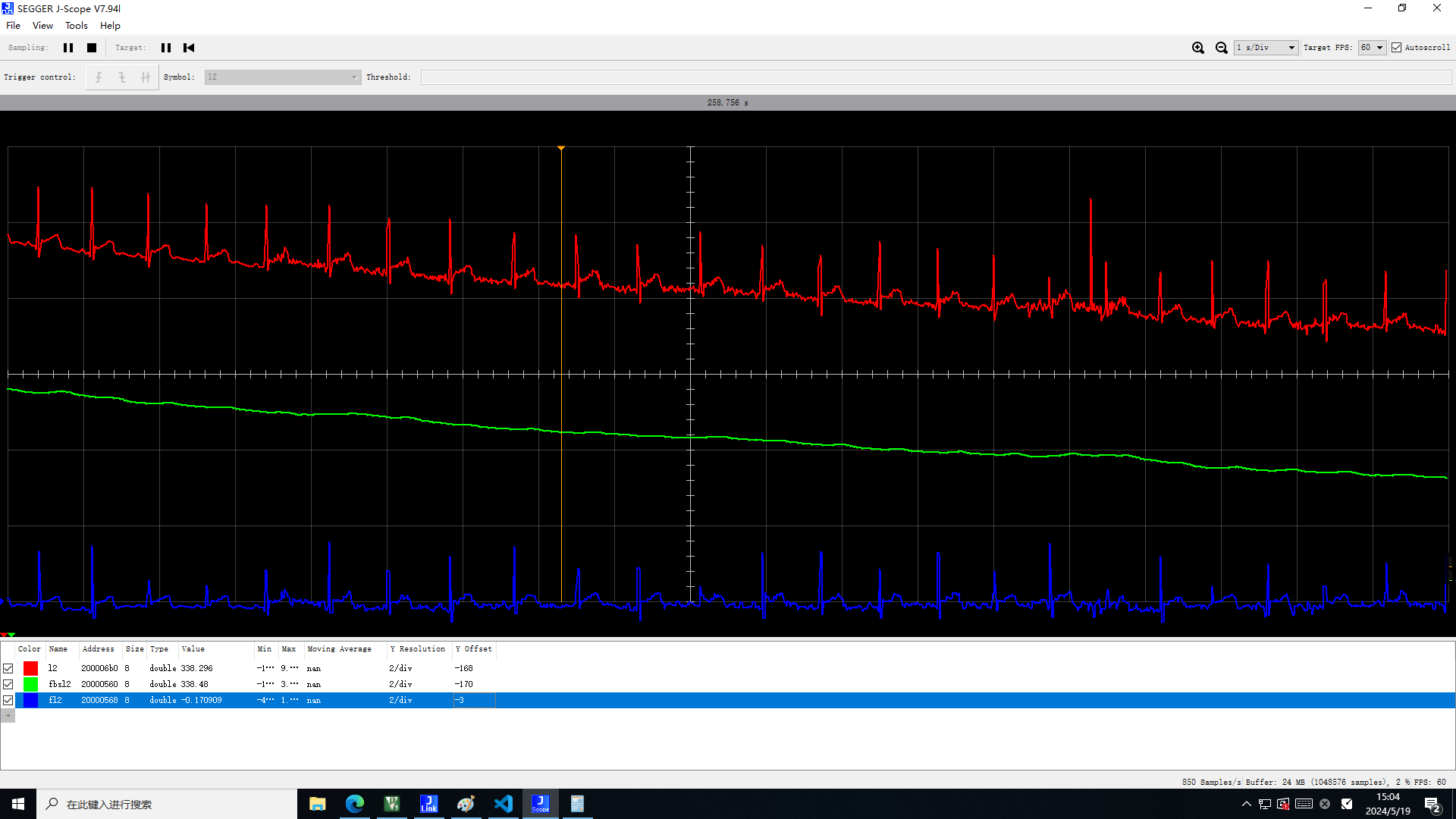

Blood oxygen saturation pulse wave display processing

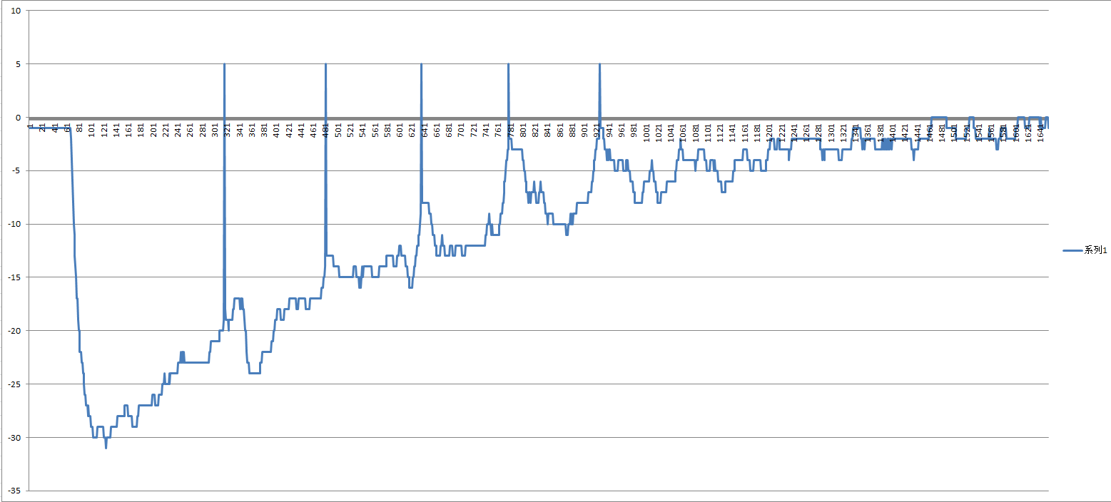

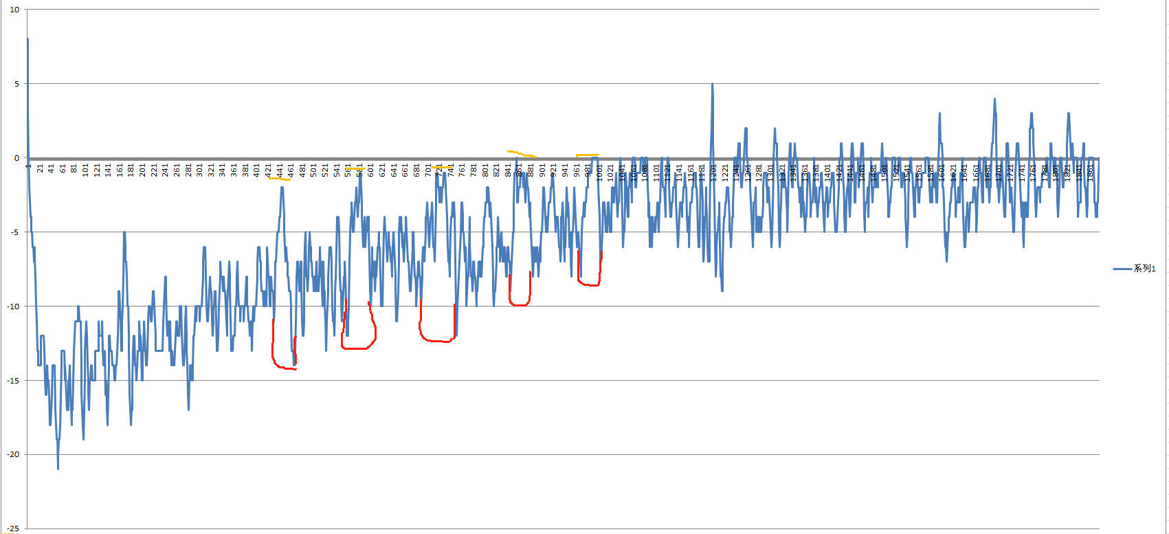

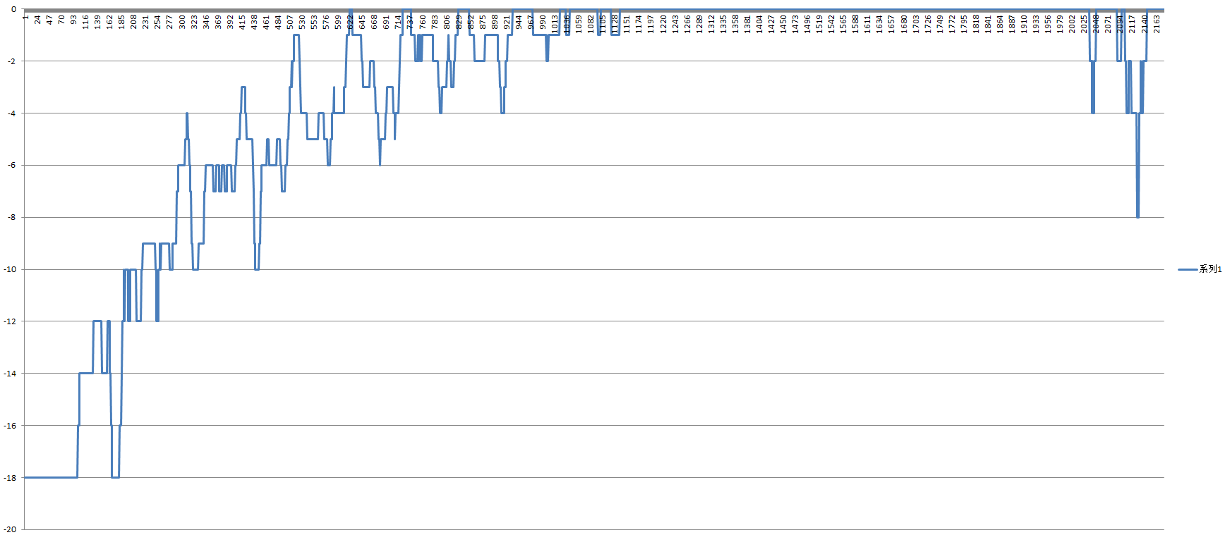

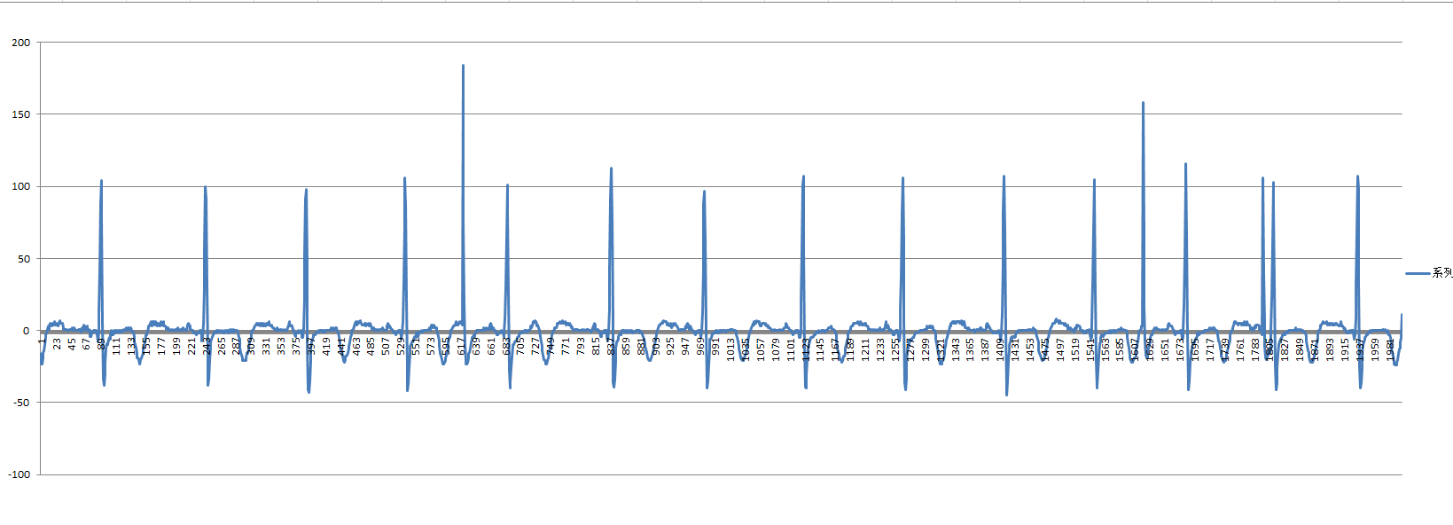

ADS1298 readout ECG signal calculation and real-time baseline correction

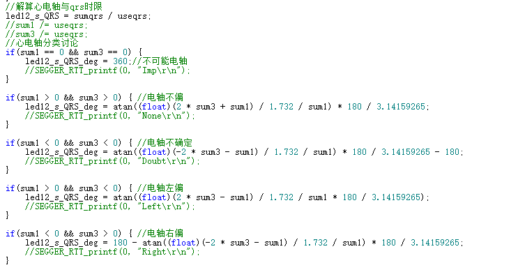

Multi-lead synchronous ECG data analysis (R wave identification, QRS origin finding, QRS electrical axis calculation, T wave finding and QTc calculation, chest lead R/S analysis)

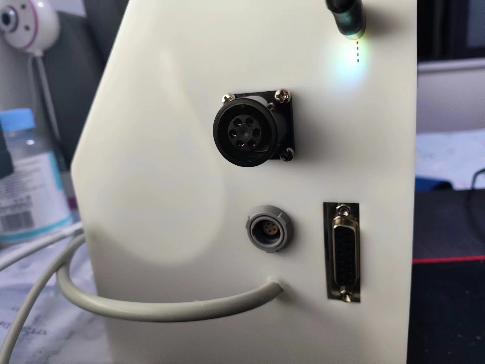

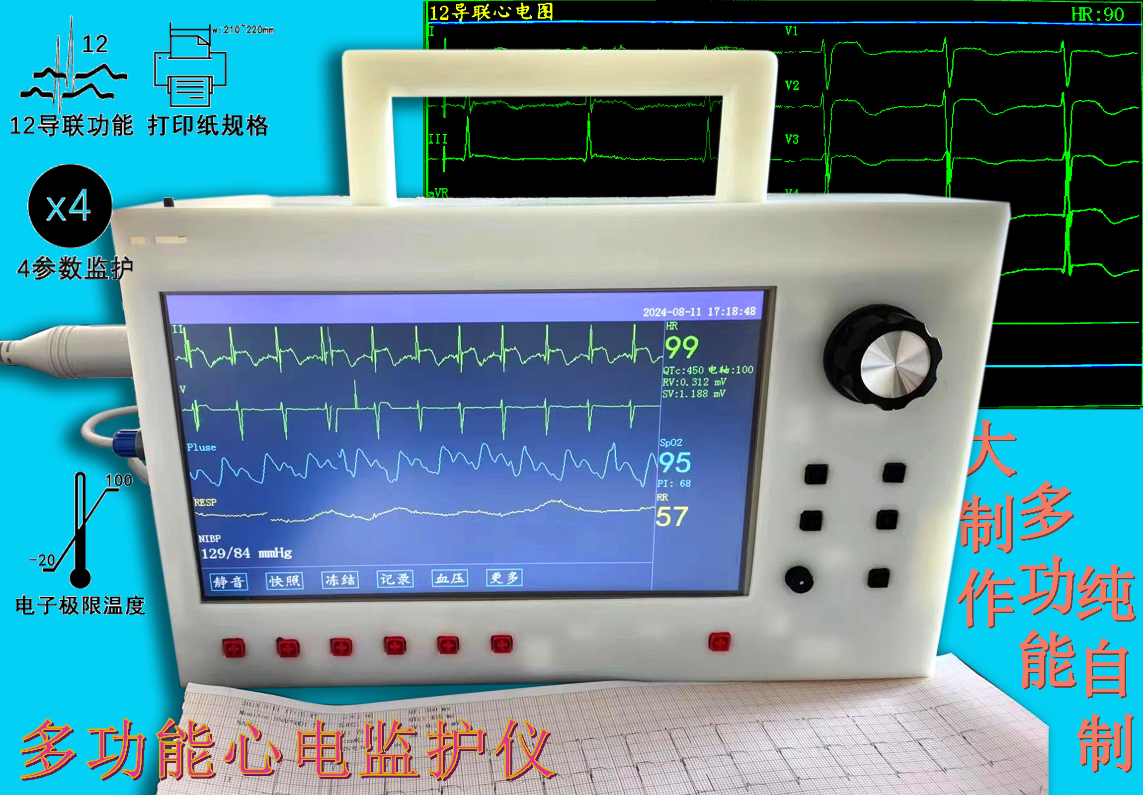

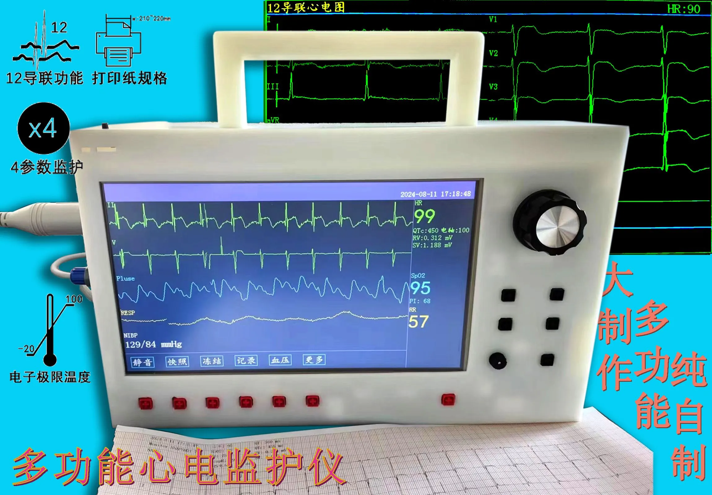

Physical Display
of ECG Monitor Overview (Blank Screen)

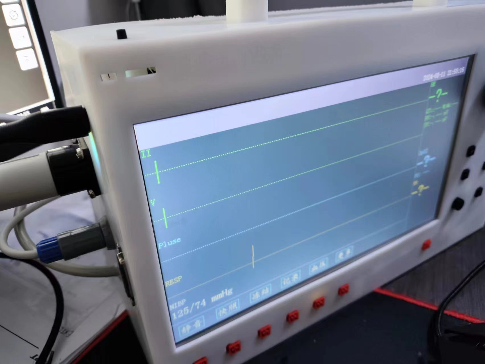

ECG Monitor

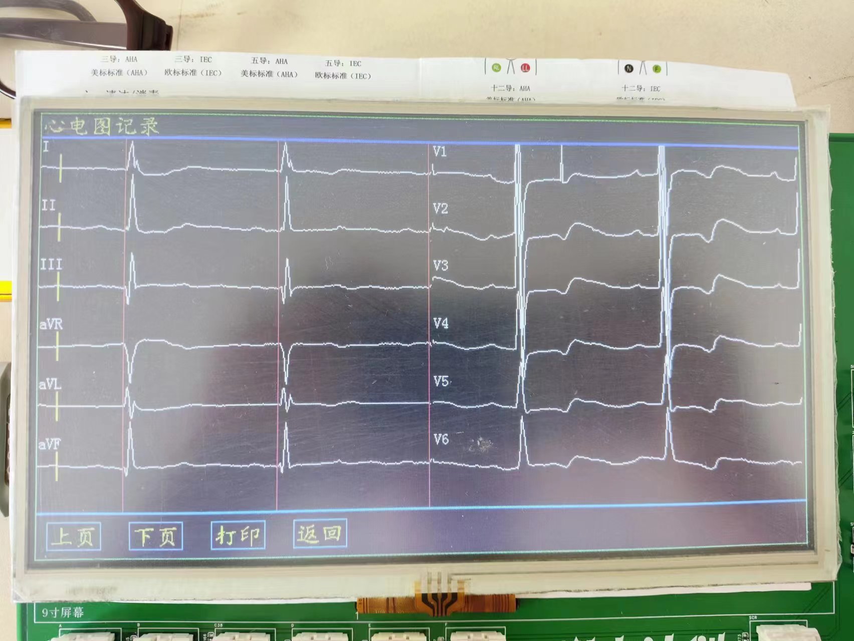

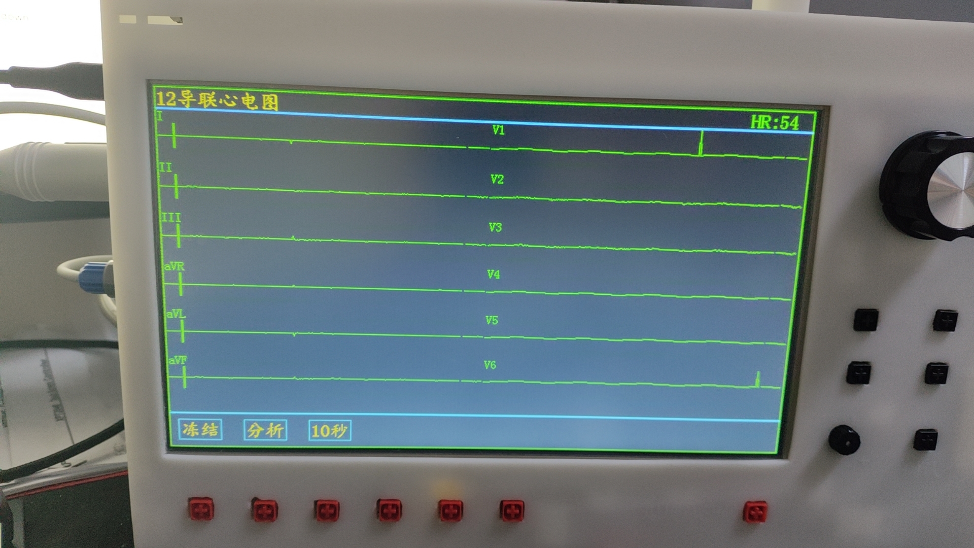

12-Lead Main Interface (Blank Screen)
12-Lead Recording Interface (Taken before assembly for a heart failure patient)

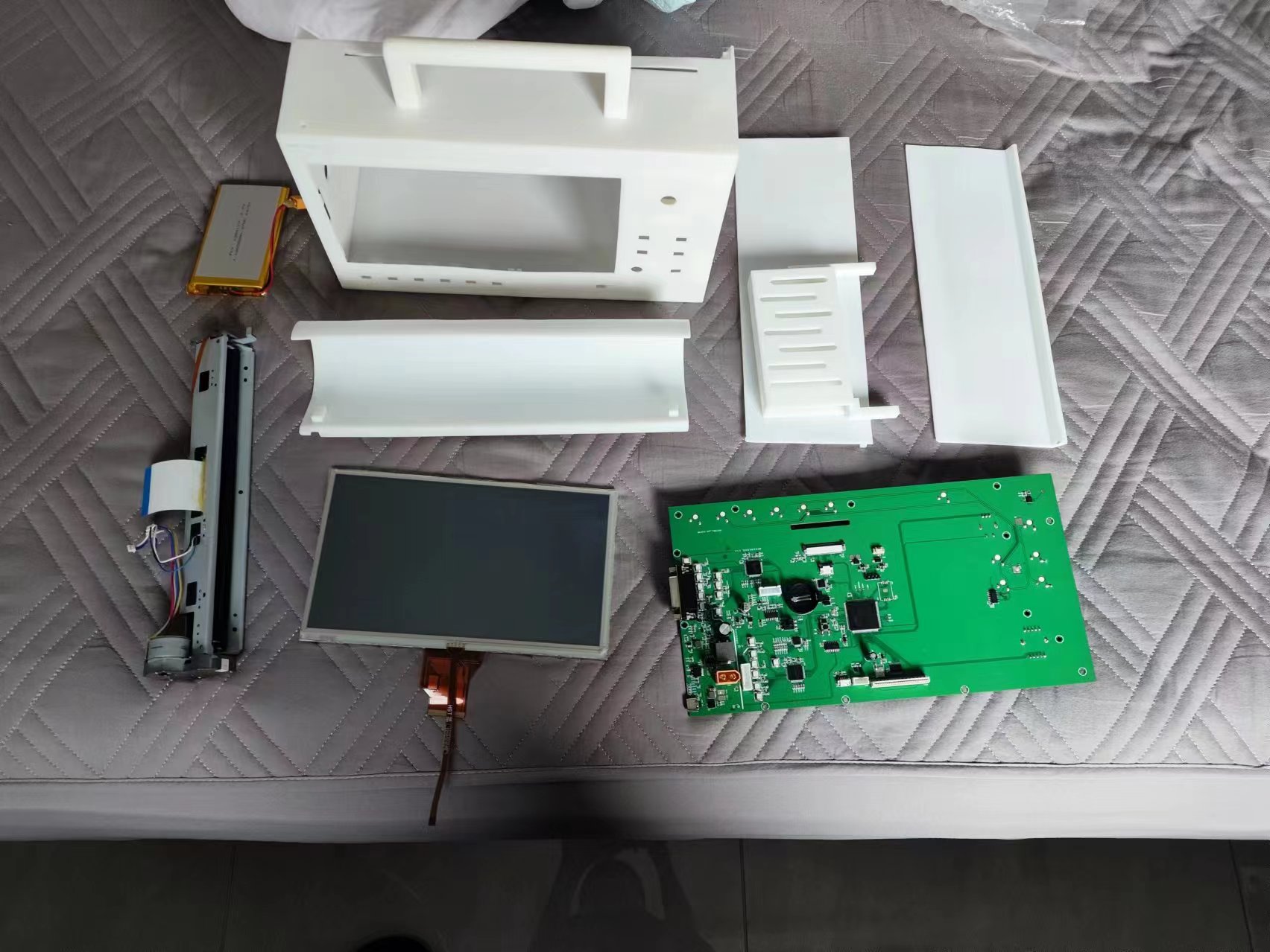

Monitor Paper Box
Monitor All Accessories (Large Lego)

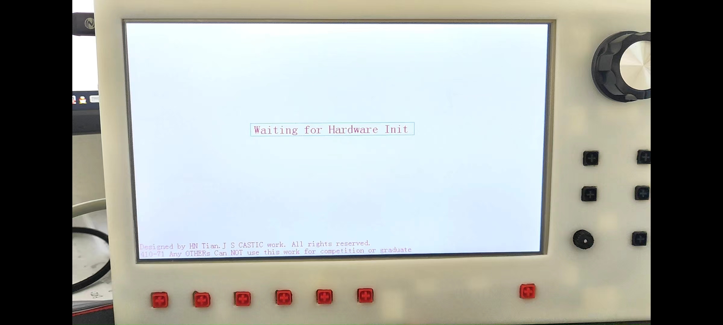

Initialization Interface
Side Interface

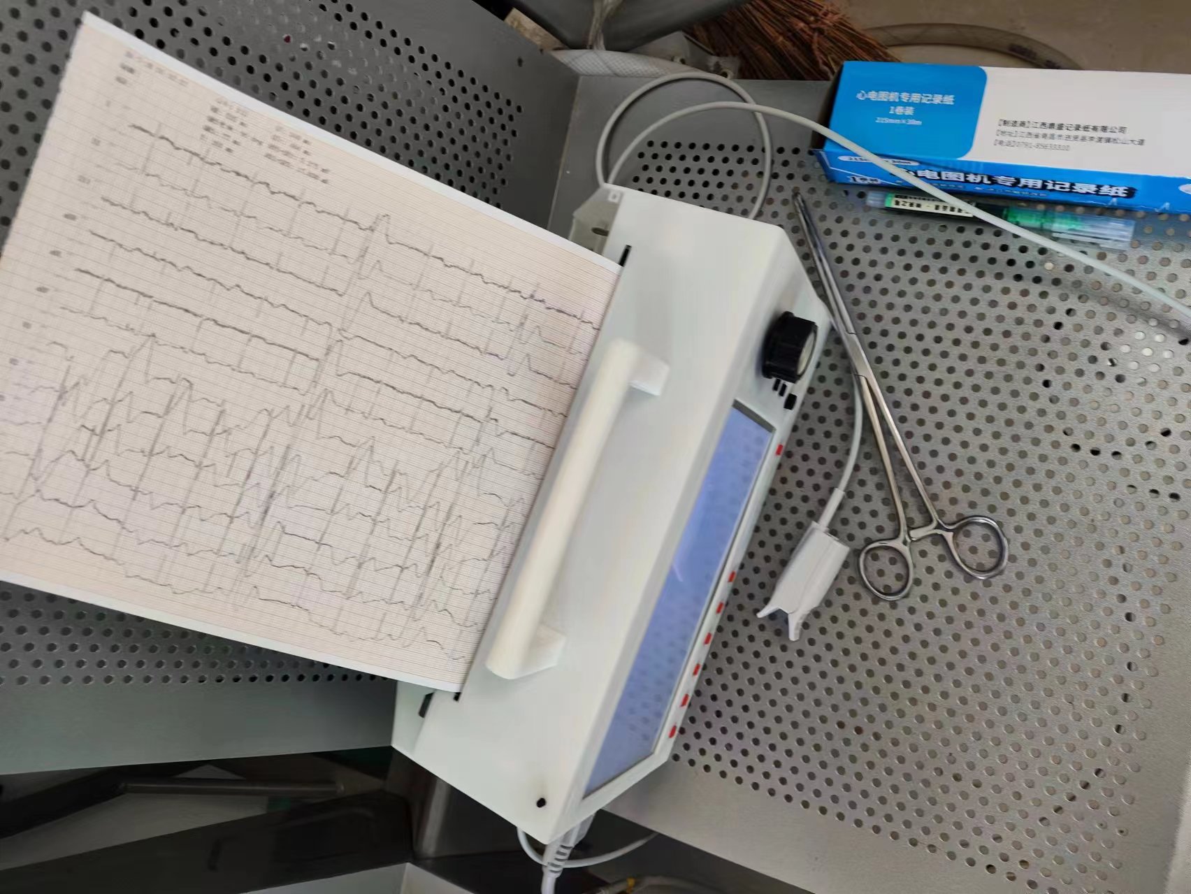

Printing Operation Diagram (Taken during a rural trip for a patient with frequent premature ventricular contractions)

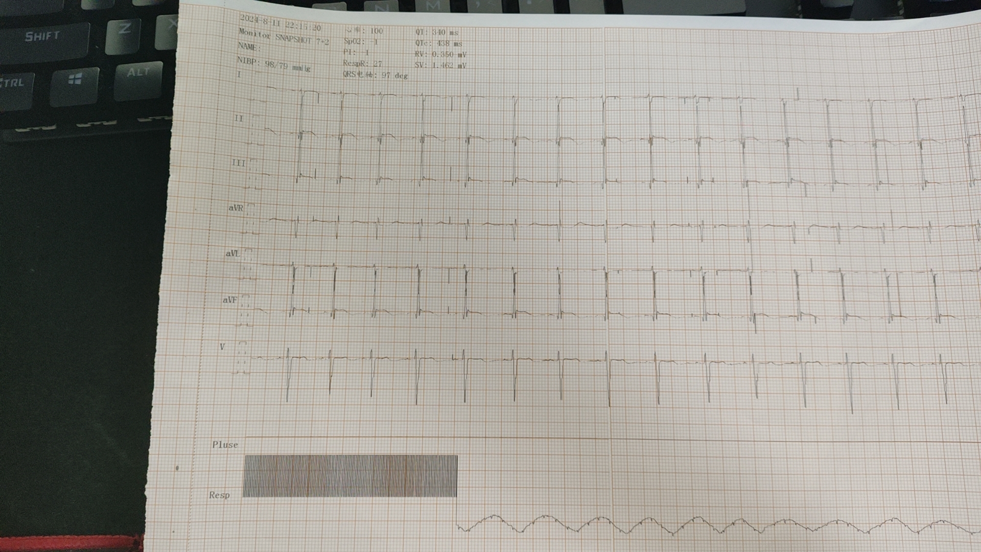

12-Lead ECG Printing Template (Taken during a rural trip for a coronary heart disease patient with frequent angina)

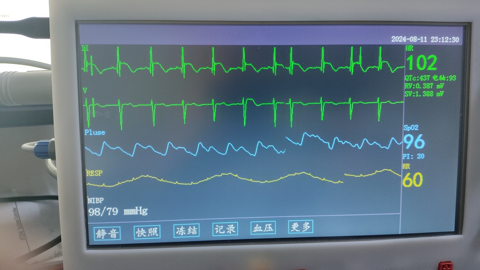

Monitor Snapshot Template (7 ECG Leads + Pulse Wave + Respiratory Wave)
Project Description:
This project uses the GD32F470ZIT6 as the main control chip and the TI ADS129X as the bioelectrical acquisition front-end design. Other acquisition systems use standard structures.
This project combines an ECG monitor with a 12-lead ECG. Powerful yet compact, this machine can be covered with a single A4 sheet of paper at close range, reducing overall weight. When used in emergency medical systems, it alleviates the burden on rescue personnel, allowing them to easily navigate narrow areas.

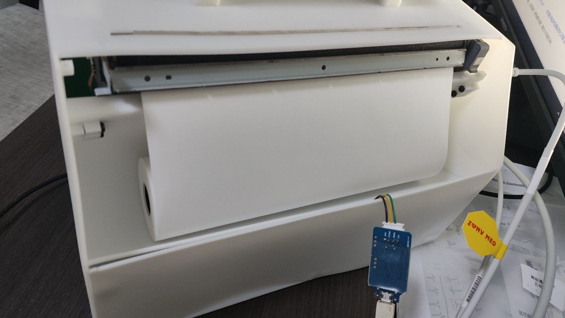

This project integrates an 8-inch (A4) thermal printer core, enabling rapid printing of records with a fixed length of 30cm. The recording paper includes binding reference lines and a built-in RTC clock for time synchronization, facilitating quick data organization and improving work efficiency. The print template data columns are concise, easy to understand, and neatly arranged, allowing for quick retrieval of important data.
This project includes accompanying video tutorials; click the link at the end of the article to watch!

2024-7-20 Implementation Status: ECG Q wave recognition, QRS duration and electrical axis calculation program completed
2024-7-22 Implementation Status: ECG QT, QTc, T calculation program completed

: Battery Management: IP5310 (Ingenic Semiconductor). It features excellent power management and current path management, with power indicator lights, short-circuit protection, high conversion efficiency, and a 3A current carrying capacity.
ECG front-end: ADS1298 (TI) high precision, easy operation, digital device, reducing interference in the transmission path.
Respiratory measurement front-end: ADS1292R (TI) low cost, high precision, easy operation, digital device, reducing interference in the transmission path (ADS1294R out of stock, a forced choice).
Blood pressure sensor: The manufacturer is about to go bankrupt, this device is discontinued, please find another option, it will not be introduced here (truly unexpected, never expected, it came too suddenly).
Voltage reference source: REF3433IDBVR (TI) 95uA low power consumption, low temperature drift, suitable for harsh environments, high precision, easily meets national standards.
Printhead mechanism: JX-8R-LXS (QJ) currently the lowest cost found, listed price 500, available for around 400. High printing accuracy, low power consumption, simple and customizable operation. (Need to contact distributor for goods)

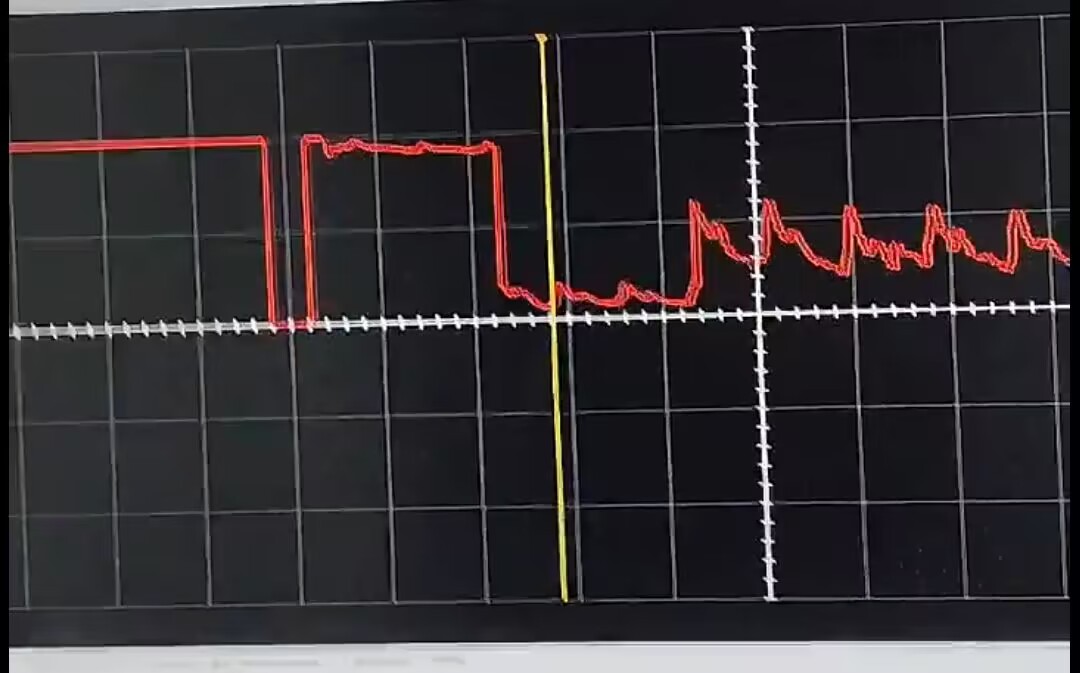

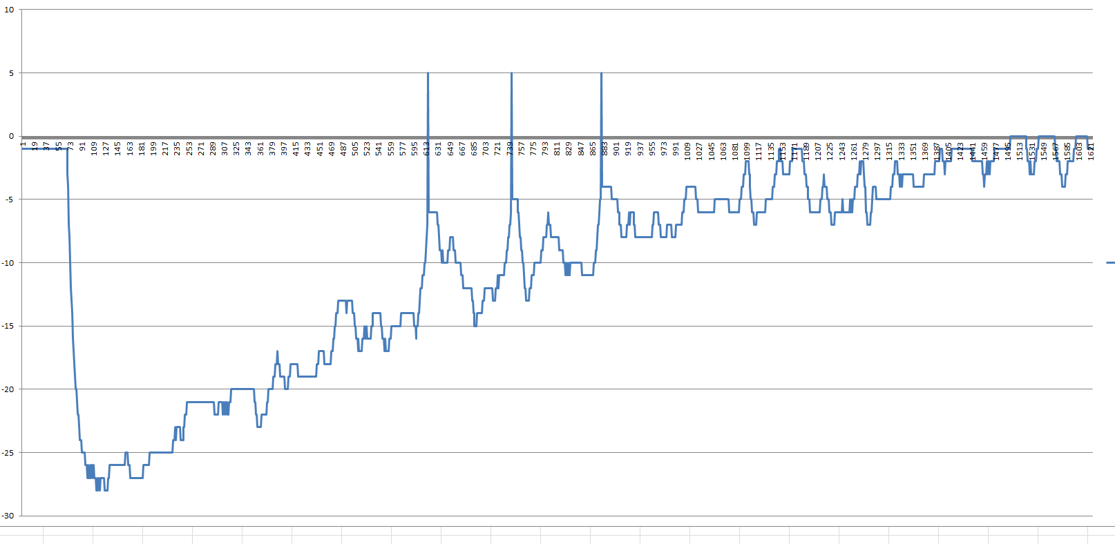

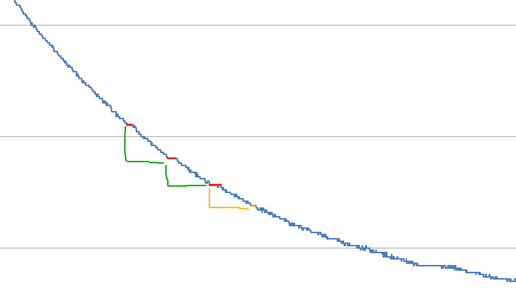

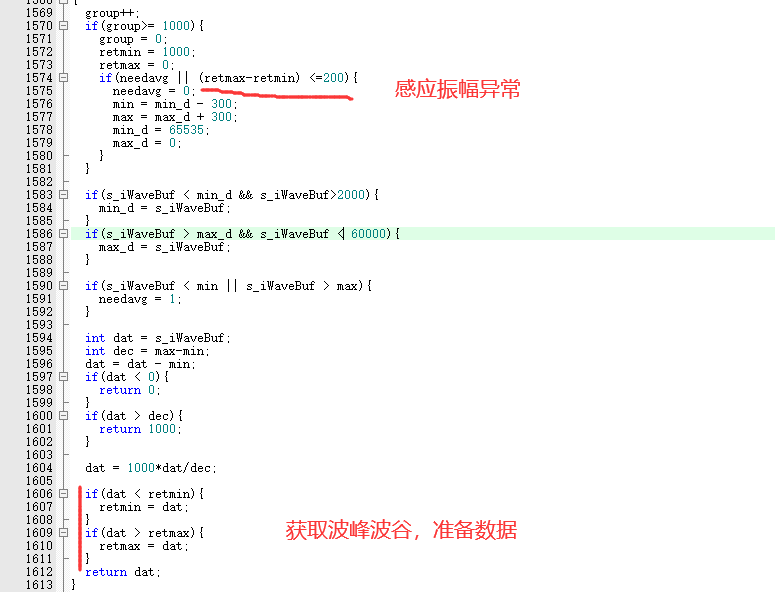

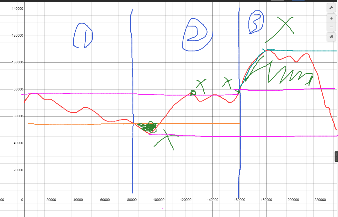

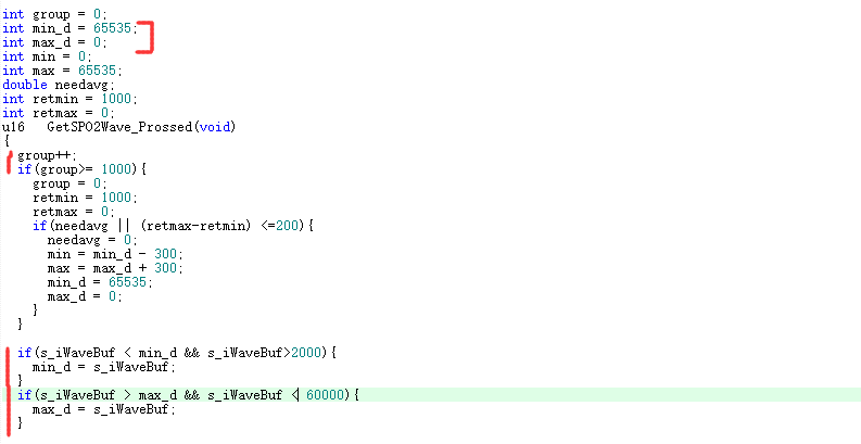

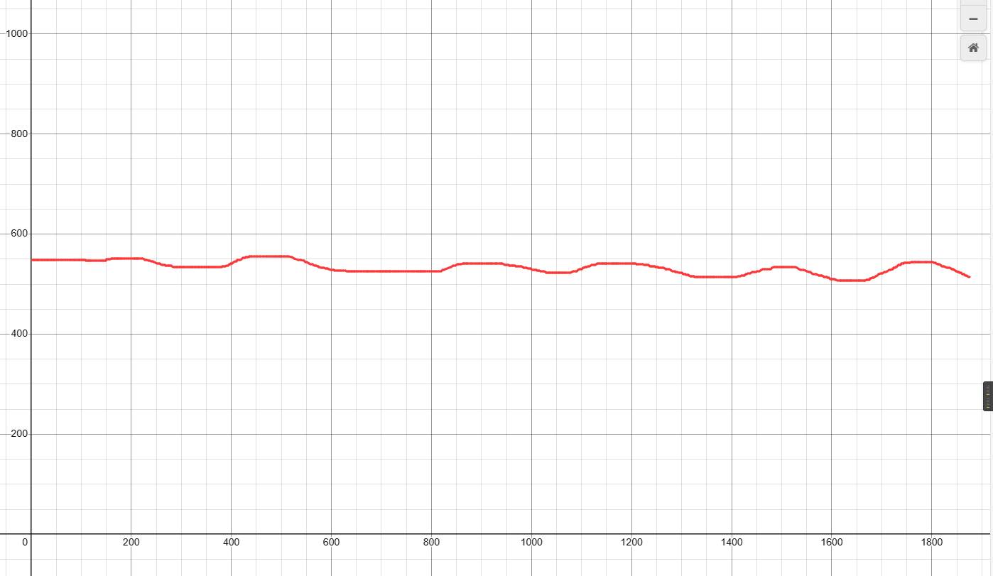

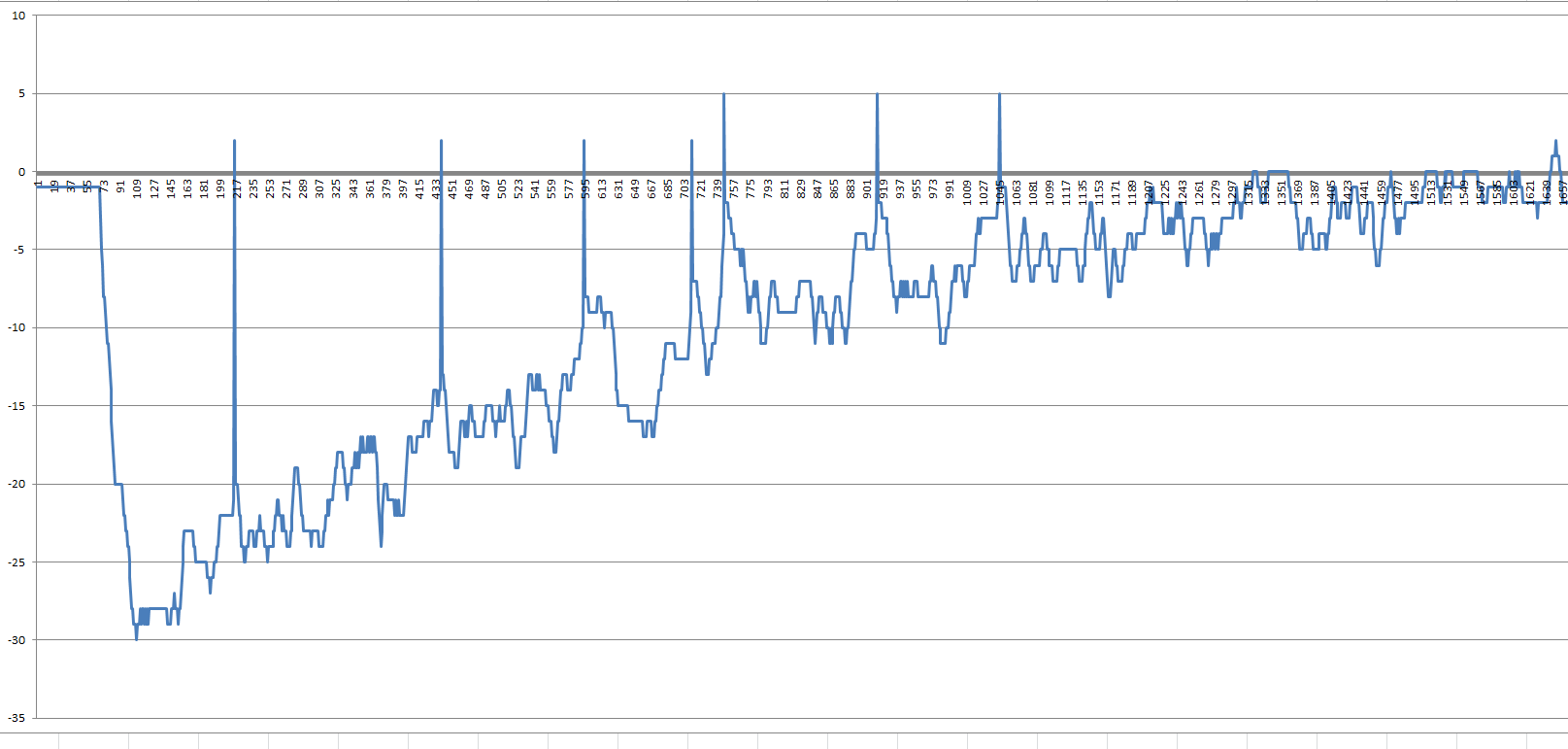

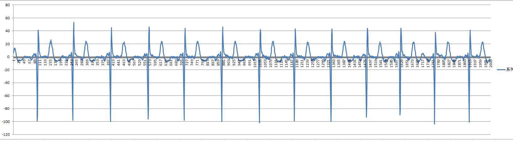

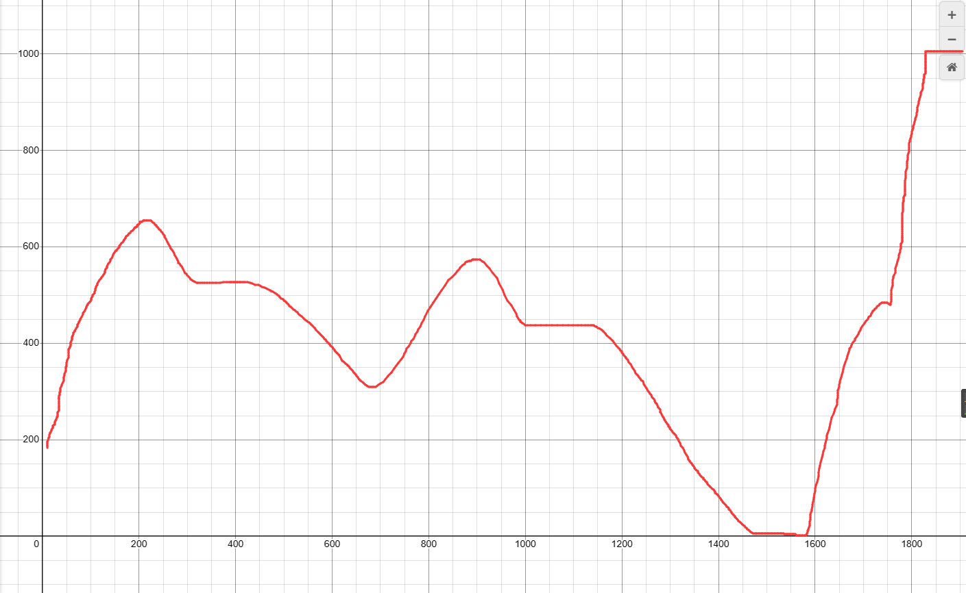

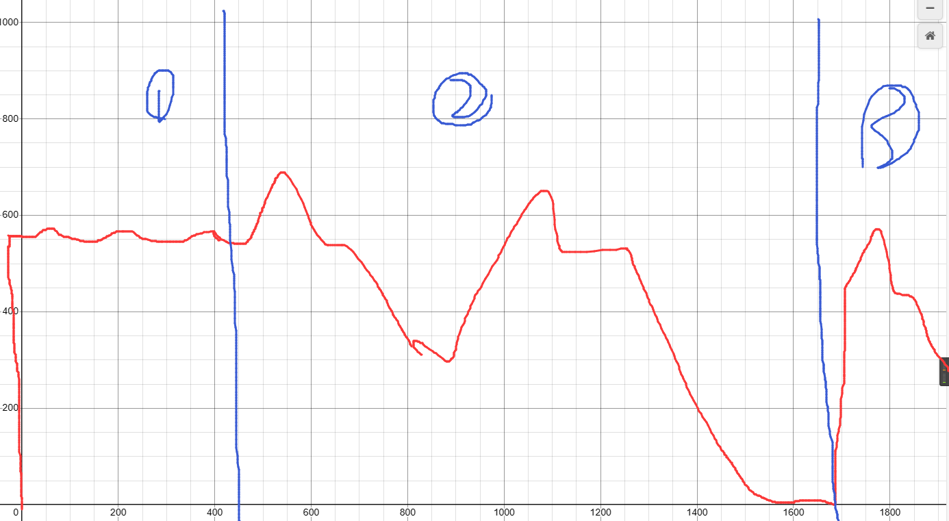

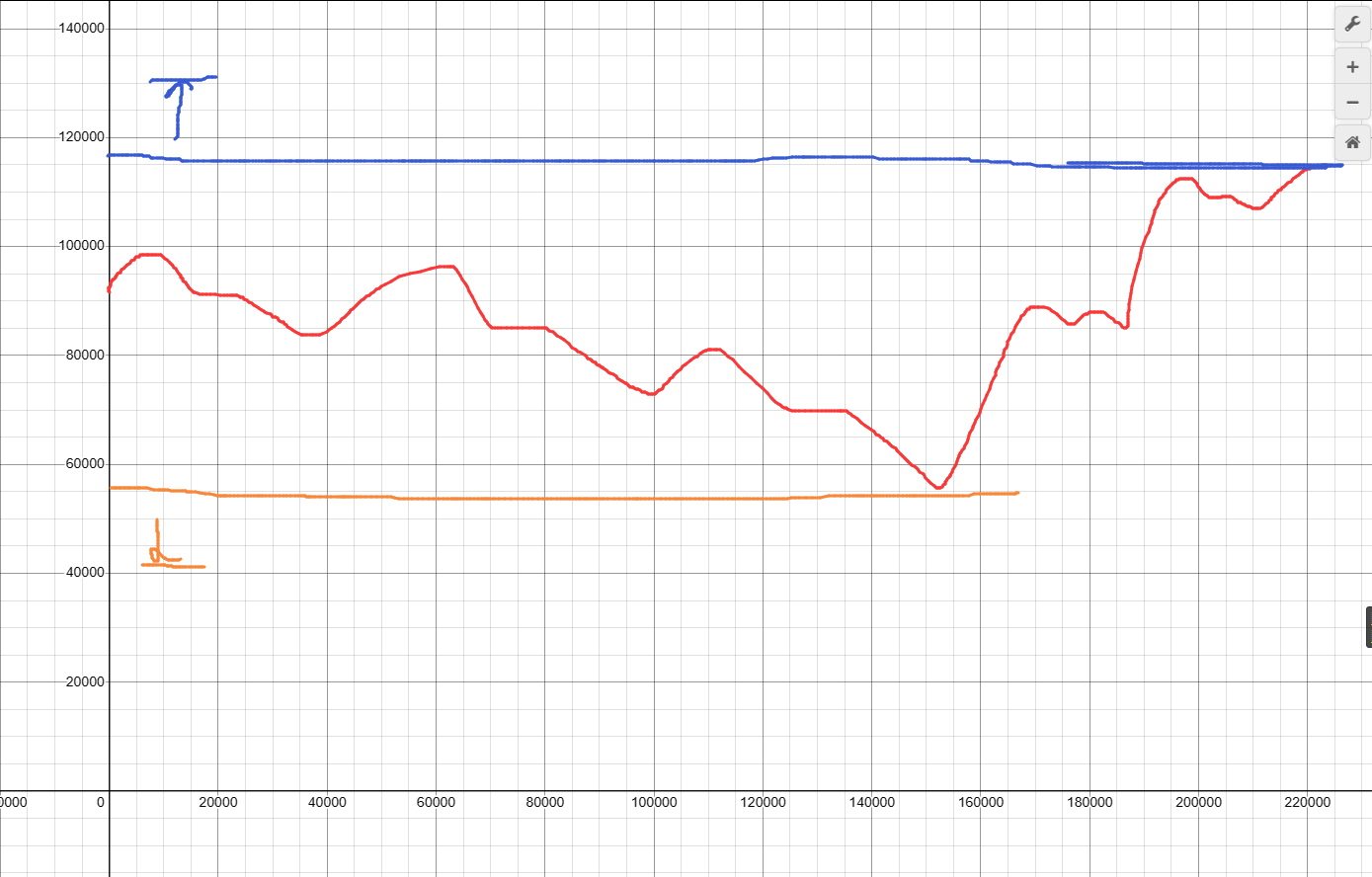

1. Blood Oxygen Saturation Pulse Wave Acquisition
The diagram shows the PPG data we need to obtain (similar). If we simply set a threshold to "cut off" everything, then signals outside the range will be cut off, presenting a false full-range appearance on the screen. The pulse wave values ​​returned after measurement are different for each person, and the waveform is also susceptible to unexpected influences: such as unauthorized movement of the pulse oxygen clamp, second-degree atrioventricular block, asphyxia or other causes of pulse oxygen drop, and limb movement that obstructs blood flow. Therefore, we must use a special algorithm to adapt to these factors.
Reading window:
We set the display window to a range of 0-1000. To display the complete graph within the window, we first need to mark the maximum and minimum values. Marking the maximum and minimum values ​​makes it possible to fit the entire graph into the display window. However, the values ​​returned by the sensor are very large and cannot be directly displayed in the window, so we need to perform further necessary processing.

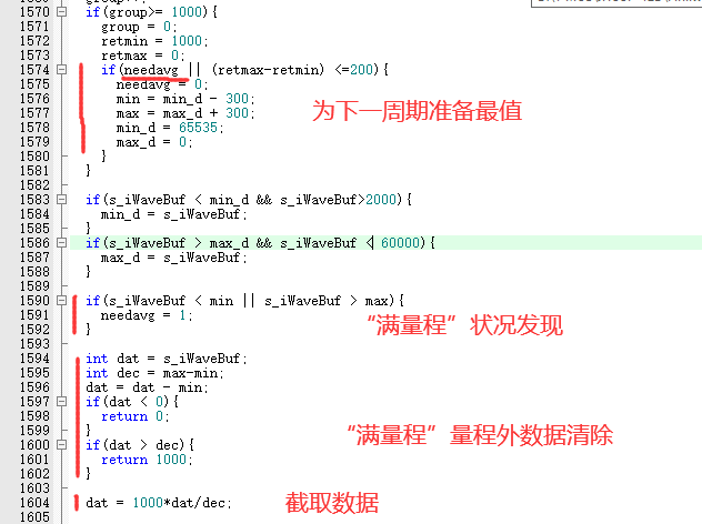

Processing Window:
The pulse wave provides a lot of information. To preserve the pulse wave's rise and fall, as well as more details in the graph, we use a segmented maximum/minimum value method instead of median filtering. Now, we set a period and take the maximum/minimum value every 1000 periods (the relevant code is marked in red, the same below).
Then, we subtract the minimum value from the value and directly omit the numbers less than the minimum value. However, the disadvantage of segmented value taking becomes apparent. So, while omitting the numbers, we tell the value taking part to retake the value (the same applies to the maximum value).
Doesn't this cause the full-scale phenomenon again? In fact, this is a necessary sacrifice for displaying trends. The signal will be re-sensed in the next cycle, and each cycle only lasts for a 2-second
processing window.
Then, we capture the data and plot the graph on the display window. To reduce over-range phenomena, we add a 300-degree grace period to
the PPG display window for the maximum value.
However, a few seconds after dimming, the maximum value of the pulse wave is incorrectly determined, or the pulse weakens when the patient experiences arrhythmia. During this process, the pulse data does not exceed the maximum value, but the waveform is abnormally small, difficult to read, or even a straight line that cannot be read. At this time, we need to detect the waveform amplitude. When the amplitude is lower than the set value, we send a request to
the PPG display window (abnormal) to re-determine the maximum value.
In this way, when the PPG signal has an abnormal amplitude, the program will "stretch" the waveform. Thus, the PPG search and unexpected handling
PPG display window (runtime) are solved.
The PPG display window (actual operation) clearly shows the processing of each cycle.
*PPG differs from ECG and cannot replace ECG in diagnosing complex conditions. However, PPG has its uses, such as detecting atrial fibrillation, premature beats, conduction blocks, tachycardia, or bradycardia. It only serves a detection purpose; ECG confirmation and qualitative analysis are still required.

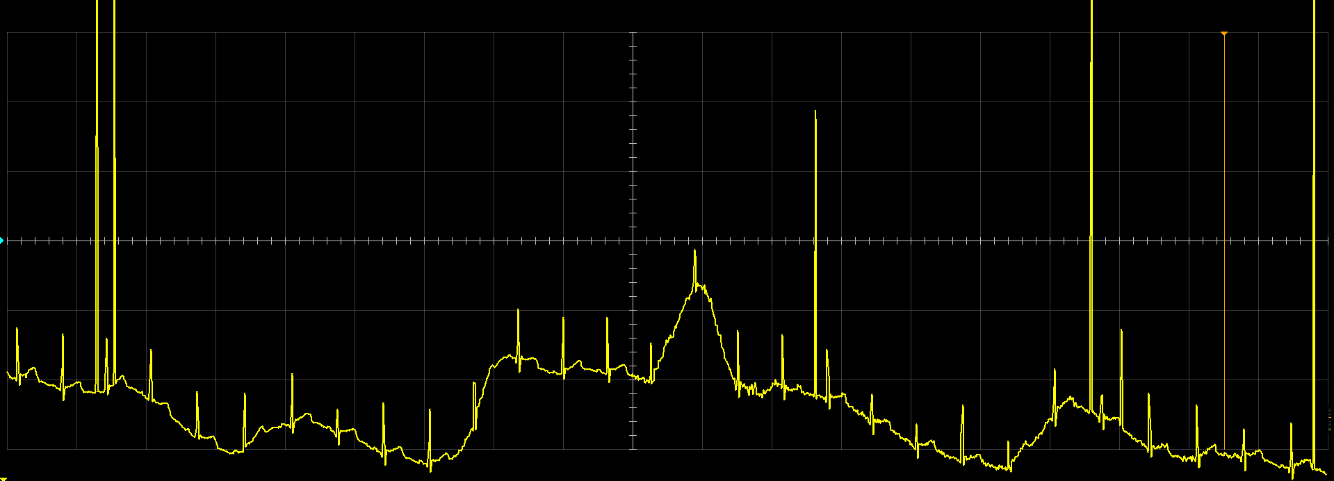

2. ADS1298 ECG Signal Readout and Real-Time Baseline Correction:

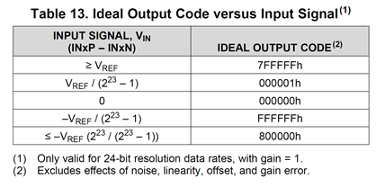

First, let's criticize the peculiar output method of the ADS1298. When the signal is from 0 to the positive full scale, the output value is 0 - 0x7FFFFF. However, when the signal is from the negative full scale to 0, it follows 0x7FFFFF, becoming 0x800000 - 0xFFFFFF.
Therefore, the plotted number line looks like this. Further processing is needed to connect the two; otherwise, when the data is stuck between positive and negative, the calculated data will be unanalyzable.
Currently, red is in one group and blue is in another. According to uint, blue comes first, then red. Now we put the blue last, and the rest is handled by the baseline correction logic.
To put the blue last and prevent overflow, we divide the process into three steps.
The first step is to determine whether the data should be above or below 0.
The second step, if below 0, subtract 0x800000 from the data to make the negative full-scale value 0.
The third step, if the data is above or below 0, add 0x8000 to the data.
This way, data reading will be smooth and can be safely passed to the baseline correction logic

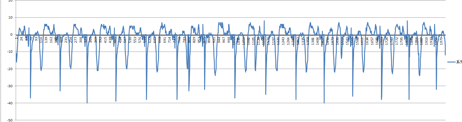

. While the old problem is solved, new problems arise. After using the "12-array method" to stabilize the data, we found many spikes, which significantly affected interpretation and analysis. We need to clean up these spikes.
We found a particularly abrupt spike with a voltage of 8mV. Is it possible for the QRS voltage to exceed 8mV? In a normal person, this is unlikely, but situations are variable. We began searching for clues in pathological electrocardiograms. We directly searched for left ventricular hypertrophy.
The search results showed that the QRS voltage in the searched cases was around 3mV, with none exceeding 3.5mV. To be on the safe side, we defined signals exceeding 6mV as glitches and removed them
(the highest QRS voltage was ultimately found in a relative with heart failure and left ventricular dilation, with an R-wave voltage of 5mV).
Now, we've said goodbye to large glitches; small glitches still require further effort in power supply analysis.

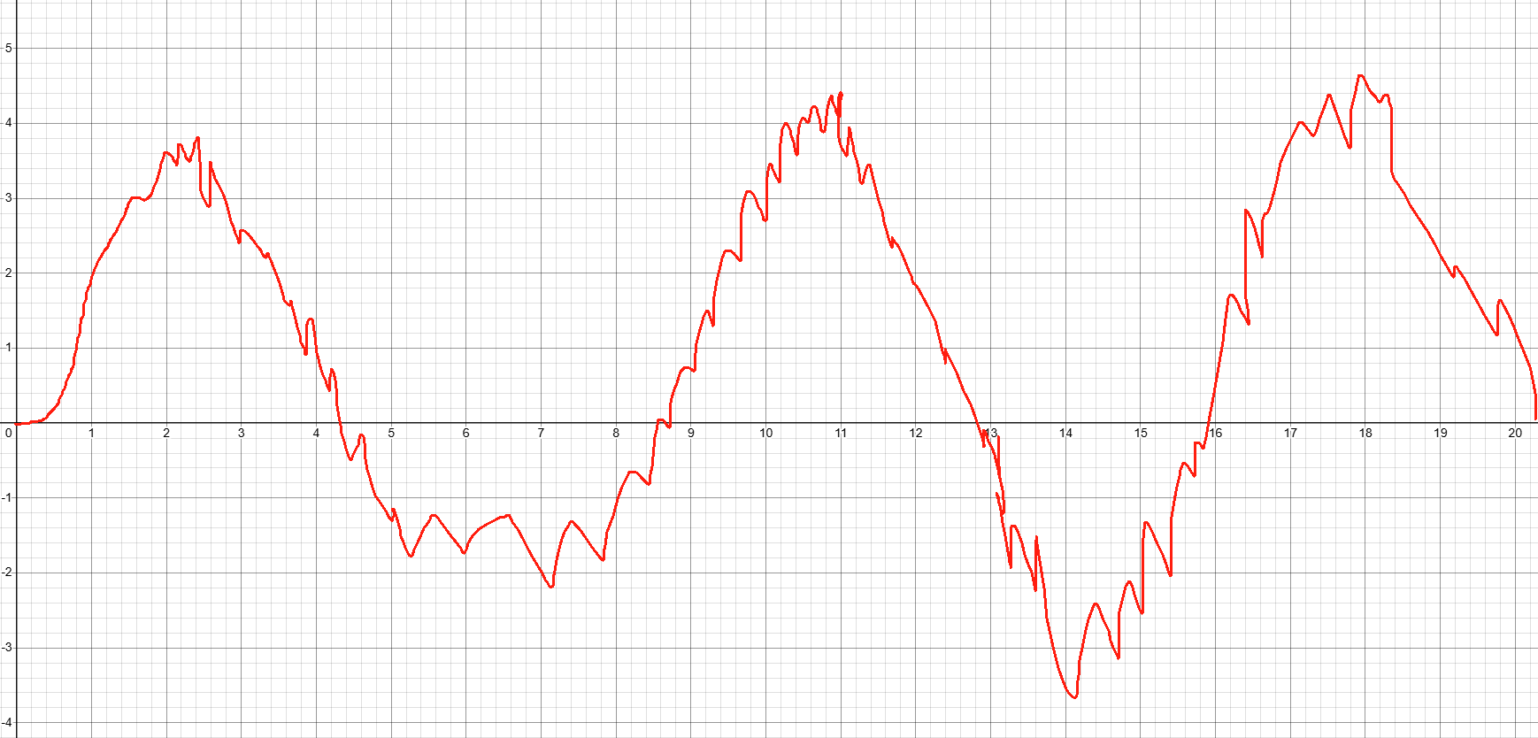

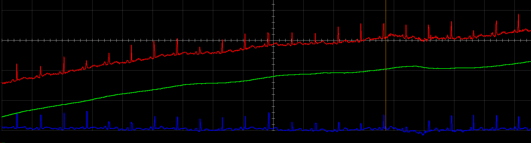

Next, we need to deal with the baseline, which looks like it's been "drunk" (i.e., tilted up and down). This is baseline drift.
How do we handle baseline drift? The key is to find the baseline signal. Then, subtracting the baseline signal from the original data will give us the corrected waveform.
To obtain the baseline signal, we need to remove the QRS wave, P wave, and T wave. The QRS wave is the easiest to remove; simply use the glitch removal code and classify the QRS wave as a glitch.
In the definition, leads I, aVR, aVL, and aVF are not defined because these leads are calculated by the algorithm and can be calculated later (bsxx, i.e., basexx, is the baseline variable).
The idea sounds good, but reality is harsh. Due to the high sampling rate, the QRS wave has a rise time, and the obtained baseline sample (purple) is almost identical to the original data (red). Solving this impasse is simple: we use sampling surveys before proceeding with the next step.
Thus, we obtain the sample after sampling surveys with the QRS wave removed. Although the sampling rate is extremely compressed, it is more than sufficient for baseline calculation.
I heard you're going to directly subtract this from the data? No! There are still unremoved P and T waves, and sometimes S waves are mixed in!
At this point, we introduce our median filter.
By subtracting the baseline data from the original data, we can obtain the baseline and final waveform.
Test subject 2:
*Related code has changed, the test graph does not reflect the final result.
Then, we can extrapolate the results to other limb leads.
3. NIBP Non-invasive Blood Pressure Data Processing

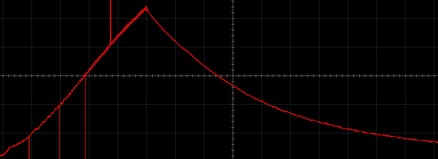

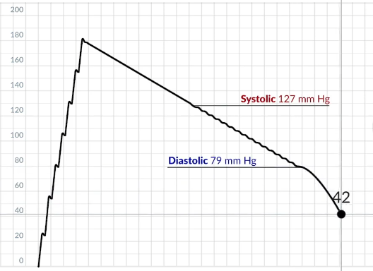

The principle of non-invasive blood pressure (NIBP, the same below) measurement is to inflate the cuff to a certain value above the highest blood pressure value and then slowly deflate it. The change in cuff pressure (or tubing pressure) during deflation is read and processed to obtain the NIBP value.
When the cuff is inflated above the systolic pressure, blood flow is blocked and no force is exerted on the cuff. During deflation, the cuff pressure drops to the systolic pressure, and blood flow resumes and fluctuates, exerting a force on the cuff, causing the pressure value inside the cuff to increase or remain temporarily unchanged. After deflation continues and the pressure drops below the diastolic pressure, a pressure difference is obtained. The pressure exerted by the cuff on the blood vessel is equal to the supporting force of the blood vessel, the resultant force is 0, no deformation occurs, and the pressure inside the cuff is no longer affected by the impact of blood flow, and the pressure value decreases normally.
The chart from https://www.bilibili.com/video/BV1JV4y167AJ shows the cuff pressure change under ideal conditions.

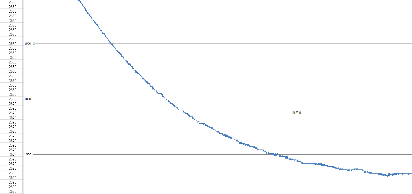

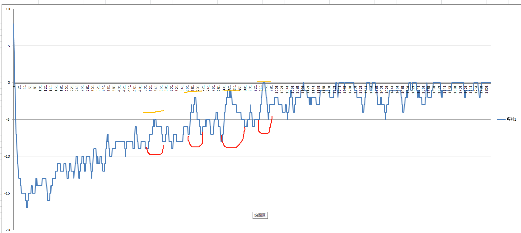

However, in reality, nothing is ideal. After preprocessing the *0.1kPa data, the readout waveform looks like this
The deflation portion
lost waveform details during the *0.75 conversion when converting to mmHg int values ​​in the preprocessing. Therefore, we unexpectedly read a strange NIBP value of (87/45) on this distorted waveform.
Replacing int with float yields the following graph
. You probably don't know where the information lies, so let us point it out:
We can find four heartbeat points, but the yellow-marked heartbeats are too faint, and the microcontroller may not be able to recognize them properly. We believe there are three valid points
. Next, we need to make the microcontroller recognize these heartbeat points. Directly letting the microcontroller process them is impossible because there are flat straight segments before and after, and we cannot calibrate the threshold. Due to the special nature of data reading, even one incorrect reading will cause a large error in the obtained data.
Following Professor Tang's guidance on the electronic blood pressure monitor circuit in the electronics design competition, a 0.3~3.5 bandpass filter was used. However, in practice, it was found that a higher frequency

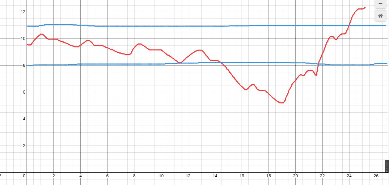

bandpass filter was needed. After filtering, extraction, and further filtering, the data obtained could easily identify five pulse points, but still contained a lot of noise, which could not meet the processing requirements of the microcontroller, which still could not understand it. Furthermore, the large vertical line on the left needed to be masked during later summarization, which could be achieved using a thresholding method.
By using median filtering at intervals, the graph was slightly optimized, making it look less cluttered. The microcontroller was then no longer challenged, and the real-time part ended there; after sampling, unified processing was performed.
By squaring to reduce noise components, the pulse could be determined using the falling branch thresholding method and interference value elimination.
The image shows the extracted pulse points (before exclusion). You can see the diabetic wave and the invalid wave that is too far away. The pulse points
are then processed using both the interval method and the direct method, and the number of valid points is compared. The one with more valid points wins.
The principle of the interval method is as follows:
Existing data: NNNNNNN (also the direct method algorithm)
First processing: NNNNN N (then try to calculate)
Second processing: NNNN NN (then try to calculate)
Third processing: NNN NNN (then try to calculate)
Fourth processing: NN NNNN (then try to calculate)
Fifth processing: N NNNNN (then try to calculate)
There is no sixth processing! Otherwise, the interval values ​​cannot be compared!
The data obtained after excluding interference is shown in the image. You can see that the value of the original data and the interference values ​​between two valid data points are filtered out.
Second experiment:
Then the corresponding systolic blood pressure appears first, followed by the corresponding diastolic blood pressure, and that's it!
I've developed high blood pressure from working late into the night to finish this project for you all! We all need to get some sleep!

5. Multi-lead ECG joint analysis algorithm:
This is a challenging task and a challenge faced by the development of various digital ECG machines. The first step in
R-wave recognition
processing is to weaken p, T, and other wavelets through Pan-Tompkins algorithm filtering and squaring operations to increase the slope of the R-wave.
Result 1:
Result 2:
Then, the index of the R-wave can be extracted through slope recognition. In the case of low voltage, if no waveform is detected, the threshold is lowered to continue detection.
However, as shown in Result 1, there is some interference in the data processed by Lead II, so Lead III needs to be introduced for double verification to obtain clean data.
Then, the index is used to calculate the RR interval and heart rate based on the sampling rate,
followed by the calculation of QRS and QT data.

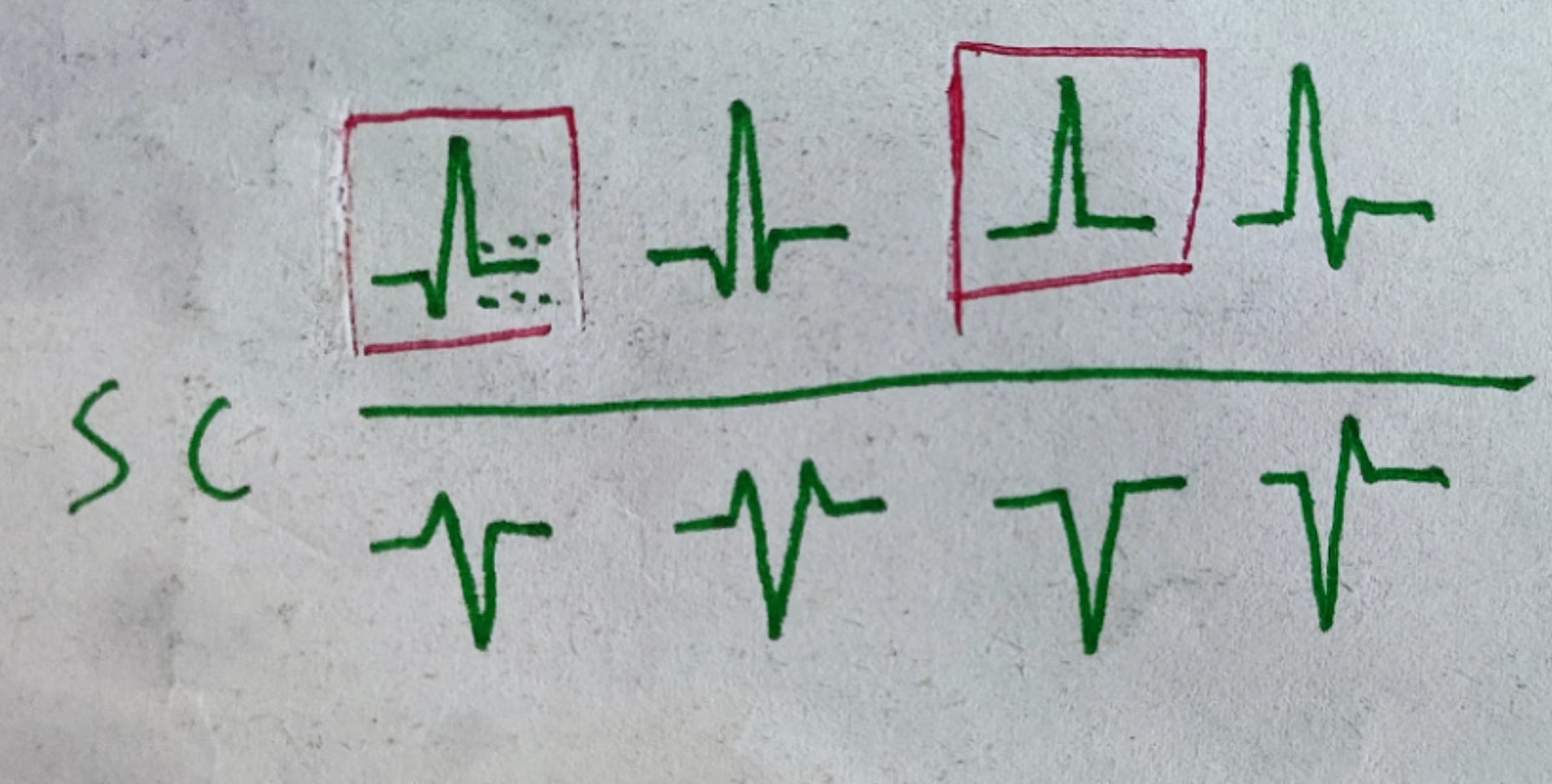

To find the QRS origin
, the R wave we found using the above algorithm may be longer than the R wave or between Q and R. We need to further search to the left for the QRS origin.
For finding the origin, we need to consider multiple cases.
These are possible cases, and some cases can be merged (positive and negative waves of the same type can be merged, and cases based on the Q wave can be merged).
 We summarize the following cases:
1. No Q wave, directly flat;
2. With Q wave, i.e., there is a turning point.
For the first case, we set a value below 4 units as flat (don't be fooled by the large number, the whole graph is actually very large). We stop searching when a flat value is encountered and define its corresponding index value as the origin. For the second case
, there is a turning point; a change in the slope sign is considered a turning point. We set the number of turns to no more than three (to counteract interference), and the difference between the previous and next operation indexes must not be less than 3; otherwise, the search stops immediately, and the corresponding index value is defined as the starting point
. While searching for the starting point, the value of the first two units of the starting point index is defined as zero potential (the average value is taken), and then we proceed to the next step: calculating the electrocardiographic axis.

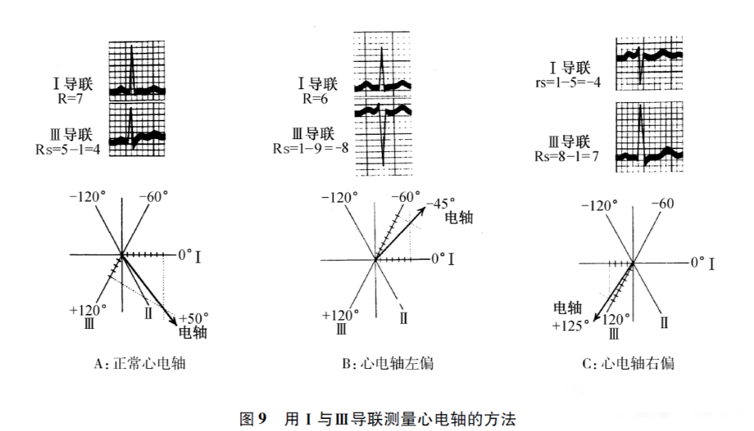

The QRS axis
, also known as the average electrical axis, is the average direction (vector) of cardiac electrical activity and is one of the indicators in an electrocardiogram (ECG). It refers to the angle formed by the maximum combined vector of the frontal plane during cardiac depolarization and repolarization and the horizontal axis.

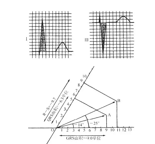

We have already recorded the QRS waves. To enable the machine to recognize the electrocardiographic axis, we must derive the calculation method
. Medical students who have studied ECG are certainly very familiar with this diagram, which uses the algebraic sum of leads I and III for calculation. However, this method is relatively complex for machines. We adopt another method: the area integration method.
Some professors have probably mentioned this to you, but it has been abandoned due to the cumbersome manual calculation. However, the area integration method is the most standard method for measuring the electrocardiographic axis and also the simplest method for machine calculation.
This diagram shows the difference between the amplitude method and the area method. The area integration method plots the algebraic sum of the areas of leads I and III relative to the isoelectric line in the positive and negative directions on a special coordinate system, where the angle between -III and +I is 60 degrees.
There are four cases in the calculation:
SI
> 0 (left axis deviation),
SI > 0 SIII,
SI > 0 SIII > 0 (no axis deviation).

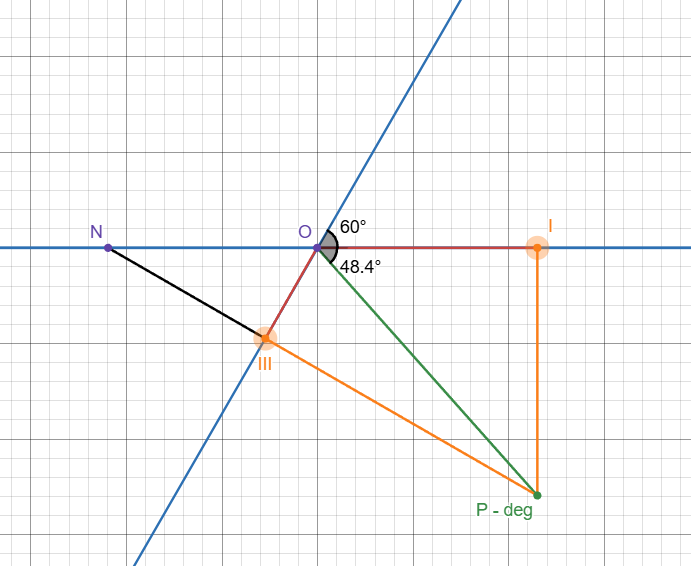

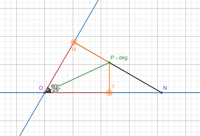

We select two representative cases to perform geometric reasoning
and draw diagrams for reference: Desmos Geometry - ECG Axis Calculation trdrfbhqzv
Red line: SI SIII Black line: Reverse extension line Green line: Intersection point and line connecting the center of the electrocouple.
Define point I as A and point III as B.
Case A: No axis deviation
. Extend PIII to intersect line IO and point N.
∵PB⊥OB, ∠NOB = ∠ = 60° deg
∴∠ONB = 30°
deg Also ∵∠NBO = 90° deg
∴NO = 2SIII
∴NA = 2SIII+SI
∵∠NAP = 90° deg, ∠ONB = 30° deg
∴PA =
∵∠NAP = 90° Therefore
, the electrocardiographic axis =
Case B: The electrocardiographic axis is deflected to the left, and the
extended BP intersects the branch I and point N.
Since ∠BON = 60°, ∠OBN = 90°,
∠BNO = 30°
. Therefore, in △NBN, ON = 2SIII.
  In △PAN, PA = NA/√3.
Since NA = ON - OA = 2SIII-SI
, PA = ∠PAO
. Therefore, in Rt△PAO, ∠PAO = 90°
For the other two possible cases, we can take the opposite of the sum of the two areas and transform them into the above two cases based on the mathematical thinking that vertical angles are equal. Isn't that interesting?
The corresponding calculations are as follows:

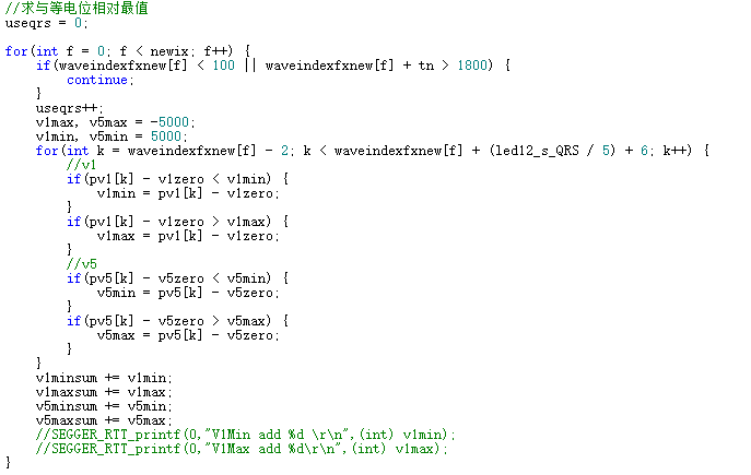

and analyze the R/S wave voltage in the chest leads.
RV5+SV1 and RV1+SV5 are important tools in ECG analysis. This system can analyze the voltage levels of the left and right ventricles, providing guidance for the diagnosis of myocardial infarction, hypertensive heart disease, ventricular dilatation, ventricular hypertrophy, and pulmonary hypertension.
First, calculate the equipotential value two units to the left of the QRS endpoint
and average it. Then, calculate the maximum and minimum values ​​relative to the
equipotential value. Finally, calculate the average voltage value and take the absolute value. Convert the recorded values ​​(units) to voltage values ​​(mV)
to complete the calculation .

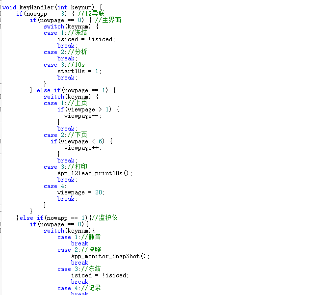

Software Description:

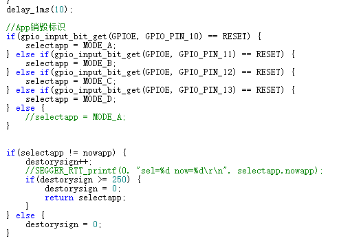

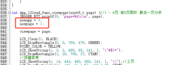

Due to the extremely limited on-chip resources of the microcontroller, we abandoned the resource-intensive FreeRTOS and LVGL, and used a bare-metal + LCD drawing library to complete the design.
Since our application design involves switching between two apps and multiple interfaces, we used the method of substituting the return values ​​of the apps or interfaces into the decision-making process to achieve switching.
Thus, only a string of characteristic code needs to be returned in the app function, and the manager can switch to the specified app or interface.
We use a rotary switch as the app switching mechanism. We destroy the current app switching by reading the switch and accumulating a flag.
When an inconsistency is detected between apps, the accumulated flag is activated, destroyed, and switched after reaching a certain value, with the flag returning to zero. If the gear switch returns to the current App, the identifier resets to
zero. In complex systems like this, mechanical buttons cannot afford to make any mistakes. For mechanical buttons, we use the button function decision function in the interrupt call manager to determine the function based on the App and page identifiers.
Of course, an identifier needs to be set when the App or page is invoked
so that the entire scheduling system can operate smoothly and maintain long-term stability. Moreover, the bare metal interface significantly improves system stability compared to RTOS, preserving more resources.

Q: Can you sell the whole device?
A: I'll sell it to you after I get the utility model patent certificate, medical device registration certificate, medical device production license, and medical device business license (the three medical device certificates).

Q: Which interface of the lead cable and pulse oximeter clip should I choose?
A: 5-lead 6-pin monitoring lead cable, D-Sub 15-pin 12-lead lead cable, 5-pin (AC type) pulse oximeter clip, see the interface on the side of the display picture.
