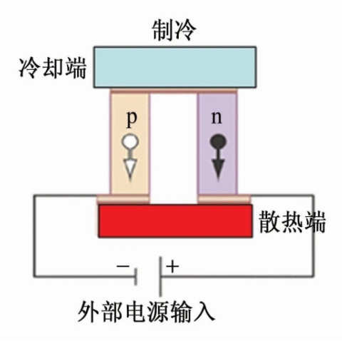

In the sweltering summer heat, what's the best way to beat the heat? A refreshing ice-cold drink is the ultimate answer! Now, the Little Arctic Ice Cup is here, bringing you an unprecedented cooling experience.
Utilizing semiconductor cooling technology, the Little Arctic Ice Cup offers portable and rapid cooling, allowing you to enjoy a refreshing drink anytime, anywhere. Whether it's iced cola or iced coffee, Little Arctic can handle it all with ease.

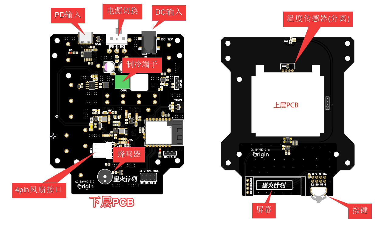

PCB Preview

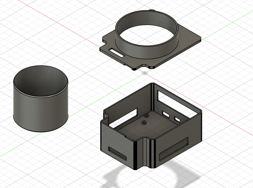

3D Shell Preview

Functional Description
: PD Input: ≥65W
DC Input: 12V~15V
Operating Current (Sample): ≤3A
Cooling Power Consumption (Sample):
Heat Dissipation Current (Sample): ≤200mA

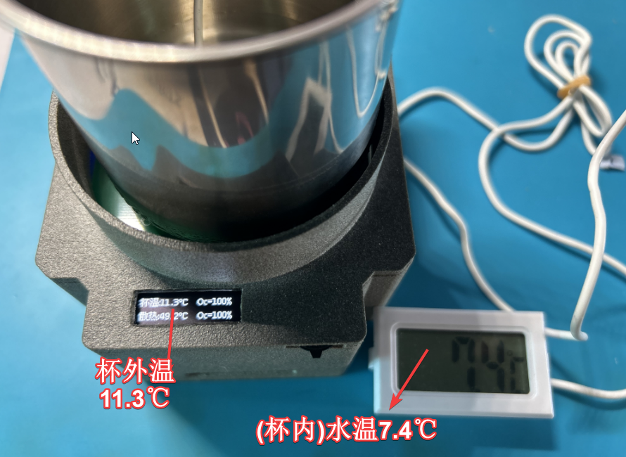

Minimum Unloaded Temperature (Sample): -5℃
Minimum Loaded Temperature (Half Load): +7℃
Minimum Loaded Temperature (Full Load): +12~+15℃
Note 1: The highest measured temperature of the copper sheet at the heat dissipation outlet during cooling can reach 53℃. The temperature is very high, but not enough to cause burns. You probably wouldn't touch it directly, right? Please be careful when using it!
Note 2: Cooling temperature is affected by factors such as environment, conductive medium, voltage, current, and cooling plate power. The tested sample is for reference only! Tip
1: Temperature conduction material of metal cups: Gold > Silver > Copper > Iron
Tip 2: Water heat absorption characteristics, measured cup temperature > actual water temperature error ≈ 2℃. For example: cup temperature 11.4℃, actual water temperature is 9.5 degrees Celsius. As shown in Figure

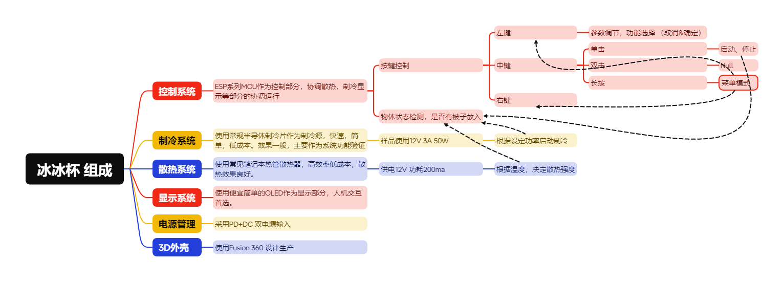

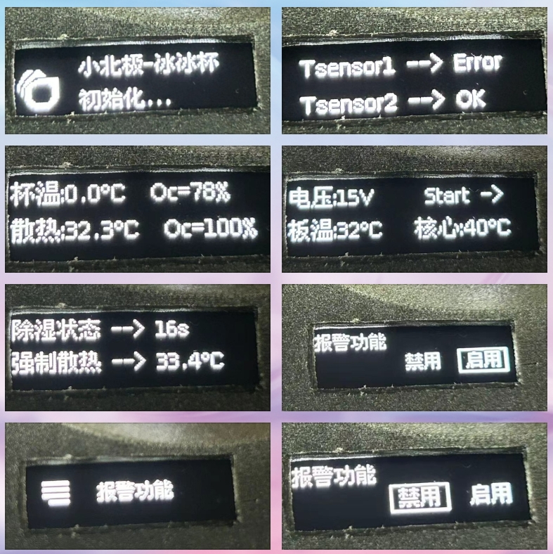

Function Description
: Supports cooling power adjustment ✓
Supports PWM intelligent heat dissipation control
✓ Supports cup placement detection ✓
Supports PD and DC dual power input ✓
4-temperature detection: environment, chip, cooling, heat dissipation ✓
Temperature reminder (under development)
Temperature and status display ✓
Remote monitoring and control function (under development)
Menu function control: buzzer, alarm, power (supports power-off storage) ✓
Button logic control ✓

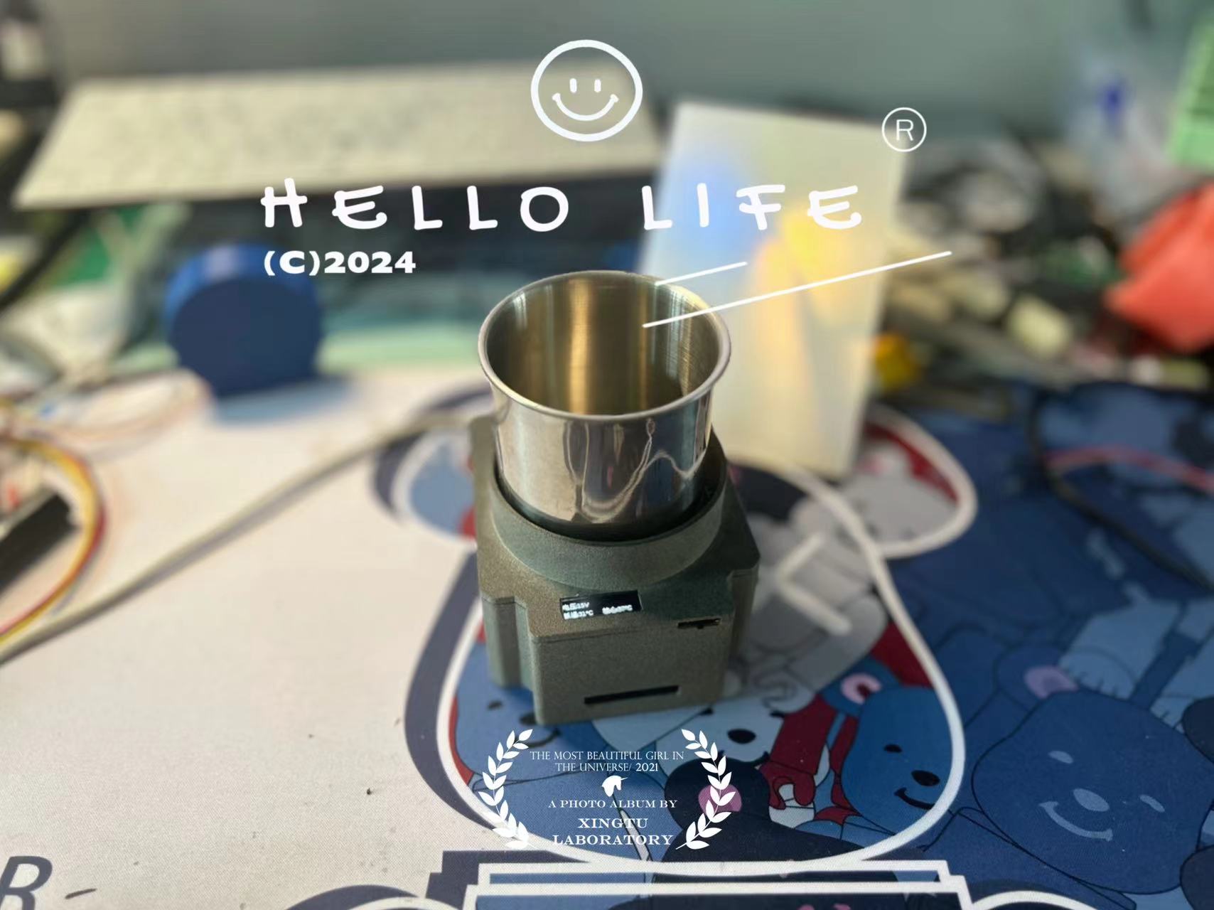

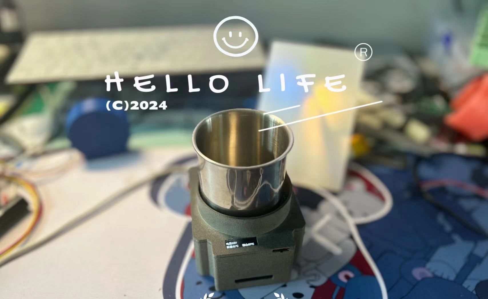

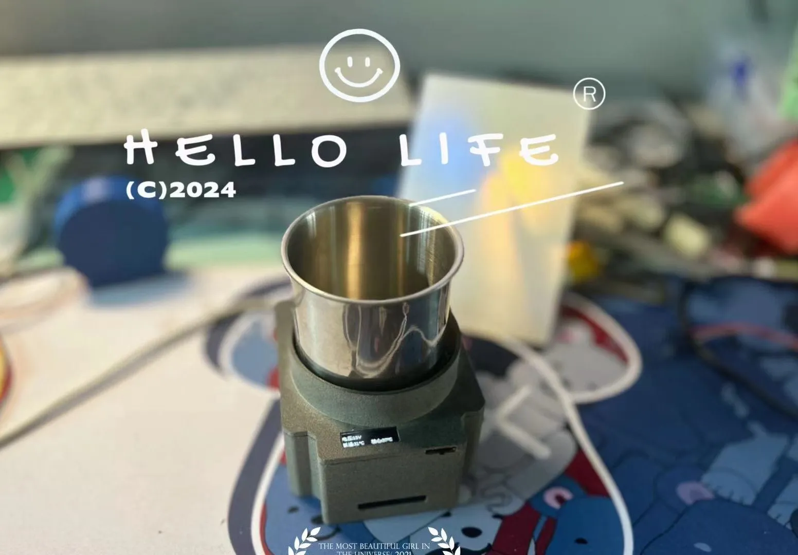

Physical demonstration of
the human-computer interaction

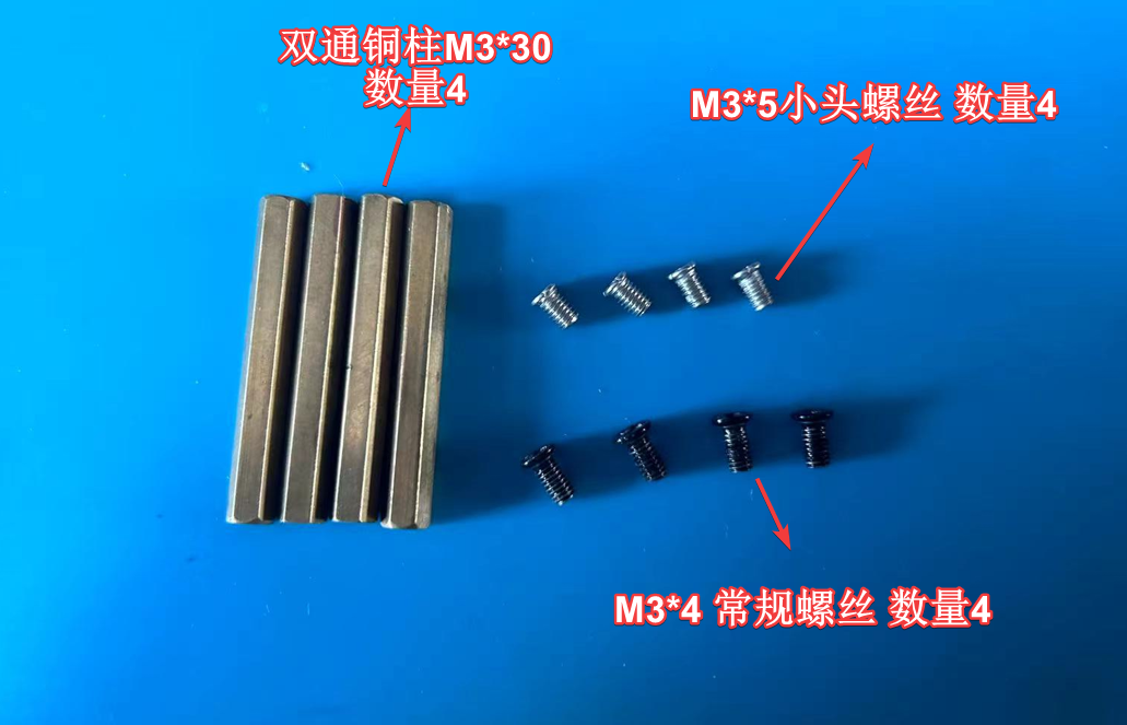

product assembly and accessories.
The overall hardware and software functions normally and have been verified. Further details will be updated later. ...
Related accessory assembly materials are being compiled and will be uploaded later. ...

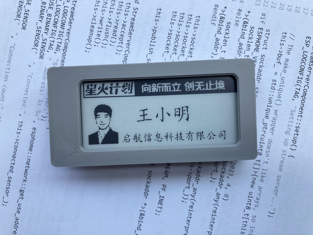

Project Functionality: The name
tag uses an e-ink display, showing the meeting name and personal information on the
front. Each name tag has a button; pressing it displays a QR code, which can be scanned to input relevant information (name, organization, photo, etc.). Releasing the button restores the displayed meeting name tag content .
Staff can pre-enter attendee information, scan the name tag directly, or allow users to enter information themselves.
Due to the uniqueness of the displayed QR code, future development can include functions such as meeting accounting.
The back of the name tag has a magnetic clip for attaching to clothing. Project Attributes:

Physical Display
