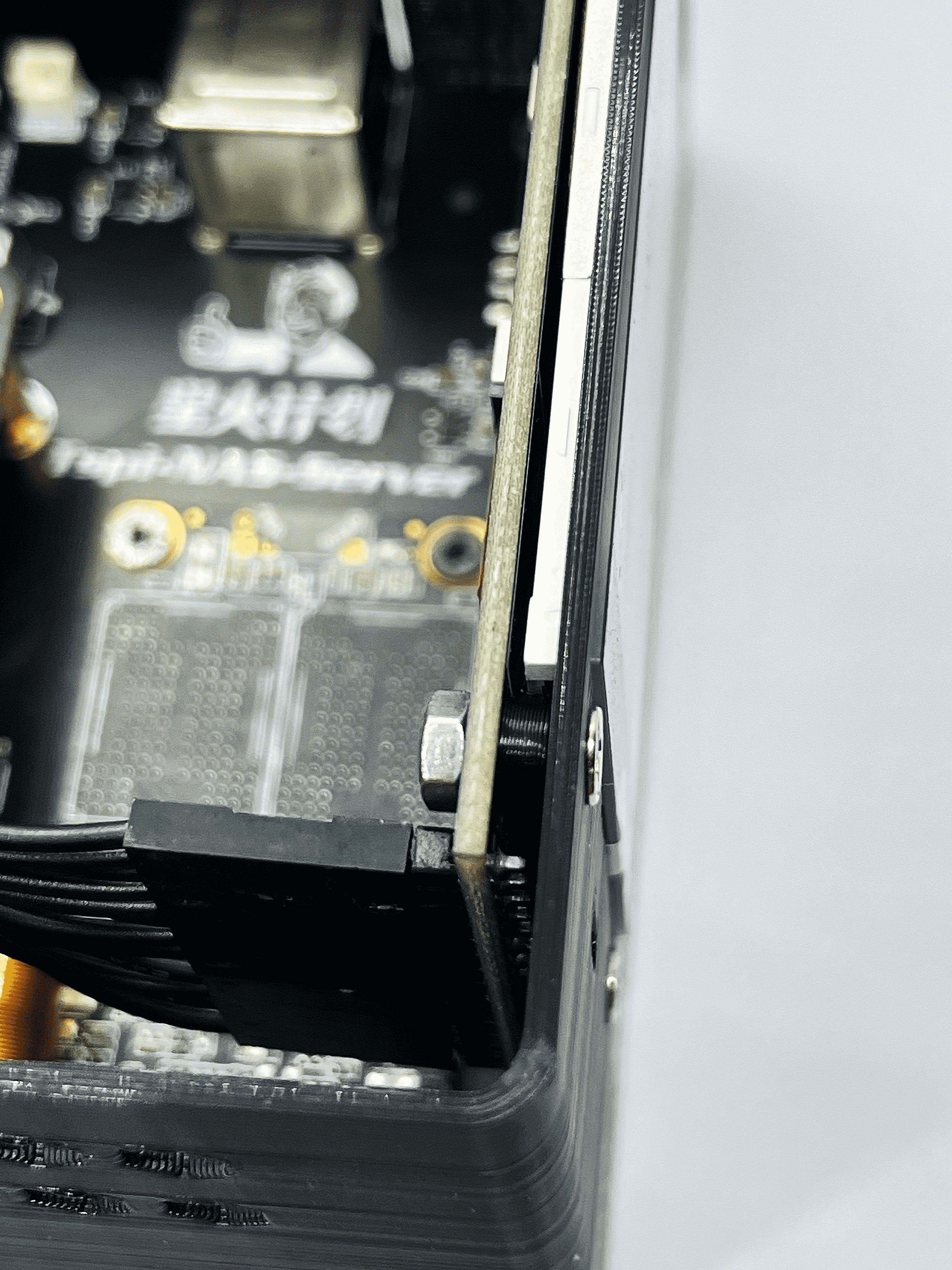

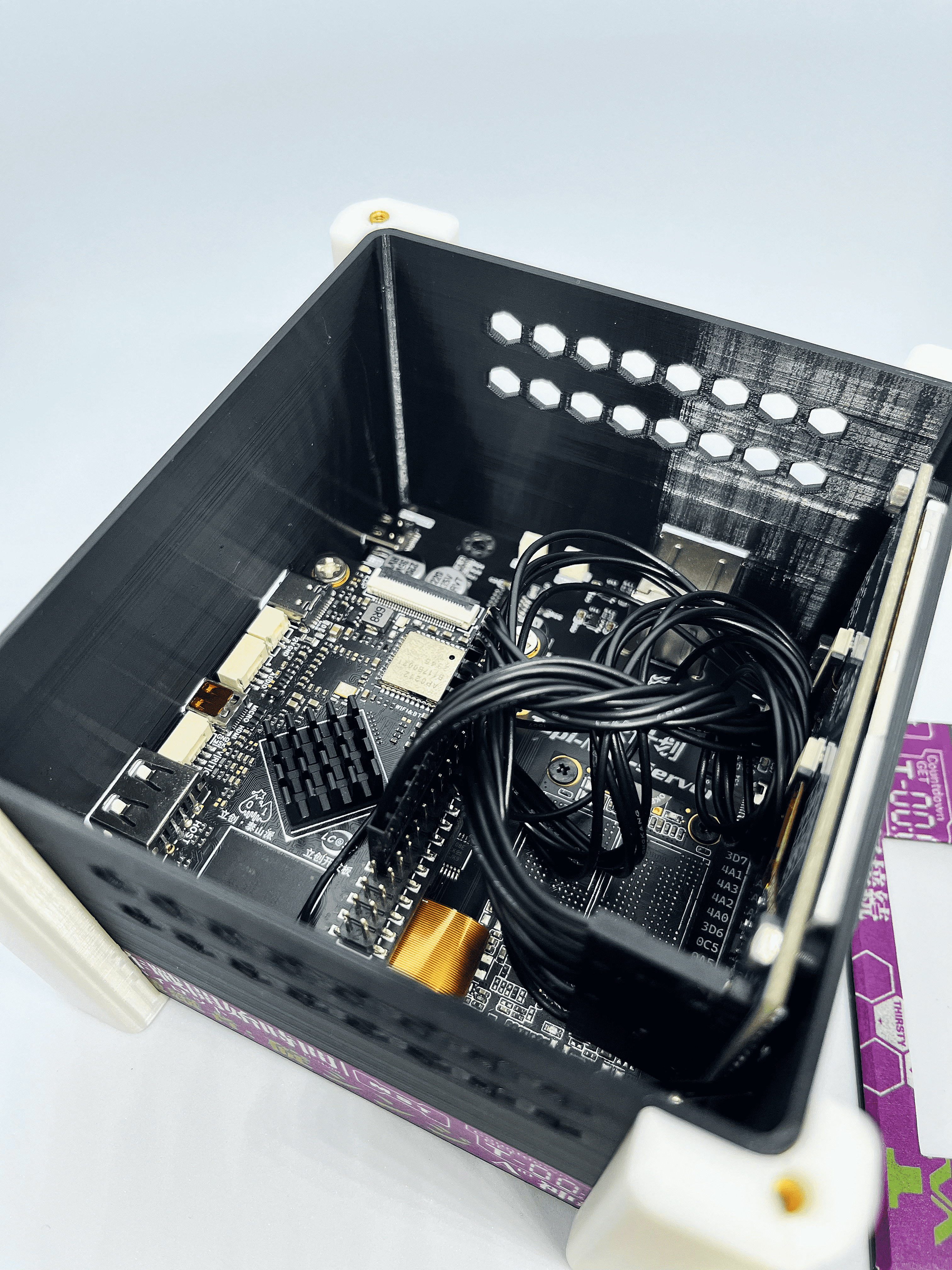

3.5

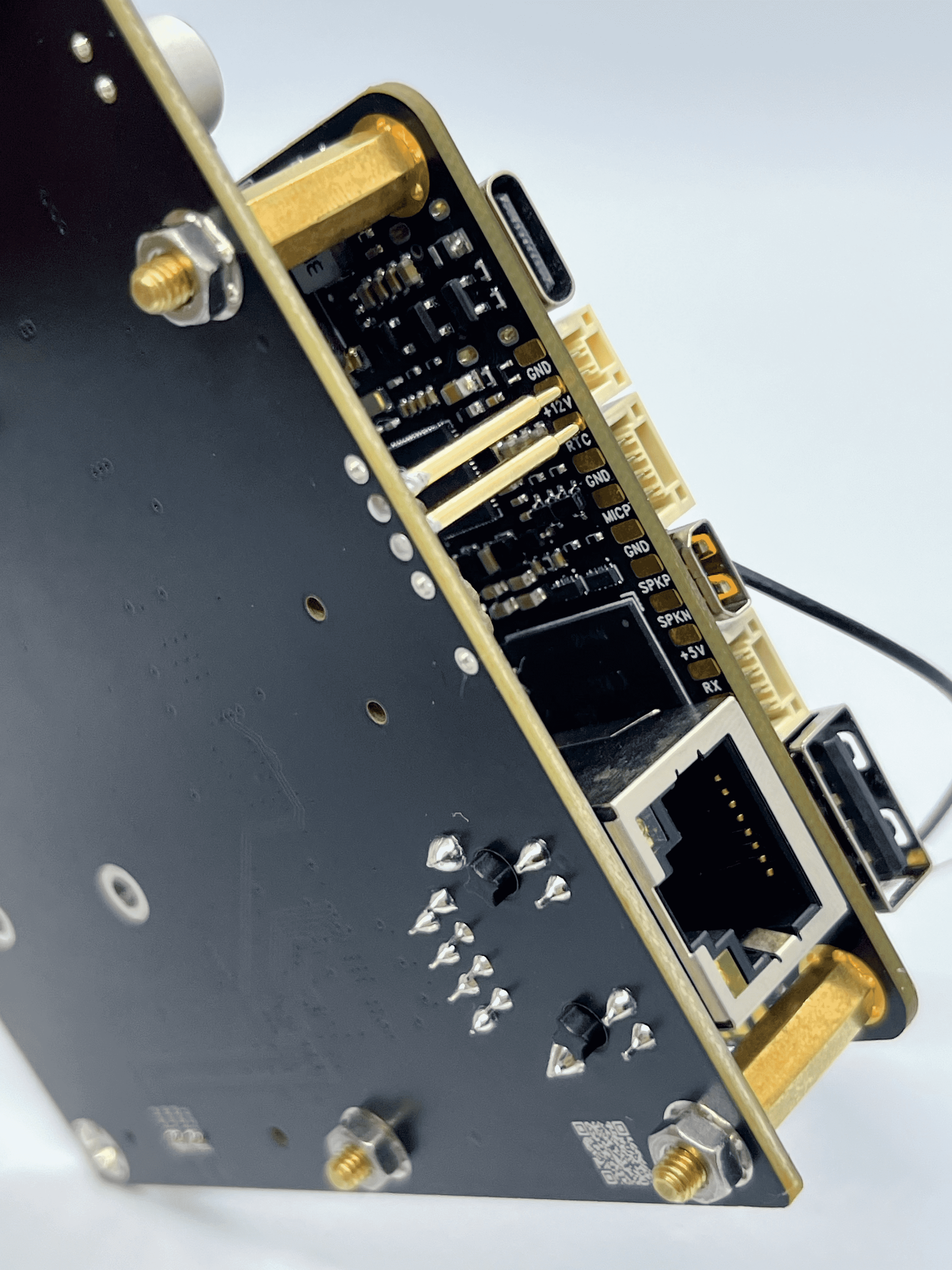

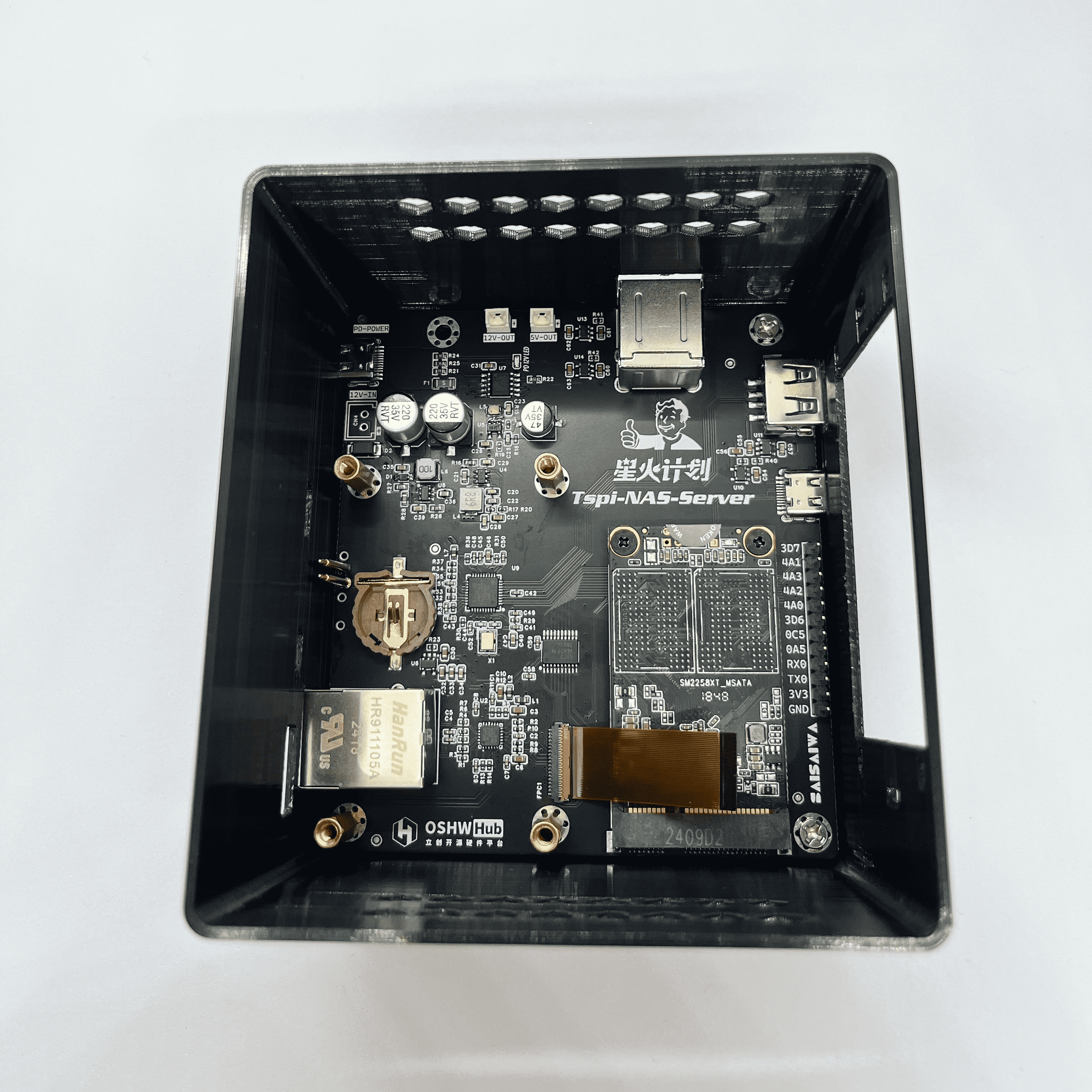

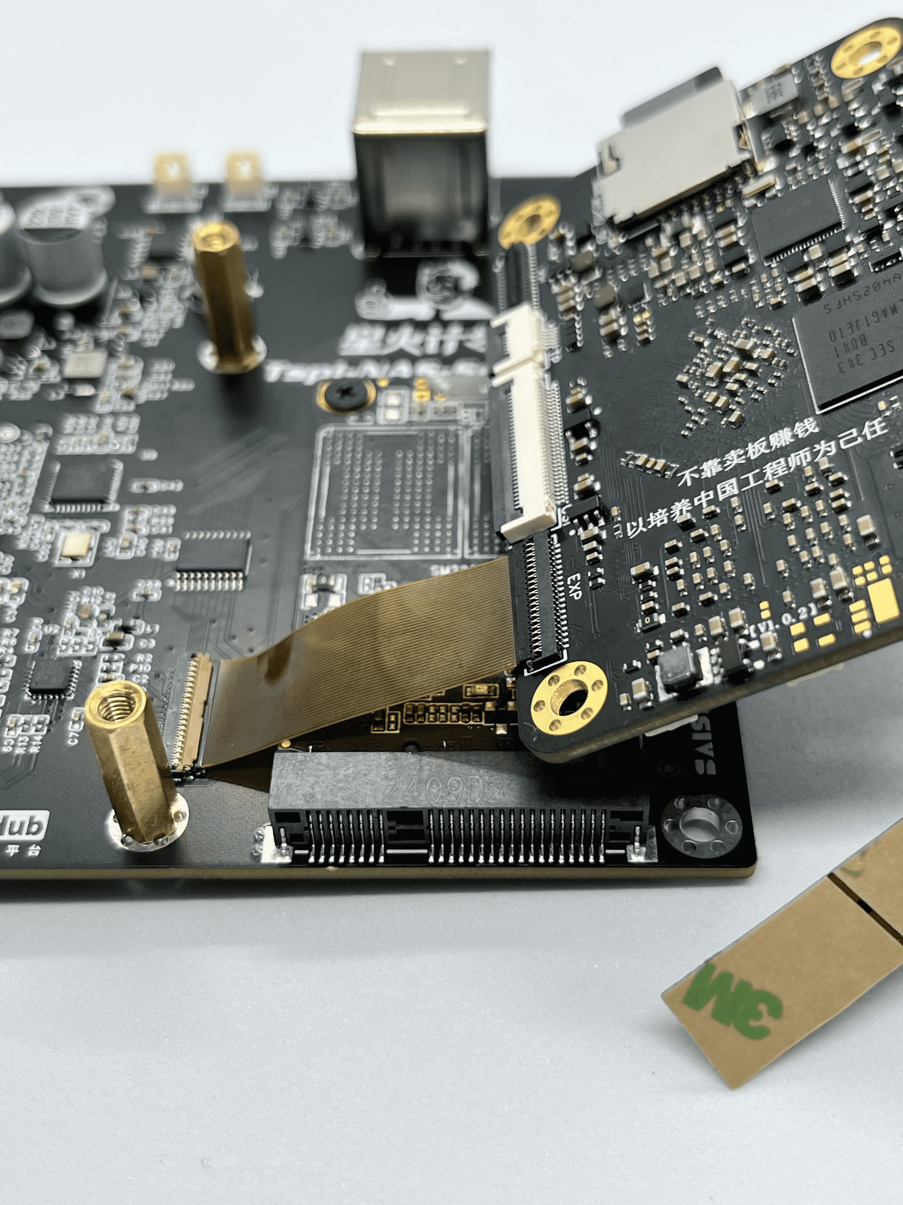

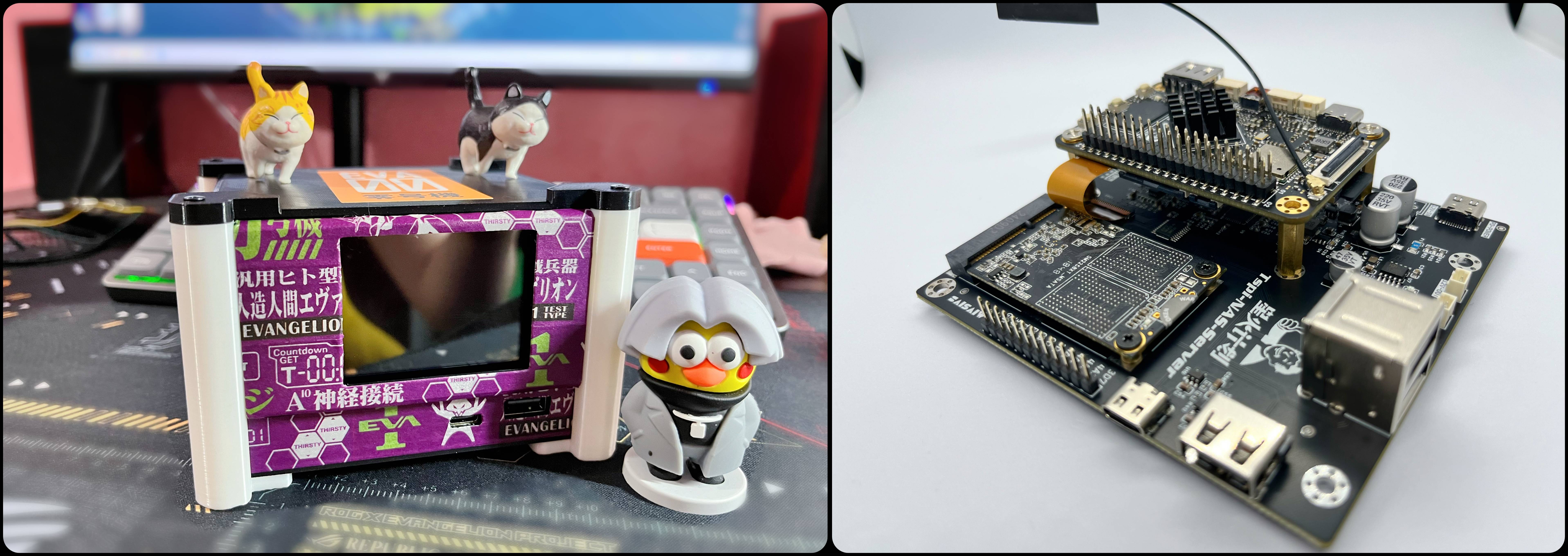

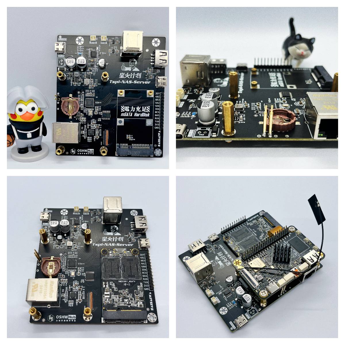

The PCB hardware for expanding peripherals uses the Taishanpai development board as the main controller, working in conjunction with the baseboard to achieve expansion functions.
A 100Mbps Ethernet PHY chip was chosen (simple wiring and design). A gigabit version is also available, but due to SATA issues, this version was omitted. For gigabit conversion, please refer to the development notes.
It supports mSATA slot SSDs, supports half-height and full-height
PD power supply with a maximum 12V trigger, and has a built-in 12V boost regulator circuit supporting 5V power supply . It
supports external DC-DC adapter power supply, with a PH2.54 connector (without fuse) allowing switching
between PH2.0 connectors for 5V and 12V power supply. It supports external fan power supply or RGB power supply, etc.
Due to the use of the 100Mbps RMII protocol, many I/O ports are freed up from the EXP interface. The board provides 10 expansion I/O ports via headers,
supports USB 2.0 hub expansion, three USB A ports, and one USB C port expansion. An
RTC battery can be added
. For more design details, please refer to the development notes; further details are omitted here.

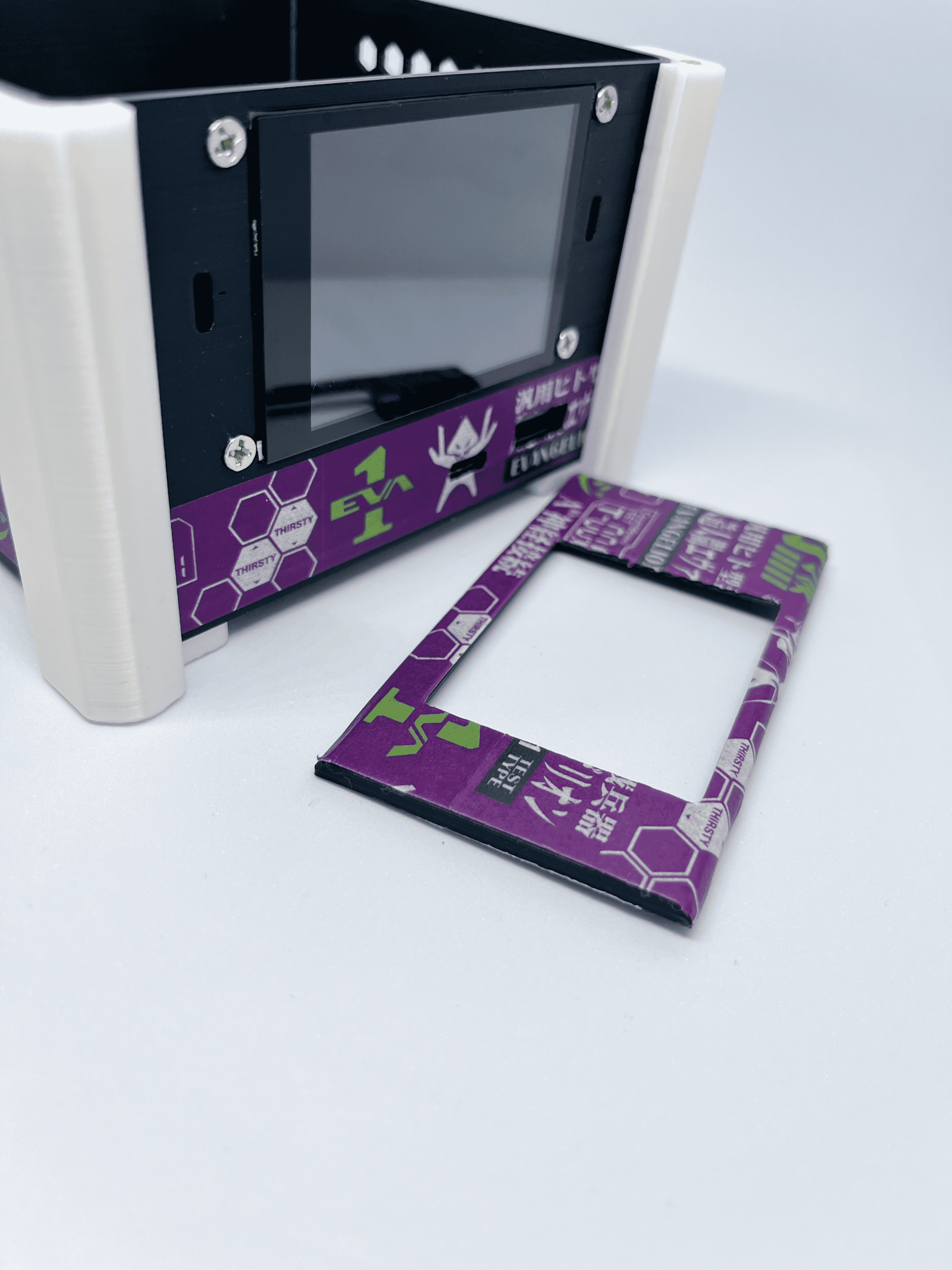

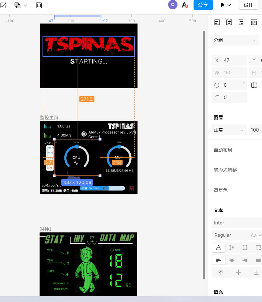

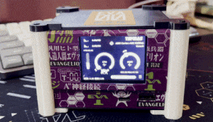

3.6 System Monitor:
Initially, we planned to use analog SPI and I2C to drive the screen, but the speed was too low and the effect was poor. Ultimately, we removed the ribbon cable and brought out the I/O for expansion, choosing to use hardware SPI to drive from the top I/O port of the Taishanpai (a component).
We await someone to modify it to use MIPI .
A 2.4-inch TFT capacitive touchscreen module is used as the display component .
The software is built using LVGL9.1 and
supports system monitoring: uplink and downlink network speed monitoring, storage size and usage, CPU temperature, CPU usage, and memory usage.
Left and right swipes switch display content. A desktop real-time clock (Fallout Shelter) and a game-style UI theme are available; design materials can be obtained upon request. 4. Material Specifications: This project used JLCPCB's SMT (first-time experience, excellent results!), so the BOOM description at the bottom contains actual material parameters. The table below will specifically describe material information not included in the BOOM. Item No. | Item Name | Purchase Link 1 | 39-pin Flexible Flat Cable, 0.3mm Spacing, Same Direction, 30mm Length | https://item.taobao.com/item.htm?_u=n1v3prvpbb4a&id=589957580932&spm=a1z09.2.0.0.3df52e8dU9geH7 2 | SATA Soldering Copper Pillars: M2x3x4 3 | POGOPIN: 16.0MM | https://item.taobao.com/item.htm?spm=a1z09.2.0.0.67002e8dowsFnW&id=587069006439&_u=n1v3prvp9c8a 4 | M3 Copper Pillars: M3x15+6 5 | Injection Molded Hot Melt Copper Nuts M3: M3x4x4.2 https://item.taobao.com/item.htm?spm=a1z09.2.0.0.67002e8dowsFnW&id=673367228604&_u=n1v3prvpd660 6 M2x10x5 7 Thermoplastic knurled nuts: M2x3x3.2 8 2.4-inch TFT capacitive touchscreen https://item.taobao.com/item.htm?spm=a1z09.2.0.0.17e02e8dAxjxdK&id=748318527653&_u=r1v3prvp465a 5. Software Development Environment Backend Development Language: Java Environment: JDK17 System: Ubuntu, WIN11 Core Framework: SpringBoot3 Database: MySQL8 Frontend Development Language: JS+HTML+TS+CSS Core Framework: Vue3 + Vite Package Management: pnpm UI Framework: Element UI Plus App Language: Dart Framework: Flutter Cross-platform Adaptation: Android + iOS System Monitor Language: C Core Framework: LVGL9.1 Open Source Git Address Server-side Spring Boot Project: https://github.com/ccy-studio/tspi-nas-server Backend Management Page: https://github.com/ccy-studio/tspi-nas-web Flutter Mobile Client: https://github.com/ccy-studio/tspi-nas-app LVGL9.1 Small Screen Monitor: https://github.com/ccy-studio/tspi-nas-lvgl Related Resources NAS System Image update.img Download: https://115.com/s/swzvzer3h3x?password=h990&#Access Code: h990 Accompanying App Client Download (Android only, iOS requires self-packaging and signing): Link: https://pan.baidu.com/s/1VgCXAvpNXgYR71Q-ElzEIw?pwd=3j4i Extraction code: 3j4i Miscellaneous materials download: see attachment at the bottom Reference articles : LCSC official expansion boards and materials: https://lceda001.feishu.cn/wiki/IJtRwVu5kiylHykl3RJcQ8ANncY Ubuntu creation tutorial: https://oshwhub.com/forum/post/a81bfab590fa4d2b9312c95c8c8c3f9b Technical exchange group QQ: 676436122

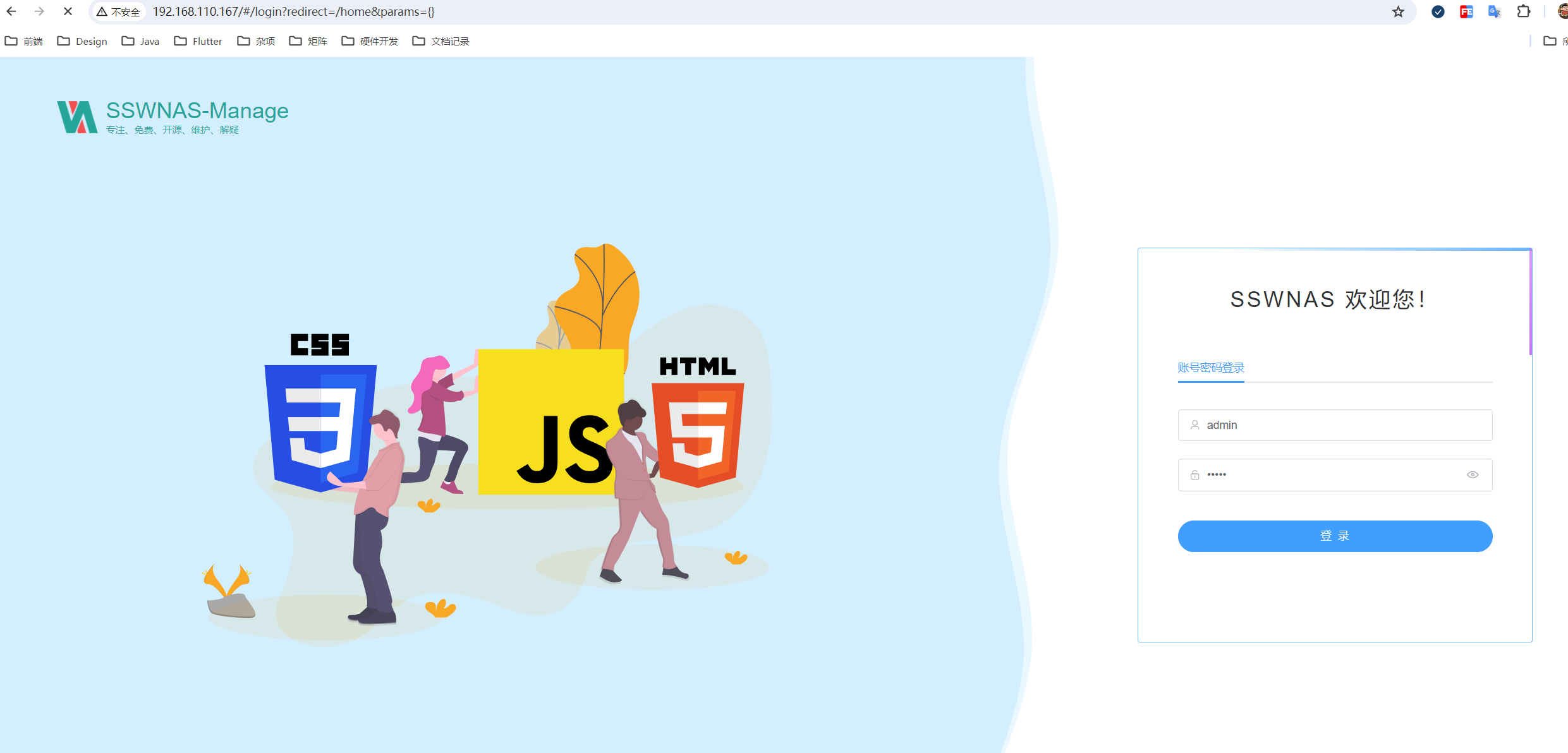

For instructions on using the backend management, please watch the video released on Bilibili.

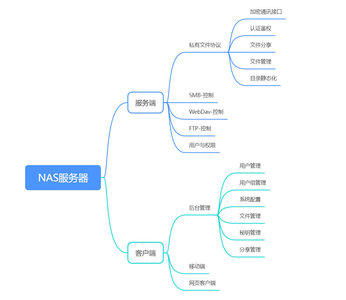

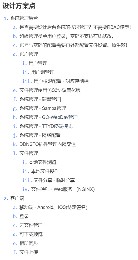

6.1.2 Brief description of the currently implemented backend functions:
The system will be empty upon first use. Please configure basic data before using the system normally.

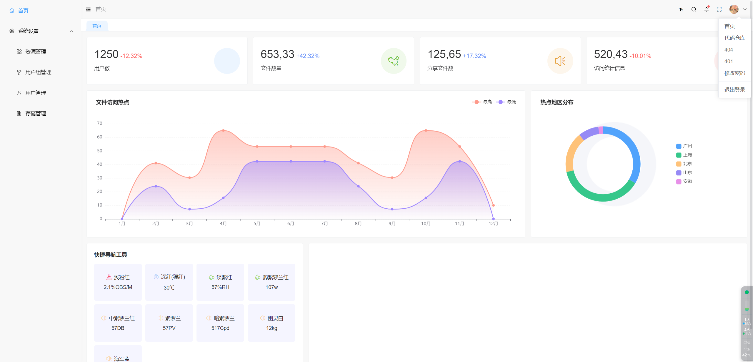

The permission function protects data within device files through access control. You can authorize or cancel ACL access control policies for anyone at will. Specific functions are as follows:
1. Resource Management:
Resource management describes a group of resources, which can include file management for SMB, FTP, and private file protocols. Resource paths typically apply to non-private file protocol resource types. For example, configuring the SMB path as /mnt/ssd/res1 as a resource item.
2. User Group Management:
User group management is used to group a group of users for better management. A user group can be bound to multiple resources, i.e., there is a one-to-many relationship between resources and user groups.
3. User Management:
User management is used to add new user accounts. Users need to be bound to user groups and can be assigned to multiple user groups. Bound users will have access to all resources bound to multiple user groups.

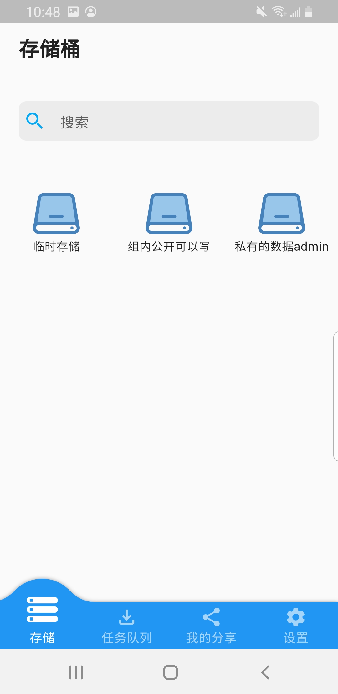

4. Storage Management:
Storage management is used to allocate and manage ACL policies for storage under resources. Root files can be created, similar to disk functionality. Creating a new storage bucket requires binding resources; the binding relationship is one-to-one. The mount path also needs to be described, and subsequent file operations will be performed according to the described mount path. New storage buckets need permissions set, which can be set to private, public write/public read, or private write/public read, and need to be further described in conjunction with the permission scope, such as: private, public within the resource group, or fully public.
5. Storage Management - ACL Policy Management:
You can set more granular permission settings for specific users, collectively called ACL policies (Access Control Lists). ACLs are used to define and manage policies for access permissions to resources, widely used in computer security and network management, to finely control the access permissions of users or system processes to specific resources (such as files, directories, network devices, services, etc.).
To add an ACL policy to a storage bucket, you need to define a target user and set their read, write, delete, and share permissions.
These features allow you to flexibly manage and control access permissions for data within device files, ensuring data security and access efficiency.

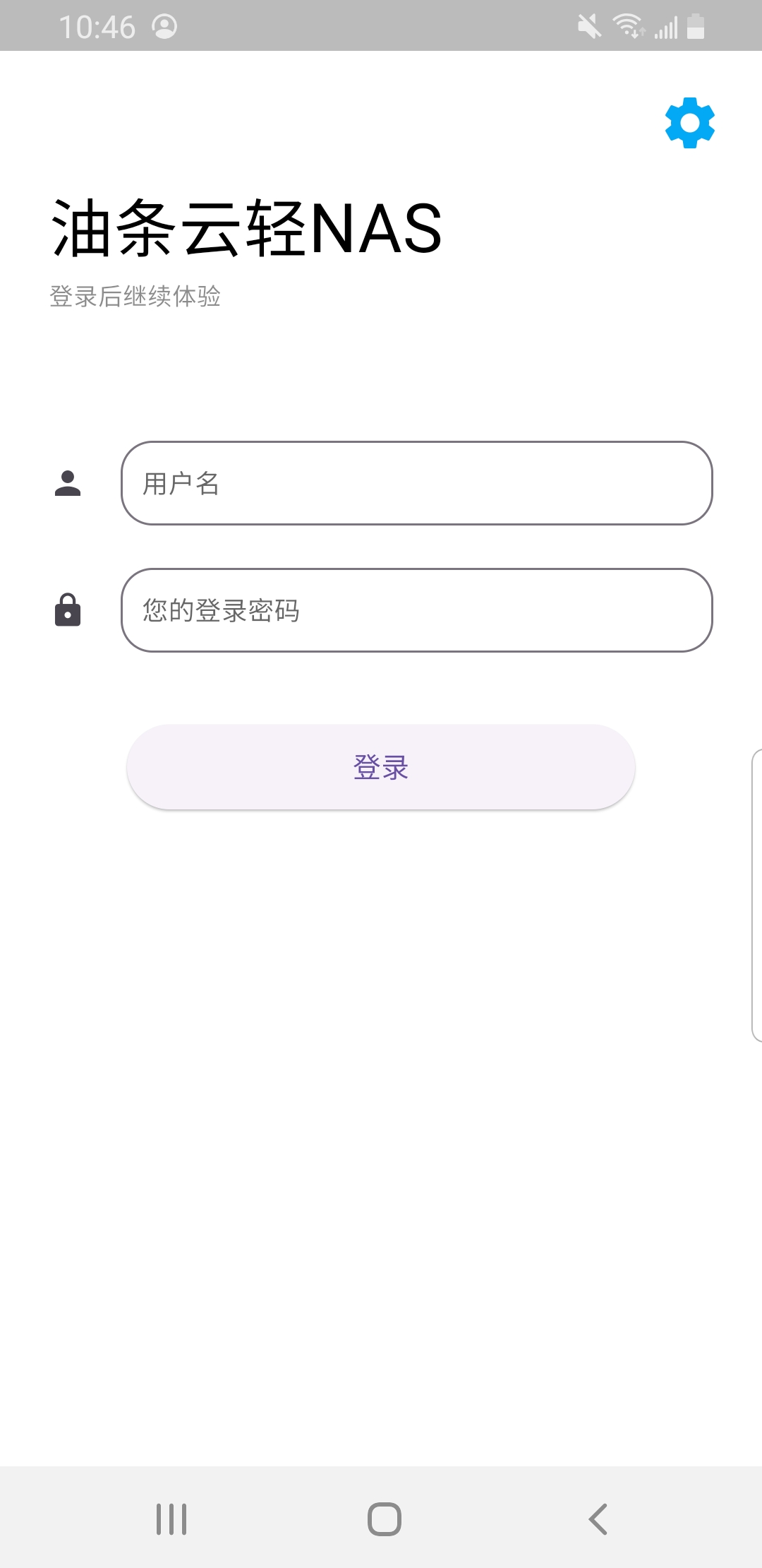

6.2 Client APP

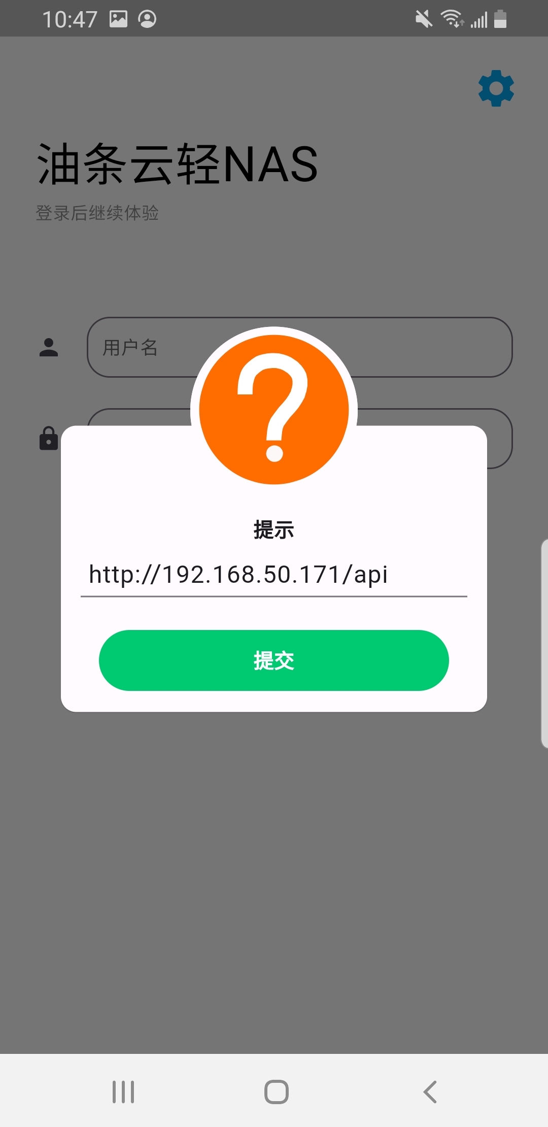

Login Page
Click the upper right corner to configure the server address or domain name backend address (ending in /api)

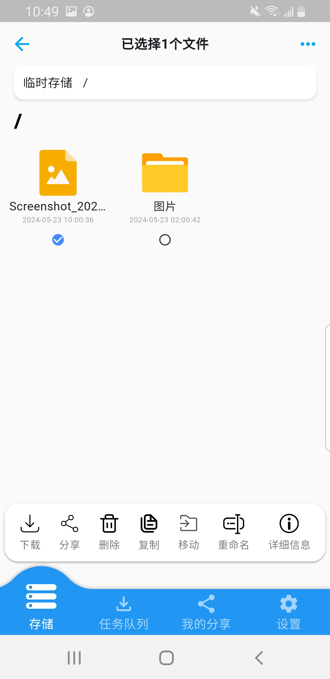

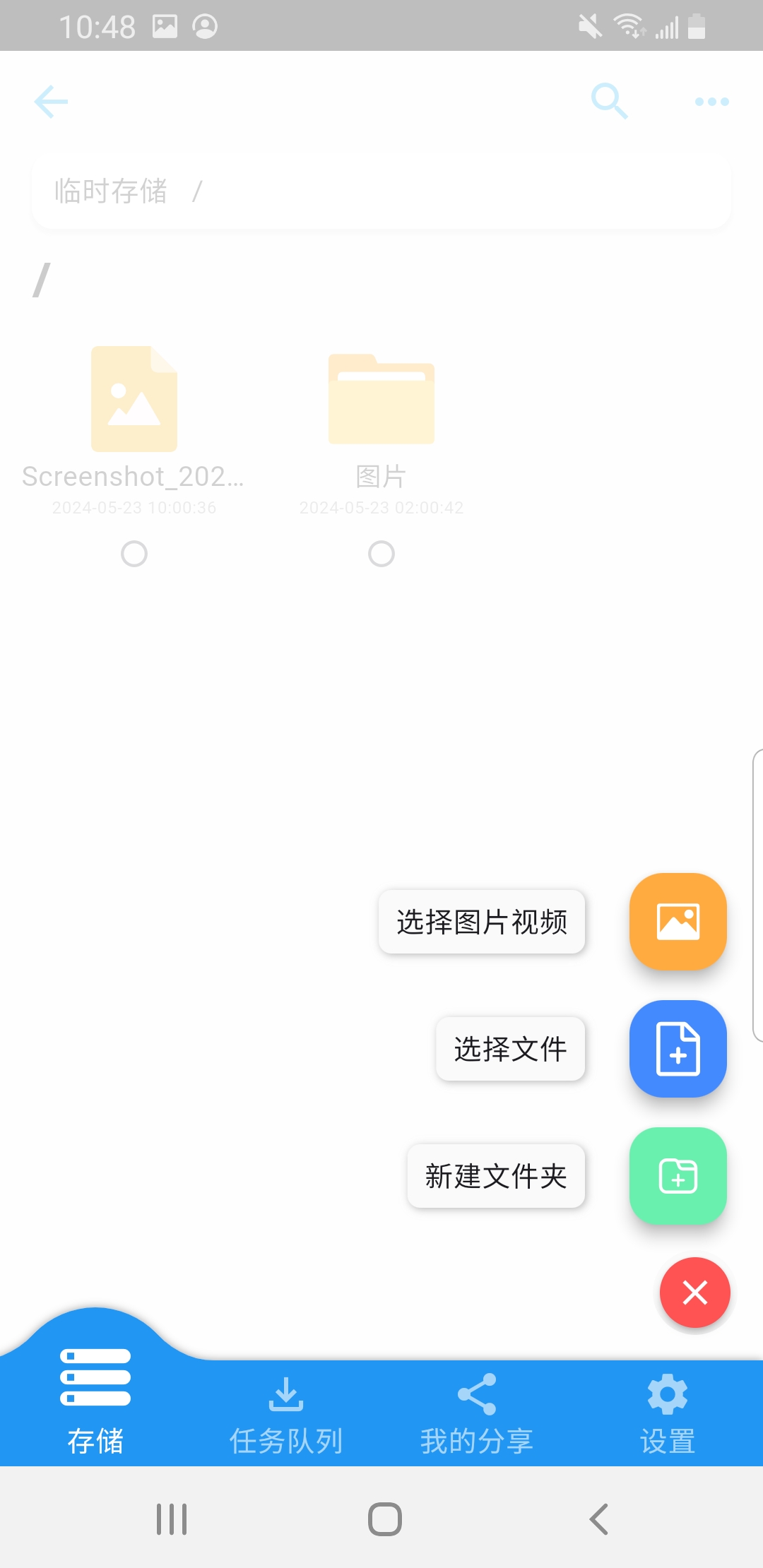

. The main interface displays the storage permissions currently granted to the user .

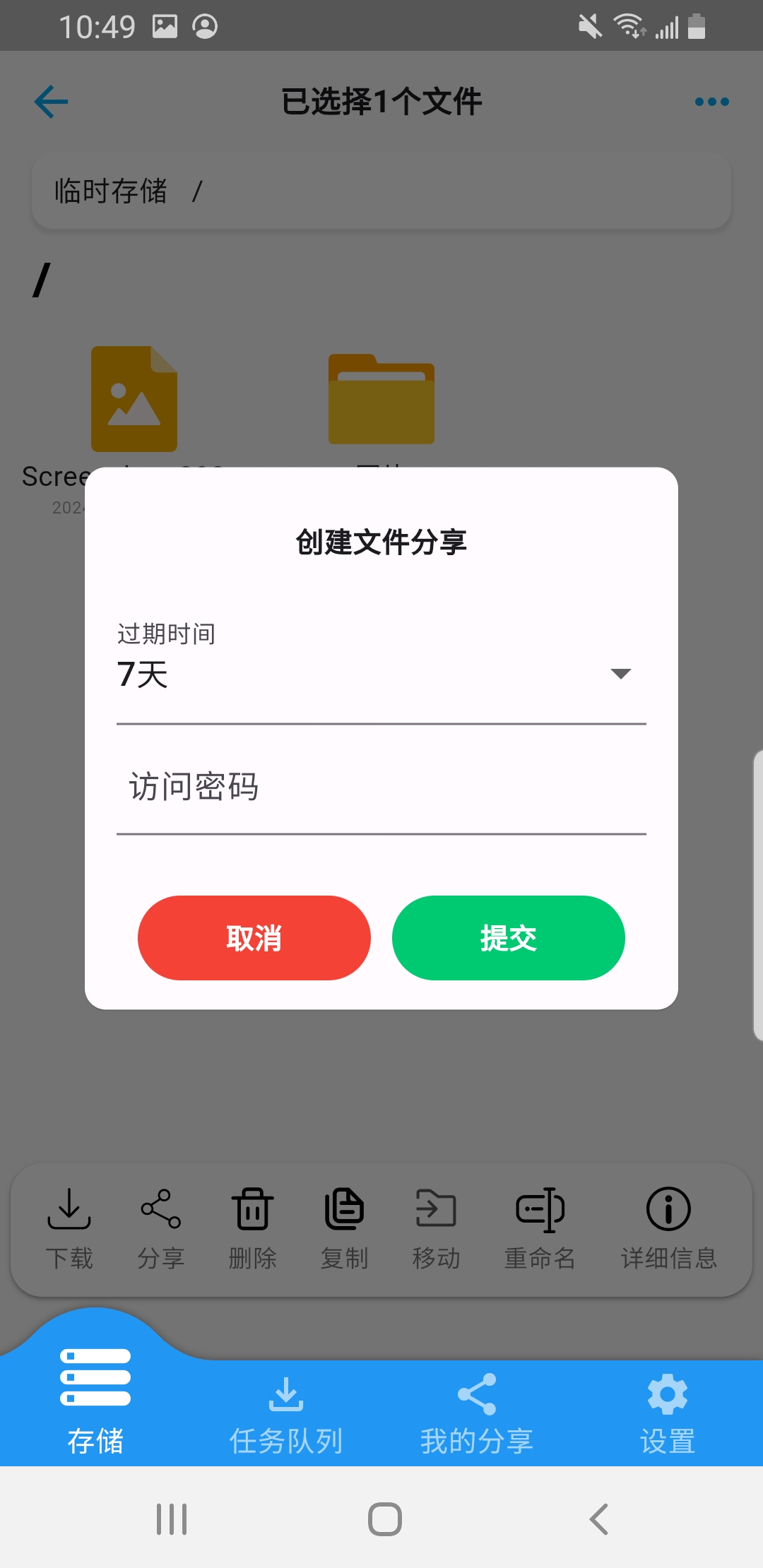

You can create new folders and upload files of any format.
Clicking allows for previewing and performing operations on files: Operation buttons are dynamically displayed based on user permissions
. Create file sharing.

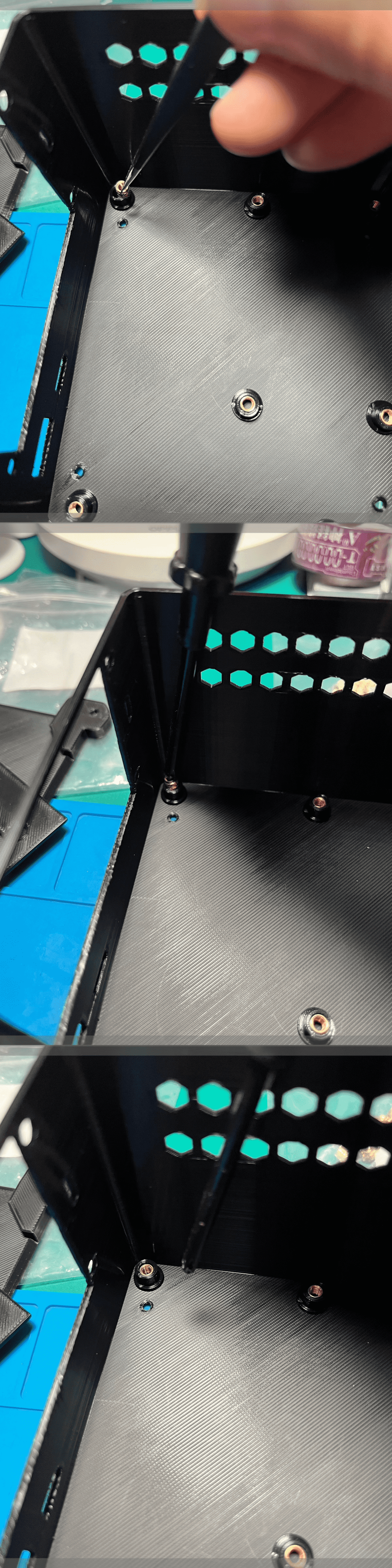

7. Quick Assembly
