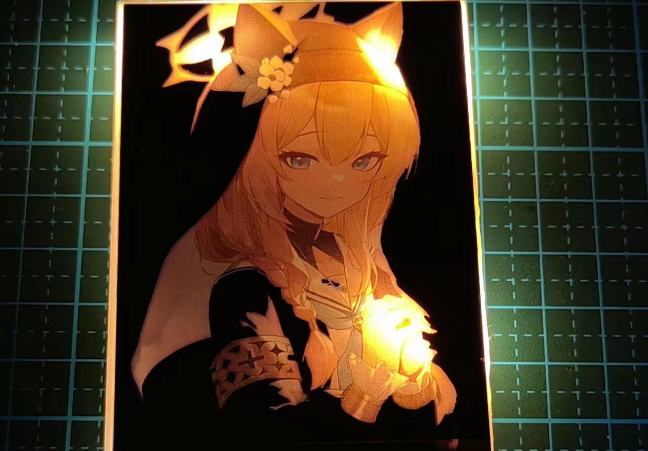

I got a free color screen printing coupon from JLCPCB. Since it was my first time designing an open-source project and I didn't have any good ideas,
I happened to see a picture with nice lighting, so I used it as my
lighting design. The circuit design is the overused TP223 touch circuit, so I won't go into detail; a quick search on Baidu yields tons of diagrams.
The design is very simple: cut out a portrait in Photoshop, place it on the top layer to block the light, and then design a few ceramic lamps for highlight areas on the bottom.
Since the highlights in the original image were already very clear, it was even simpler.
However,
because the ceramic lamps didn't provide enough diffused light, the secondary light-emitting positions weren't really visible. So
I quickly designed a reflective base, focusing on a simple
design. Adding a bottom cover to the printer
makes a big difference. The floodlight is reflected by the white material underneath onto the entire panel, giving the portrait a subtle glow.
The original image and reflective cover are included in the accessories. If you're interested, you can try making a replica.
