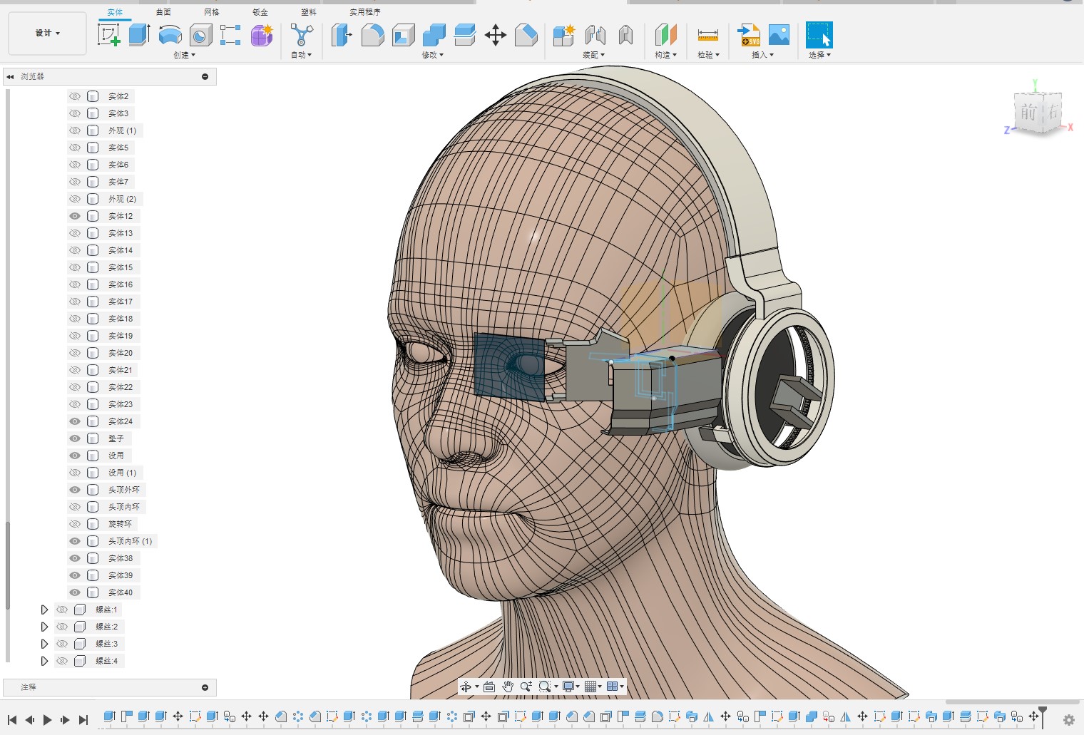

Parallel Project: We will also release an amazing innovation: Headphone-type AR! Why should AR be confined to the form of glasses? Why can't it be made into the form of a monocular lens from "Dragon Ball"? So here it is:
The functions will lean towards "headphone" and "music listening" applications, with a blink sensor (infrared reflection) display effect as shown in the attached video.

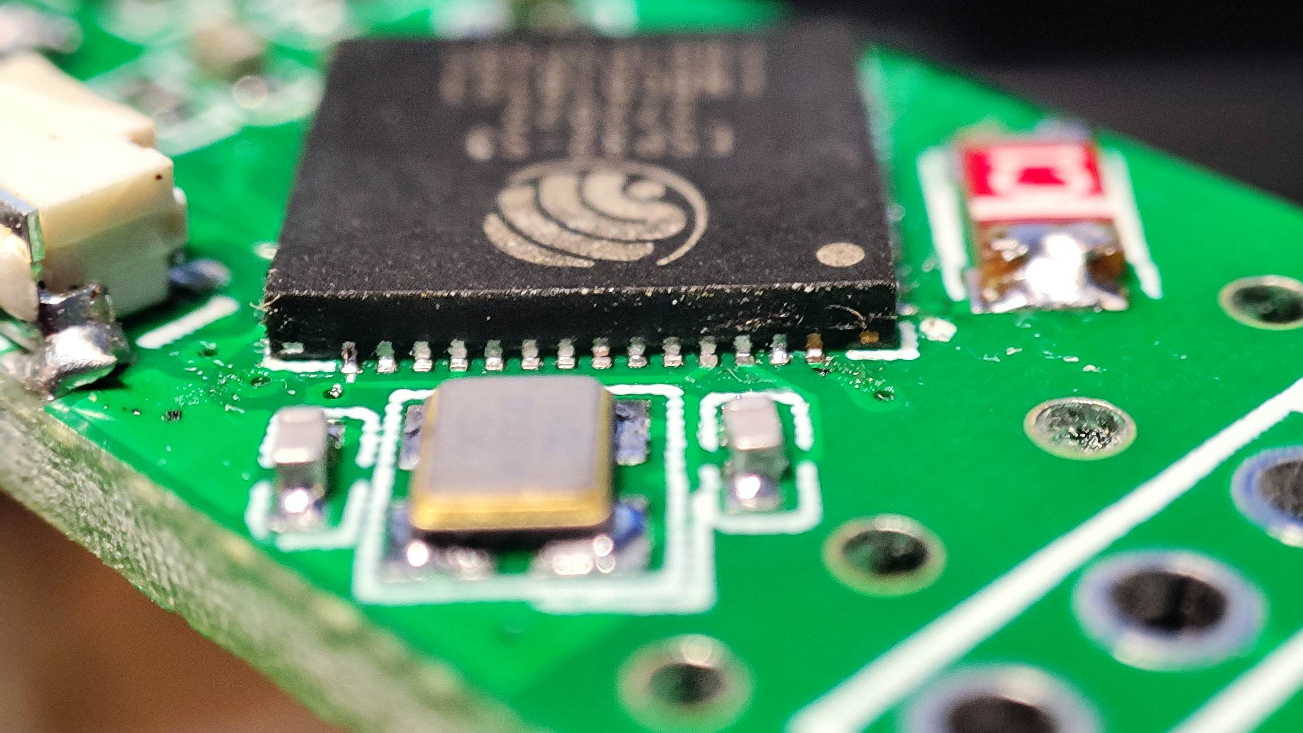

Currently, the circuit board verification is half completed, but there are still some issues with wireless communication.

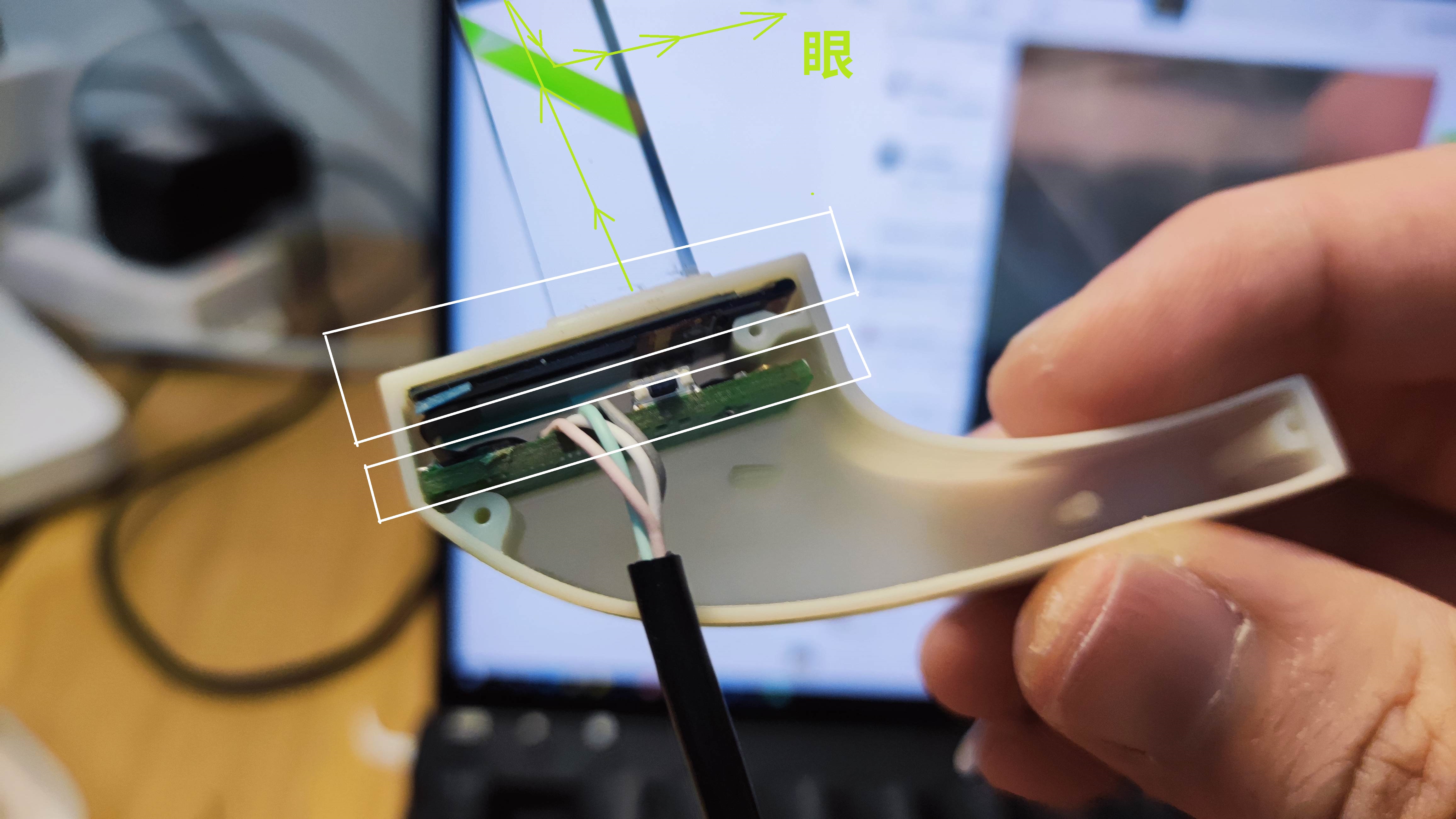

Note: In the design principle explanation of this project
, the white box (top) represents the screen;
the white box (bottom) represents the motherboard;
the empty part is the battery.
The green line represents the optical path. The AR device is only 10mm from the eye, while the eye's closest focusing distance is over 50mm. To achieve image formation at such a close distance, light must first pass through a freeform surface for refraction (similar to the pancake effect or Fresnel effect in VR) and then through a semi-transparent, semi-reflective coating for close-range focusing.

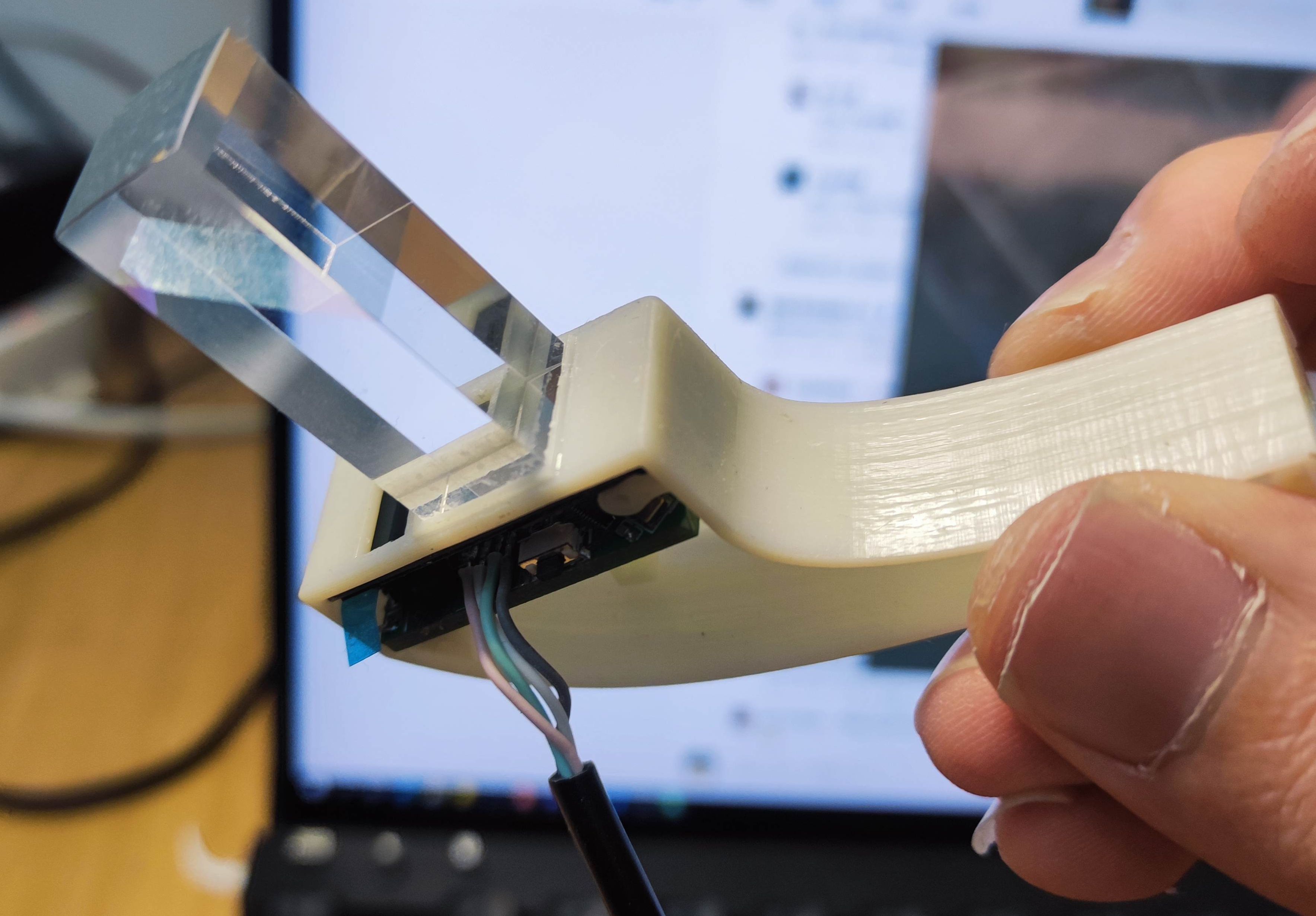

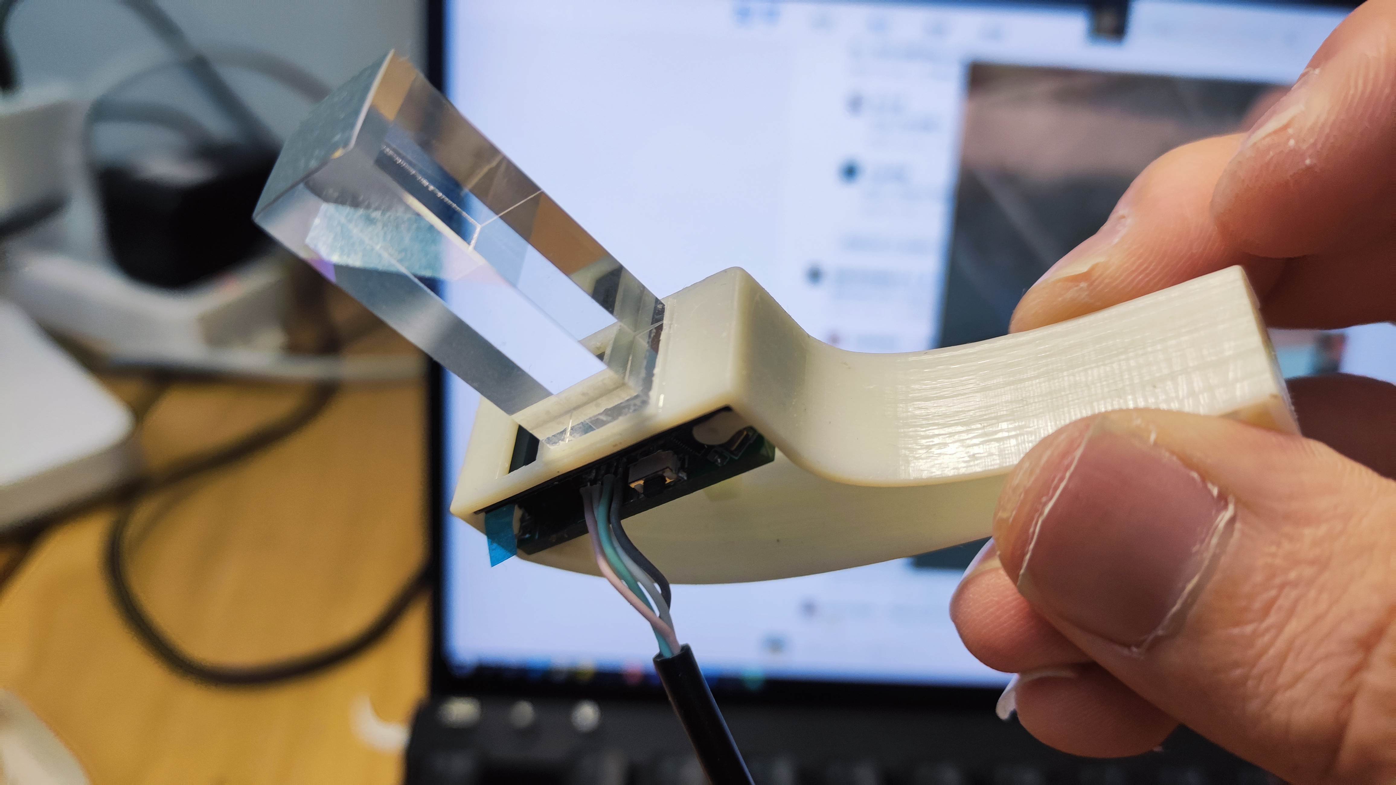

Physical
demonstration: Images of the actual product are provided; descriptions can be added to the images.
