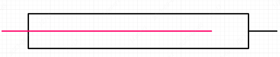

The Geiger-Muller tube (GM tube) is a commonly used radiation detector, primarily used to detect and measure various types of radiation, such as alpha particles, beta particles, and gamma rays. Its structure is simple, consisting of a metal outer shell
(modern Geiger tubes are made of glass tubes coated with a metal film) and an internal gas-filled conduit. Typically, the metal outer shell is cylindrical, usually made of metal or alloy, possessing good conductivity and shielding properties to prevent external interference. The gas filled inside is usually a low-pressure inert gas, such as a mixture of nitrogen and argon. This gas has good ionization and energy transfer properties, producing an effective ionization effect. The
working principle of the Geiger tube is based on the gas ionization effect. The Geiger tube has
a simple structure, typically consisting of a thin metal wire fixed in the center of a metal cylinder. A DC voltage, usually greater than 300V, is applied between the wire and the outer wall. The container is filled with a gas for generating ionization (such as argon) and a gas for quenching (such as butane).
When ions pass through a Geiger tube, they excite a gas atom, causing ionization. The excited electrons, attracted by the positive voltage of the metal wire, collide with other gas molecules, causing avalanche ionization. This process also triggers a larger-scale ionization avalanche through the emitted ultraviolet photons, ultimately forming a current pulse consisting of up to 10 billion electrons. Because of their large mass, the ionized positively charged particles move slowly. After the electron avalanche, they remain in the center of the Geiger tube, forming a positive electron cloud that disrupts the electric field within the tube, hindering further avalanche. The avalanche current is quickly terminated by the combined action of the current-limiting resistor and the quenching gas. After a recovery dead time of 100-500 microseconds, the Geiger tube returns to normal, ready for the next particle detection. In short, a pulse is generated when an ion is detected passing through the Geiger tube.

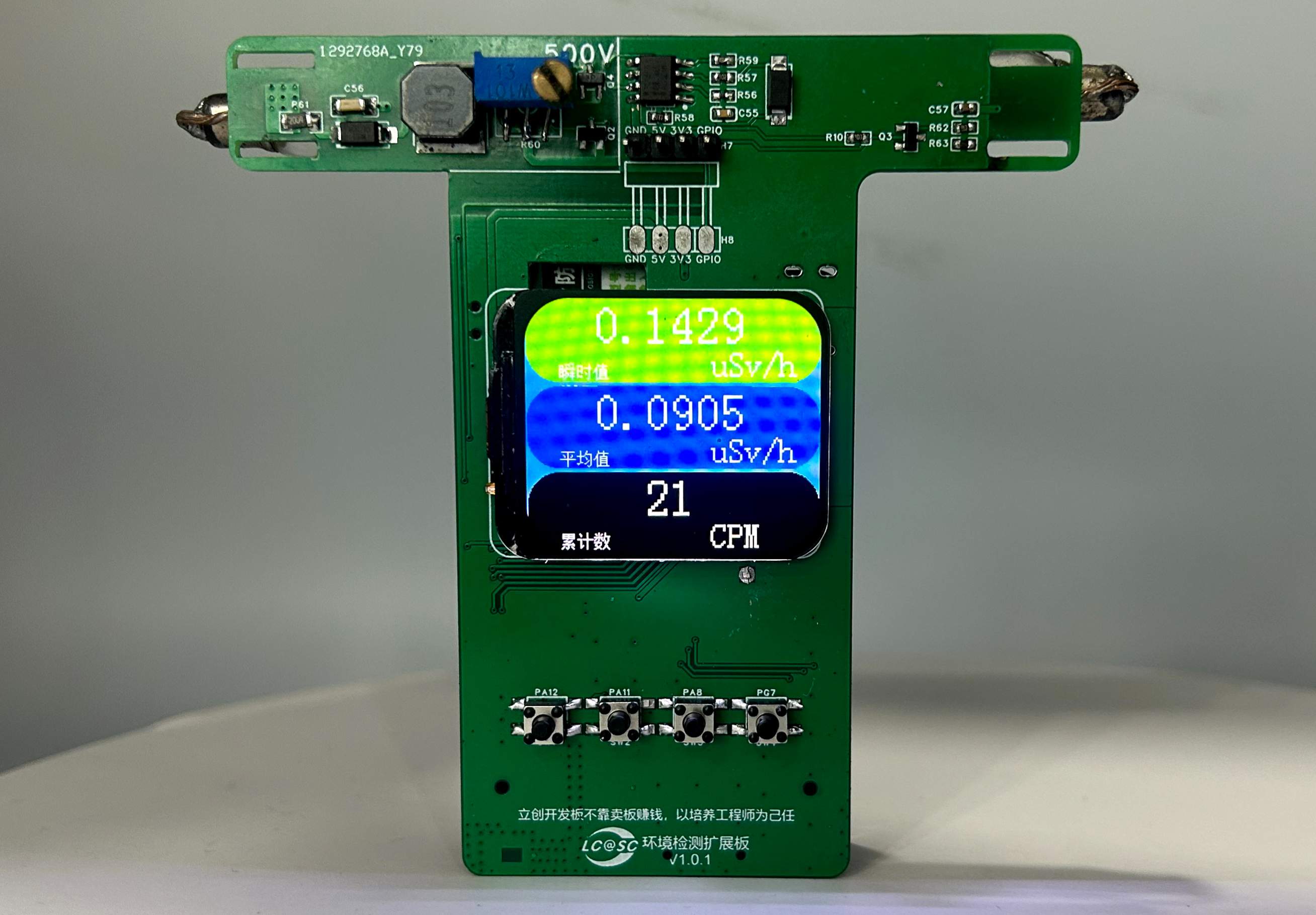

The main circuit design
needs to achieve the following basic functions:
handheld portability;
buzzer alert;
radiation detection display; and
a charging/boost circuit .

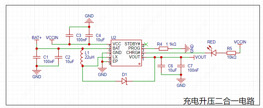

Since it's handheld, it requires battery power.
Under normal circumstances, it's powered by the battery voltage BAT+. When a Type-C port is connected, VCCIN has power, which charges the battery, and the RED charging indicator light illuminates. VOUT is the 5V output voltage boosted from the battery voltage. Please refer to the TP5400 datasheet for details.

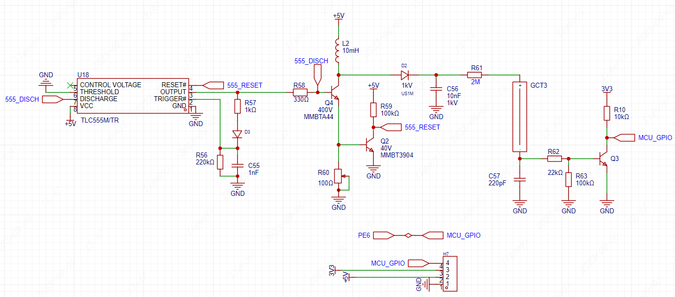

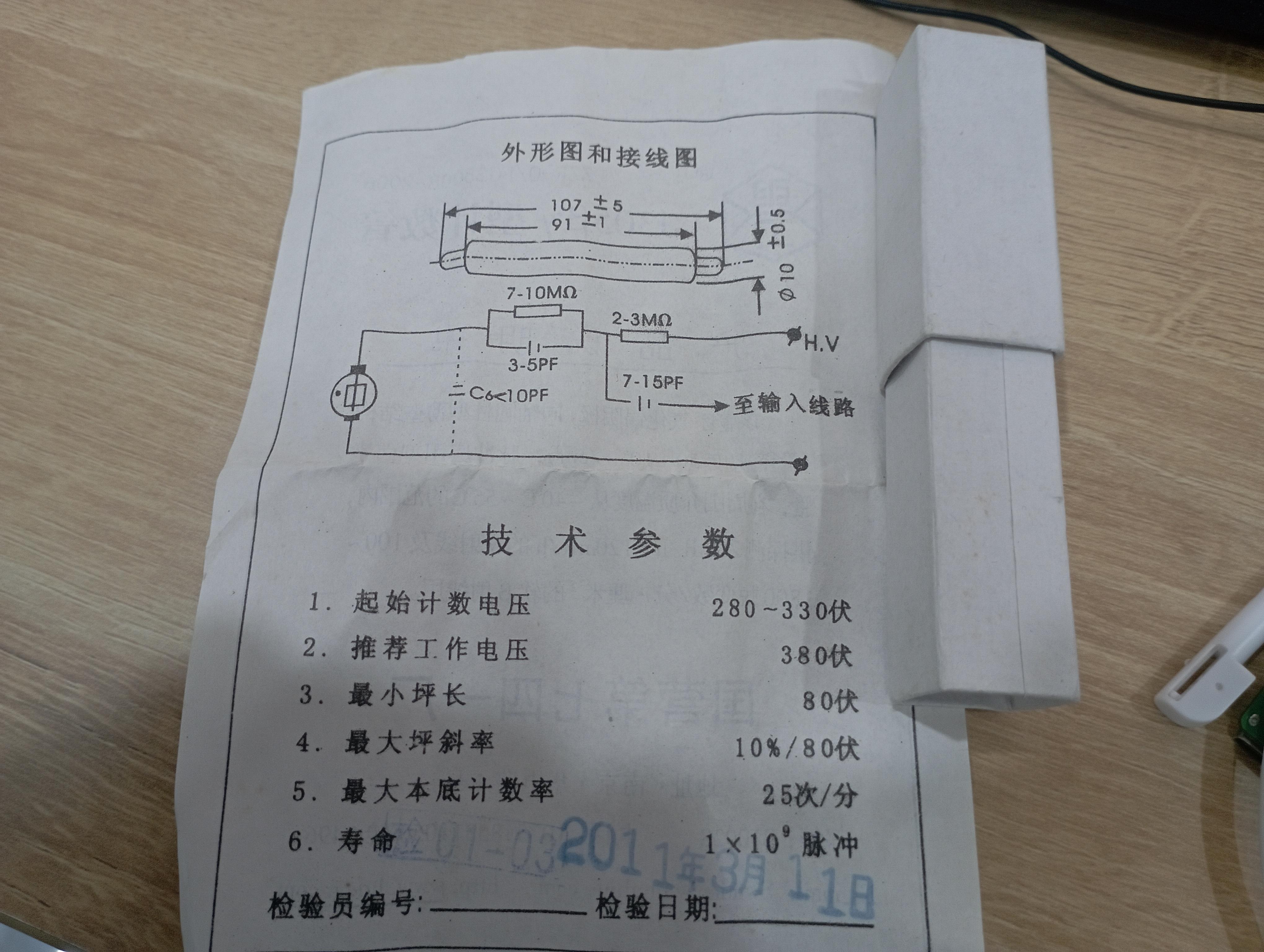

The Geiger diode operating circuit
detects radiation, requiring a boost circuit to ensure the Geiger diode functions properly. According to the Geiger transistor manual, the operating voltage should be at least 280V, with 380V recommended.

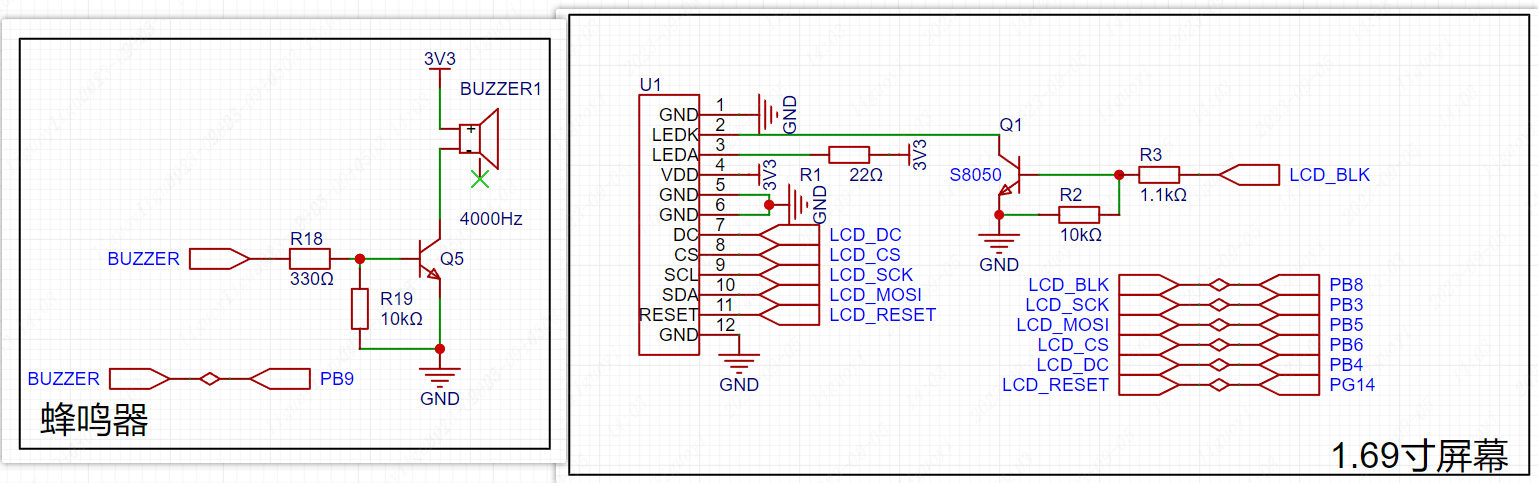

Q2/Q4 in the schematic need to be high-voltage rated, and R60 uses a 3296-packaged potentiometer for output voltage adjustment. A 4000Hz passive buzzer is used for the
buzzer and display
. The screen is a 1.69-inch SPI 16-bit color screen. (Screen purchase link: 1.69-inch TFT color high-definition IPS LCD bare screen 240*280 SPI interface ST7789 driver (select soldering type)).

code is the second detection and interrupt function. The Geiger transistor detection pin PE6 is set to external interrupt falling edge trigger mode (when a pulse is measured on the Geiger transistor, Q3 conducts, making PE6 low).

Every
second, the current count value is compared to the previous count value. If there is a difference, the difference is recorded; this difference is the count value for that second. The difference is stored in the array `COUNTS_buff`. This difference is accumulated 10 times, so `COUNTS_buff` contains 10 measurement results from the past 10 seconds. All numbers in the `COUNTS_buff` array are summed and multiplied by 6 to display the CPM value (CPM = count rate per minute) on the screen.
The dose equivalent, expressed in µSv/hr, is calculated by dividing the CPM value by 2^10 (K) (this value can be found in the literature).
