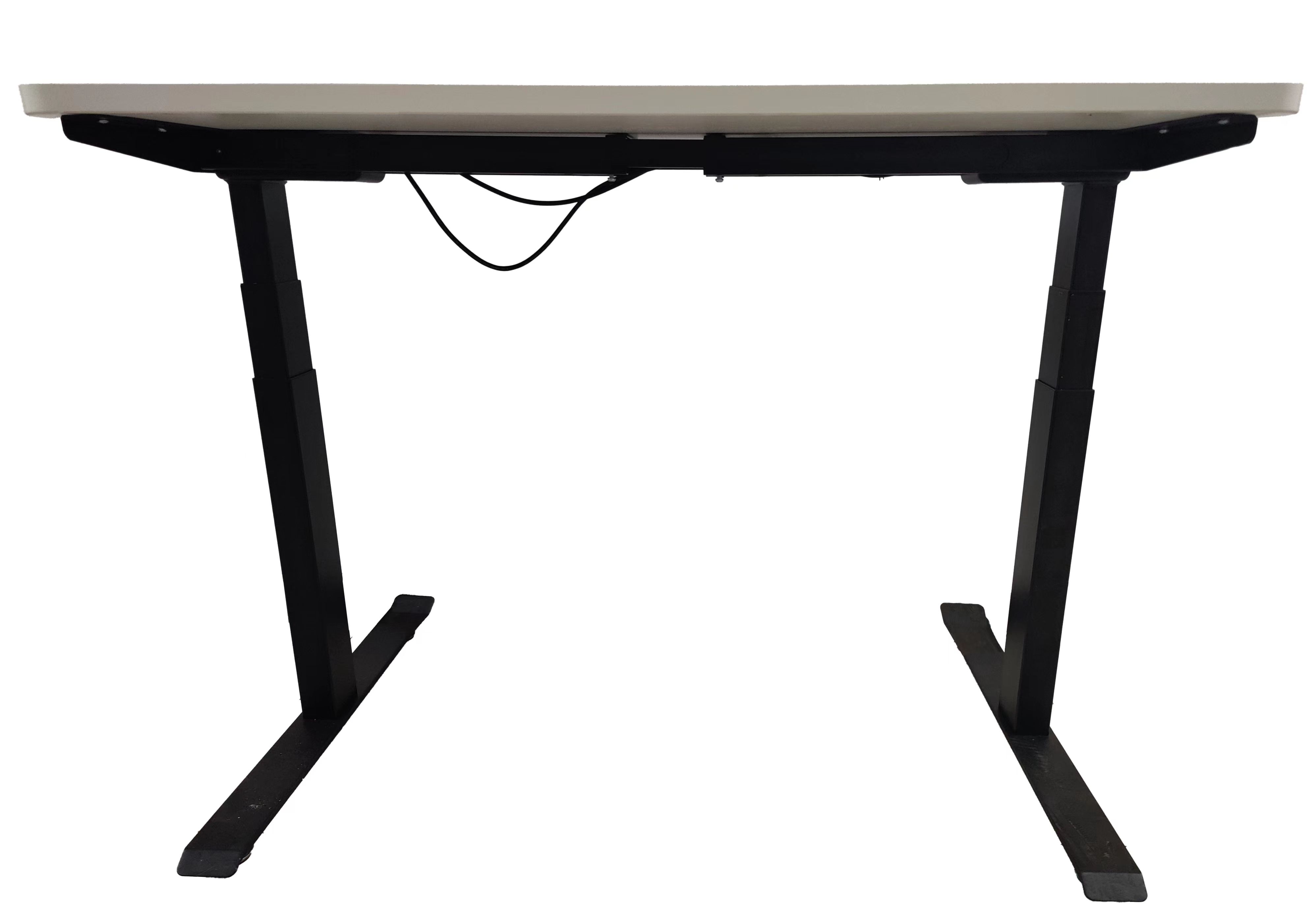

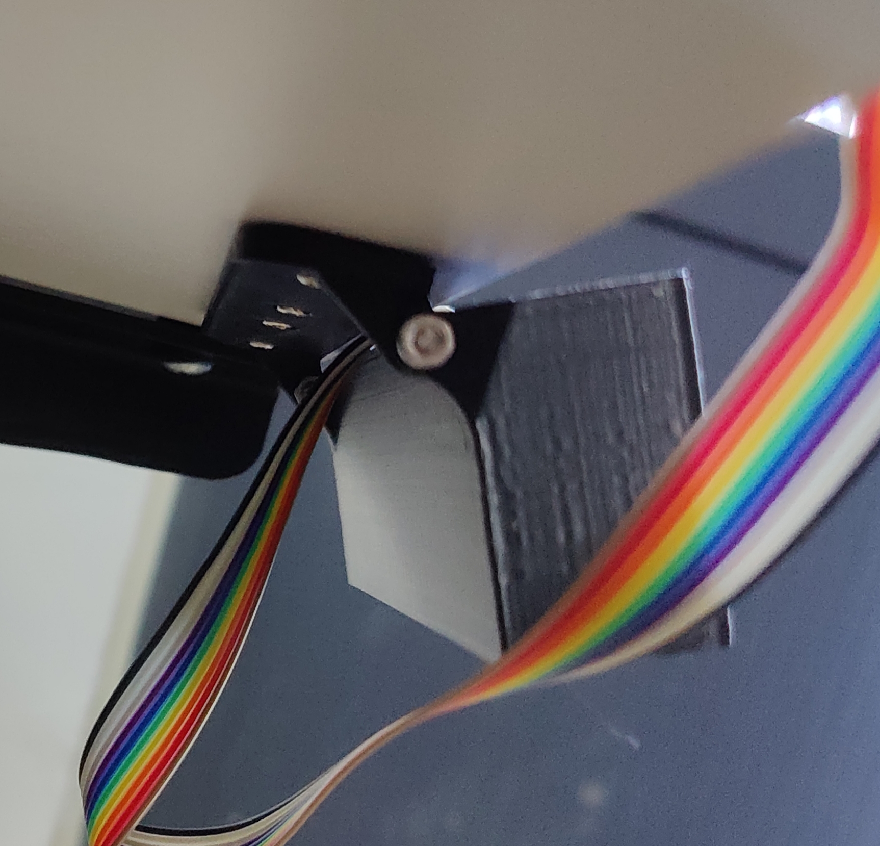

     is divided into the following sections: Structural section: I purchased a used Changteng CTHT3-F4200 dual-motor 3-section height-adjustable desk frame from Xianyu (official specifications: noise level around 42 decibels, maximum load capacity 120KG, height adjustment range 600-1250mm).

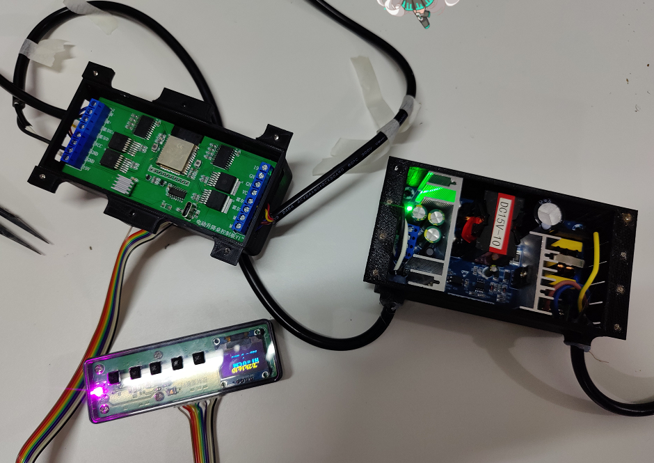

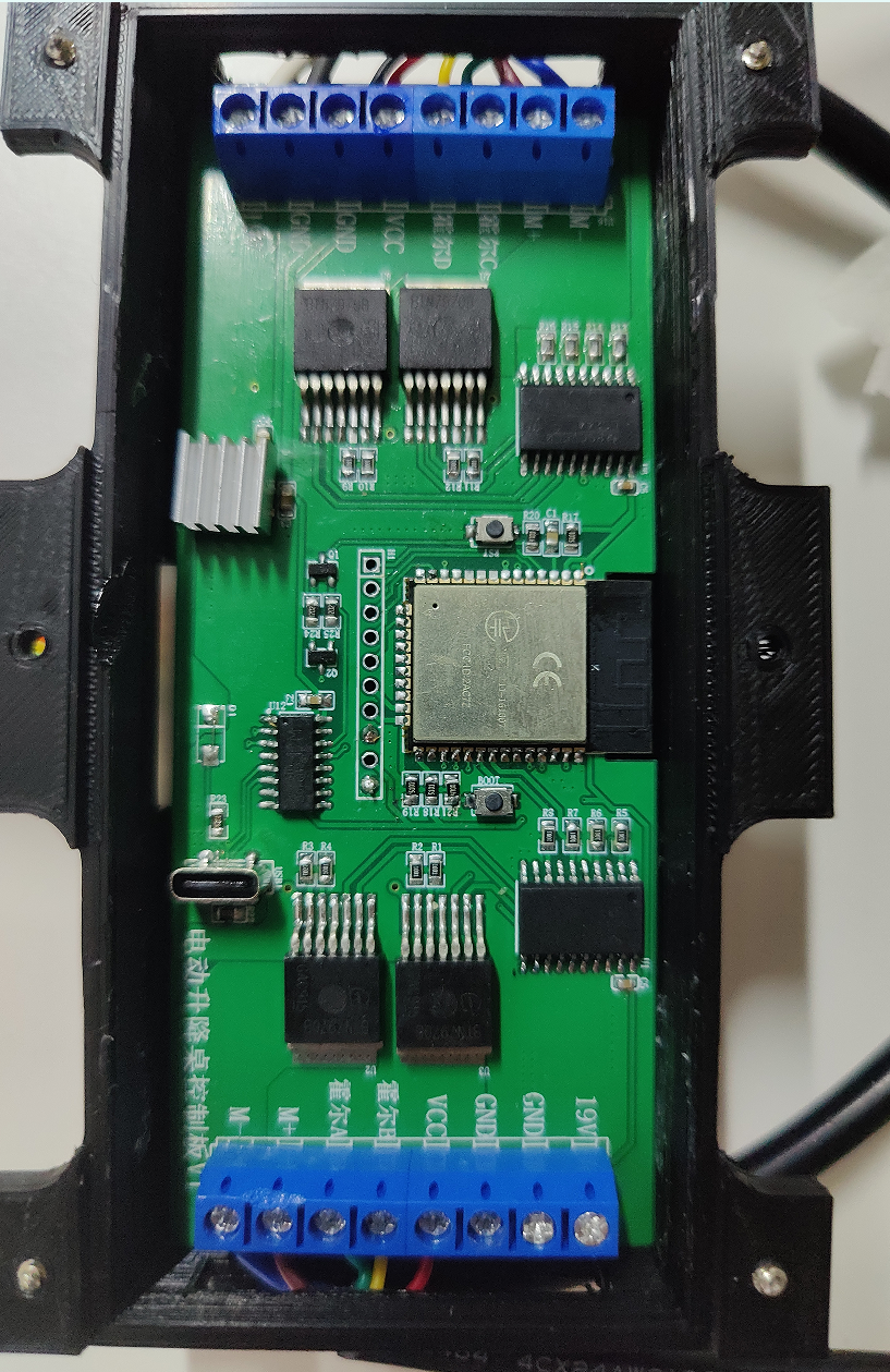

     Main control section: I used the ESP32 as the main control chip for the following reasons:
                   1. Sufficient I/O ports (I need approximately 12, making the ESP32 suitable).
                   2. Sufficient interrupts (interrupts are crucial for monitoring motor Hall effect sensors, and each I/O port of the ESP32 can be used as an independent interrupt).
                   3. I2C pins are required (for OLED control).
                   4. Sufficiently large EEPROM is needed to store height information after power failure.
                   5. Wi-Fi functionality is required for future IoT planning.
     Motor control section: I used the BTS7960 motor driver chip (the 7970 also works). Its biggest feature is its ability to output a maximum current of 27V 43A. This is more than enough for driving the motor of the height-adjustable desk. It also requires a large heatsink to dissipate heat from the chip, which increases its size, but it's sufficient for the space under the desk.

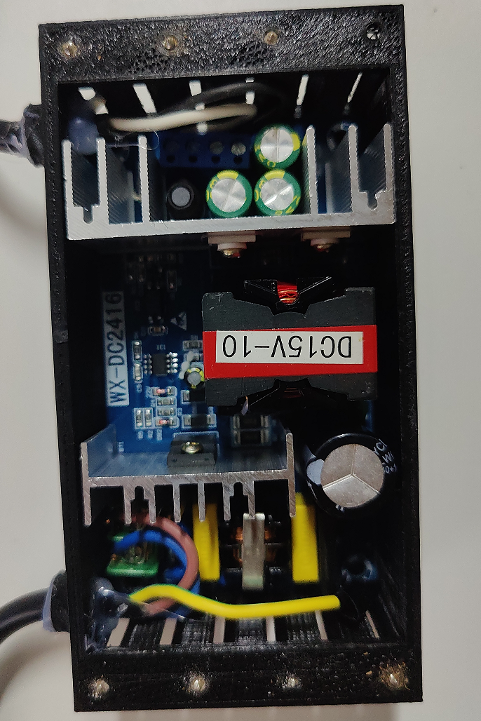

     Main power supply: After disassembling the motor, I found that each motor is an 18V, 4.3A worm motor. Testing revealed that the normal rotational current of the motor is around 2A. Considering the weight-bearing capacity, I chose a 15V 10A AD-DC power module. It costs approximately 15 yuan.

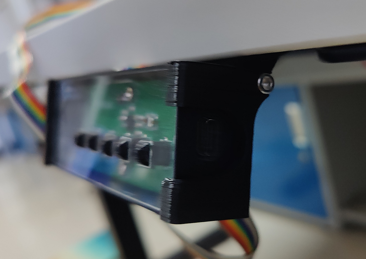

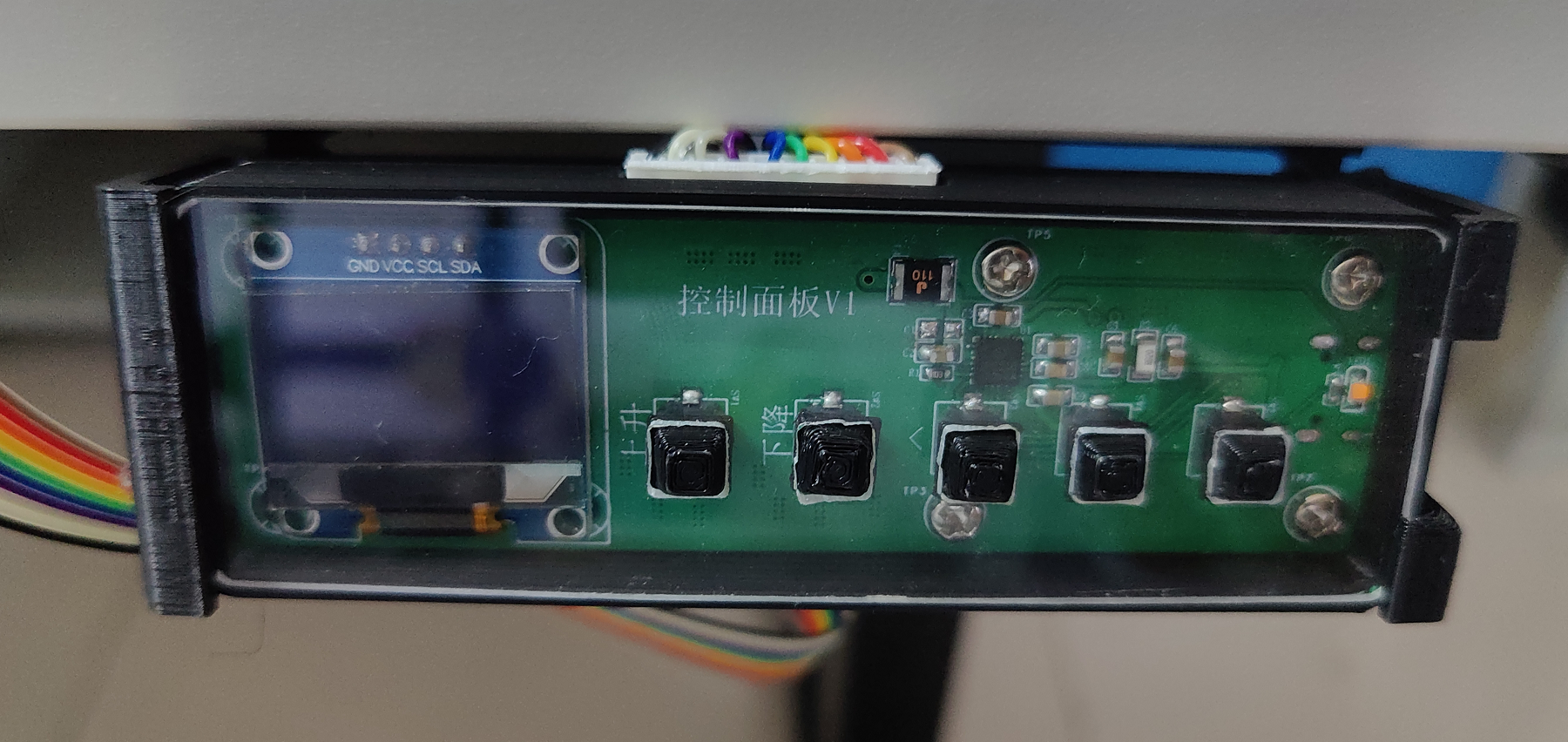

     Display: A 0.96-inch OLED screen is used as the height display screen for showing the time, alarm settings, height, etc.

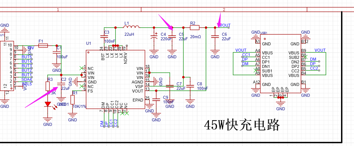

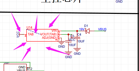

     Fast charging: An IP5306 fast charging chip is used, with a maximum output power of 45W.

Maximum height: 120CM, minimum height: 60CM;
Desktop area: 120cm x 60cm;
Maximum load capacity: 50KG, and the height cannot be rebounded;
Number of motors: 1-2;

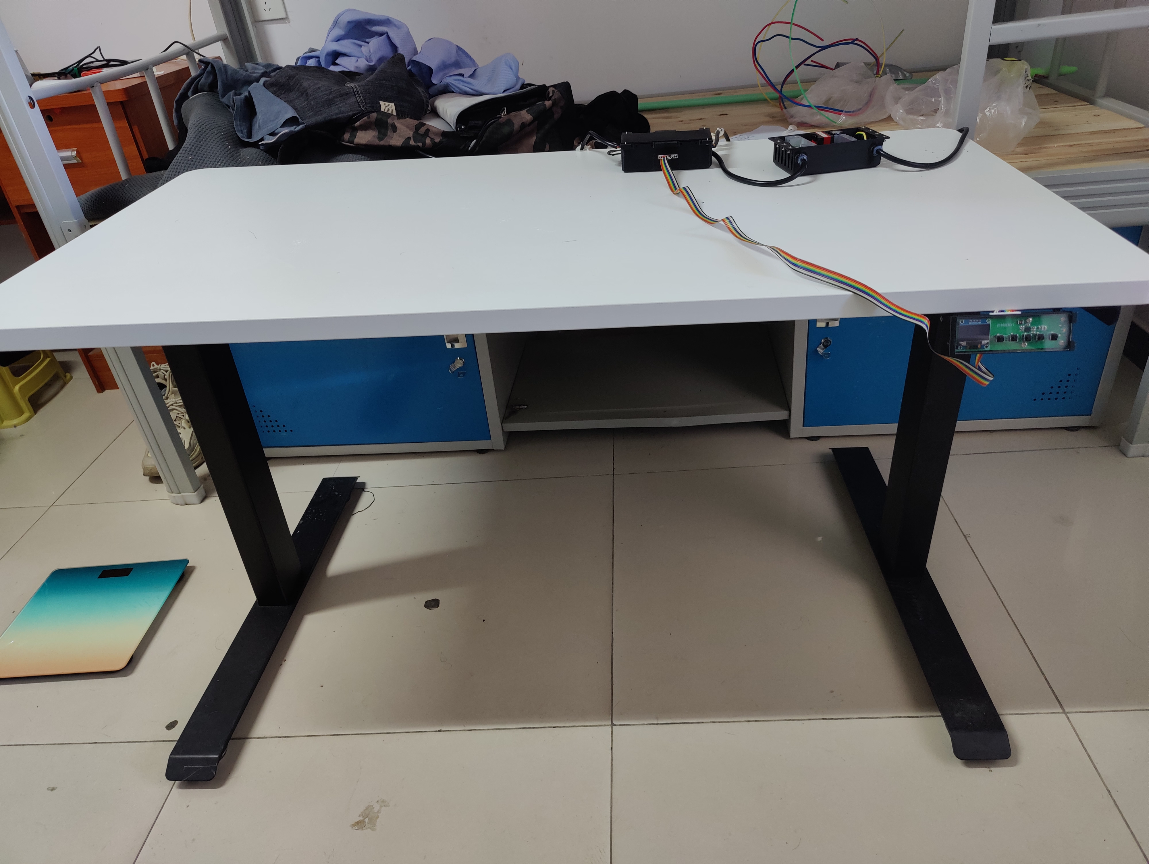

: July 1st: The height-adjustable desk arrived and was tested. The size and installation location of each module were determined, and modeling of the control board casing began.
July 3rd: The control board was manually soldered, code was written, and the performance of the height-adjustable desk was tested to ensure it met requirements.
July 10th: PCB schematic design was completed, including (motor drive, control section, OLED screen display, button control, limit switch settings, USB fast charging settings). Power-off memory and alarm clock were placed in the final testing section.
July 13th: PCB design and prototyping.
July 13th: Electronic component procurement
. July 20th: PCB soldering and testing.

         First, the hardware was measured and chips were selected to determine the appropriate PCB size and chip type to ensure that the design requirements are met.
         By disassembling the motors, each motor has two Hall effect sensors. When the motor's magnetic ring rotates, the two Hall effect sensors detect different values ​​due to the S and N poles of the magnetic ring. For example, if Hall effect sensor 1 detects a low level and Hall effect sensor 2 detects a high level, it indicates that the motor is rotating clockwise, and the table is rising. If Hall effect sensor 1 detects a high level and Hall effect sensor 2 detects a low level, it indicates that the motor is rotating counterclockwise, and the table is falling. Therefore, I set up five buttons: up, down, alarm hour timer setting, alarm minute timer setting, and clear button.
        When the "raise" button is pressed, the ESP32 outputs two PWM control signals to raise the two table legs. Simultaneously, the motor rotation triggers a Hall sensor, which detects the rotation, initiating an interrupt and sending the read pulses to the ESP32 for recording. When the desired height is reached, the current height is calculated using a function formula, displayed on the OLED screen, and saved to the EEPROM to prevent data loss in case of power failure. Through repeated calculations and measurements, it was found that the table outputs 2569 pulses at its maximum height of 1200mm, meaning the motors stop rising when the height reaches 1200mm.
        When the "lower" button is pressed, the ESP32 outputs two PWM signals to lower the two table legs. When the detected height is greater than or equal to 0, it indicates the bottom has been reached, and the descent stops. Similarly, when the lowest height is reached, the pulse count is 0.
        For network time and alarm clock: After the table is powered on, the ESP32 automatically connects to the home Wi-Fi network and obtains the network time, displaying it on the OLED screen. Users can set the desired alarm time by pressing the corresponding alarm timer button. The set time will be displayed on the OLED screen. The network time is read and compared with the set time; if they are equal, a buzzer is activated.
         EEPROM Section: When the up or down button is pressed, the current height is stored in the EEPROM. After a power outage, the height is saved in the EEPROM. When power is restored, the previously saved height is read directly, and the up or down height calculation is performed at that height to prevent the current height value from being cleared to zero after a power outage.
        Power supply section: Measurements were taken using a Zhengdian Atom adjustable power supply. It was found that under normal operating conditions (adjustable power supply set to 12V 5A), the current of a single motor is about 2.5A. Since the motor parameters are 18V 4.3A, considering the load-bearing capacity and starting current, an AC-DC 15V 10A power supply module was selected for this test.

    //OLED displays the current time
    display.clearDisplay(); //Clear the display image
    display.setTextSize(1);
    display.setTextColor(WHITE);
    display.setCursor(20, 13);
    display.print("T:");
    display.println(timeClient.getFormattedTime()); // //
    OLED displays the timer
    display.setCursor(20, 30);
    display.print("DING:"); //"DING --fixed"
    display.print(alarmHour); // Hours
    display.print(":");
    display.println(alarmMinute); // Minutes
    checkAlarmTrigger(); // Start the timer function

Physical
demonstration: Images of the actual product are provided, with descriptions added.
The control panel has a detachable and foldable design .

The AMS1117 used in the circuit diagram is currently considered to cause significant heat generation; the AMS117 I purchased appears to be defective. Replacing it with an AS1117 is recommended.
When actually programming, a program to clear the ESP32 and EEPROM needs to be programmed first to prevent incorrect read heights.
The capacitors marked with arrows in the fast charging circuit can be modified as needed.
