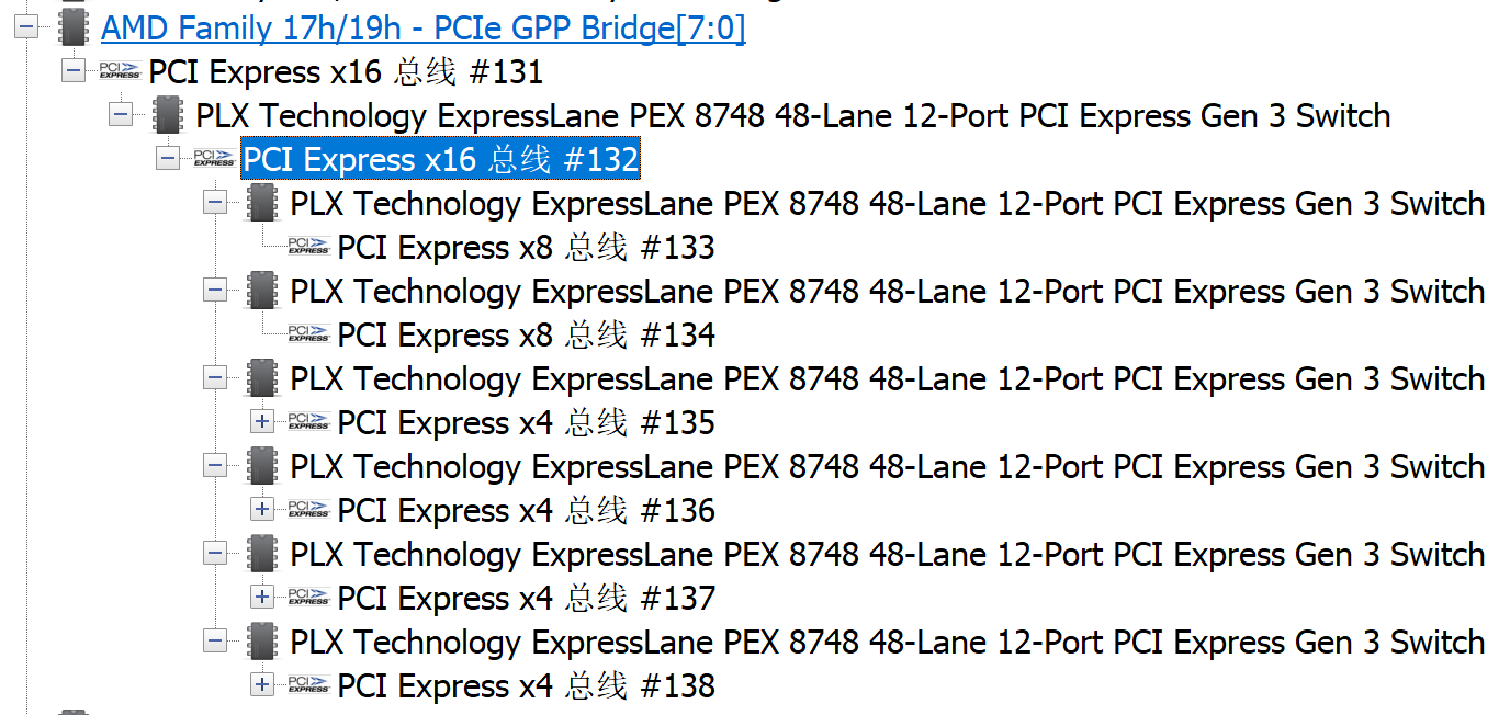

PCIe x16 3.0 as the upstream motherboard insert; four downstream M.2 22110 sizes (compatible with 2280), plus two SFF-8654 8I cards (which can be switched between X4, X8, and X16 via DIP switches). The cards use full-height standard dimensions, and the bezels are LSI standard half-height hole spacing full-height bezels!

has been verified as OK! The current price of a brand new PEX8748 is around 200 RMB. Including other components and the PCB, the mass production cost per card is over 400 RMB! The main purpose of open-sourcing this card is to provide design references. If you're doing prototyping and surface mounting alone, it's very expensive; you'll need to find a partner for mass production!

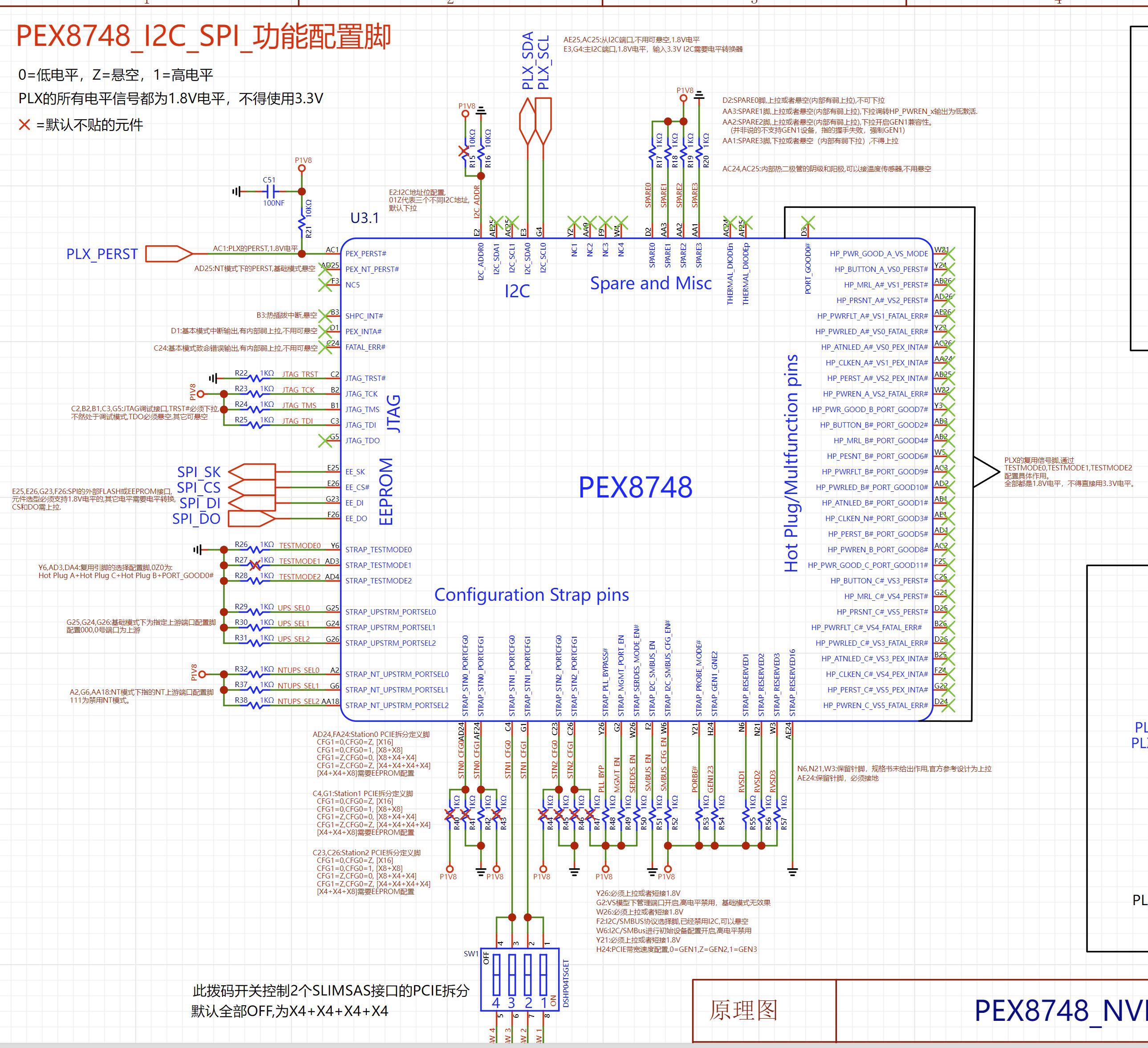

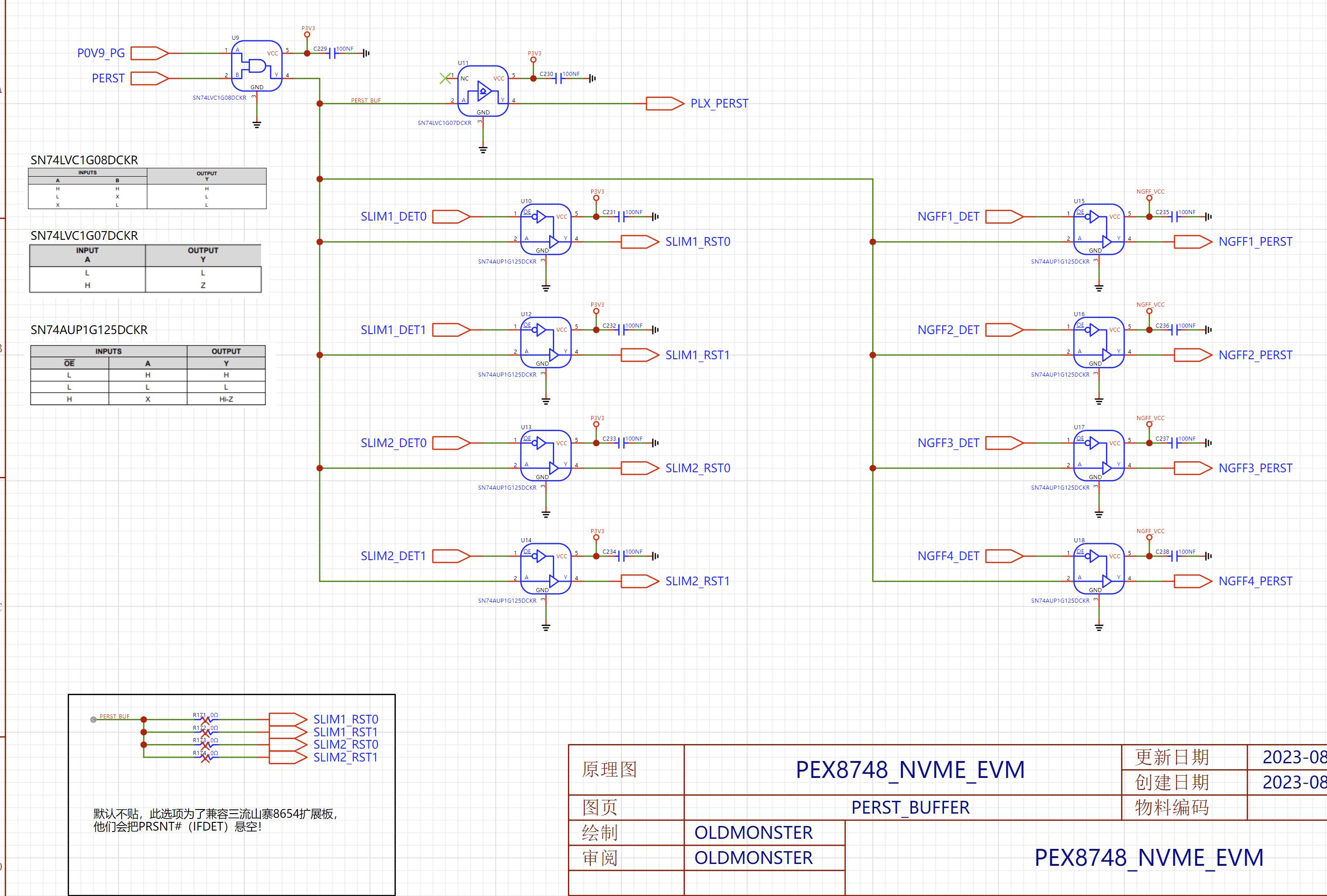

principles of PEX chips are generally similar; you can refer to the previous PEX8796 design. To make it easier for those with basic knowledge to understand, I've specifically added Chinese standard labels for the functions and roles in all locations on the schematic diagram! I've also redrawn the component symbols to provide a clear understanding of their functions for those with basic knowledge but limited understanding.
All related functions are annotated in Chinese, and all logic gates are symbolized.

This card does not require firmware. The I2C level converter chip and EEPROM can be omitted; they are configured using resistors and DIP switches by default.

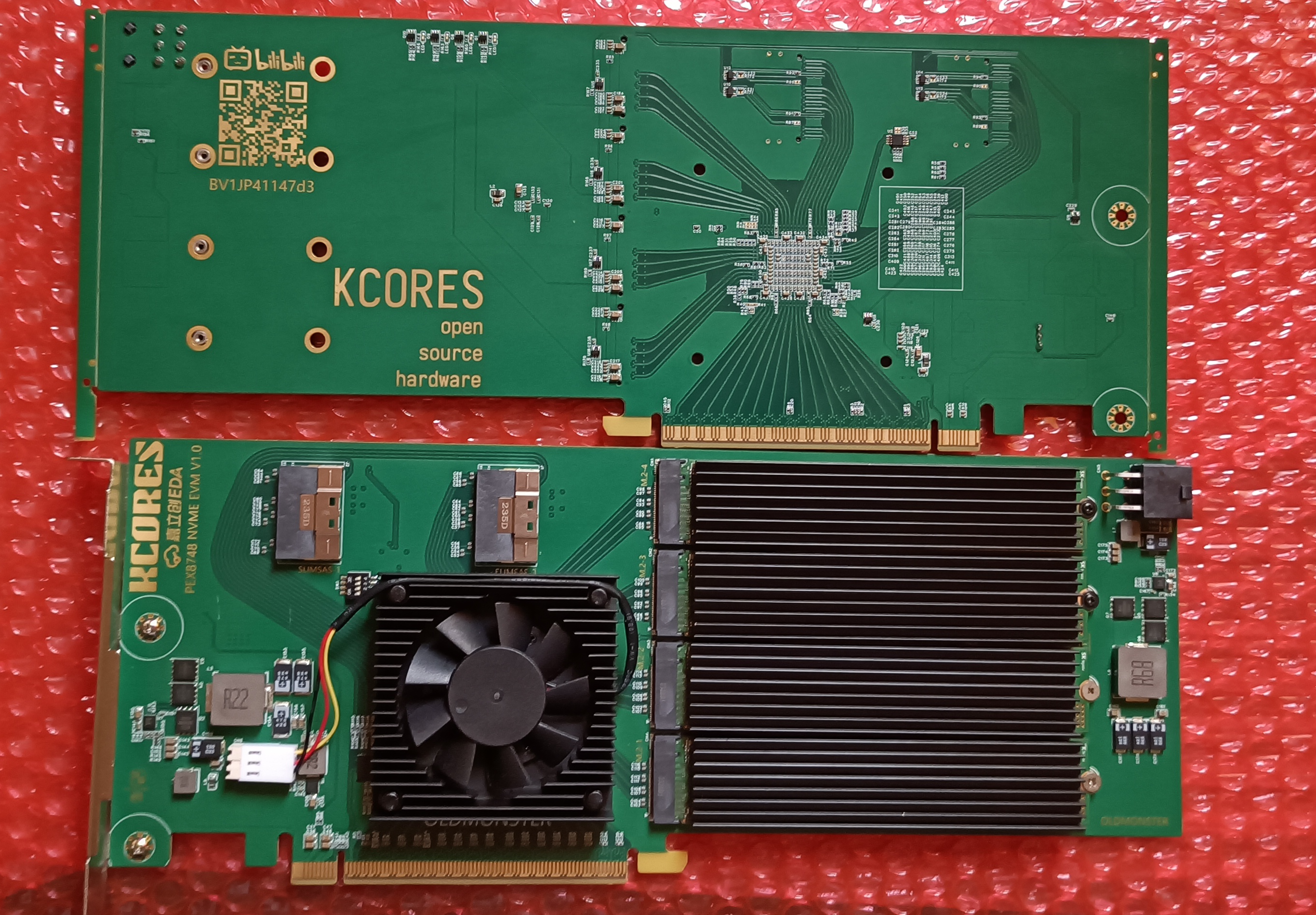

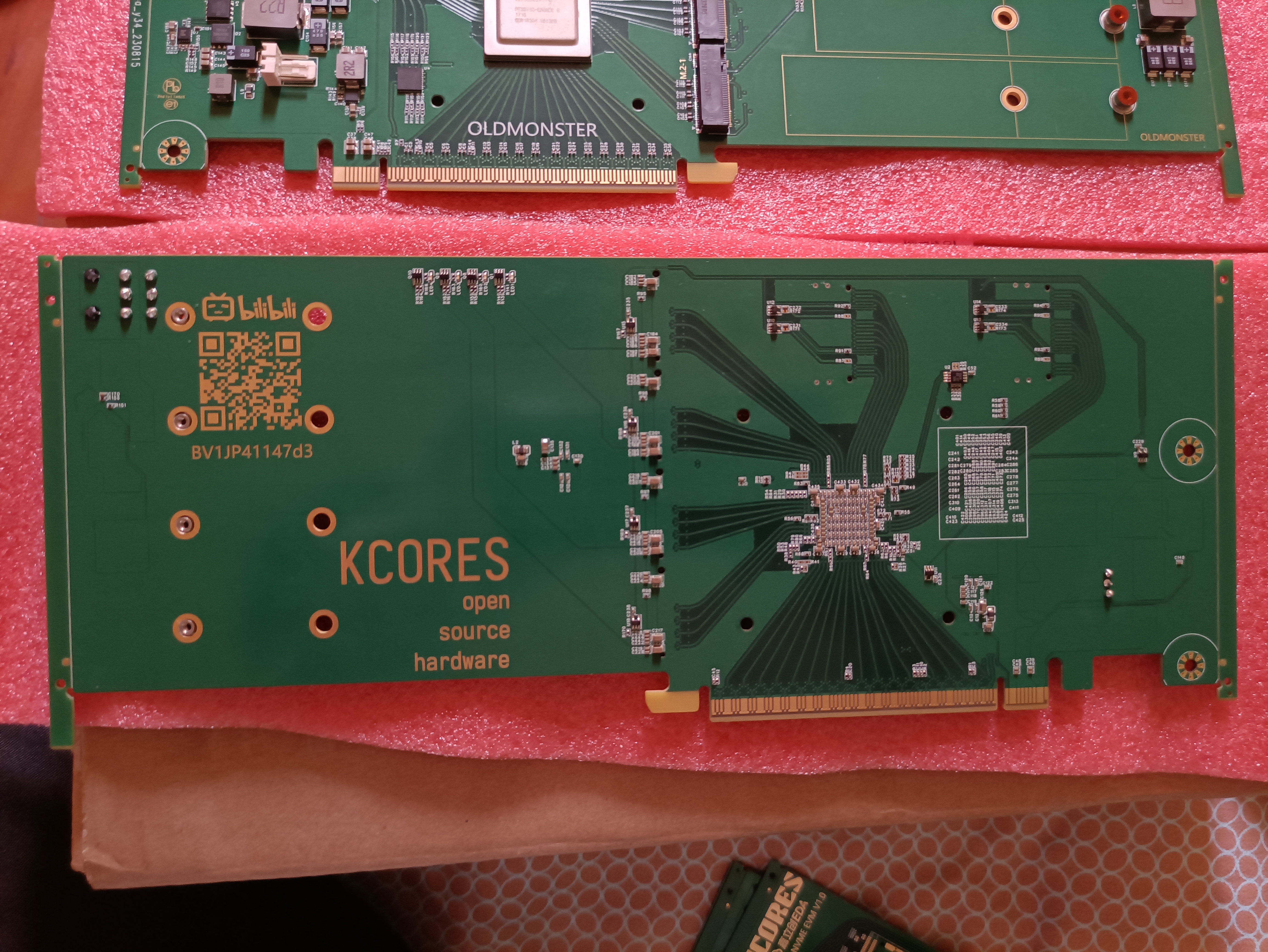

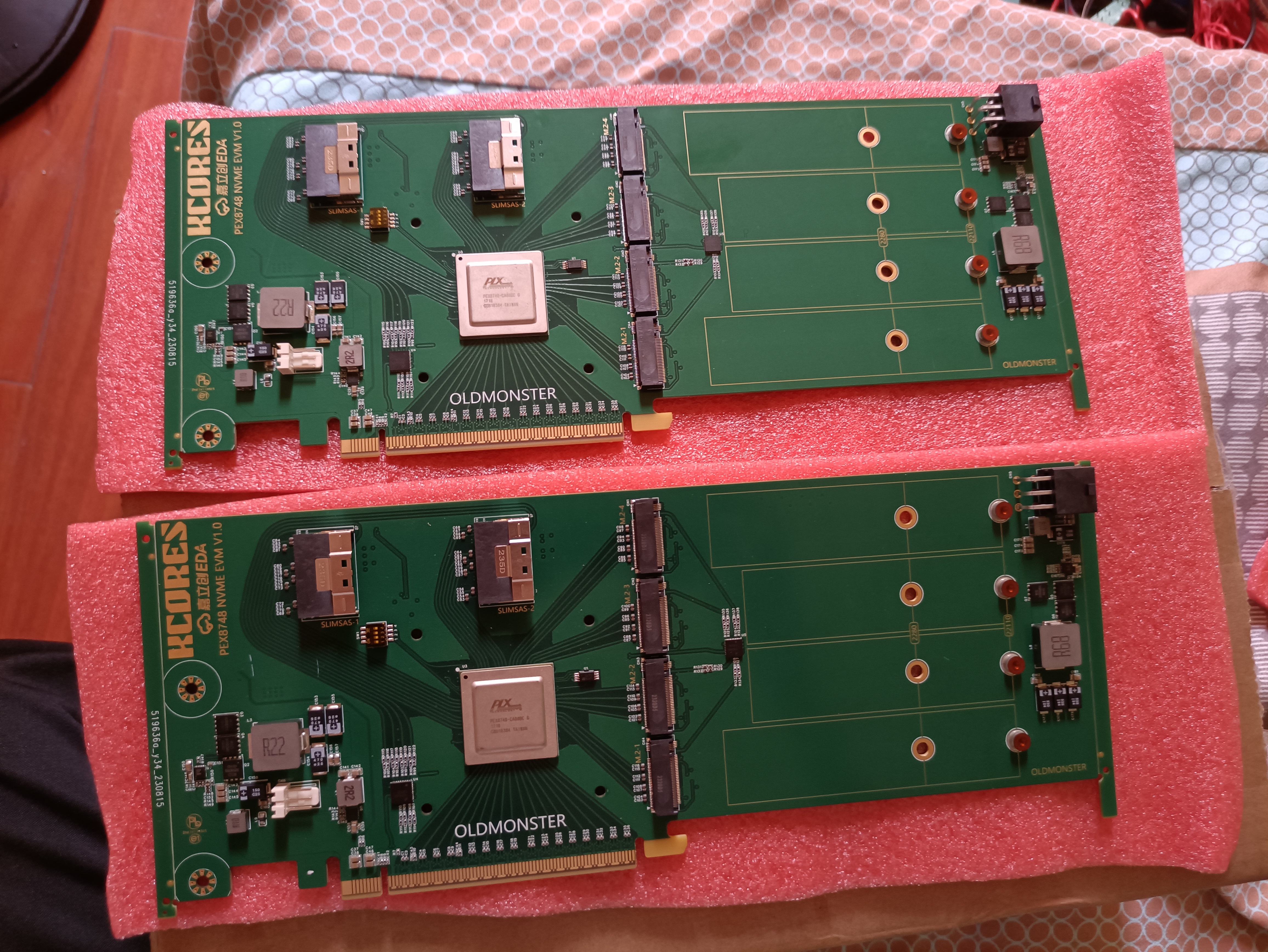

Physical demonstration:
