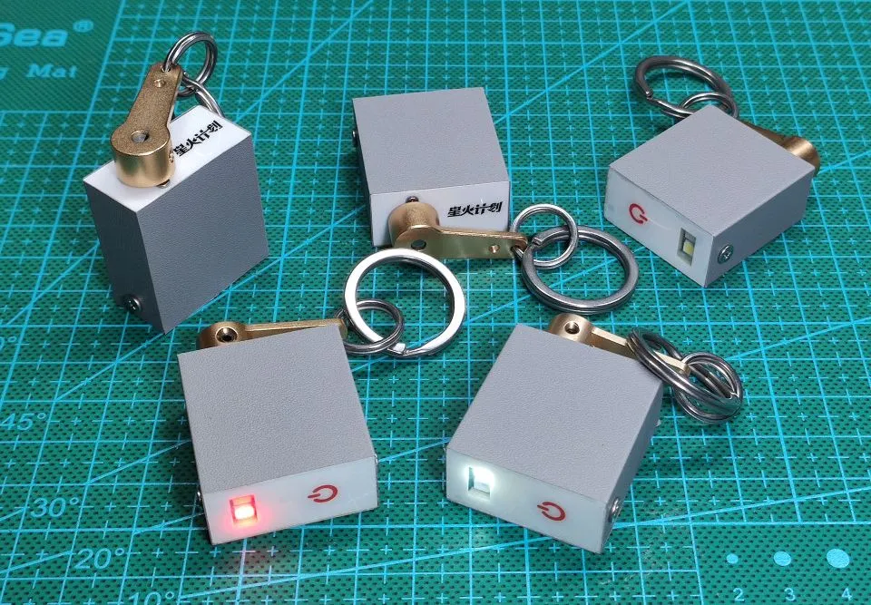

EDC-generated flashlight
This
is a multi-functional power-generation flashlight with various lighting modes. It features a red and white dual-color LED, an aluminum alloy body, a comprehensive protection circuit, and a compact, portable design.
Pictures don't do it justice, check out the video
demonstration:
https://www.bilibili.com/video/BV1X7mFY7EkG/
Hardware project:
https://oshwhub.com/code504/edc-power-generation-flashlight
Software code:
The https://gitee.com/dma/edc-generator-flashlight
function description states that for
first-time use or after a long period of inactivity, please rotate the handle to generate electricity. When the battery reaches the minimum usage limit, the white light will flash twice. At this point, you can continue generating electricity or providing illumination .
With the device off, rotating the handle 300 times in 2 minutes will charge it to approximately 60%, and rotating it 450 times in 3 minutes will charge it to approximately 80% (actual generation efficiency may vary slightly depending on the rotation speed).
Continuing to rotate the handle when it is close to full charge will reduce generation efficiency, so it is not recommended to continue generating electricity. Once fully charged, the protection circuit will activate, so there is no need to worry about overcharging the capacitor.
Generating electricity can be done by rotating the handle in either direction, so there is no need to worry about the direction.
When the battery is low, the brightness will gradually decrease and eventually turn off.
The circuit will consume some power during standby after being turned off. The supercapacitor itself also has a self-discharge phenomenon; it is normal for the flashlight to run out of power after a long period of inactivity (more than 3 days).
Button instructions:
Single click turns on the flashlight. After powering on, the default white dim
lighting mode is activated. Single click switches the brightness; single click has no effect on other modes. 4 brightness levels: Low, Medium, and High.
Double-click to switch modes, cycling through the following modes: Illumination, Single Flash (twice per second), Double Flash (twice per second), Strobe, and SOS.
Triple-click to switch colors; white and red are available, and colors can be switched in any mode.
Long press to power off.

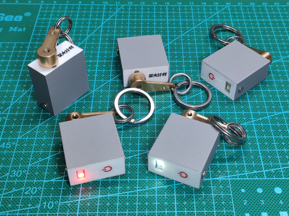

Hardware parameters:
Main body dimensions: 43mm*31mm (including the rocker arm, excluding the key ring).
Capacitor specifications: 2.7F, 10F. White
light brightness: Approximately 15 lumens for high brightness
. High brightness illumination duration: Approximately 2 minutes from the start of illumination on a full charge until the brightness noticeably decreases (actual performance may vary slightly depending on component batches).
Power consumption when powered off: Approximately 15uA at 2.6V, theoretical power-off time of over 1 day (actual performance may vary slightly depending on component batches).

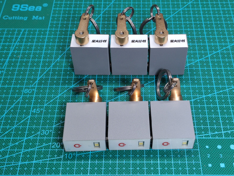

: Find aluminum square tubes for custom processing on an e-commerce platform. The aluminum square tube specifications are 30mm x 15mm, wall thickness 1mm. Have the merchant cut it to 32mm length, and drill a 2.5mm diameter hole on each of the two shorter sides, 4mm from the edge, in the center. Three views are shown below. You can directly send it to the merchant for processing. If needed, surface treatment processes such as sandblasting and anodizing can also be done, but the price will be higher. A vendor I consulted quoted 90 yuan for 10 units without any surface treatment and 260 yuan for 100 units without any surface treatment. This price is for reference only.
To save costs, I chose the option of not doing surface treatment and applying the skin myself. You can also choose a better-looking skin, or if you have the budget, go for sandblasting and anodizing.
The theoretical length of the aluminum square tube is 1.2 (PCB thickness) * 3 + 2.5 (pin header height) + 1.5 (button height) + 15 (motor height) + 9 (gearbox height) = 31.6mm.
In reality, because the PCB has a solder mask layer, copper layer, and silkscreen layer, the thickness will be slightly thicker. In addition, there are assembly errors and processing errors, so I simply rounded it to 32mm, which is also convenient for processing. If you want the best, you can consider making it 31.8mm.
