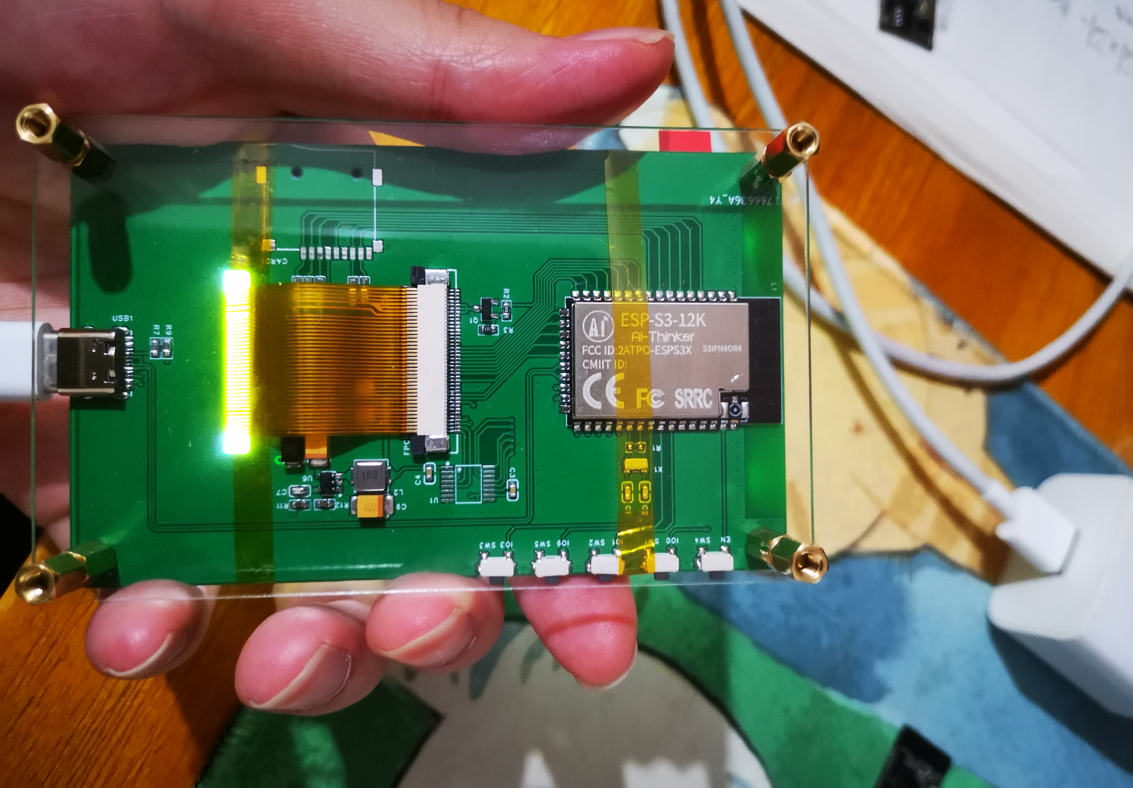

ESP32-S3 3.5'' screen driver board is roughly compatible with several models with the same pin definitions on Taobao. The board is equipped with an Essence ESP-S3-12K module and adds a 32.768k crystal oscillator for use in sleep mode. Keep ESP32 time accurate.
Screen purchase link reference: https://item.taobao.com/item.htm?spm=a1z09.2.0.0.40d82e8dEP5EFr&id=521624918530&_u=42dklb459cf9
Driver reference under ESP-IDF, I use ST7796, which should be compatible with 9488: https://gitee.com/fhcloud/idf-st7796_drive
FPC seats are difficult to solder. I have been trying for a long time and now I use solder paste + soldering iron to solder a little bit. If possible, you can open a steel mesh.
