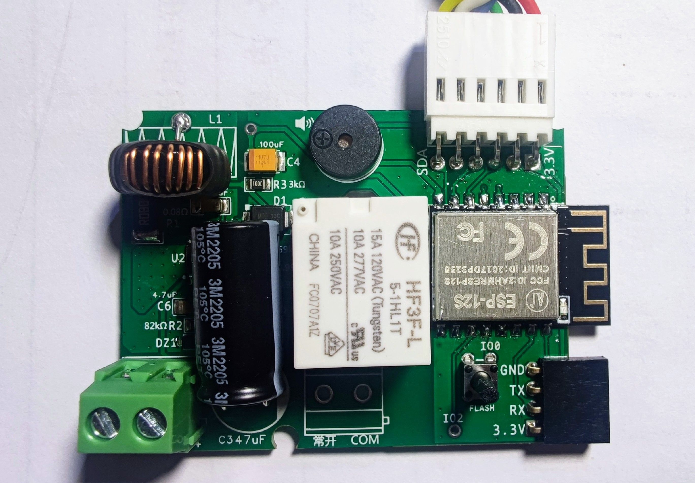

The electric vehicle NFC control module supports DC8-120V input.
Previously, it used a standard relay with 3.3V power supply: https://oshwhub.com/dt27/wifi-switch_copy.
This is an improved version, integrating a DC-DC wide voltage step-down converter, supporting DC 8~120V input.
The relay has been changed to a magnetic latching relay, providing instantaneous power during switching with no additional power consumption, preventing accidental activation, and ensuring the current status is unaffected by unexpected power outages.
The control center is an ESP-12S, not an ESP-12F!
The relay can control a maximum current of 10A.
An integrated buzzer is used to provide feedback on the card swipe result.
The NFC module is an RC522; this board only has an interface, so the RC522 module must be purchased separately.
RC522 module (7.8 RMB including shipping): https://dwz.ee/2fj.
Detailed information and firmware setup tutorial: https://www.domoticz.cn/forum/viewtopic.php?t=468
