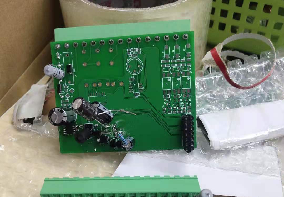

UP: 2021-03-26. The power board was soldered and actually tested to output 13.6V/5.2V. After some effort, I came to the conclusion that the VCC capacitor must be exactly 1uF. After replacing the capacitor, the no-load output is 12.52V. Full load 350ma, voltage 11.96V.
