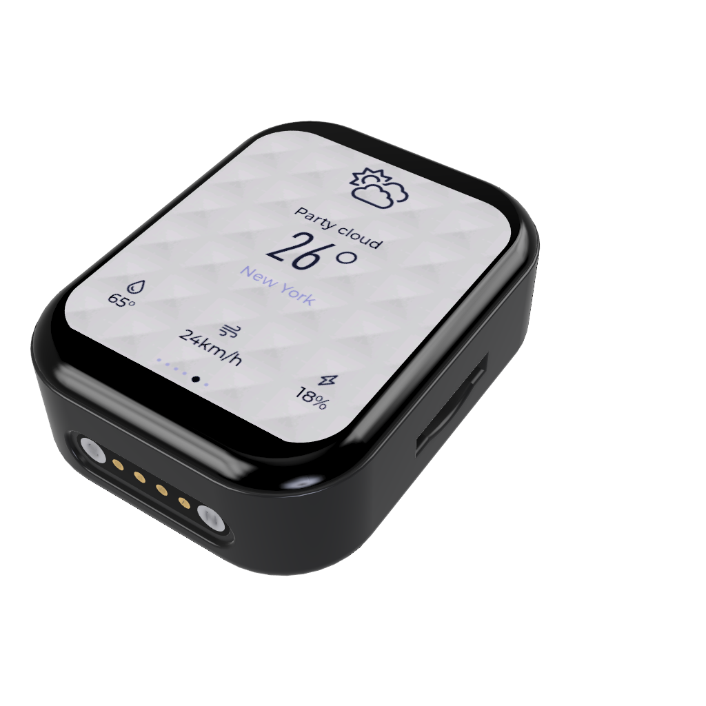

TD3 - Portable Charm with Wireless Power
The TD3-TouchDisplay 3.0
is a small pendant based on an ESP32-S3R8 chip and a 1.89-inch QSPI screen. It offers a smooth user experience and supports both wireless charging and magnetic charging. It features an onboard clock chip, a six-axis gyroscope, a pressure sensor, a passive buzzer, and supports the SDMMC memory card file system. The
overall hardware thickness is less than 15mm, and it contains a 300mAh lithium battery powered by an AXP173 microcontroller. The magnetic charging interface and wireless power supply are switched via path selection. The
PCB thickness is 1.2mm.
Wireless power supply
uses the Volta NU1680 solution, supporting up to 5W wireless charging. The charging speed is limited by the AXP173, preventing the charging current from exceeding 1A. The NU1680's peripheral components have specific material requirements; it is recommended to refer to the datasheet to select appropriate resistors and capacitors.
The power management
uses the older AXP173 chip. Many people who are replicating this chip say that it has too many custom voltages and is difficult to buy. It can be modified to use my open-source single-cell lithium battery charging and discharging solution. You only need to write an additional ADC acquisition solution.

display that couldn't be installed
was a 1.89-inch QSPI screen from Huaxia Color, which is a bit pricey and currently has no alternative. This screen is the most expensive piece of hardware in the entire project. The screen's IC is GC9B71, and the driver is conveniently included in the IDF example code, making migration very easy. It's also a touch-enabled example code, and the chip is identical. If you don't want to use the code I provided, you can try migrating it yourself.
Magnetic power supply
was chosen because it makes base design very convenient, and the models for the two components of the magnetic power supply are already built; you can ask me for them if needed.
