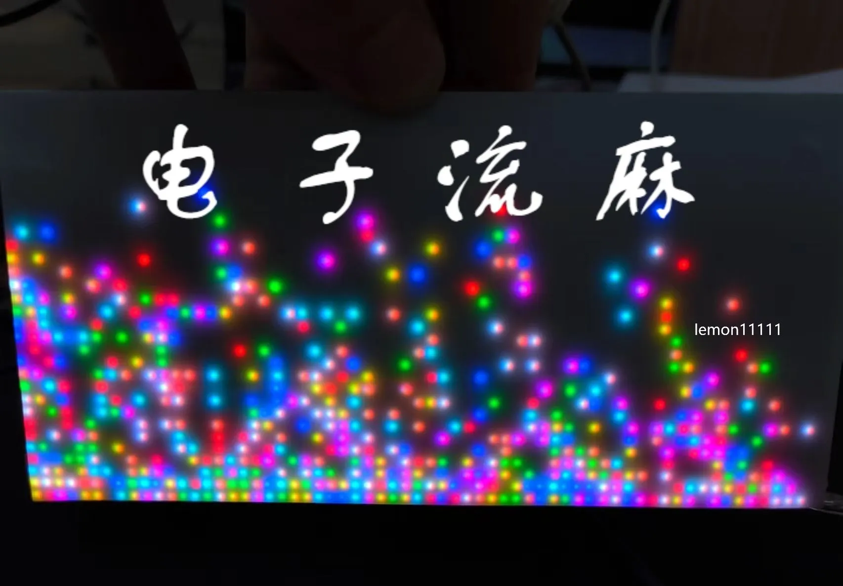

I usually enjoy making all sorts of handicrafts, especially quicksand mahjong sets, and I've made quite a few over the past year. This time, I wanted to make a special quicksand mahjong set, combining my love of crafting with my professional knowledge, which resulted in this electronic quicksand mahjong set. By controlling the on/off state of LED beads, it simulates the flow of quicksand in real quicksand mahjong, with particles of different colors intertwining to create a cyberpunk aesthetic. For a detailed look, please see this video: I made an electronic quicksand mahjong set!!!

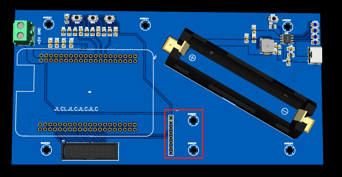

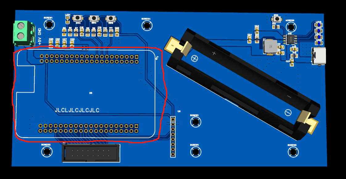

The project works as follows: the MPU6050 module acquires the current x-axis and y-axis acceleration and transmits the collected acceleration data to the microcontroller via the I2C protocol. The microcontroller calculates the positions of all particles based on the acceleration data and displays the results on the LED screen. The schematic design is straightforward; simply connect the aforementioned circuits. The completed PCB board is shown in the figure.

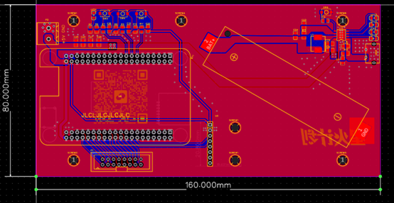

This PCB board measures 8mm*16mm, exactly the same size as the LED screen. Therefore, the PCB board is placed below the screen, and the two are connected using studs. The studs are positioned as shown in the positioning holes in the figure, corresponding precisely to the mounting holes on the LED screen. The two positioning holes in the lower middle are for securing the MPU6050 module, not the screen.

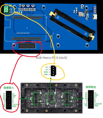

2.1 The connection between the LED screen and the base plate
is shown in the figure. Two cables are needed to connect the base plate and the screen: a data cable and a power cable. The screen manufacturer will include these two cables, but they are quite long and may not fit between the base plate and the screen. Therefore, a shorter cable is recommended. Shorter data cables can be purchased directly on Taobao, but shorter power cables need to be hand-forged. The data cable has a foolproof 2×8p connector to prevent reverse connection. For the power cable, be careful not to reverse the +5V and GND connections, otherwise it will burn out.
2.2 The connection between the core board and the base plate
involves soldering two 2×20p headers to the core board area on the PCB. Make sure the core board is inserted correctly; the serial and download headers should face outwards. Incidentally, the core board is shipped without headers; you need to purchase two 2×20p headers and one 2×5p header separately for soldering. When soldering the core board, the header pins should be soldered downwards. Be careful not to solder them backwards. A silly guy in our lab once soldered the header pins backwards, and I teased him about it for ages, haha. Also, don't solder the core board directly onto the PCB. Doing so makes it difficult to reuse the core board. Using a female header and header pin connection is better.
2.3 MPU6050 Connection to the Baseboard
: On the MPU6050 area of ​​the PCB, a 1×8p female header needs to be soldered. Make sure this female header is soldered correctly; it must be aligned straight. If it's misaligned, it will affect the accuracy of the acceleration.
2.4 Lithium Battery Charging/Discharging Circuit:
The lithium battery charging/discharging circuit uses the IP5306 chip. The ground of this chip is connected to the pin under the chip's surface, making soldering somewhat difficult. A hot air gun is needed for soldering, not a soldering iron. Other parts of the PCB baseboard can be soldered with a soldering iron. Additionally, this circuit board is powered by the Type-C interface on the right side of the PCB, not the Type-C interface on the core board. The reason is that the Type-C interface on the core board has a small load capacity, and the current should not exceed 1A. However, the LED screen draws more than 2.5A under full load (of course, the current required for electronic current control is far from the full load current). The information provided by the screen manufacturer states that using the core board's Type-C interface for power supply may burn out the core board. I don't know if the consequences are really that serious, but using the Type-C interface on the right side of the PCB board for power supply should definitely be fine. Also, be careful not to reverse the positive and negative terminals of the lithium battery box.

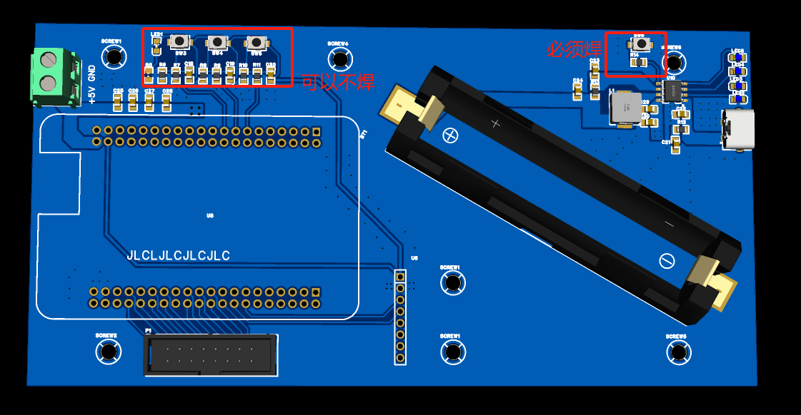

2.5 Switches
The entire PCB board has four push-button switches. The three on the left are not currently used and can be left unsoldered. The switch in the lithium battery charging and discharging circuit area on the right must be soldered; it is the electronic current control switch. A short press turns on, and two consecutive short presses turn off.
