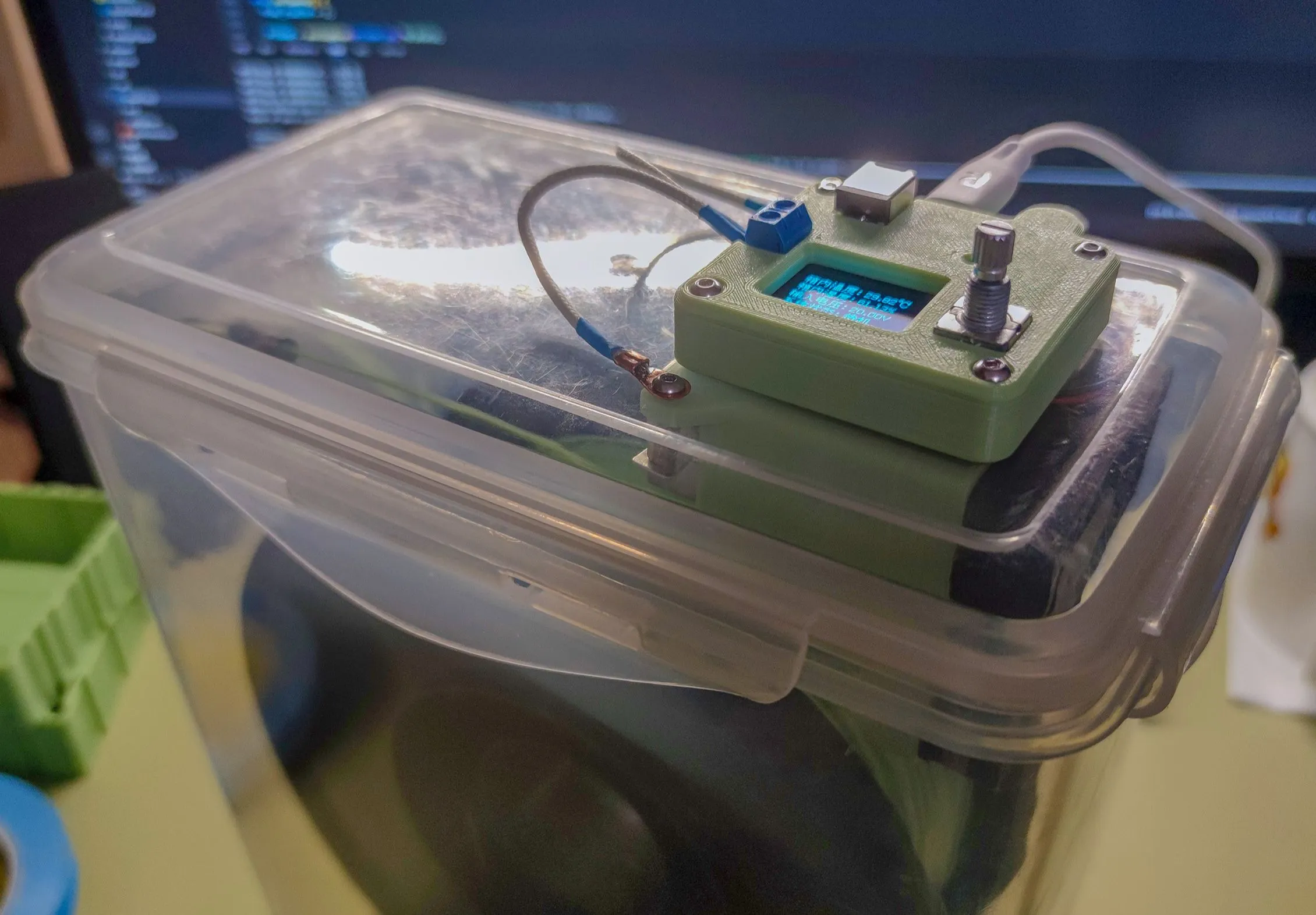

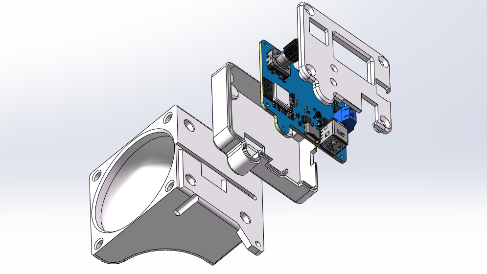

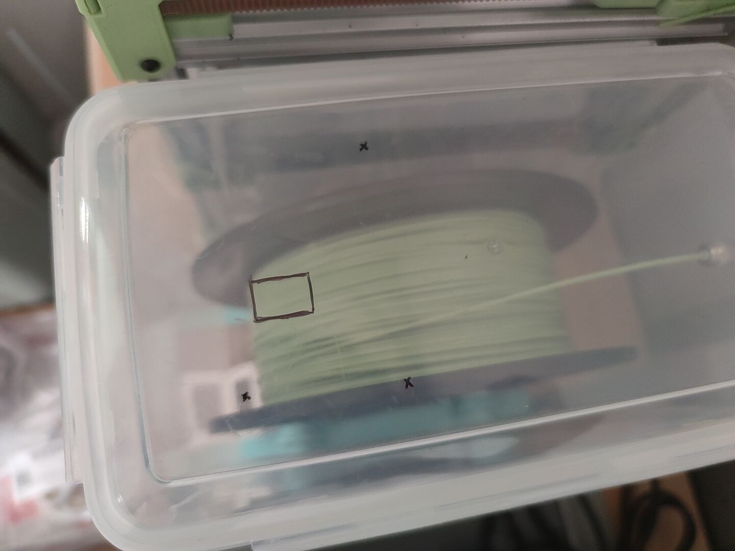

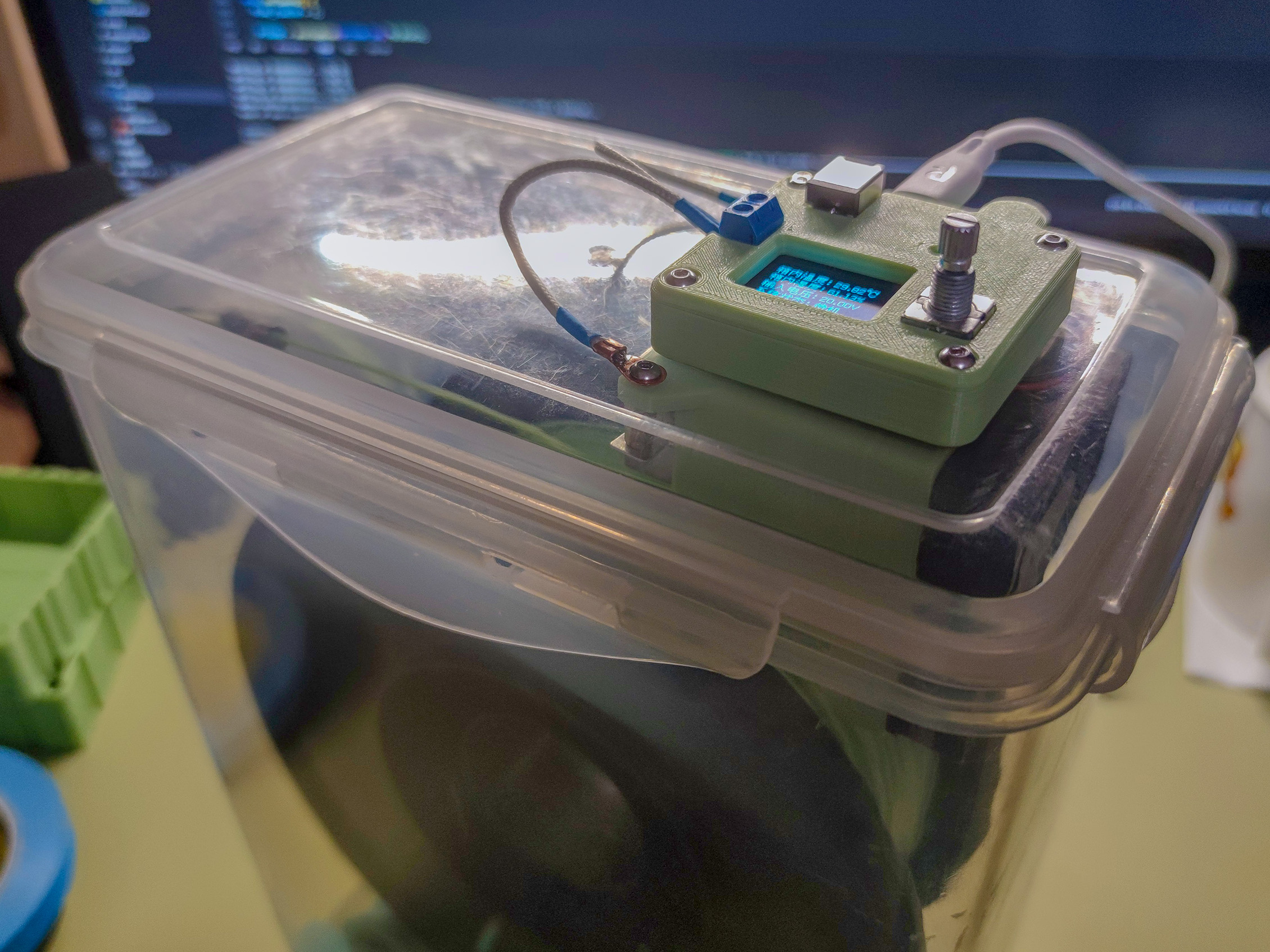

This drying component is an addition to a commonly used 5L rice bucket drying box, with minor modifications to achieve temperature and humidity monitoring and active drying functions.

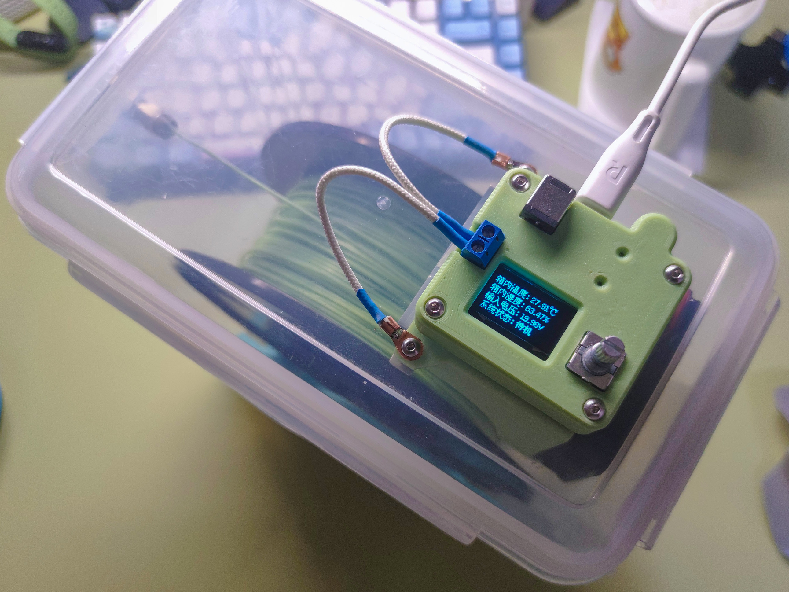

Below is a demonstration of the verified product:
Figure 2: Product Display Figure 1
Figure 3: Product Display Figure 2

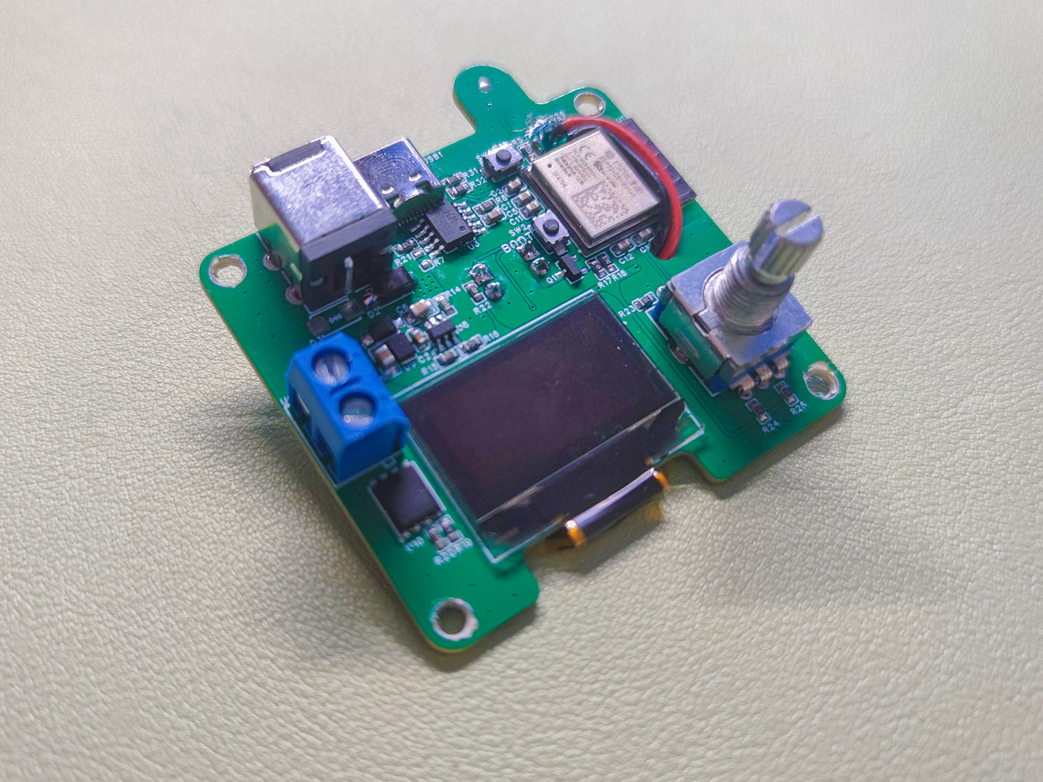

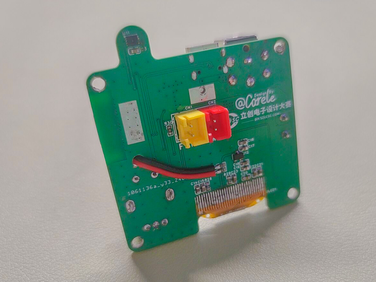

Figure 4: Control Module PCB Display

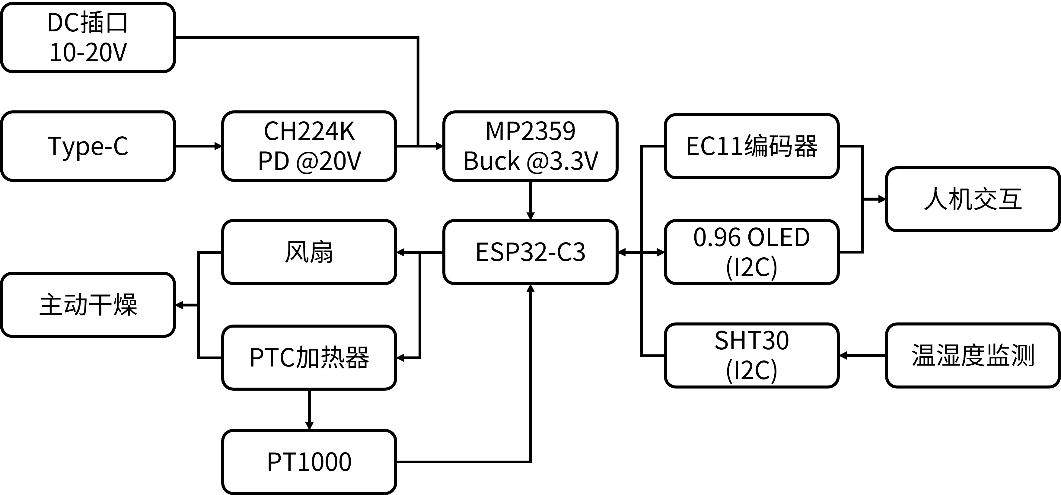

This component mainly consists of an MCU, power supply section, active drying section, temperature and humidity monitoring, and human-machine interaction section.
The system structure diagram is shown below:
Figure 5 System Structure Diagram

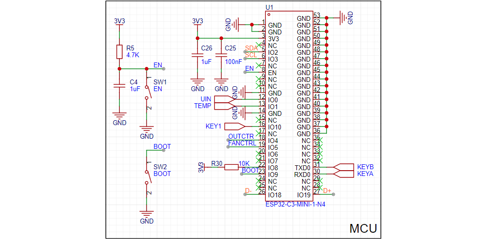

· The MCU uses the ESP32-C3-MINI-1-N4 module, which has built-in USB support for JTAG. Everyone who has used it says it's great! This isn't the first time I've used this module in a project, but I always learn something new every time I use it.
The chip has a 12-bit ADC for sampling the PT1000 and input voltage (the drift is significant; it's completely unusable without calibration).
This module has Wi-Fi functionality, and future integration with IoT devices is possible.
Other functions will be described later.

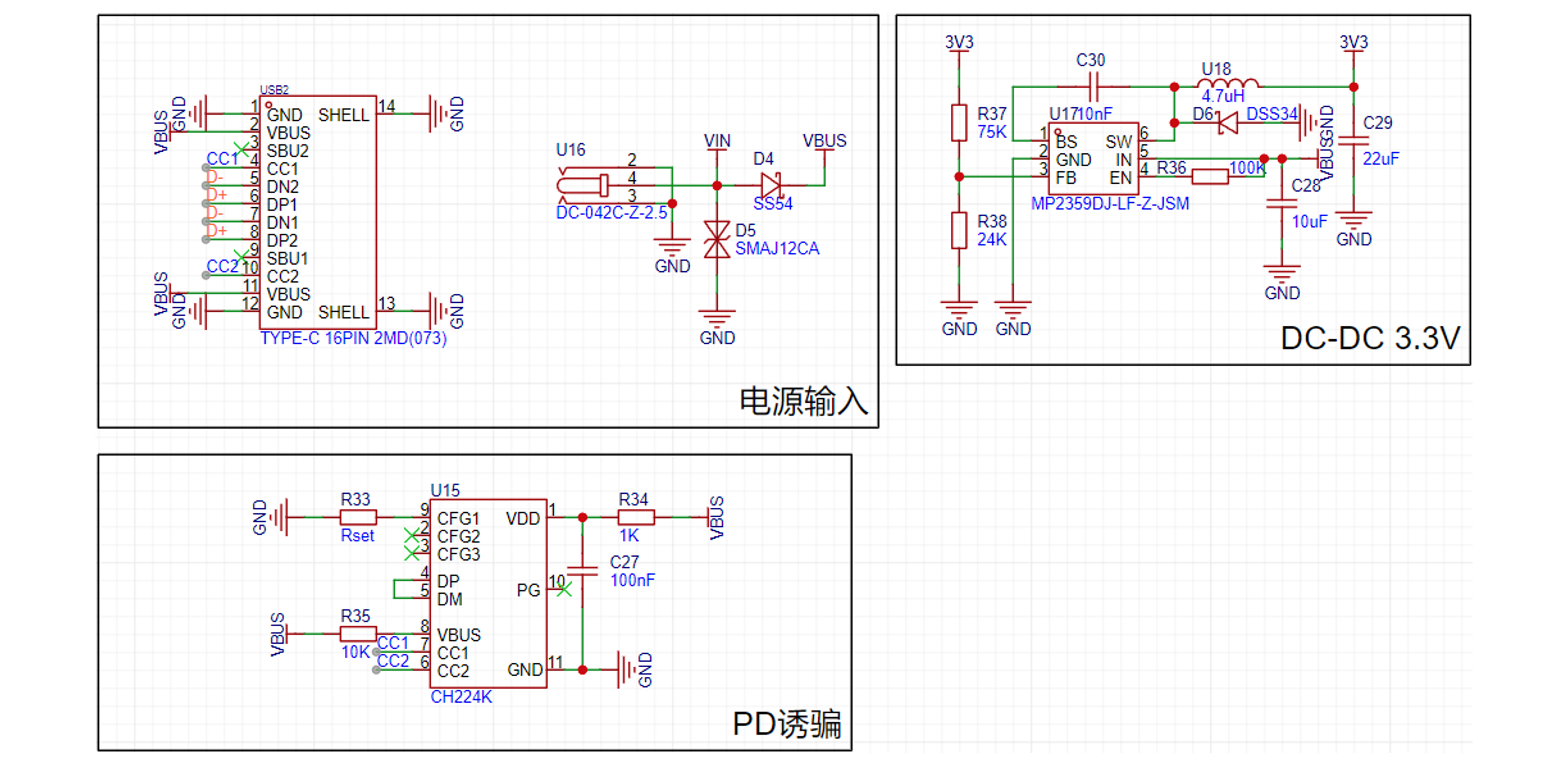

Figure 6 shows the MCU schematic .

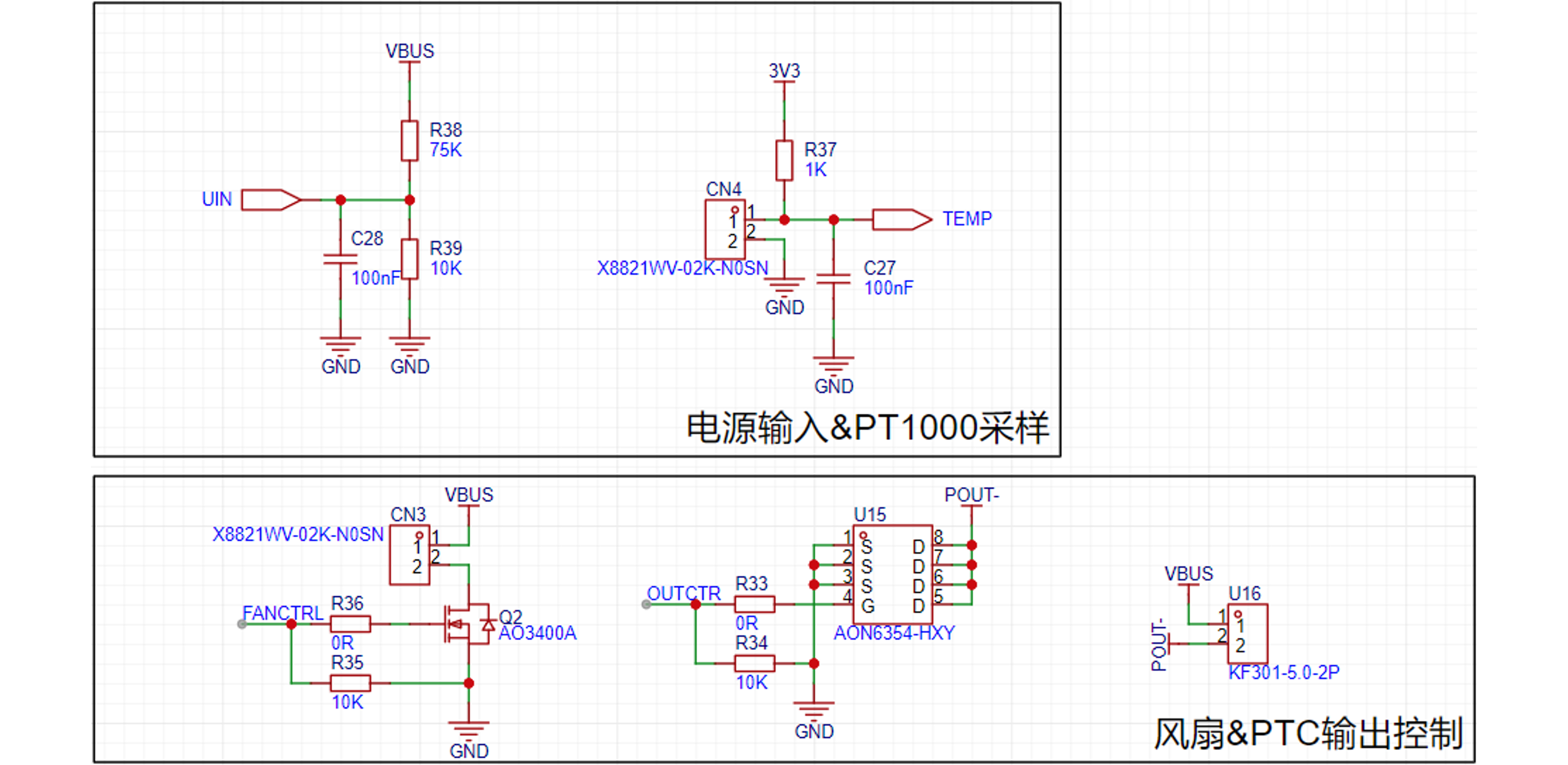

For the power supply, the input uses a DC socket + Type-C scheme; the main power supply VBUS directly supplies the PTC heater and fan; the main power supply is stepped down to 3.3V via a DC-DC converter for powering the ESP32-C3, OLED, etc.
A Schottky diode SS54 is connected between the DC socket and VBUS for reverse connection and reverse current protection; a TVS converter is connected to prevent the PTC from being damaged by an input voltage greater than 20V. A CH224K is connected after the Type-C converter for PD spoofing, with Rset set to NC to spoof a 20V voltage.

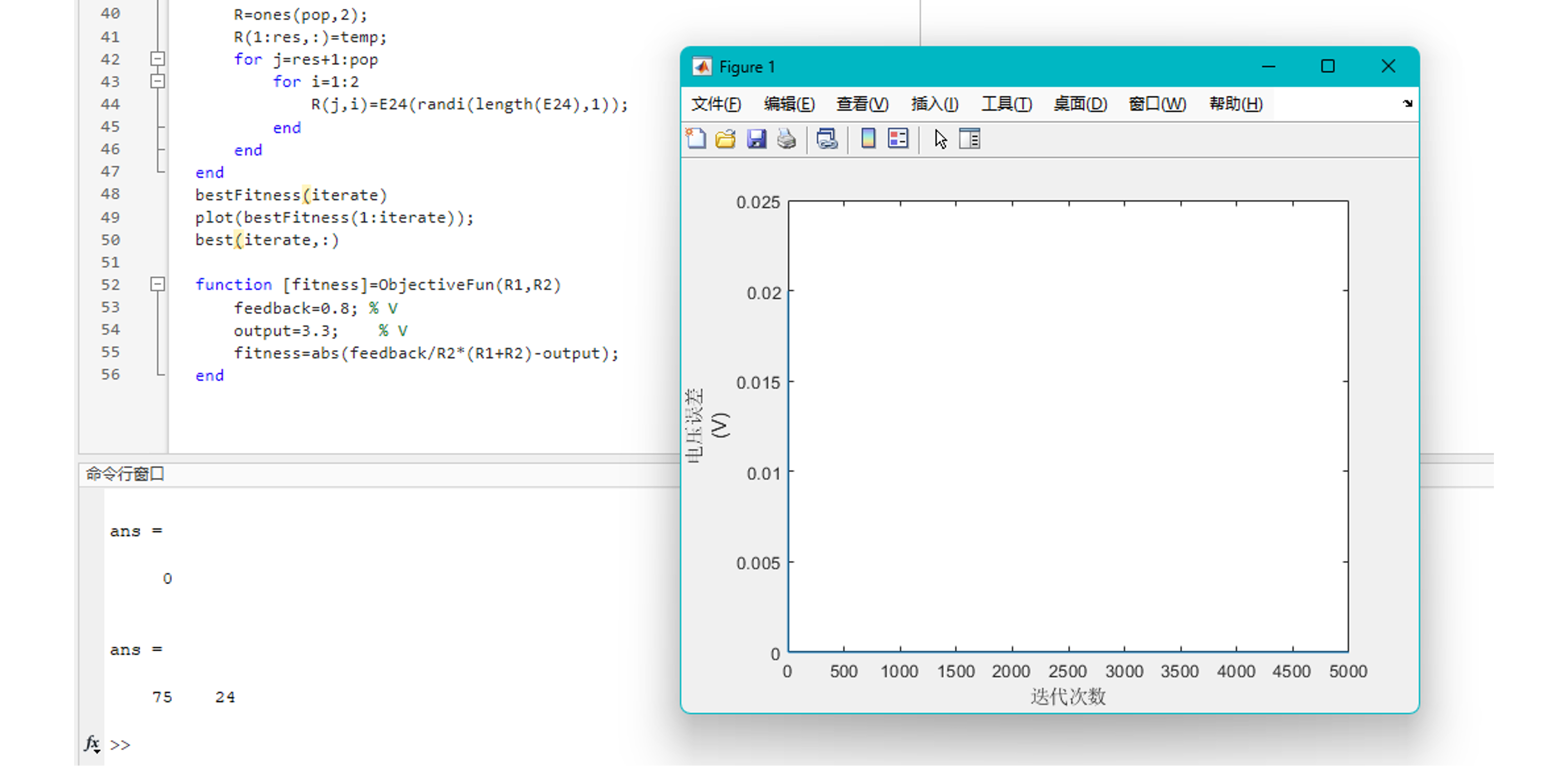

The DC-DC converter uses a Buck topology and is controlled by an MP2359 chip (available for free from Jiesheng Microelectronics & many Pin2Pin chips). The FB voltage is 0.8V, obtained through resistor division.
The voltage divider resistors were calculated using a genetic algorithm program written in Matlab, iteratively with voltage conditions substituted, with a theoretical error of 0V.
Figure 7 shows the FB resistor calculation
, but note that the output voltage may not be exactly equal to 3.3V, and subsequent ADC calibration requires adjustments to the calibration parameters as needed. (The actual voltage in this project's test was 3.345V, measured using an LCSC530 and a multimeter.)
Figure 8 shows the power supply schematic
. The active drying section consists of PTC heating control, fan control, and PT1000 measurement.
PTC heating control and fan control are implemented using NMOS switching circuits. The fan current is relatively small, so an AO3400 NMOS is used; the PTC requires a larger current, but only a few amps, which can generally be met by a DFN-8 (5x6) packaged NMOS.
The PT1000 measurement involves forming a voltage divider circuit with a 1kΩ resistor, measuring the voltage between the PT1000 and the 1kΩ resistor. (Too lazy to add op-amps for range switching, so I'll just do the software calculation.)
Figure 9
: Schematic diagram of the active drying section. The temperature and humidity monitoring section uses the Sensirion SHT30 temperature and humidity sensor, with data exchange via I2C bus.

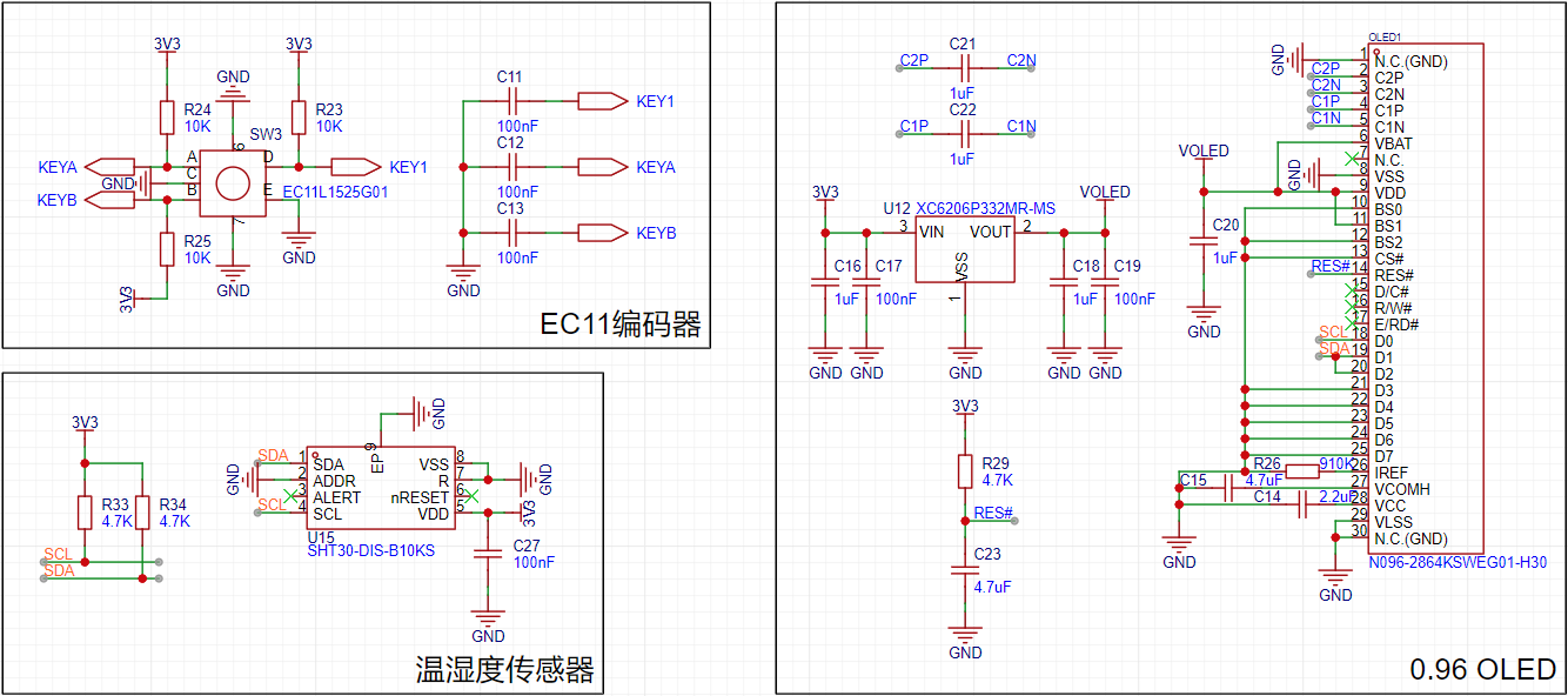

The human-machine interface consists of a 0.96" OLED and its driving circuit, and an EC11 encoder.
The OLED selected for this project is the SH1106 128x64 0.96" 30Pin I2C protocol OLED. Generally, 30-pin 0.96" OLEDs are compatible; the EC11 encoder stem height is arbitrary.
The SHT30 and OLED use the same hardware I2C.
In previous designs, two pairs of pins were used, with plans to use two sets of I2C buses. However, during programming, it was difficult to implement Wire1 using library functions (sorry, my coding skills are lacking), so it was changed to use the same pair of pins and the same hardware I2C bus.
Using software I2C for screen access has a significant latency, which will be explained in the subsequent software section.
Figure 10: Schematic diagram of temperature and humidity monitoring section & human-computer interaction section

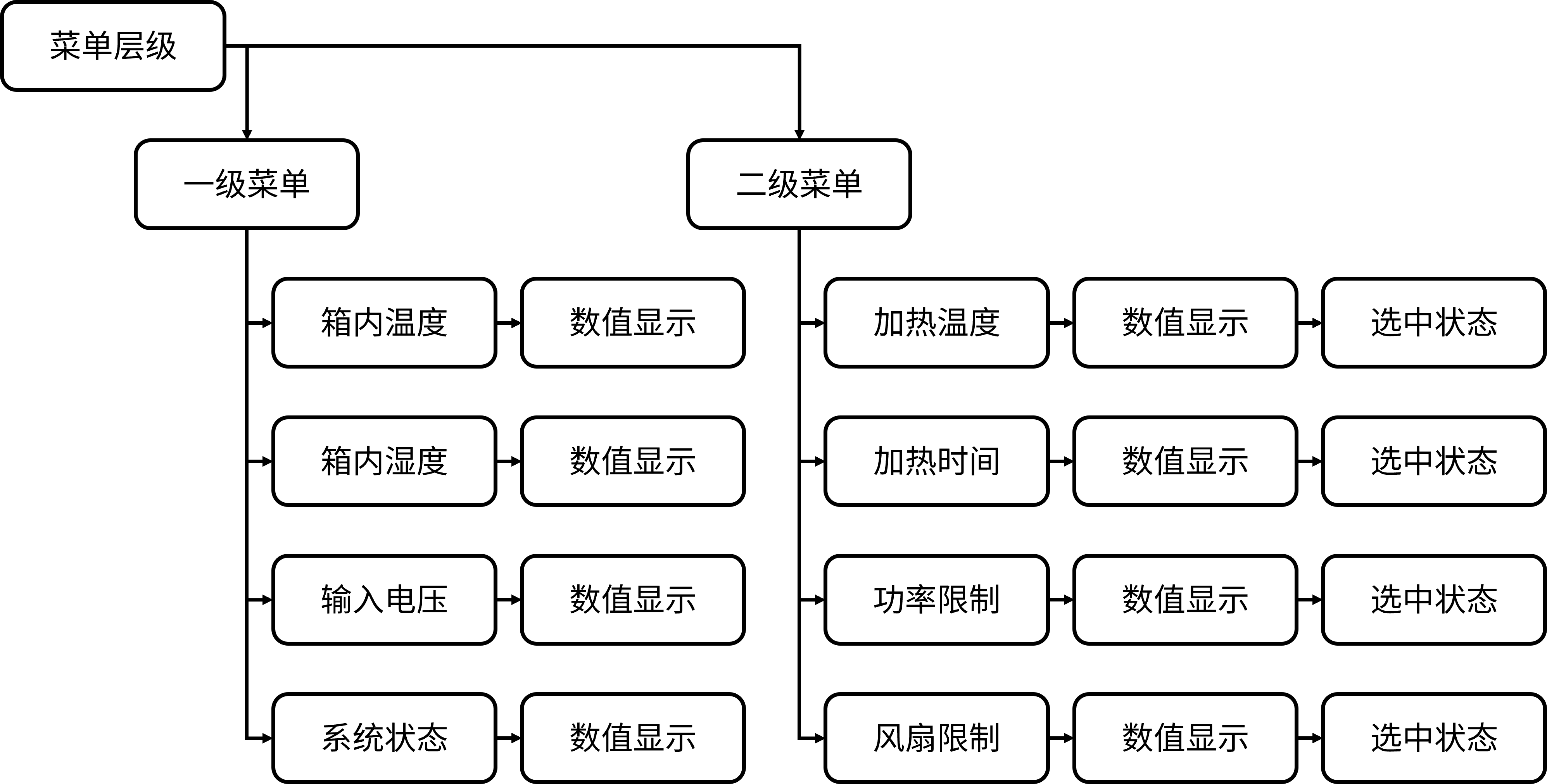

• Menu Logic
This project has a two-level menu. The first-level menu displays the current system status (temperature, humidity, input voltage, system status); the second-level menu sets parameters for active drying (heating temperature, heating time, fan and PTC power limits).
In the program design, a boolean variable is used to determine the menu level. Entering each level of the menu, the corresponding item is printed and its value is requested. String() is used to convert the value to a string, which is then concatenated with "+" and displayed in one output.
The second-level menu requires editing specific items, adding a selection option. Therefore, an unsigned char variable is added to store the selected target number, ranging from 0 to 3. When the target number equals the item number, an asterisk (*) is output at the end of the line as a selection marker.
In the second-level menu programming, a structure is used, greatly simplifying the program's complexity (the first-level menu is used as is and I'm too lazy to modify it). The structure stores the item name, unit, value, and adjustment scale.
Using a for loop in conjunction with the struct print statement can greatly compress the program content used for display.
The program is as follows:
struct element{ char* name; char* unit; unsigned char value; unsigned char scale;}; element Setting_Element[] = { {"Heating temperature: ","℃",60,1}, {"Heating time: ","min",0,1}, {"Power limit: ","",32,8}, {"Fan speed: ","",64,8},};
The menu display logic is as follows:
Figure 11 Menu display logic

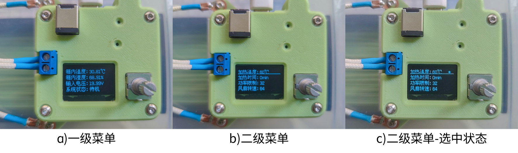

The menu display effect is as follows:
Figure 12 Menu display effect

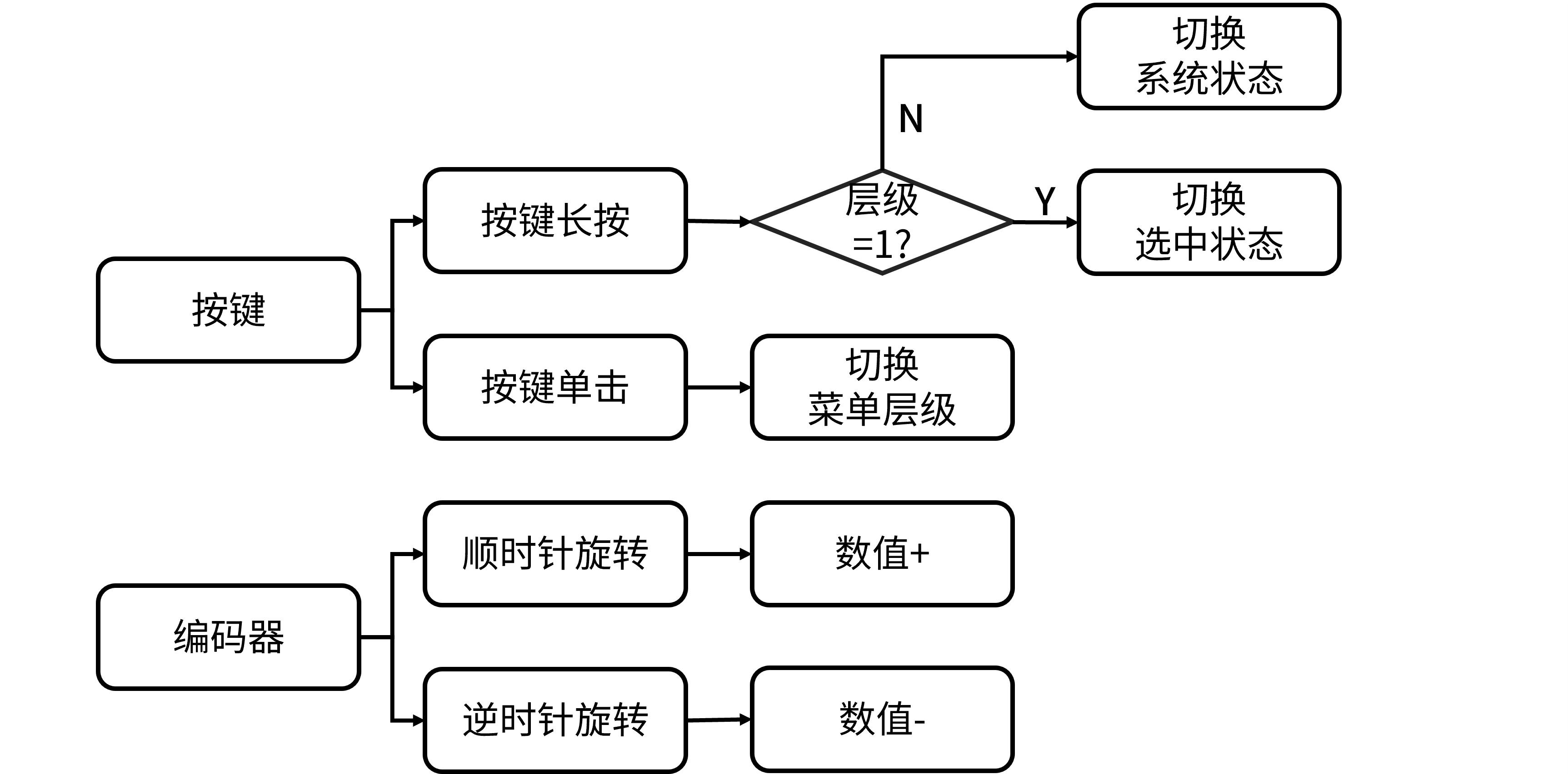

Input logic
Input is mainly divided into encoder input and button input. The encoder can increase or decrease the value by rotating; the buttons can realize the selection and switching effects through function reuse.
The OneButton library provides a variety of button states. This project only uses two types: single button and long button (because the display time in the main loop is long, double-click recognition is less accurate, so it is discarded).
The Encoder library can record the current encoder position. By comparing the current position with the previous position, it can be determined whether the value has increased or decreased (some jitter still exists in actual use).
The input interaction logic is shown in
Figure 13.

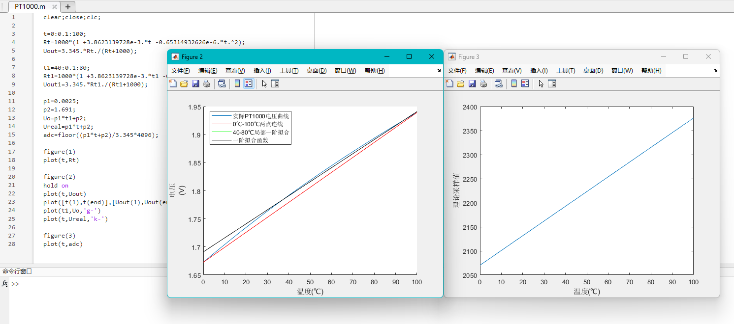

The resistance of the PT1000 is 1kΩ at 0℃, and the resistance increases with the temperature. However, the relationship is not linear, so it needs to be processed.
Considering that the heating temperature is mostly between 40 and 80℃, this project abandons the measurement accuracy below 40℃ and above 80℃, and adopts a local fitting method to obtain the relationship between temperature and sampled values.
Based on the PT1000 temperature calculation formula, an actual temperature-voltage curve was established. Then, a portion from 40-80℃ was selected and a first-order linear fit was performed using Matlab cftool. The fitting result is shown in
Figure 14.
The green line (local first-order fit) overlaps with the black line (first-order fitting function) in the figure.
However, due to the lack of a tool for temperature calibration, the fitting effect cannot be determined. Furthermore, due to the offset of the ESP32-C3's ADC, the measurement results will inevitably contain some error.

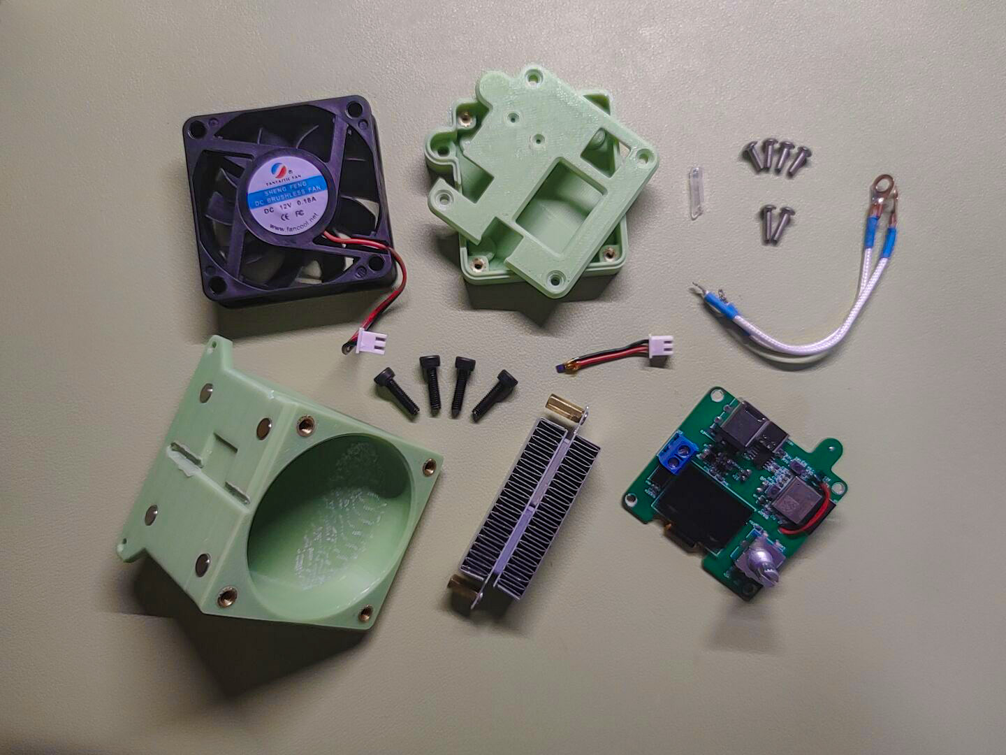

*6. Bill of
Materials (BOM) 6.1 Assembly
List 1 Assembly
List No.
Item
Quantity
Remarks
6CM Fan
Thickness not limited
6x3 Magnets
Ensure proper alignment during installation
M4x4x5.5 Hex nut
M4x14 Socket head bolt
M3x3x4.5 Hex nut
M3x12 Copper post
M3x8 Copper post
M3x4 Flat head screw
PT1000
XH2.5 4-2P terminal wire
PTFE tubing
A small section, outer diameter 4mm (Those who play with 3D printing probably have this, right?)
M3x10 Screws
Round head or flat head
M3x8 Screws
Countersunk head is best
Copper lugs
Hole inner diameter >3mm
PTC heater
12V 50W
Controller module
17. One printed part
