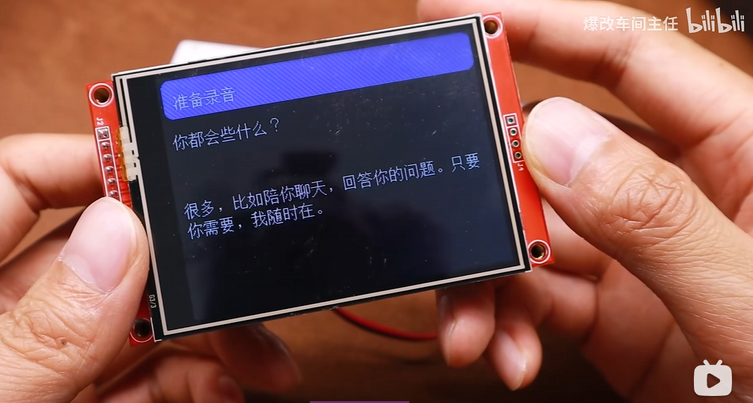

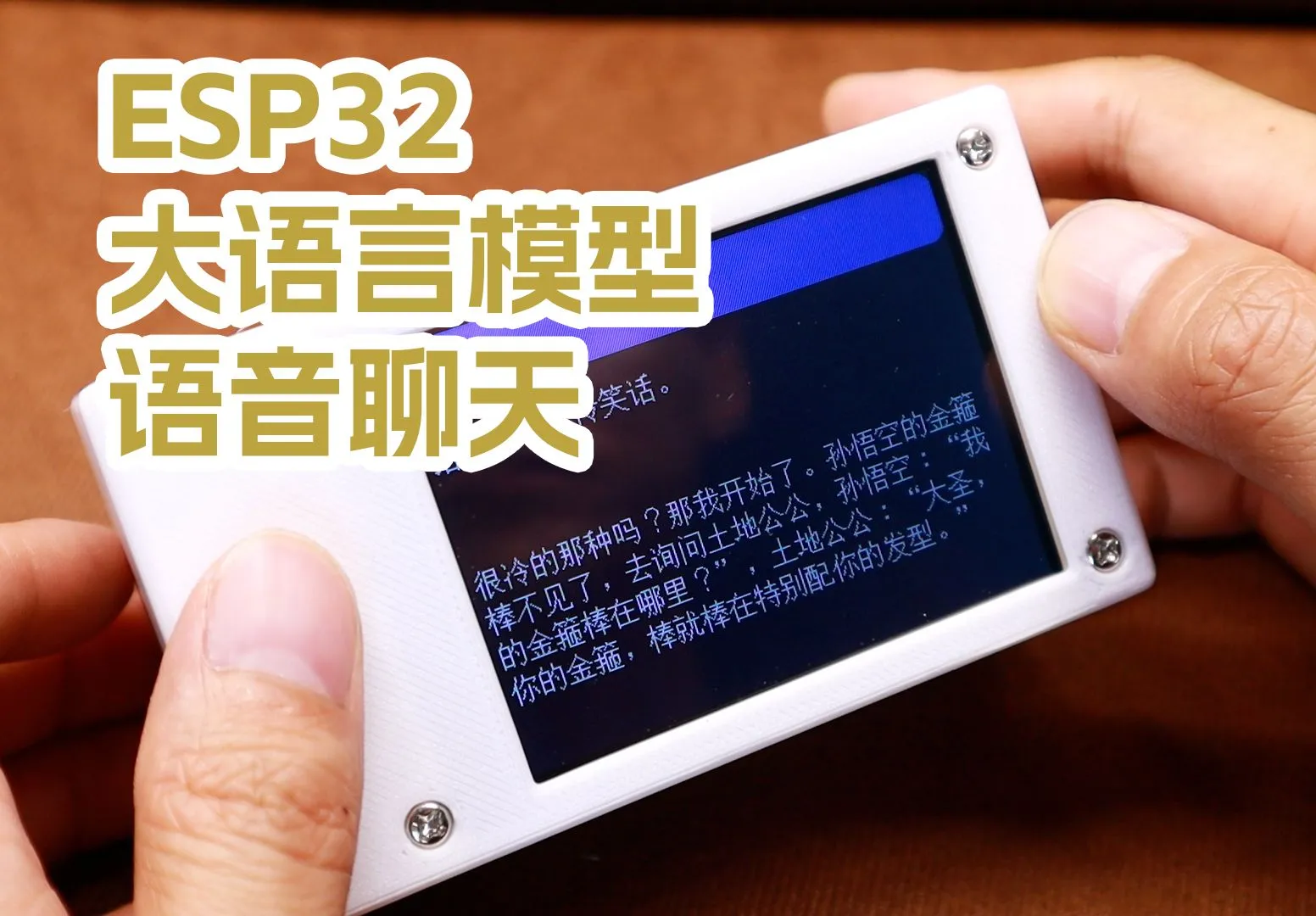

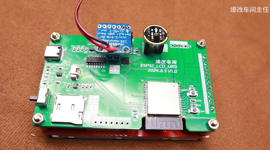

The ESP32S3 uses the INMP441 to receive audio, sends the PCM audio data to the STT speech recognition service to convert it into text, then sends the text to the Large Language Model API to ask a question, and finally sends the text response to the TTS speech synthesis service. The audio is then played back via the MAX98357A, with interactive display using a TFT touchscreen.

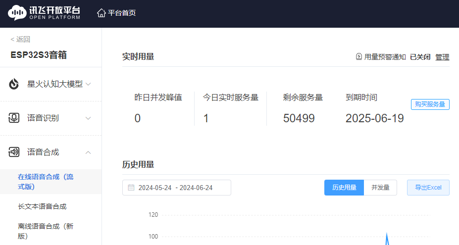

Both the STT Chinese language recognition and TTS speech synthesis in this project use the iFlytek API. You need to register an iFlytek account (https://www.xfyun.cn/) and receive a trial package to use the service for free.

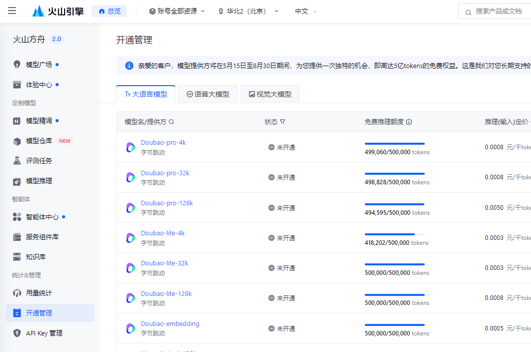

The large language model in this project uses the same engine as Doubao from Volcano Engine (https://www.volcengine.com/product/ark). Registering an account and receiving a free trial is required, and you can try it for a period of time.

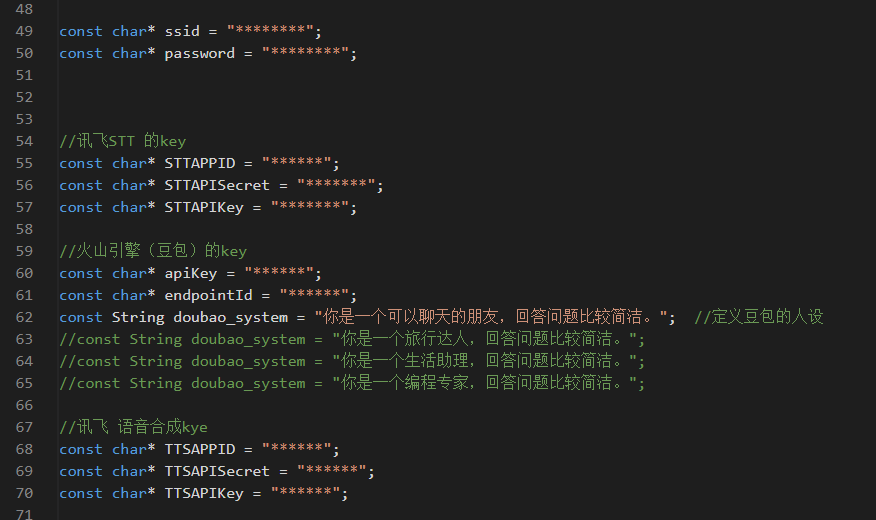

For the three APIs mentioned above, you need to obtain the keys from their respective official website consoles and modify the relevant fields in the code to connect to the API normally. The code also needs to modify the WiFi connection information.

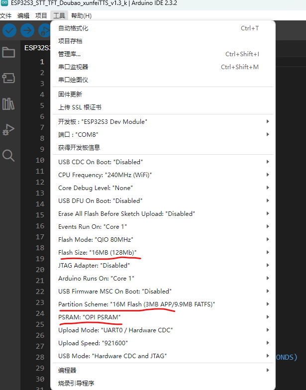

The compilation environment is as follows
: Compilation software: Arduino IDE 2.3.2
; SDK: ESP32 SDK 2.0.13 (downloadable from the development board management);
Main libraries used: TFT_eSPI 2.5.43 (downloadable from the library management),
                     U8g2_for_TFT_eSPI (download address: https://github.com/Bodmer/U8g2_for_TFT_eSPI);
Development board setup:
The attached source code package contains a Base64_Arturo library, which needs to be copied to the libraries/ directory.

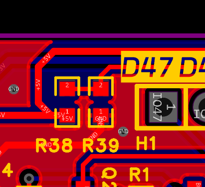

On the motherboard, resistors R38 and R39 control the pull-up and pull-down pins of the MAX98357A module's GAIN interface. You only need to solder one of them, or none at all. Do not solder both simultaneously. Note that they are left floating by default.
GAIN pin function:
GAIN is, well, the gain setting. You can have a gain of 3dB, 6dB, 9dB, 12dB or 15dB.
15dB if a 100K resistor is connected between GAIN and GND
12dB if GAIN is connected directly to GND
9dB if GAIN is not connected to anything (this is the default)
6dB if GAIN is connected directly to Vin
3dB if a 100K resistor is connected between GAIN and Vin

The battery plug is a 1.25mm pitch positive connector, supporting only a single 3.7V lithium battery. The Type-C interface has a charging function and can charge lithium batteries.
The speaker: MAX98357A can drive a 3W speaker
. The serial module is CH340C; note the "C" designation.
The display screen is a 3.2-inch touchscreen. Reference link: https://item.taobao.com/item.htm?spm=a1z09.2.0.0.54402e8dfVHHff&id=643516677167&_u=o2oqo1kfcc57
The motherboard has an MPU-6050 gyroscope, originally intended for screen rotation tracking, but not used in this project. It can be left unsoldered if not used for this purpose. For
