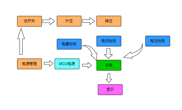

1.1.1 Mind Map: The
Mind Map file contains the mind map, logic diagram, and physical block diagram used in this project.

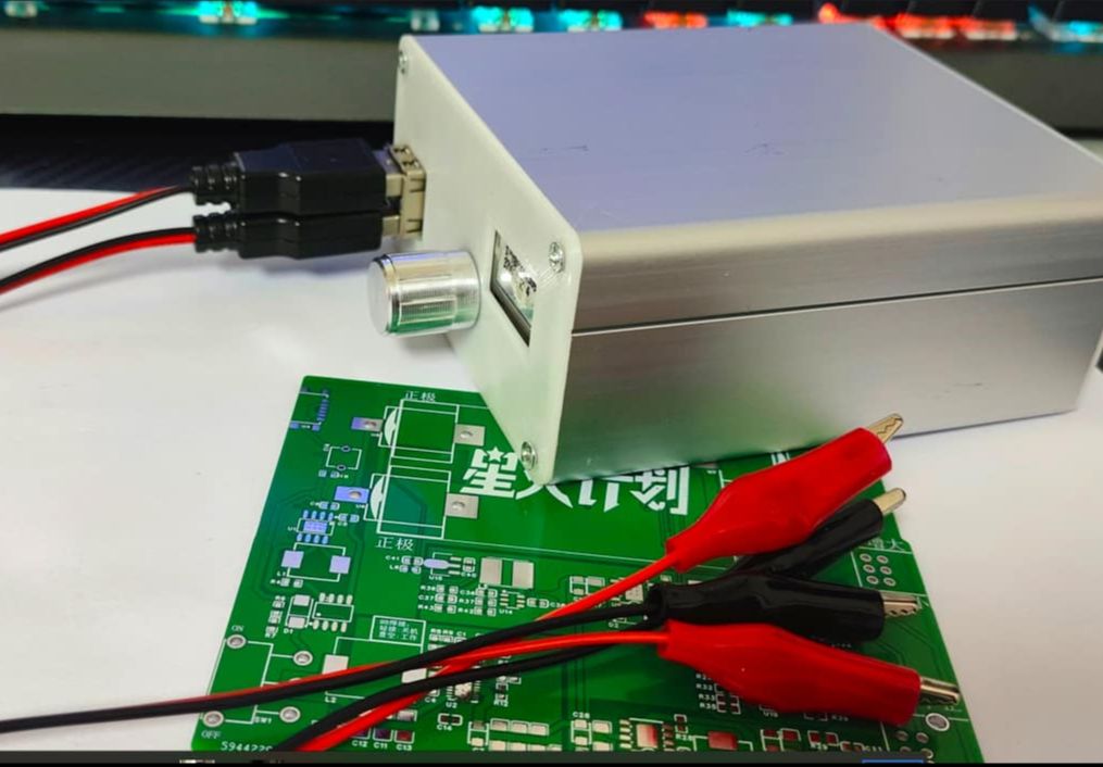

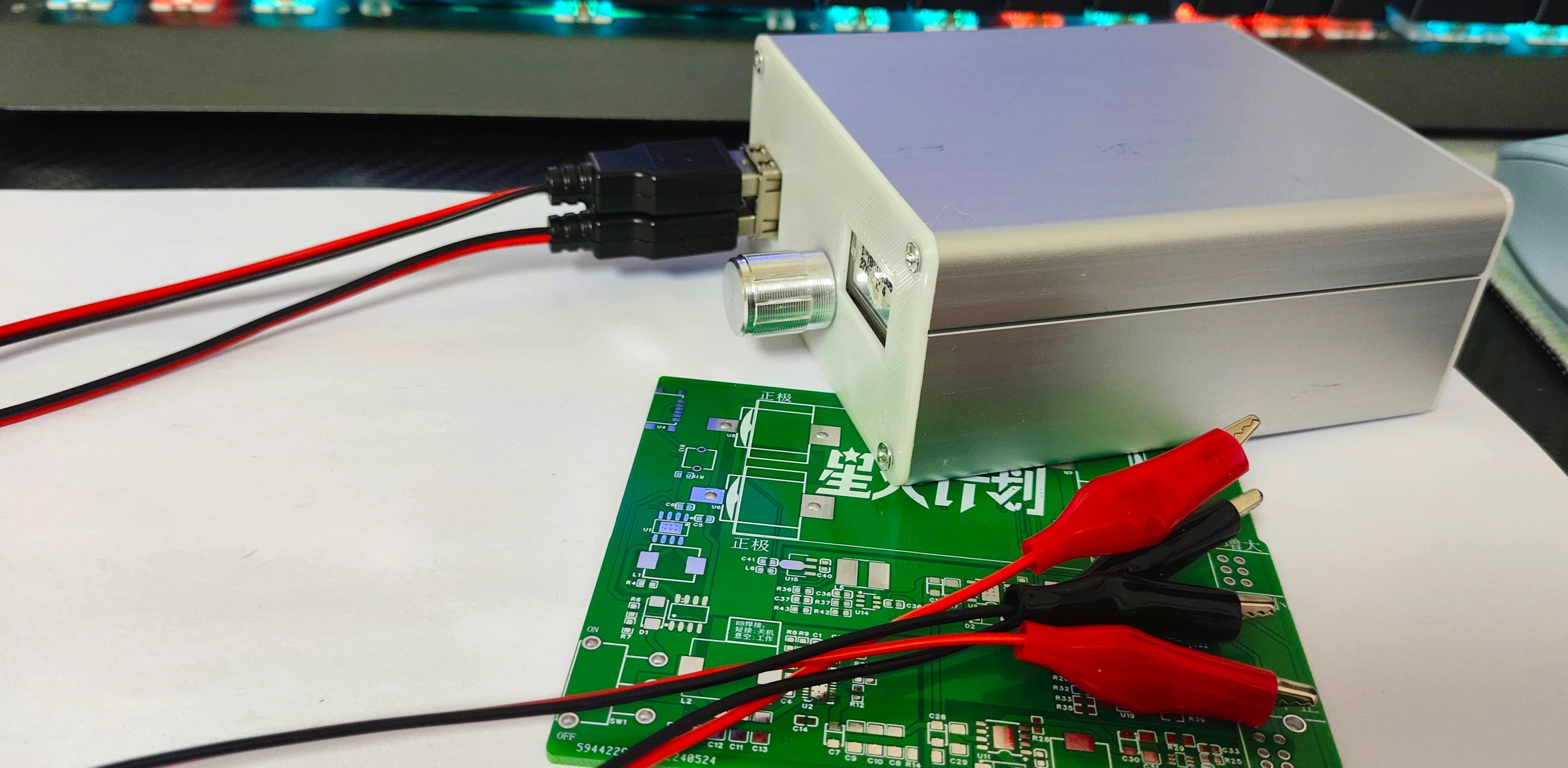

2.2 Shell Design:

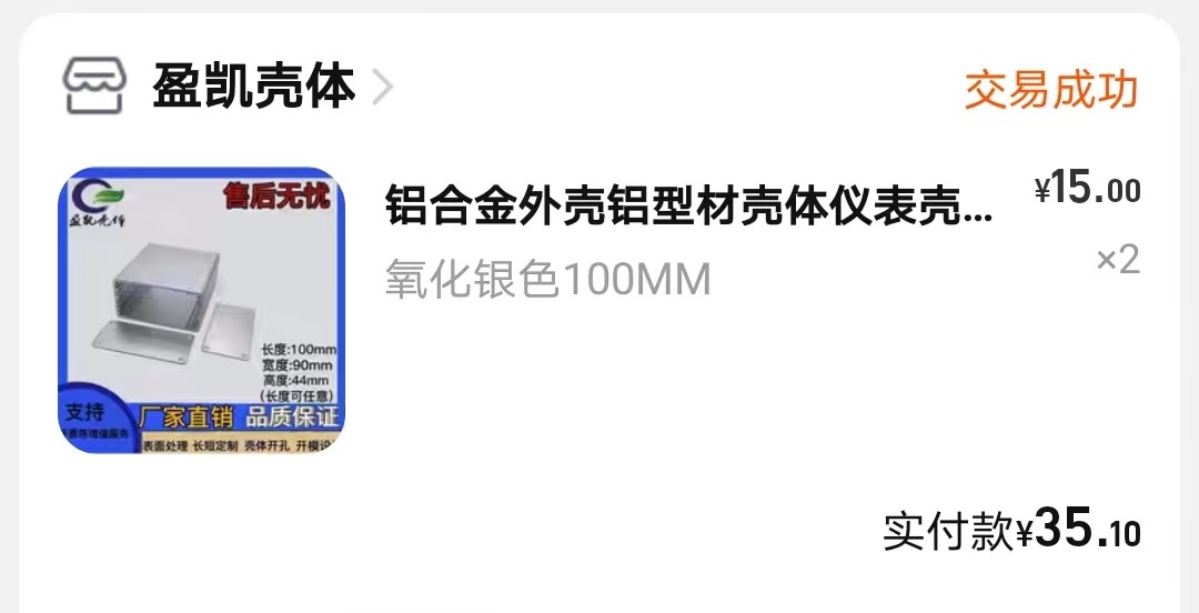

The main shell is made of aluminum alloy, with dimensions of 100*90*44mm. The control indicator panel is made of PCB board, aluminum alloy, or other materials.
2.3 External Components (OLED bare screen, 100K dual potentiometer, USB alligator clip)

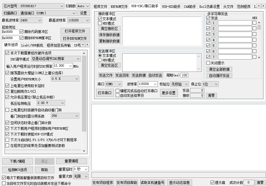

3.1 Terminal main
control chip is STC8H1K17

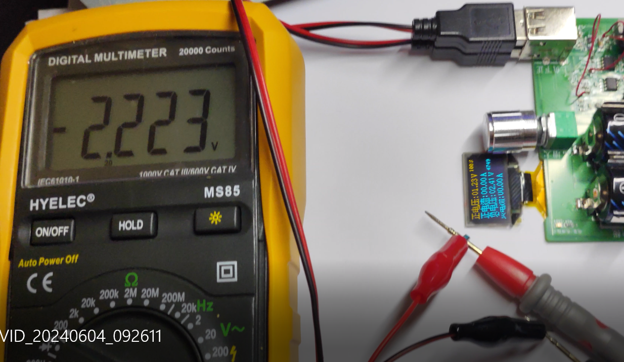

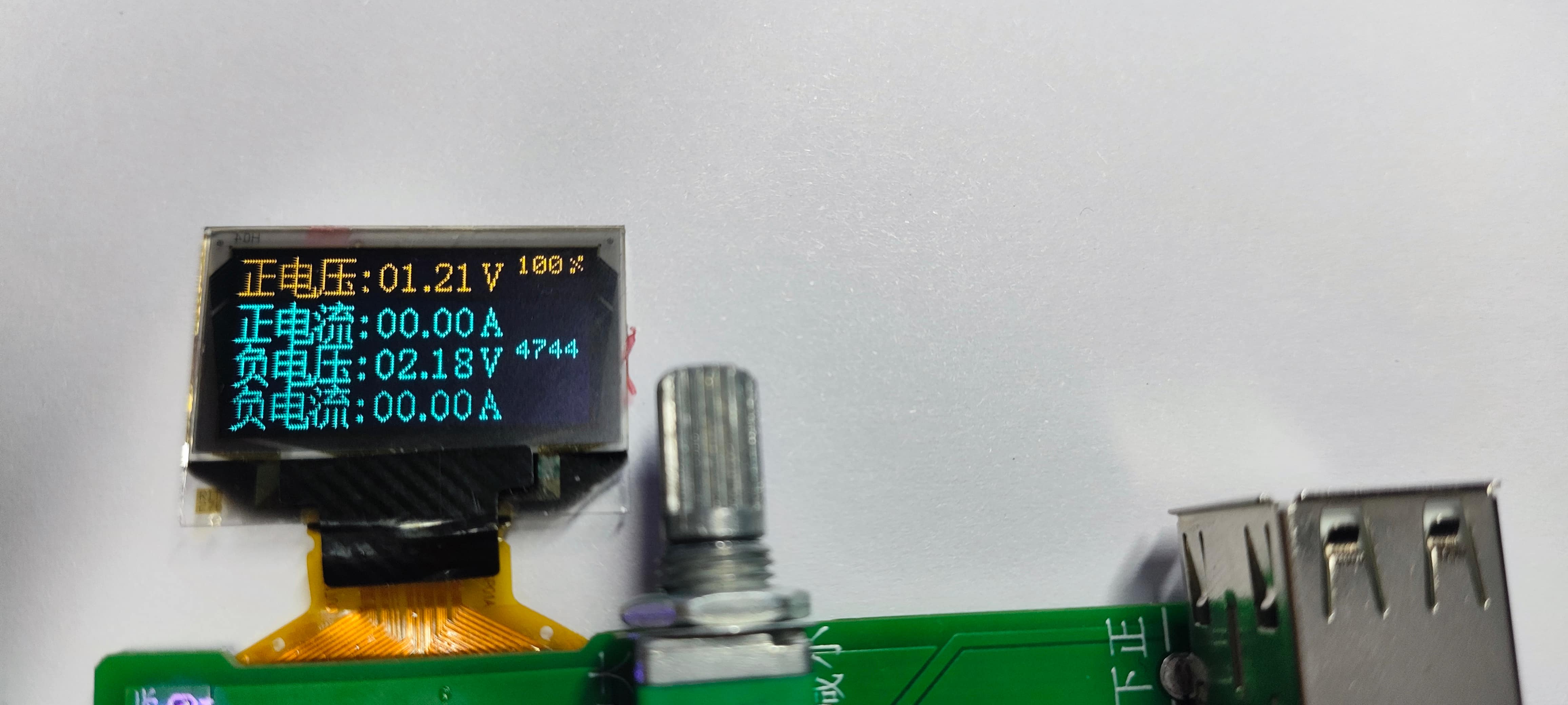

(1) Adjustable positive and negative power output 1.3V~11V/3A
(2) Real-time battery power display
(3) Real-time output voltage and current display
5.1 Accuracy
Voltage: 0.1V
Current: 0.2A
Power: 2%

(1): The crystal oscillator circuit of the MCU circuit in the application does not need to be soldered. The crystal oscillator frequency is adjusted to 12MHz when downloading.
