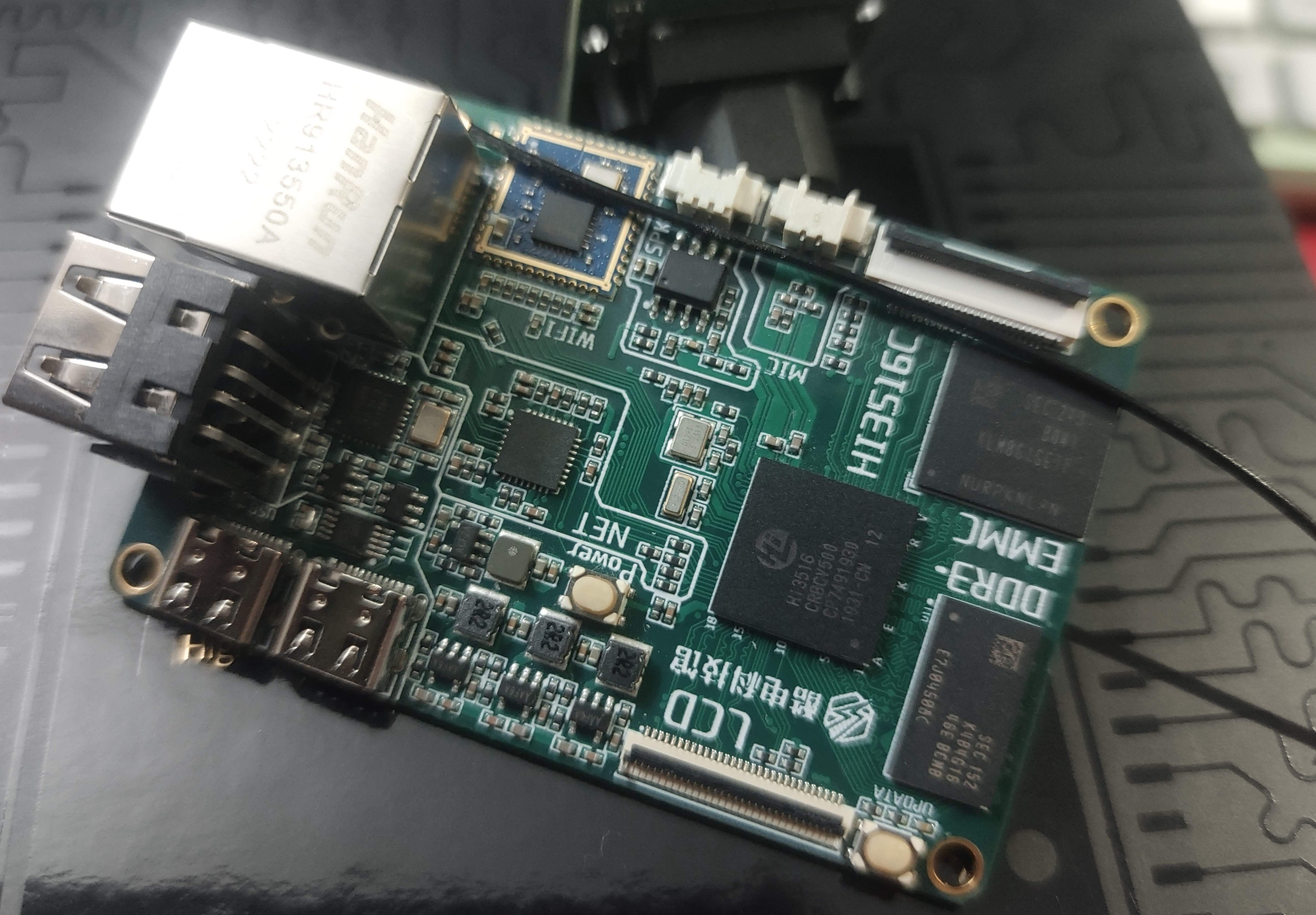

Project Description: This project utilizes the
Hisilicon HI3516CV500 development board/dashcam/electron microscope, equipped with a MIPI display and an IMX327 camera. It employs Linux + QT/LVGL + MPP libraries to implement video capture and display, video encoding and storage, and a GUI display. The
open-source
software and hardware are licensed under GPL 3.0.
Project Functionality:
The Hisilicon HI3516CV500 development board/dashcam/electron microscope is a development board used for learning Linux development and Hisilicon audio/video codecs. Based on this hardware, a dashcam/electron microscope demo software is implemented, implementing video capture and display, video encoding and storage, and a UI interface.
Project Attributes:
This is the first public release of this project, and it is the author's original work. This project has not won any awards in other competitions.
Project Progress
March 18, 2023
Hardware Testing Progress: WIFI + Ethernet Port + USB HUB + DDR3 + eMMC + TF-Card + LCD + Camera debugging completed.
Software Completion Progress: Uboot + Kernel + rootfs trimming and porting completed; QT + SSH + DHCPCD open source library porting and deployment completed; VIO + HIFB + VENC MPP library case debugging completed.
January 13, 2024
New Software Progress: Porting LVGL to the development board; source code will be added later after organization.
May 30, 2024
    1. Implemented a dashcam demo case based on LVGL GUI, realizing video preview, video encoding and storage, menu settings, etc.
    2. Improved supporting SDK functions
        : ① Supporting uboot/kernel: Added RTL8189FTV WIFI module driver, GT911 touch driver, FT5x06 touch driver
        ② Added supporting eMMC Uboot table, added supporting device tree (SD card, eMMC, PHY Ethernet driver function adaptation).
        ③ Supporting MPP libraries: Adapting to sensor drivers, video encoding (VENC), video input/output (VIO), RTSP streaming, HIFB (Linux FB), and other examples.
        ④ Porting third-party libraries: Adding dhcpcd, ssh, and qt libraries and their compilation and packaging.
        ⑤ Porting LVGL GUI: Implementing a dashcam demo case based on LVGL GUI.
Design principles
, hardware encoding/decoding, MPP library, LVGL GUI.
Software description:
