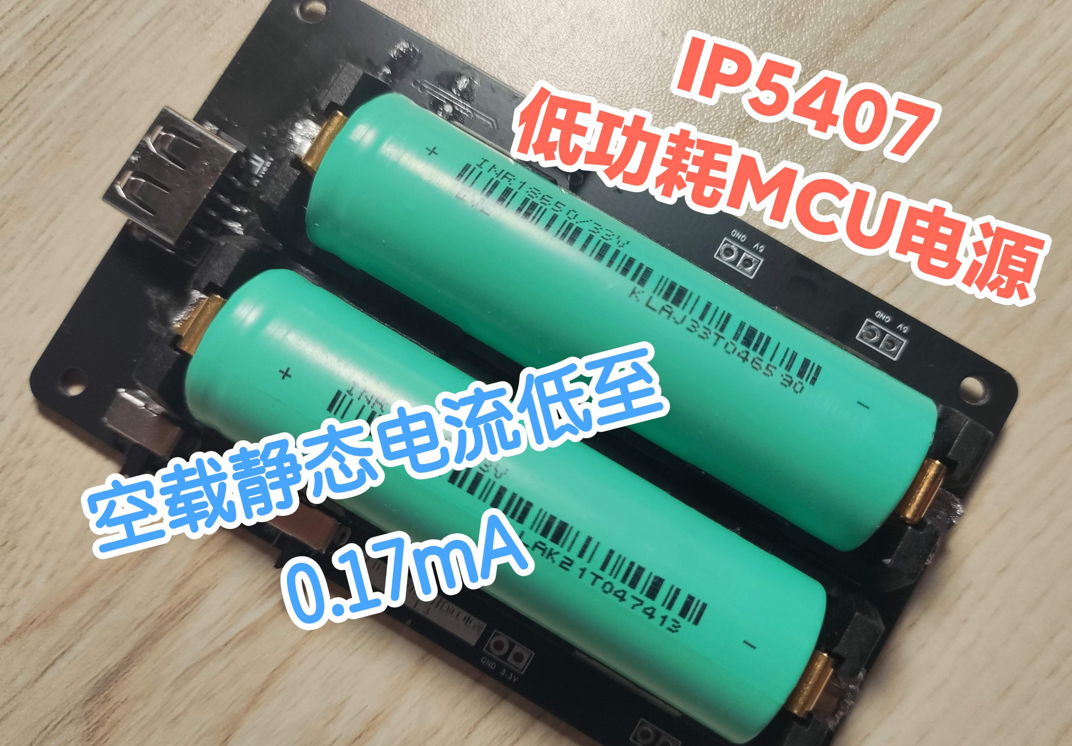

My ESP8266+BME280 temperature, humidity and barometric pressure sensor is in a deep sleep state with extremely low power consumption most of the time. Most power banks on the market can only keep the low current charging function on for a few hours.
I once used a power bank with a "always on" function, but it was solved by a resistor continuously consuming power, and the electrical energy was meaninglessly converted into heat energy. At the same time, its power indicator LED was also always on, which further increased the power consumption. Therefore, I had the idea of ​​designing a power supply specifically for low-power IoT devices.
1. Features at a glance
[x] Extremely low quiescent current 0.17mA
[x] 5V to 3.3V power supply
[x] 2 LED version, reducing costs
[x] 5V always on
[x] Lithium battery protection
[x] Simple and easy to solder, suitable for beginners
2. Main components used
2.1 IP5407_2D1D
After browsing around, I found that IP5407 supports fixed always on 5V and the standby power consumption is less than 150 µA, which meets the design requirements. Fortunately, the IP5407 has a special 2D1D version, which supports two LEDs, thus saving material costs by requiring only two indicator lights. The LEDs turn off approximately 30 seconds after the battery level is checked, reducing power consumption.

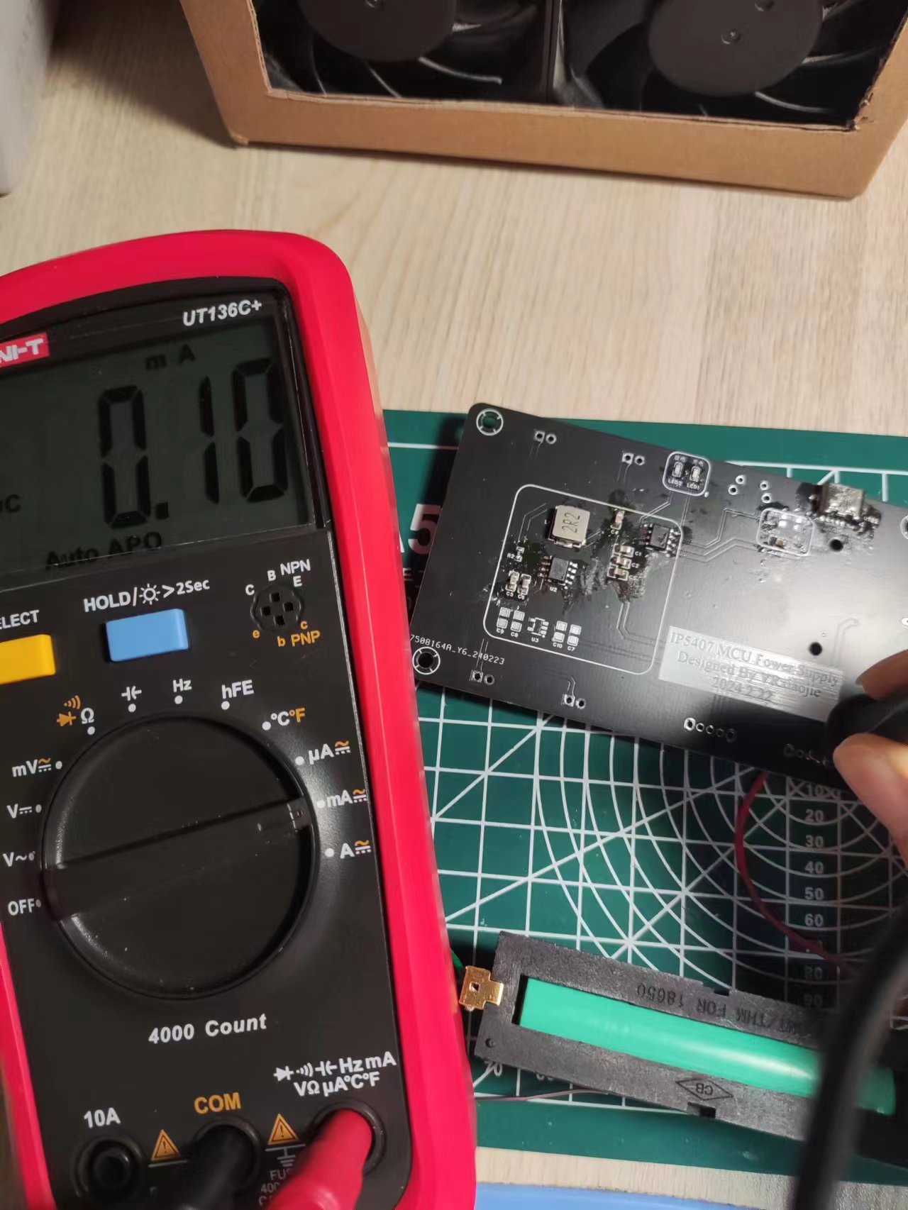

2.2 The IP3005A lithium battery protection IC
references the open-source project IP5407 charging module. Since the IP5407 doesn't provide much information on battery protection, a separate battery protection module is added for safety.

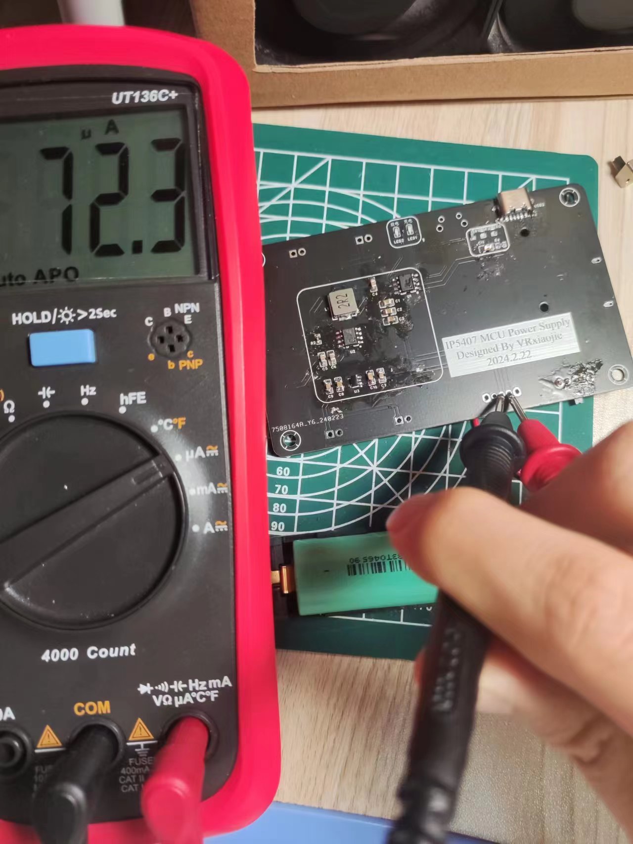

2.3 3.3V Power Supply:
Since the ESP8266 series operates on 3.3V, while the IP5407 boosts to 5V, an LDO is needed to convert to 3.3V.
Versions V1.2 and earlier use the AMS1117-3.3. However, as pointed out by @allstar2008 in the comments section, this LDO has a large quiescent current (Iq) (MAX 10mA, measured no-load 2mA), which significantly reduces battery life. Therefore, versions after V1.3 use the TLV70233DBVR LDO, which, according to the datasheet, has a quiescent current of only 0.03 mA.

(1) IP5407 + battery protection IC IP3005A Quiescent current
0.1 mA
(2) TLV70233DBVR Quiescent current
72uA = 0.072mA
