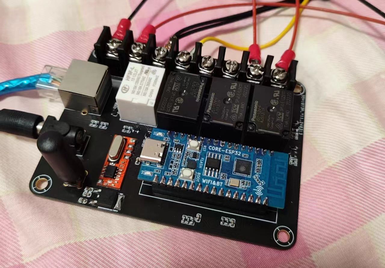

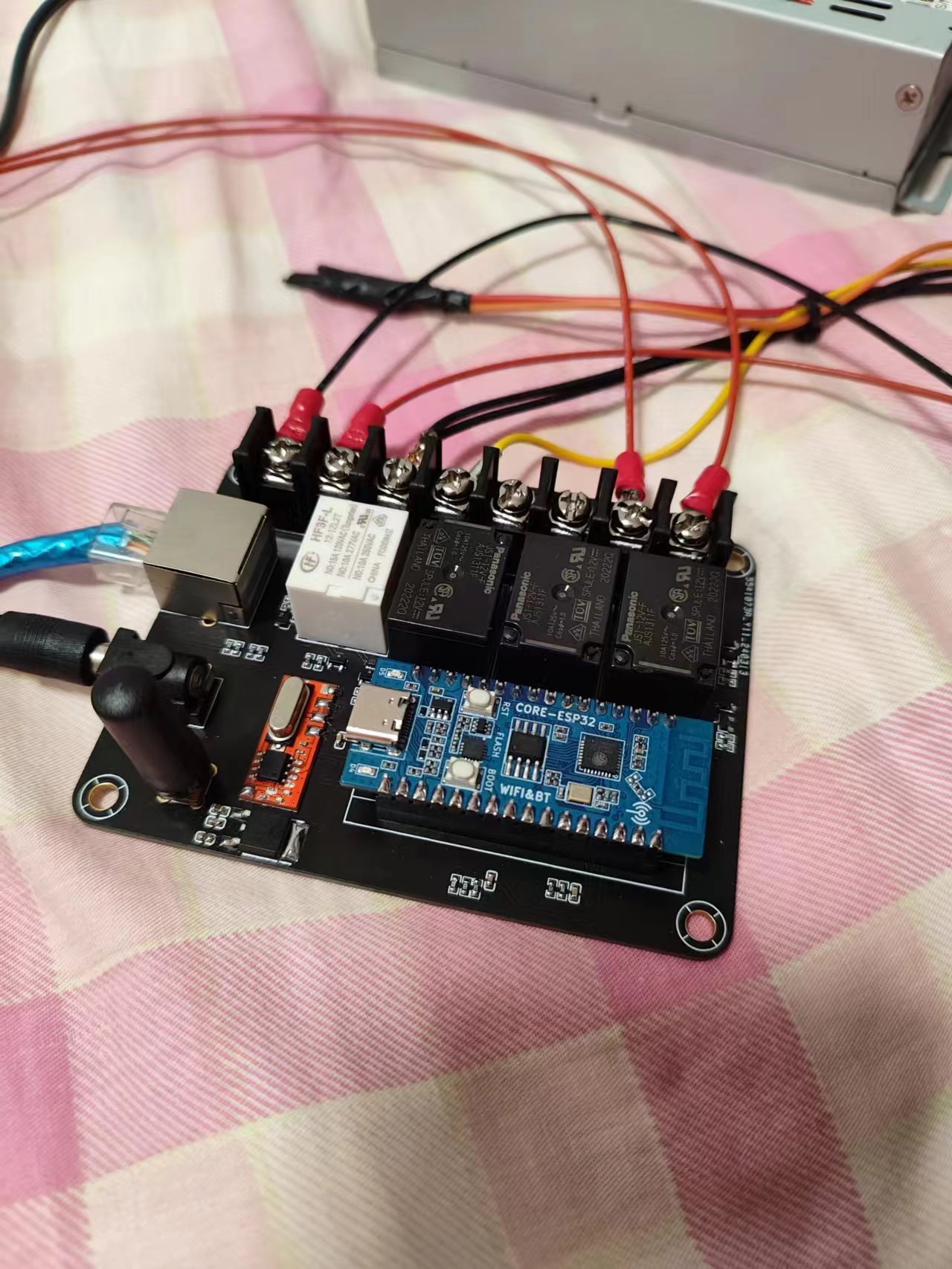

: The fingerprint module and ESP32 module use UART communication. After successful fingerprint recognition, the relay engages, and the electromagnetic lock automatically opens.
The ESP32 connects to the smart home control center via MQTT. Through MQTT communication, it can execute commands such as fingerprint enrollment, deletion, querying, unlocking, and checking the electromagnetic lock status.
It prioritizes mains power when available, automatically switching to 12V battery power during power outages. The ESP32's ADC port monitors the battery level; if the voltage is low, it initiates charging and automatically shuts off when fully charged.

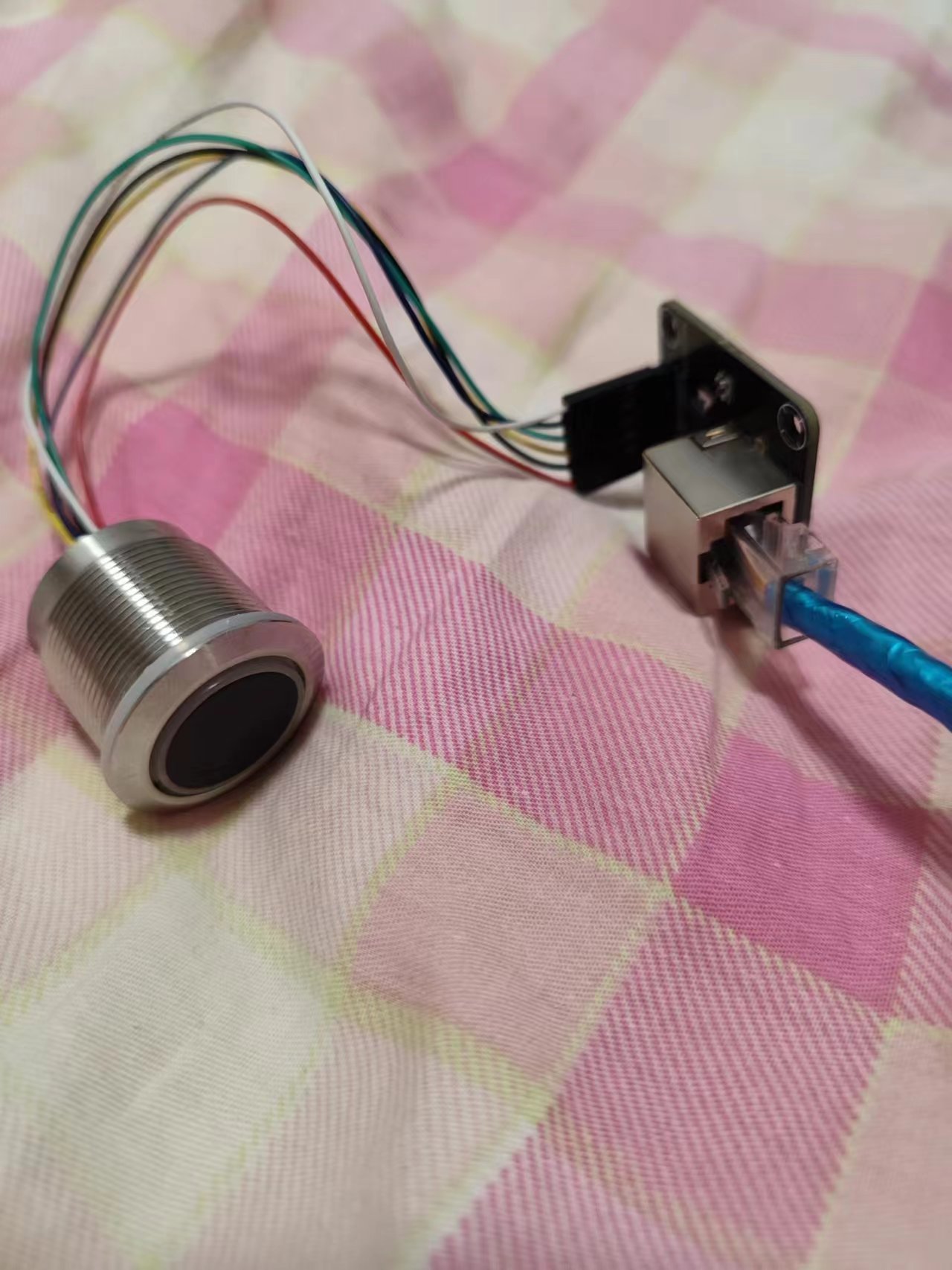

The main control module connects to the fingerprint reader via a network cable (this is only a connection cable and does not transmit data via the network) for UART data communication.

Main control module:
Fingerprint recognition module

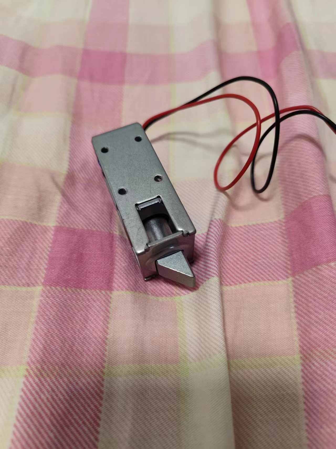

, electromagnetic lock, 12V, rated current 0.4A. The number of modules that can be connected depends on the relay and power supply. Because my cabinet only has 5 doors, I connected 5.
