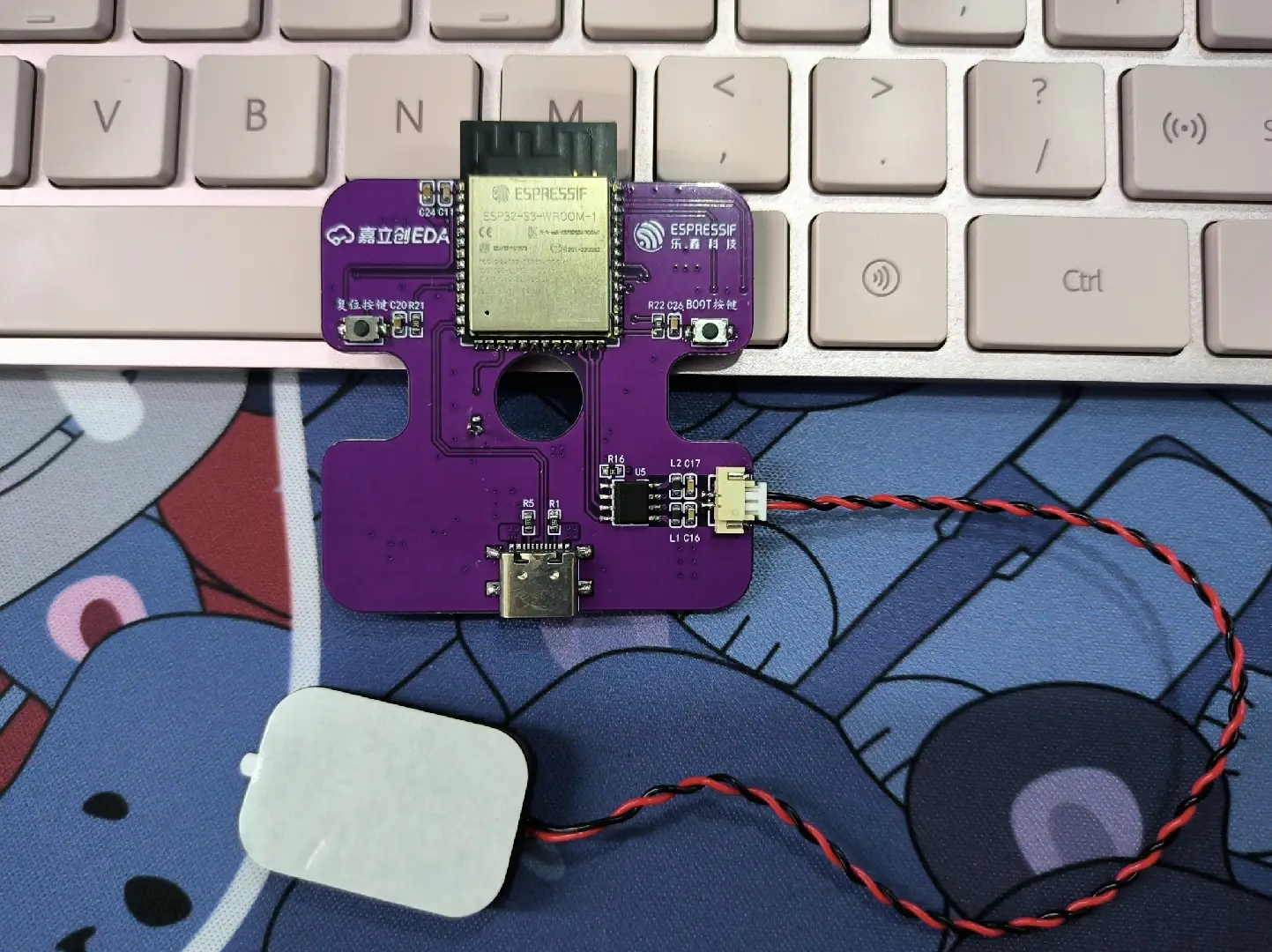

2.1 Power Supply Circuit

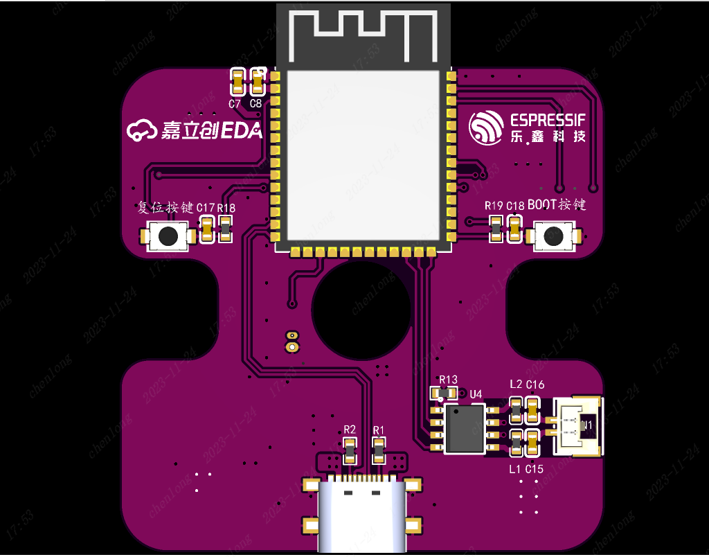

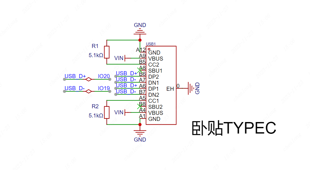

A TYPE-C-16P interface is used as the power supply interface. The corresponding USB data pins are connected to the corresponding USB pins on the S3 (USBD+ IO20) and (USBD- IO19), allowing direct USB download and debugging without conversion to serial signals. 5.1K pull-down resistors are added to the CC1 and CC2 pins for easy identification and configuration by different hosts.

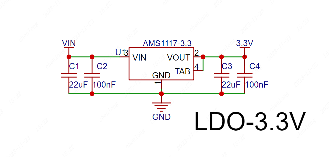

The AMS1117 is used as a 5V to 3.3V step-down LDO. The ESP32S3 consumes a significant amount of current when enabling wireless RF or performing voice analysis calculations. Considering the presence of other peripheral circuits, a power supply chip with an output current of at least 600mA was selected. The AMS1117, with an output current of 1A, meets this requirement.

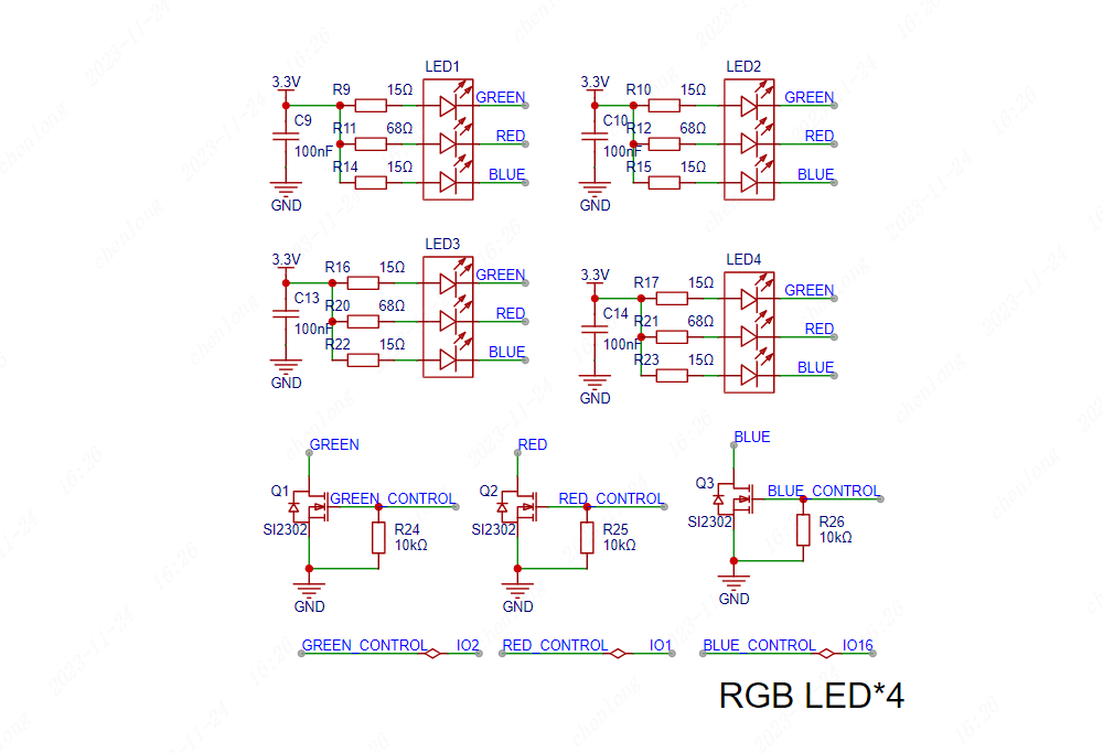

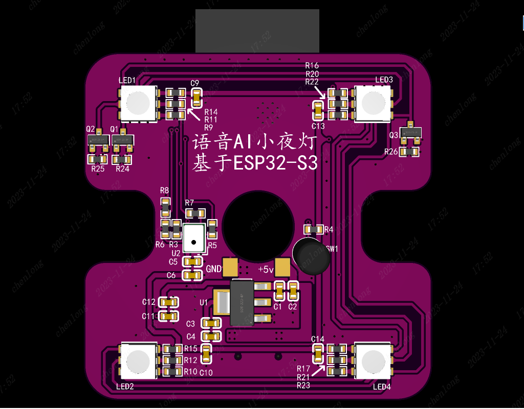

2.2 The LED lighting circuit
uses four RGB tri-color LEDs distributed around the perimeter of the board. Different display effects can be achieved by changing the brightness of different colors. Considering the different current requirements of red, blue, and green LEDs, different resistors are used in series in their respective branches. The brightness can be uniformly adjusted later by changing the resistance values. Each color LED is connected in series and controlled by a SI2302N channel MOSFET for unified conduction and shutdown. Brightness can also be adjusted by controlling the conduction time using PWM.
2.3 The main control section

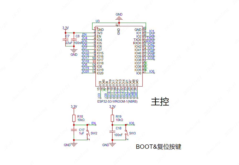

uses the ESP32S3N8R8 module as the main control chip. Note that if speech recognition is required, the resource library is relatively large; it is recommended to choose Flash and PSRAM of 8MB or more. In modules with OSPI PSRAM (i.e., the built-in chip is ESP32-S3R8 or higher), pins IO35, IO36, and IO37 are for connecting to the integrated OSPI PSRAM and cannot be used for other functions. These pins need to be marked as "not connected."

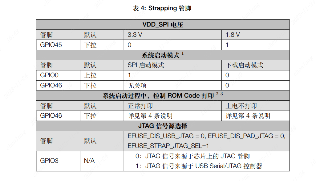

The ESP32S3 has four Strapping pins. When assigning pins, avoid adding pull-up or pull-down resistors to these pins to change their default state.

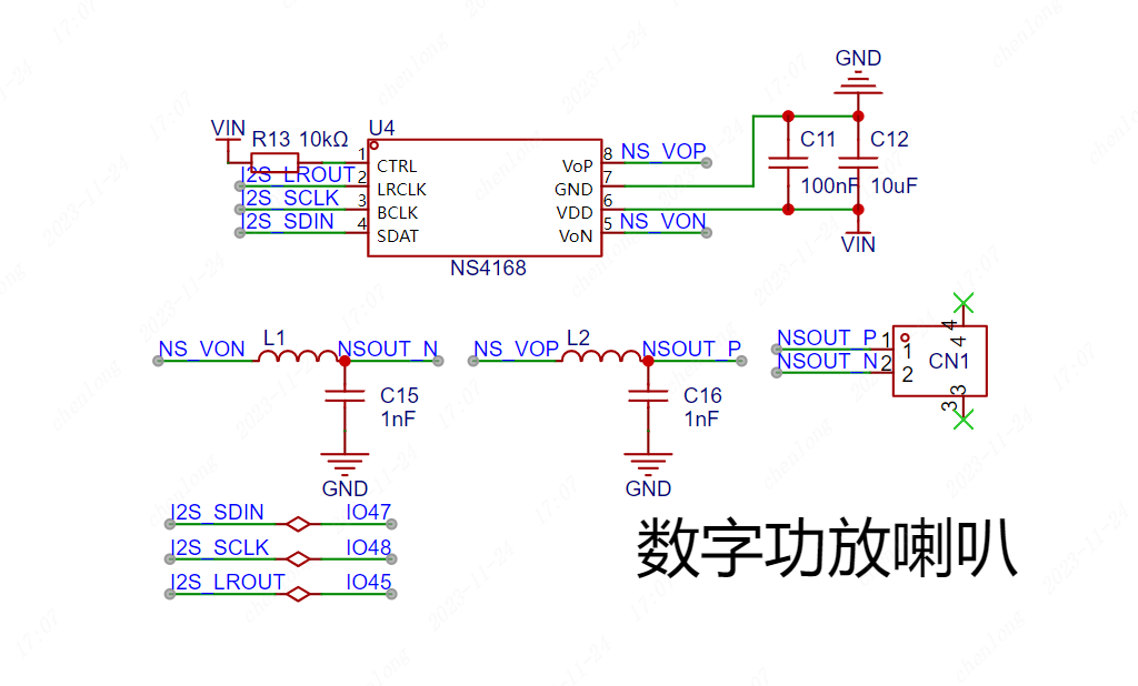

2.4 The speech recognition extension section

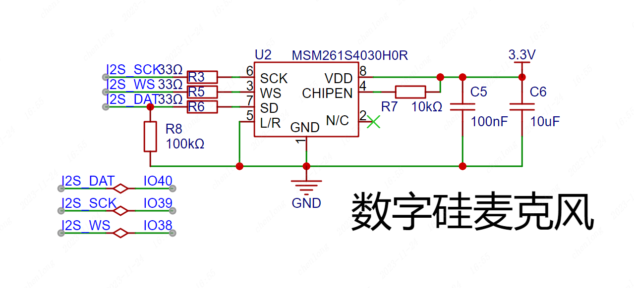

uses an I2S digital silicon microphone to receive the speech signal. At the I2S signal line, to obtain better anti-interference effect, a small series resistor can be used for impedance matching. A
Class D power amplifier chip with I2S signals is used for speech output. A ferrite bead and capacitor are added to the sound output path to form an LC filter circuit to reduce output interference. The external speaker is connected using a GH1.25*2P connector.
The ESP32S3 has two I2S controllers, and all I/O pins can be multiplexed into I2S pins via an internal matrix, allowing for flexible pin allocation.

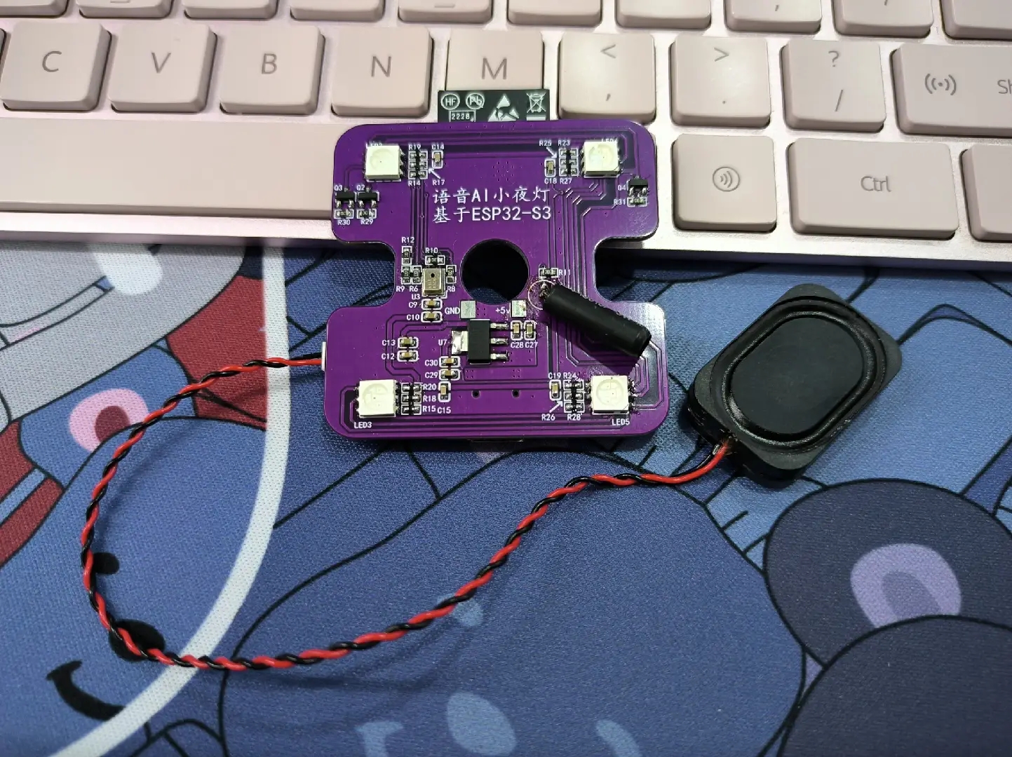

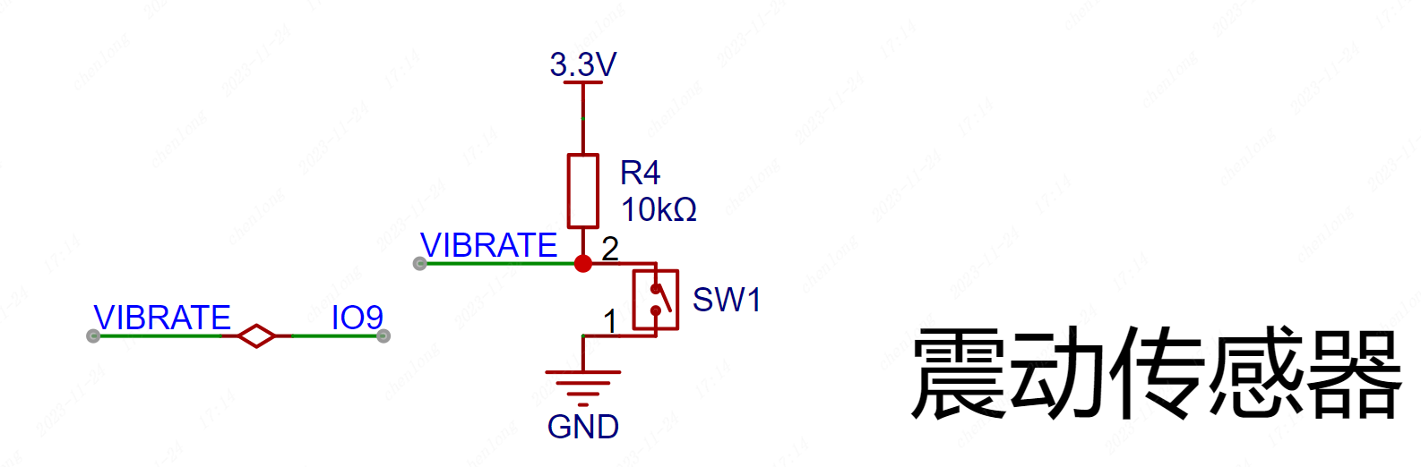

A vibration sensor is included, enabling different lighting effects when a hand taps the table, increasing its versatility. The vibration sensor has an internal spring structure, which can be simply understood as a spring-loaded button.

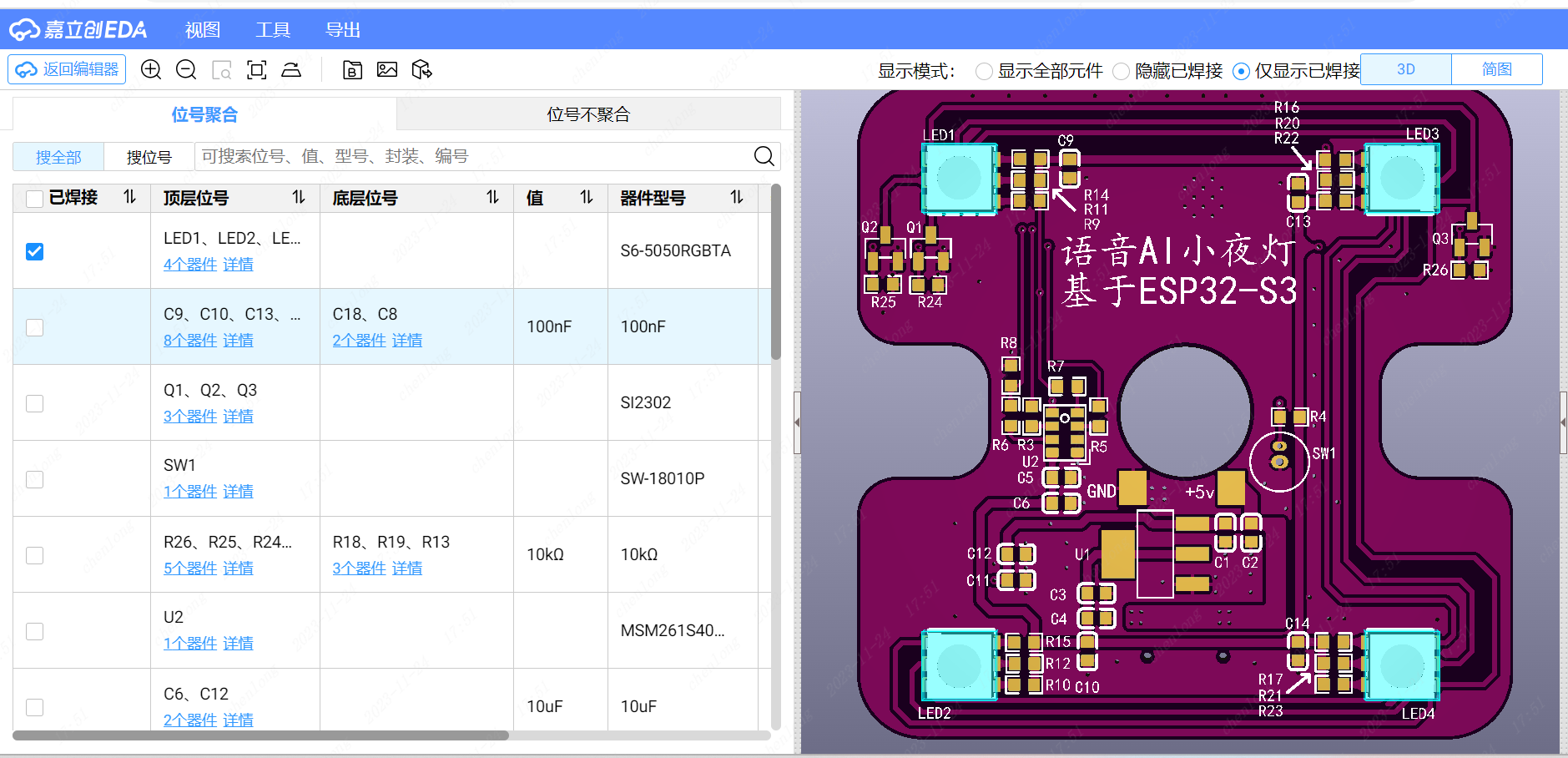

3.2 Soldering Auxiliary Tools
When soldering, you can click on the tools in the top menu bar of JLCPCB EDA's PCB page and select soldering auxiliary tools. This will take you to an interactive BOM page, which displays the coordinate positions of the components on the PCB board in real time. You can check to hide or show the soldered components for high-efficiency soldering.
