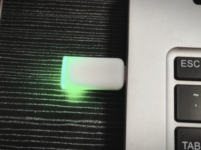

The LED and touch-sensitive buttons are located at the rear, and the casing is 3D printed.

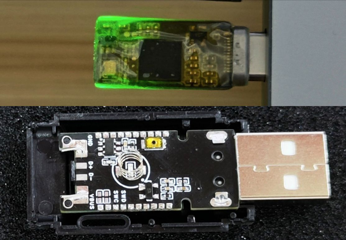

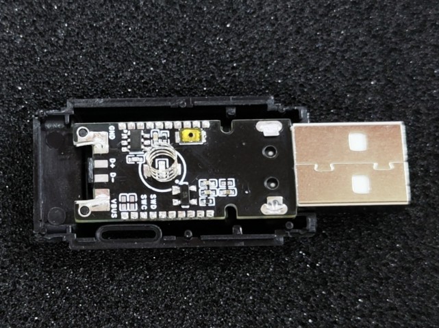

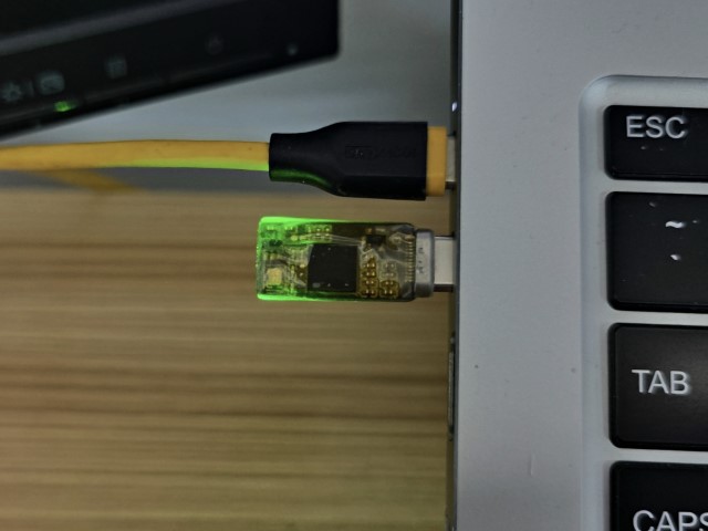

Image Preview
MINI Version:
E73 Version:
