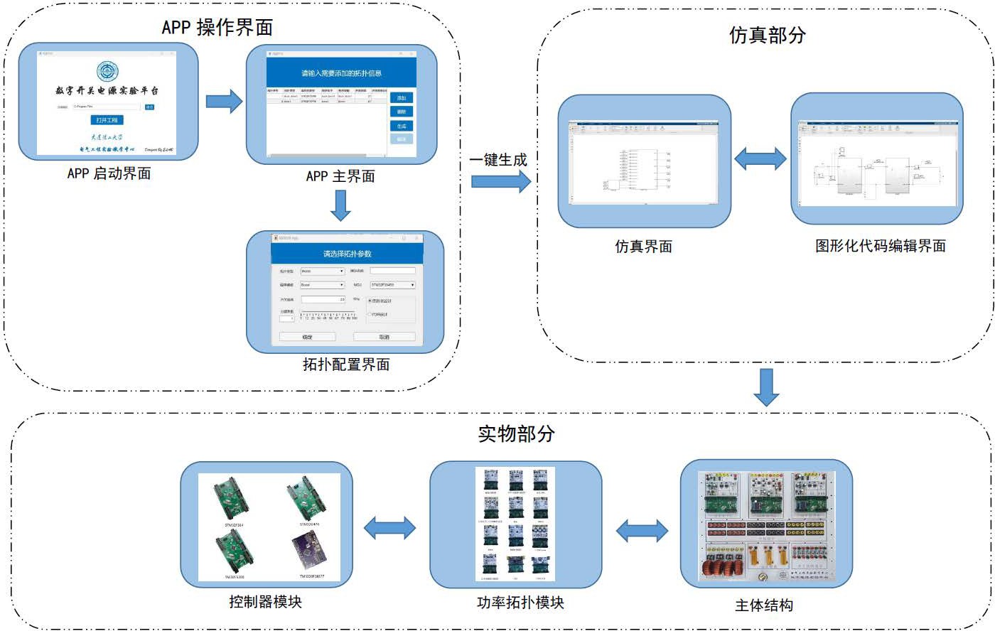

Figure 1.1.1 System Architecture

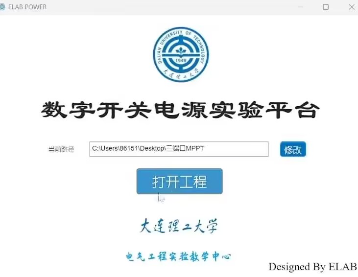

APP Operation Interface
Startup Interface: Used to select the path to store the project
Main Interface: Used to add/delete topologies, generate projects and code, and compile code

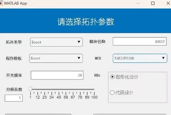

Topology Configuration Interface: Allows selection of topology type, program template, microcontroller model, switching frequency, frequency division factor of control frequency, code programming method, and configuration of module name
Simulation Part
Simulation Interface: Based on the APP The system features automatically generated modules, allowing for parallel and cascaded connections as needed
. A graphical code editing interface is provided, including programming for controller algorithms, buttons, PWM, and ADC. The
main

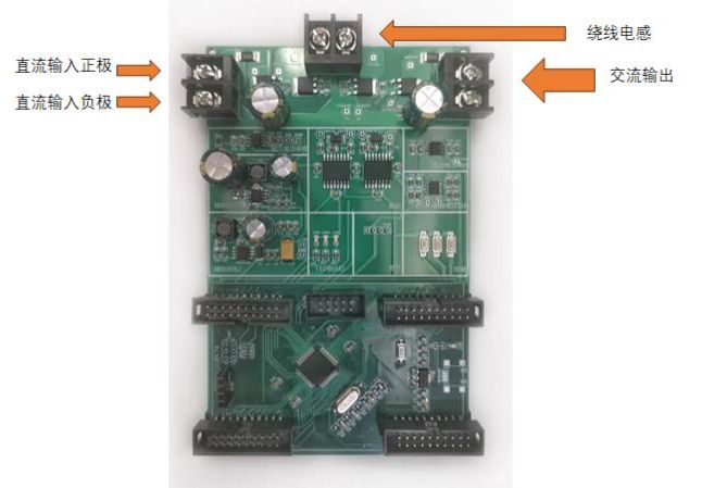

structure includes three replaceable power topologies, branch terminals, power resistors, inductor terminals, and switch terminals. Power
topology modules include twelve types: buck/boost, buck-boost, inverter/PFC, three-phase inverter/three-phase PWM rectifier, three-phase Vienna, Cuk, Sepic, Zeta, phase-shifted full-bridge, reverse polarity buck-boost, LLC, and gallium nitride, totaling sixteen hardware boards
. Controller modules consist of controllers built from minimum systems such as TAE32F5300 (a domestic microcontroller), STM32F334, STM32G474, and TMS320F28377, with pin compatibility and interchangeability.

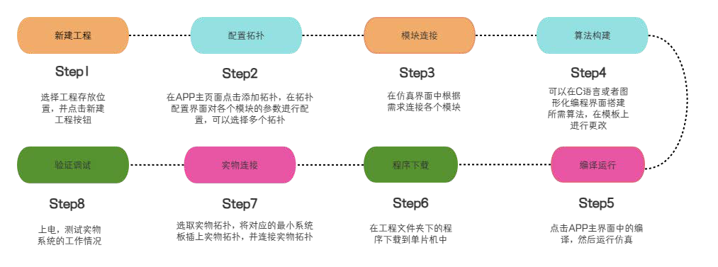

(1.1.4 Application
Flowchart; 1.1.2 Application Flowchart;

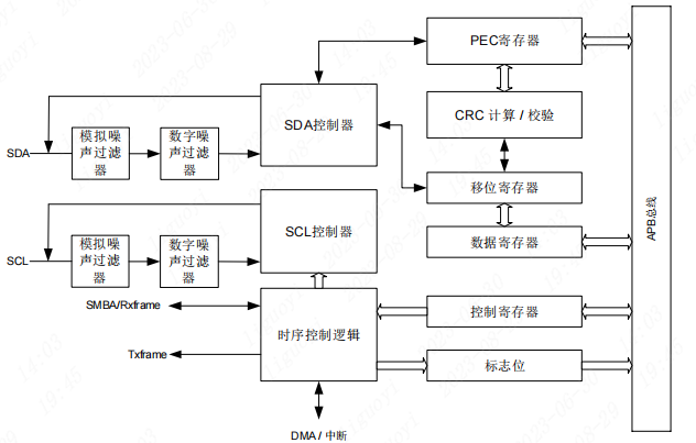

1.2.2 Introduction to GD32 Hardware I2C
The GD32F470 has three hardware I2C peripherals, which are internal circuits that allow communication with external I2C interfaces. The hardware I2C module on the GD32F4 chip uses specific pin multiplexing for data and clock signal transmission.
Timing control of the hardware I2C module is implemented by hardware circuits and registers. These circuits and registers are responsible for generating the clock and controlling the level changes of the data lines to conform to the timing requirements of the I2C communication protocol. They can automatically process the timing signals required for I2C communication, ensuring that data transmission occurs on the correct timeline. Through the automatic control of the hardware I2C module, timing control can be more accurate and reliable, thereby improving the success rate of communication.
Hardware I2C also supports interrupts and DMA. It can communicate with the processor via interrupts or DMA. This allows the processor to perform other tasks during data transmission, improving system efficiency and performance.
Figure 1.2.1 shows the hardware I2C block diagram.
The hardware I2C module on the GD32F470ZGT6 only supports standard mode (100 kHz) and fast mode (400 kHz) to meet the communication needs of different application scenarios.

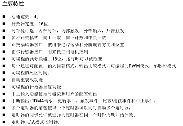

1.2.3 Timer Resources of GD32 The
GD32F450ZGT6 has a total of 14 timers, which can be divided into five types: Advanced Timers 0/7, General Purpose Timers (L0) 1-4, General Purpose Timers (L1) 8/11, General Purpose Timers (L2) 9/10/12/13, and Basic Timers 5/6. The number of functions available for each type of timer varies; generally, Advanced Timers have the most functions, followed by General Purpose Timers, and Basic Timers have the fewest. For a detailed comparison of functions, please refer to page 356 of the user manual.
Advanced Timers (TIMER0 and TIMER7) are four-channel timers that support input capture and output comparison. They can generate PWM signals to control motors and manage power. Advanced Timers include a dead-time insertion module, which is very suitable for motor control.
The main characteristics of Advanced Timers are shown in Figure 1.2.2.
Figure 1.2.2 Main Characteristics of Advanced Timers

Below, we will use the 2021 National Competition three-port example to demonstrate how to use the experimental platform to quickly verify the solution to the real competition problem in ten minutes.
The first step is to create a new folder for subsequent code and simulation. Select the newly created folder on the main interface of the app.
(Figure 1.3.1: Creating a new folder)

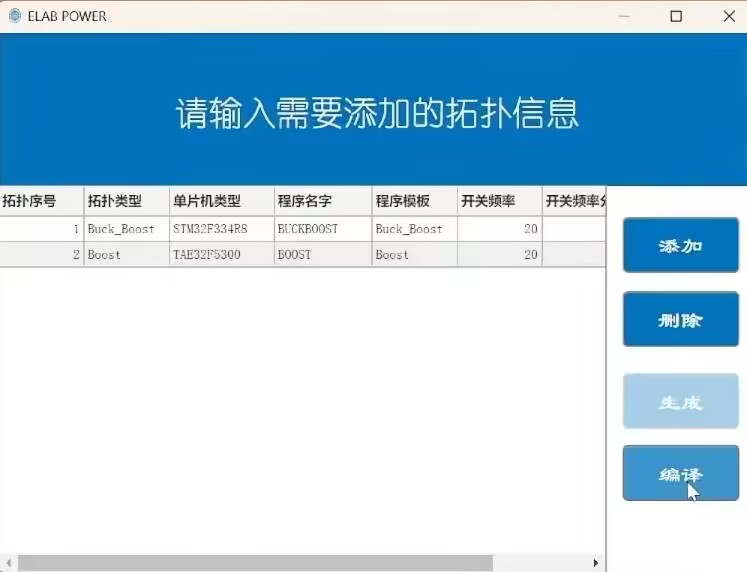

The second step is to select the required topology for the solution. The first topology is the BUCK-BOOST circuit, controlled by an STM32F334 microcontroller minimum system, and programmed using a graphical interface. The second topology is the BOOST circuit, controlled by a TAE32 microcontroller minimum system, also programmed using a graphical interface.
(Figure 1.3.2: Selecting a topology)

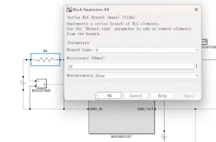

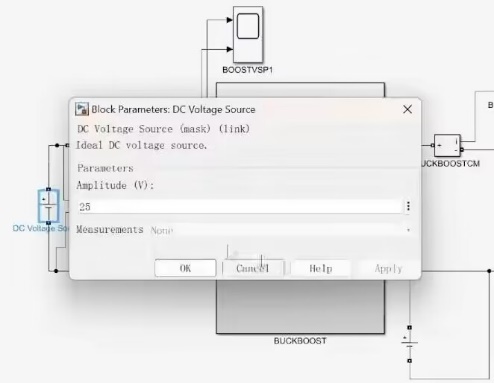

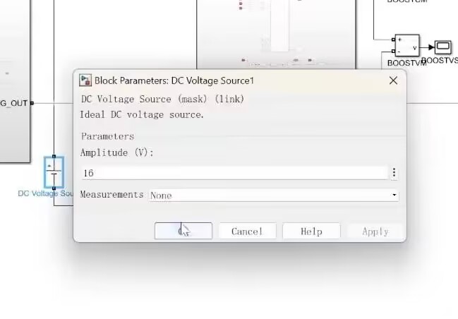

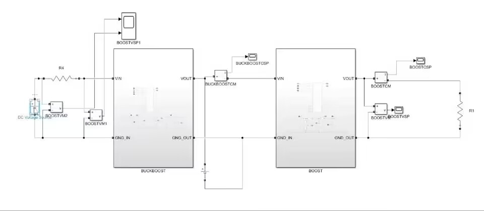

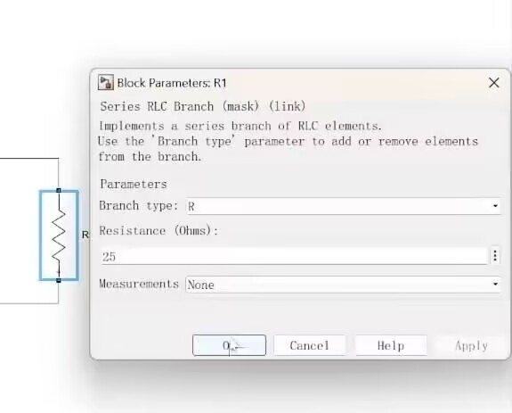

The third step is to generate the project with one click and wait for the files to be generated. In Simulink, connect the two topologies according to the requirements of the problem. Connect a 10-ohm resistor to the voltage source to simulate the internal resistance of the photovoltaic panel, and then connect the BUCK-BOOST. The output of the BUCK-BOOST is connected to the BOOST and the battery. The battery uses four lithium batteries in series, and the battery voltage in the simulation is set to 16V. The BOOST output is connected to a 25-ohm load resistor.
Figure 1.3.3 Wiring
Diagram 1.3.4 Setting the Output Impedance of the Photovoltaic Panel Figure
1.3.5 Setting the Battery Voltage
Figure 1.3.6 Setting the Output Resistance

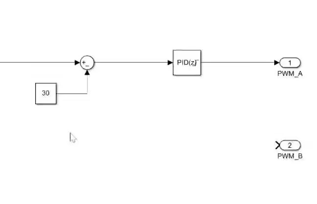

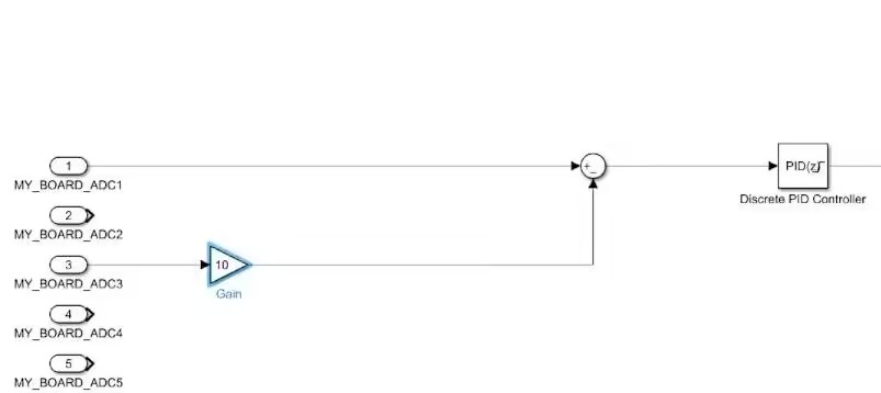

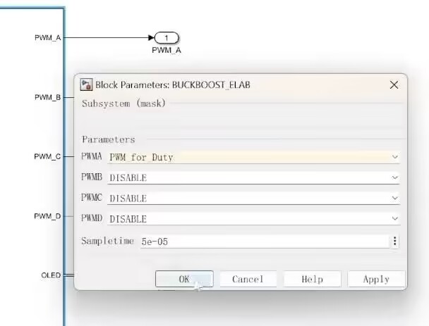

The fourth step is to edit the controller in the graphical interface. First, BUCK-BOOST, making the input voltage equal to the input current multiplied by the internal resistance to achieve MPPT, that is, the current multiplied by 10 and combined with the voltage to form a PID. Then enable PWMA in duty cycle mode. Then BOOST, set the voltage setpoint to 30, and enable PWMA in duty cycle mode.
Figure 1.3.7 Setting the Control Loop
Diagram 1.3.8 PWM Diagram with Duty Cycle Mode Enabled
1.3.9 Editing the BUCK Controller
The fifth step is to click to compile.
Figure 1.3.10

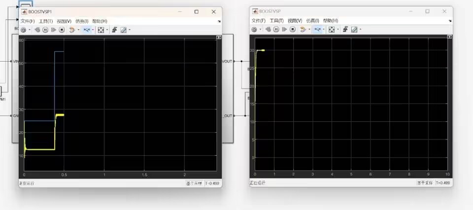

Successful Compilation After compilation, simulation testing can be performed. First, set the input voltage of the voltage source to 25V. You can see that the input voltage of the front stage is about 12.5V, and the output is 30V. Then set the input voltage of the voltage source to 55V. You can see that the input voltage of the front stage is about 27.5V, and the output is 30V. All parameters meet the requirements of the question, and the simulation verification is successful.
Figure 1.3.11 Simulation verification

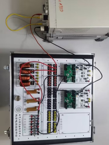

step six: open the generated program, compile it separately, and after confirming that there are no compilation errors, burn the program to the two minimum system boards respectively.

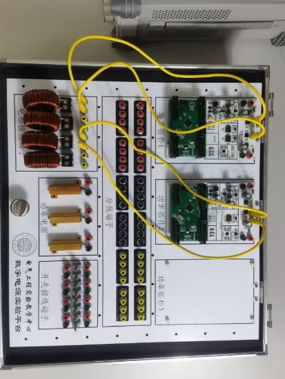

Step seven: insert the minimum system boards into the corresponding power boards respectively, fix the power boards on the experimental platform and connect the wires.
Figure 1.3.12 Wiring

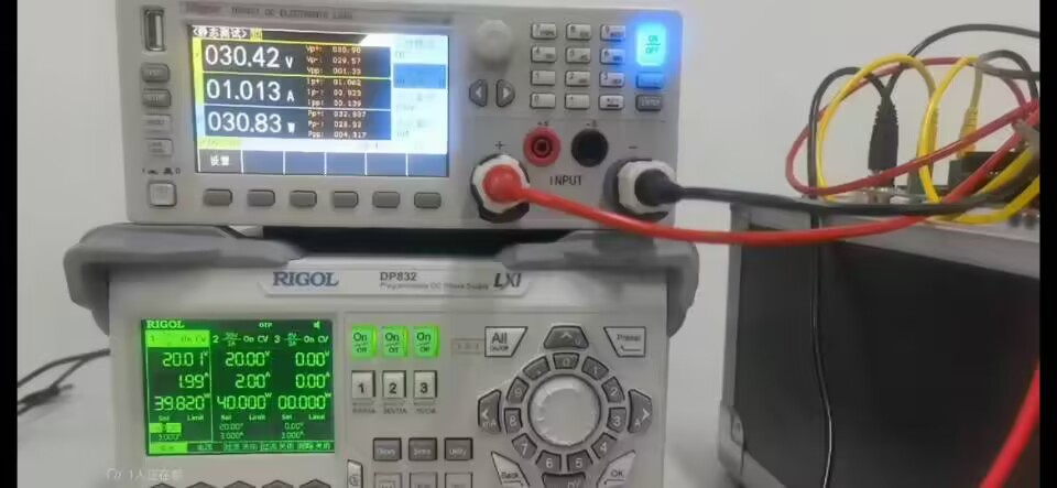

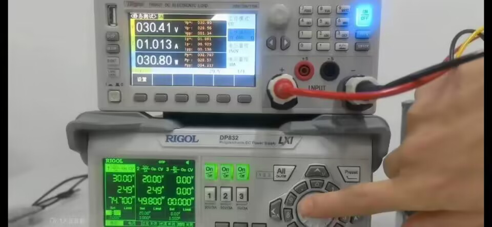

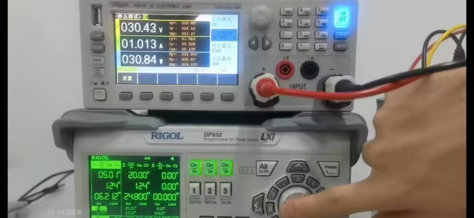

step eight: power on, and test the physical output under the premise of ensuring safety.
(1) When the input is 50V, the current of the input port is 2.49A, the internal resistance voltage division is half of the power supply box voltage, and the output is 30V.
Figure 1.3.13 Output when 50V input
(2) When the input is 25V, the current of the input port is 1.24A, the internal resistance voltage division is half of the power supply box voltage, and the output is 30V.
Figure 1.3.14 Output when 25V input
(3) With an input of 40V, the current at the input port is 1.99A, and the voltage division of the internal resistance is half of the power supply box voltage. At this time, the output is 30V.
Figure 1.3.15 shows that all parameters of the output with a 40V input
meet the requirements of the problem, and the scheme is successfully verified.
