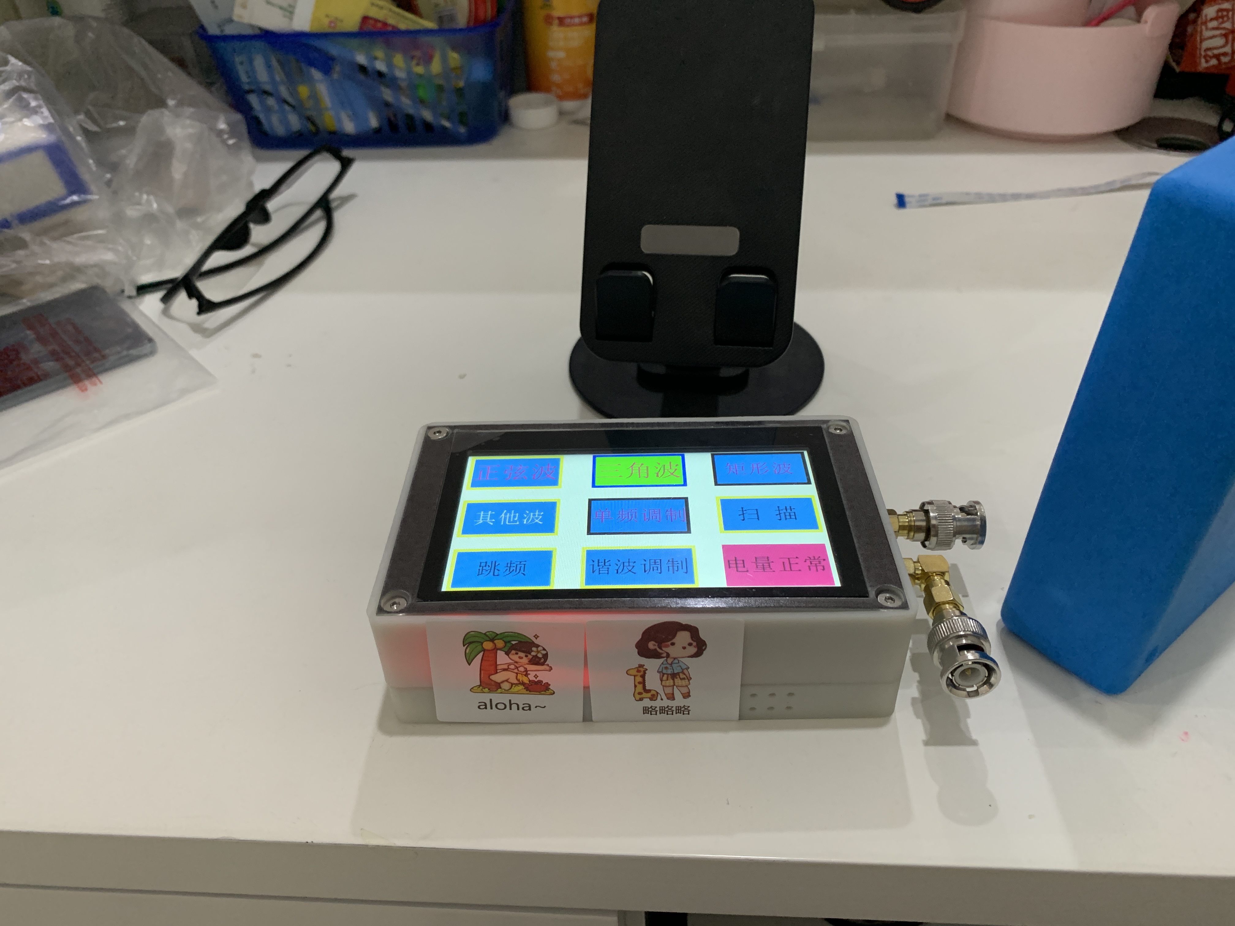

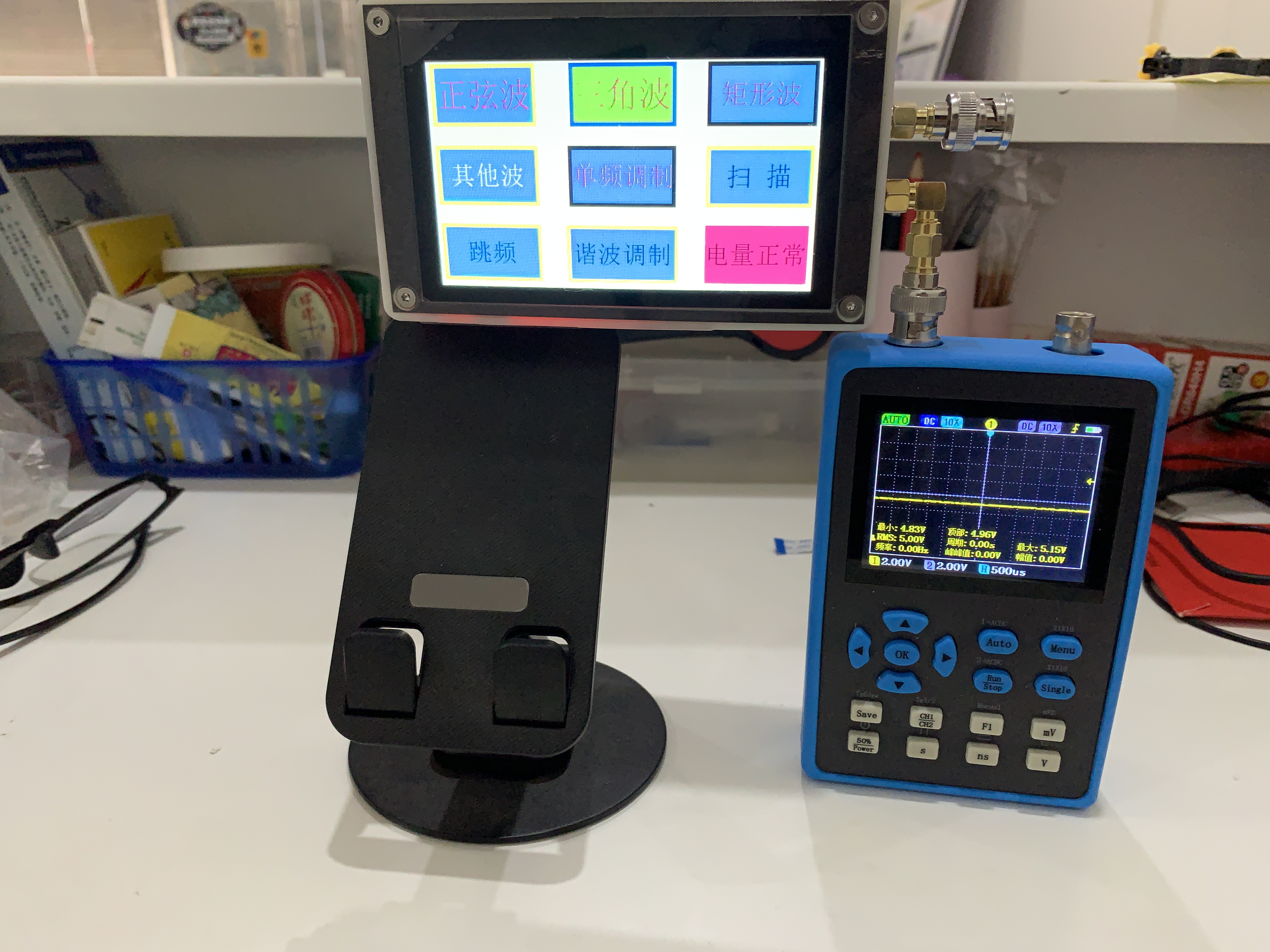

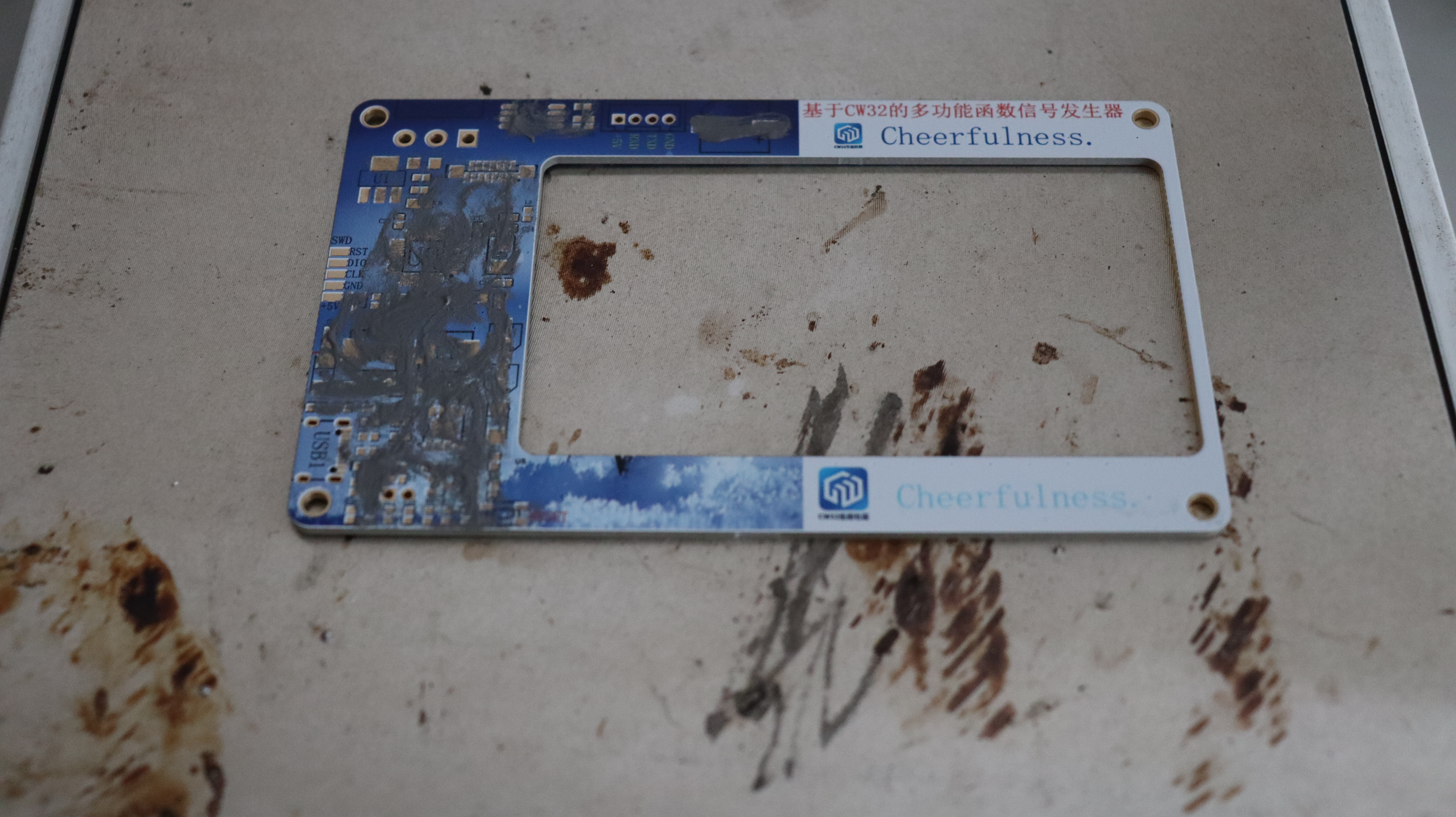

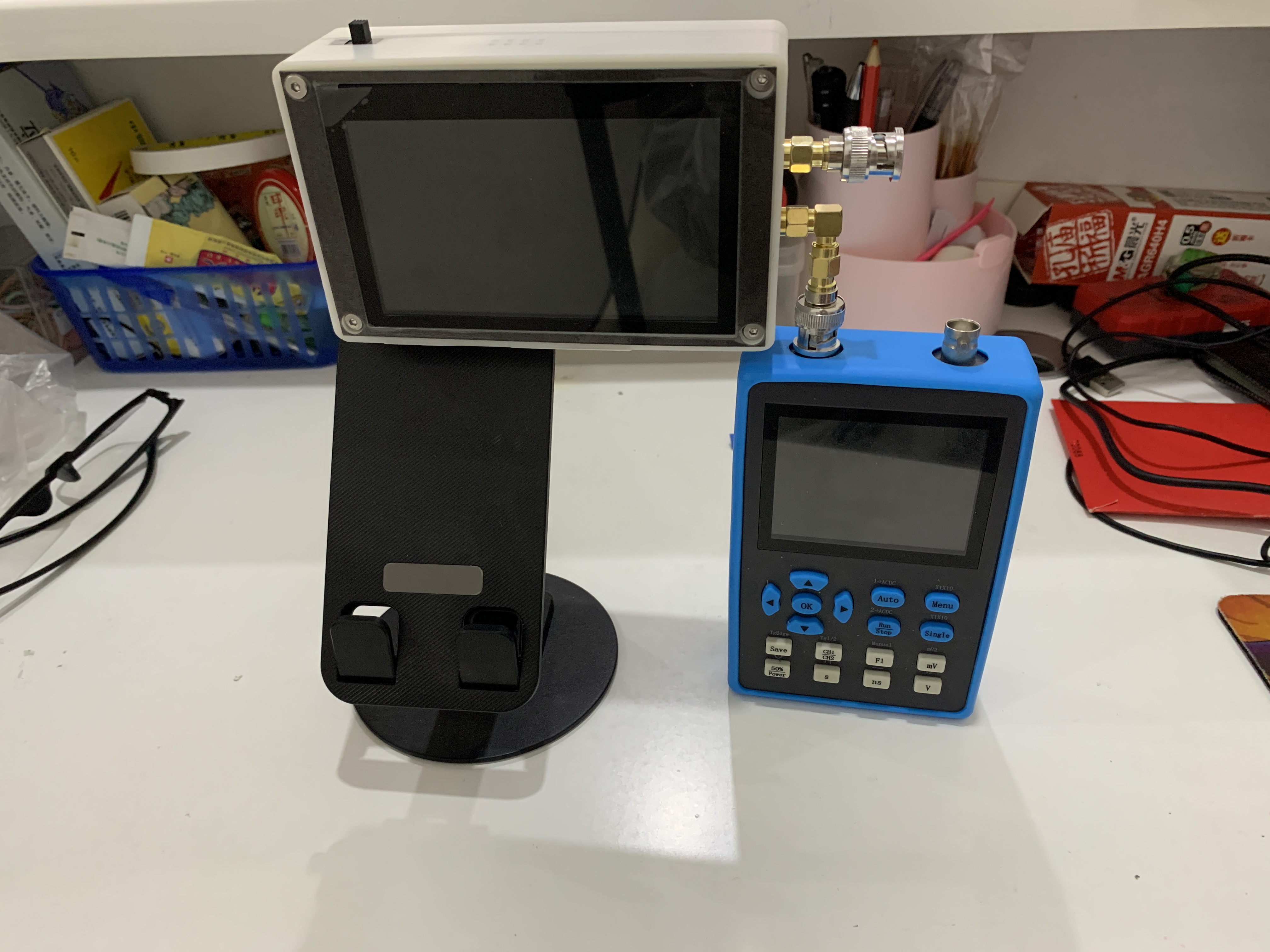

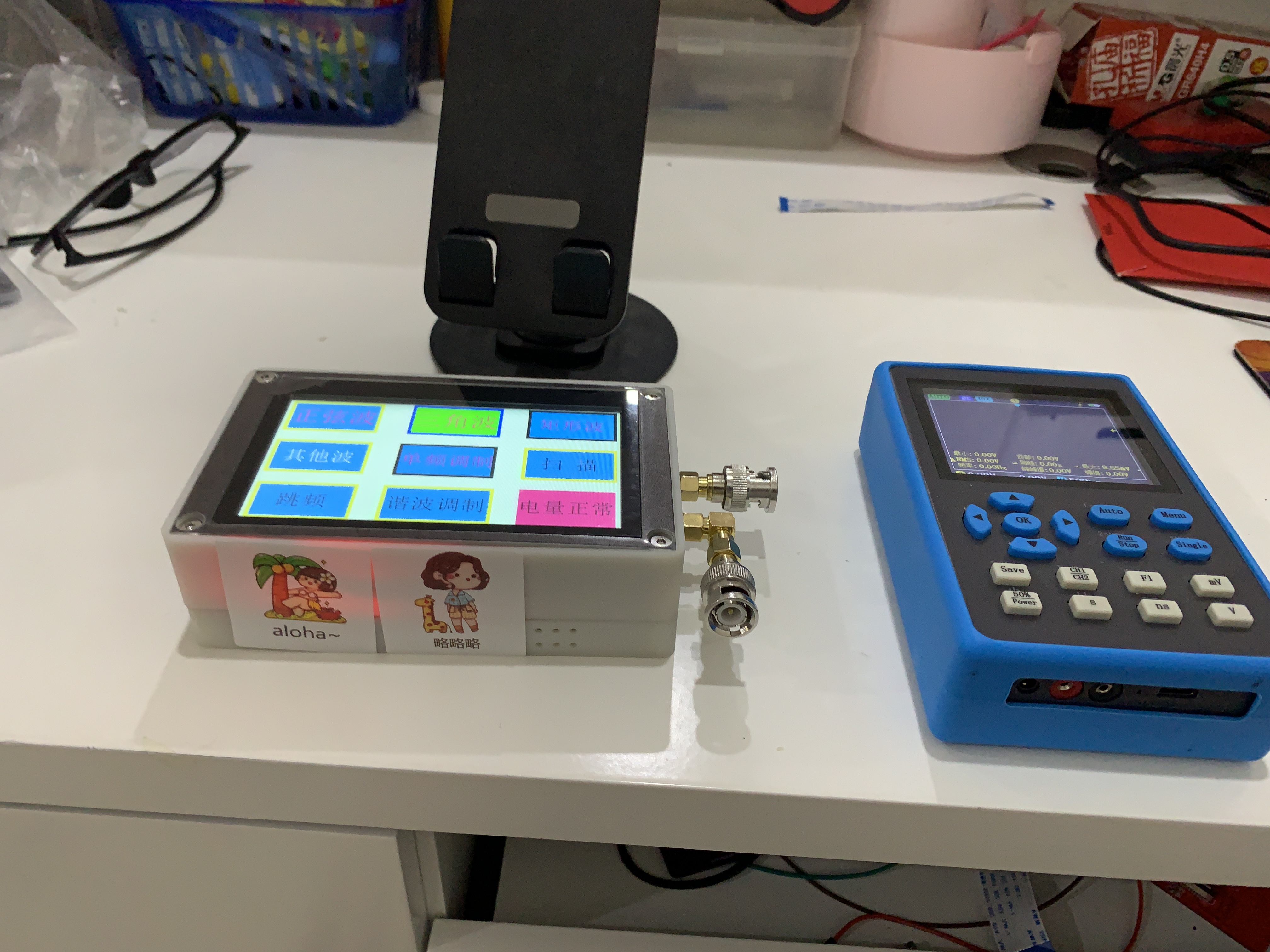

I. Physical Display and Partial Manufacturing Process Demonstration:
Physical Display Link: Demonstration Video
II. Detailed Functional Description

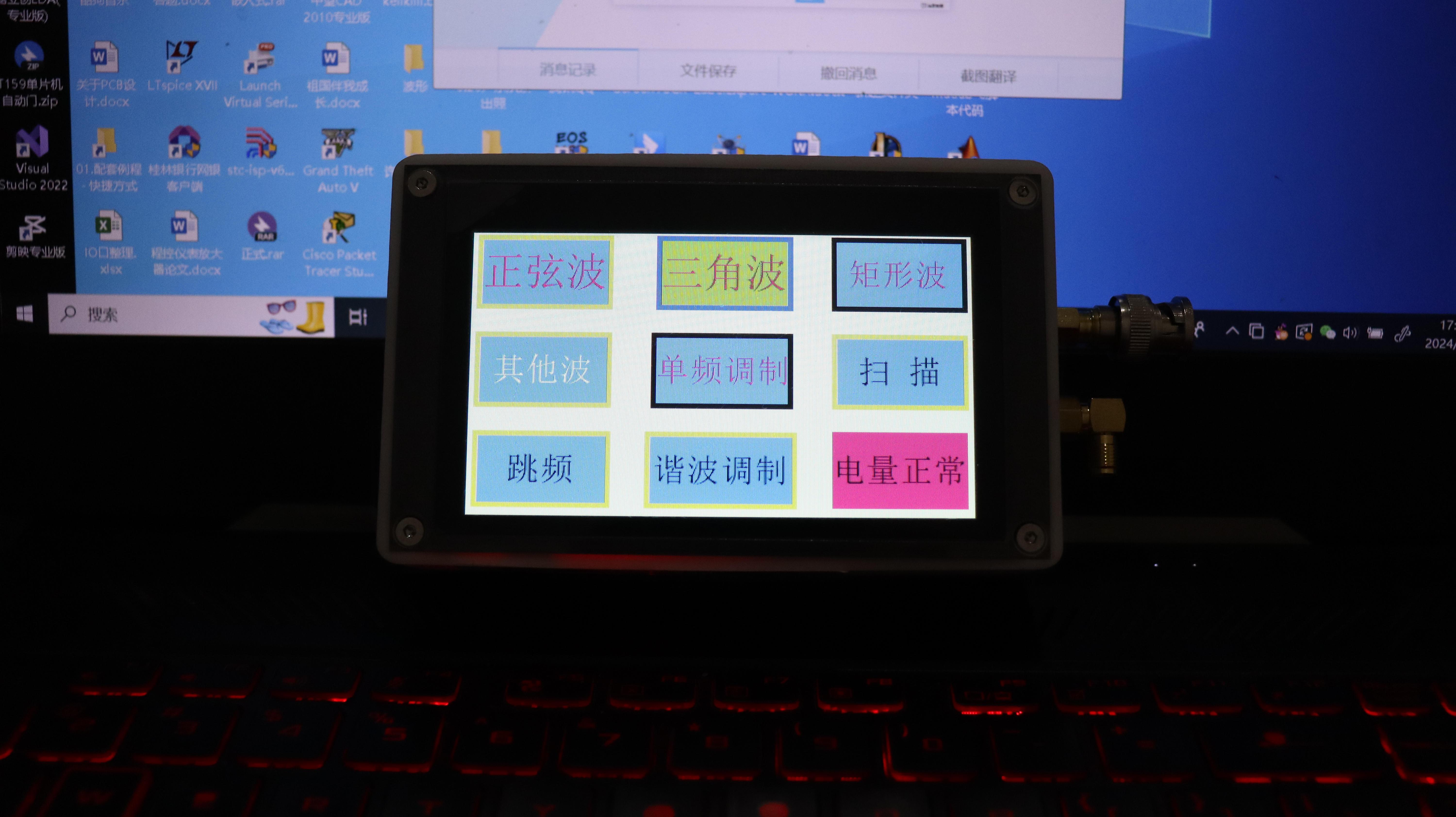

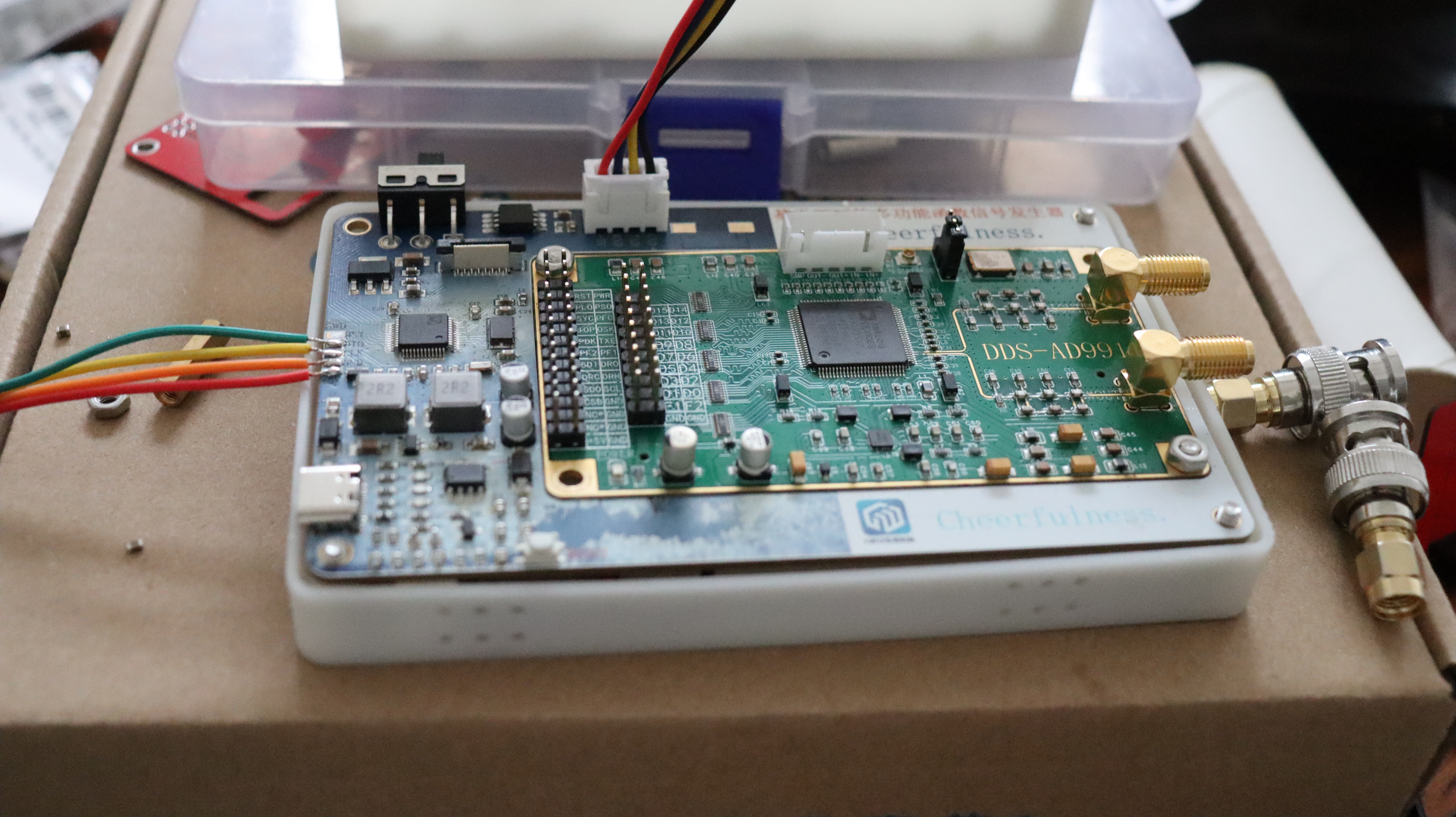

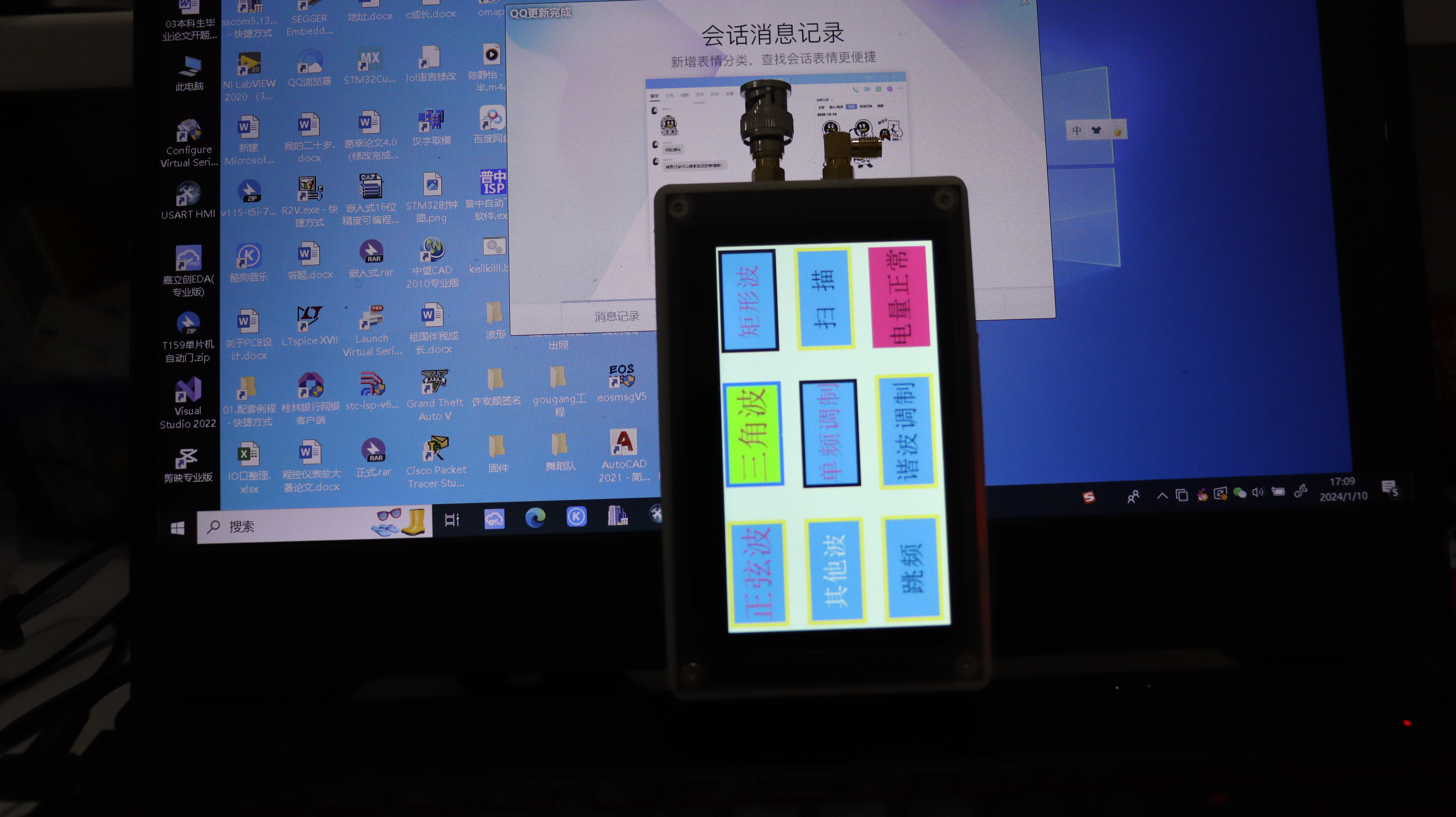

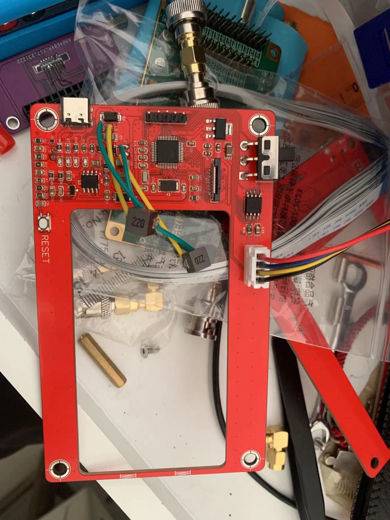

This design uses the CW32F030 series microcontroller as the system control core, the AD9910 module as the waveform generation system, the HMI 4.3-inch touchscreen as the human-machine interface for setting relevant parameters, and the W25Q64 as the data storage device. With a simple peripheral circuit structure, a multi-functional function signal generator is designed. The basic function GUI interface is shown in the figure.
The basic functions of the project include:
1. 1-420MHz sine wave output.
2. 3.7-244kHz triangular wave output. 3.
3.7-244kHz square wave output.
4. Other common wave outputs (14 other common waveforms).
5. Single frequency modulation can select the following functions:
(1) AM modulation.
(2) PM modulation.
(3) FM modulation.
(4) 2ASK.
(5) 2PSK.
(6) 2FSK.
6. Scanning function can select the following functions:
(1) frequency sweep.
(2) amplitude sweep.
(3) phase sweep.
7. Harmonic modulation can select the following functions:
(1) FM.
(2) AM.
(3) PM.
8. Frequency hopping (this function is not yet implemented).
8. Other (extended functions).

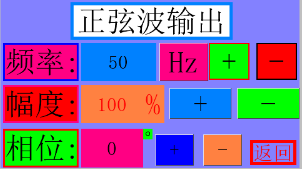

1. Sine Wave Output Mode: In sine wave output mode, frequency, amplitude, and phase are adjustable via the HMI touchscreen. Frequency range: 1Hz-450MHz, 1Hz step; amplitude: 0-100%, 1% step; phase: 0-360 degrees, 1 degree step. The GUI interface is shown in the figure below.

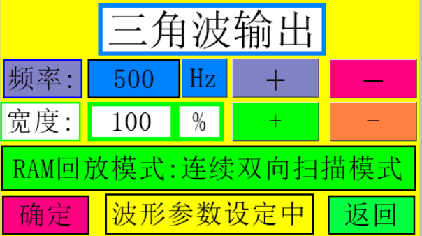

2. Triangle Wave Output Mode: In triangle wave mode, frequency and width are adjustable, with a frequency step of 1Hz and a maximum of 244kHz. Two waveform output modes are provided:
1. Continuous Bidirectional Scan: After playing a waveform, the waveform is played in reverse.
2. Continuous Loop Scan: Continuously plays a waveform.

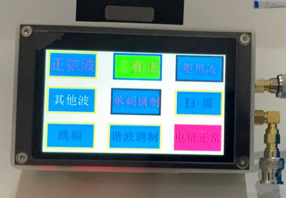

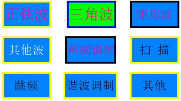

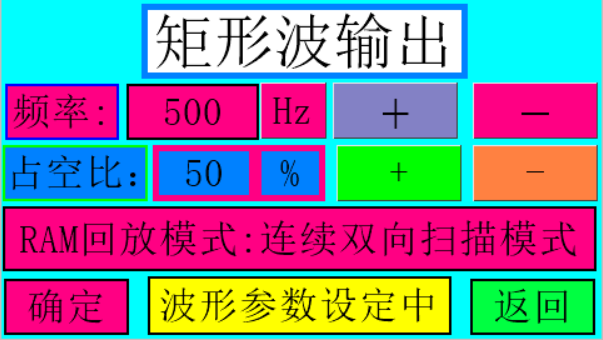

3. Square Wave Output Mode: In square wave output mode, waveform width and frequency are adjustable, with a width step of 5% and a frequency step of 1Hz.
The GUI interface is shown in Figure

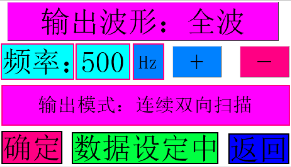

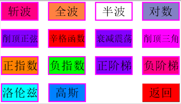

4. Other waveform output modes: The output waveform has the following 14 common waveforms to choose from:
(1) Chopper.
(2) Full wave.
(3) Half wave.
(4) Logarithmic.
(5) Clipped sine.
(6) Singer function.
(7) Damped oscillation.
(8) Clipped triangle.
(9) Positive exponential.
(10) Negative exponential.
(11) Positive step.
(12) Negative step.
(13) Lorentz.
(14) Gaussian.
4. In this mode, the waveform frequency and waveform output mode are adjustable. Two waveform output modes are provided:
1. Continuous bidirectional scanning
2. Continuous cyclic scanning
The corresponding waveform output interface is shown in Figure 4.
By clicking the output waveform button, you can switch between one waveform output in sequence.
Waveform output can be performed by clicking the confirmation button. After pressing the confirmation button, pressing it again will become the cancel button, canceling the waveform output. Pressing the return button will return to the previous menu.

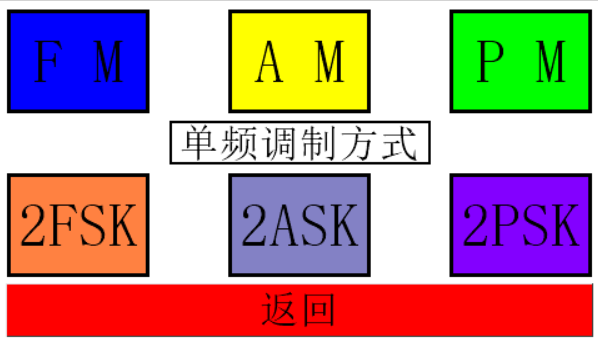

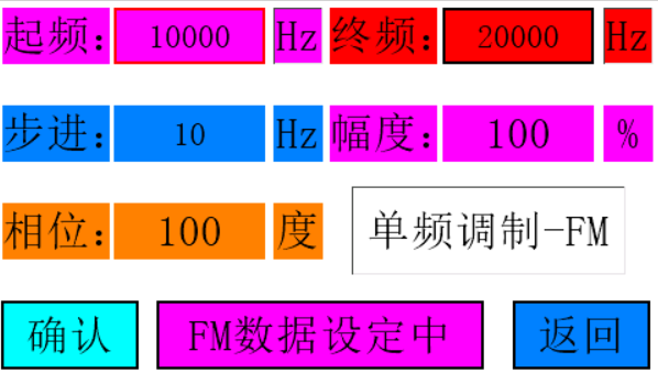

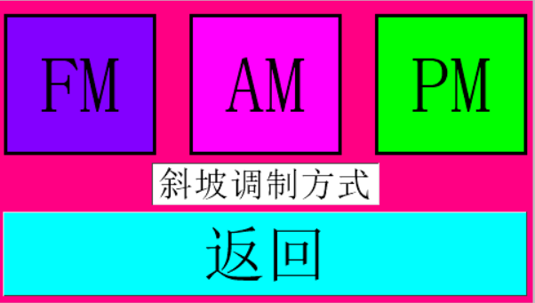

4. Single-frequency modulation GUI is shown in the figure below.
4. Single-frequency modulation mode provides

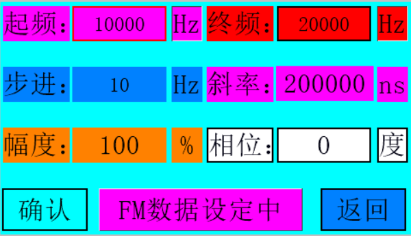

(1) FM modulation:
The interface GUI is shown in the figure below.
In this mode, the following parameters of FM modulation can be set:
1. Start frequency.
2. End frequency.
3. Step frequency.
4. Waveform amplitude.
5. Waveform phase.

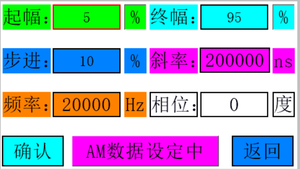

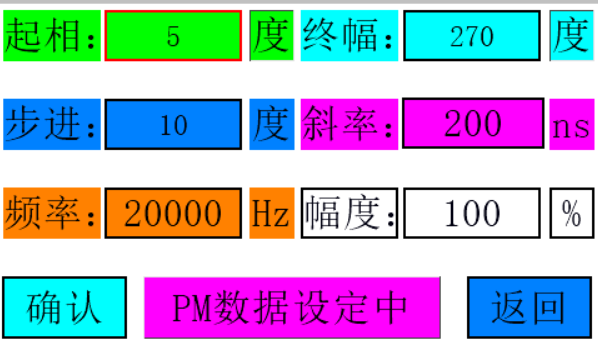

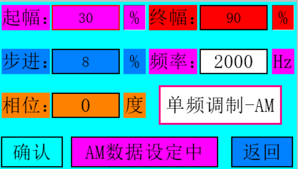

(2) AM modulation
In this mode, the following parameters of AM modulation can be set:
1. Start amplitude.
2. End amplitude. 3.
Step amplitude.
4. Waveform frequency.
5. Waveform phase.

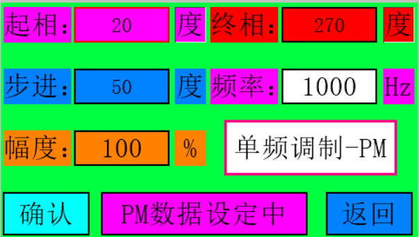

(3) PM modulation
. In this mode, the following parameters of PM modulation can be set:
1. Start phase.
2. End phase.
3. Step phase.
5. Waveform amplitude.

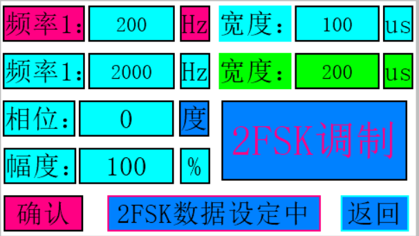

(4) 2FSK modulation
. In this mode, the following parameters of 2FSK modulation can be set:
1. Start frequency.
2. End frequency.
3. Start frequency duration.
4. Start frequency duration.
5. Waveform phase.

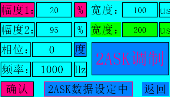

(5) 2ASK modulation
In this mode, the following parameters of 2ASK modulation can be set:
1. Start amplitude.
2. End amplitude.
3. Start amplitude duration.
4. Start amplitude duration.
5. Waveform frequency.
5. Waveform phase.

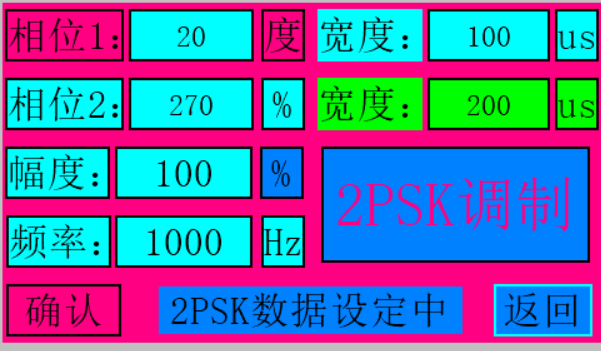

(5) 2PSK modulation
In this mode, the following parameters of 2PSK modulation can be set:
1. Start phase.
2. End phase.
3. Start phase duration.
4. Start phase duration.
5. Waveform frequency. 5.
Waveform amplitude.

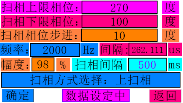

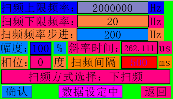

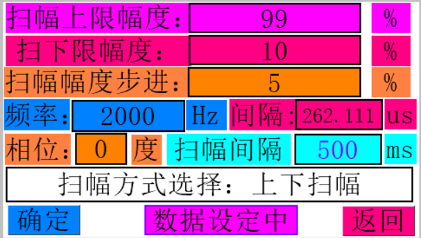

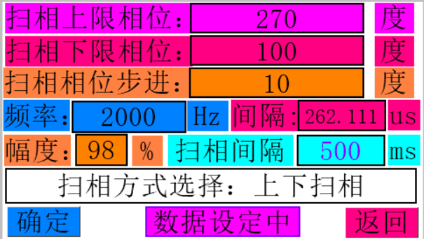

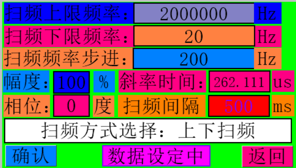

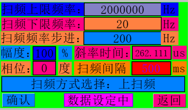

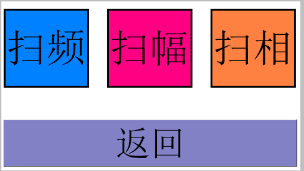

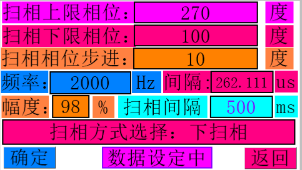

4. Scan mode GUI is shown in the figure below.
Scan mode function 1: frequency
sweep. The three different frequency sweep modes GUIs under the frequency sweep function are shown in the figure below. Upper frequency
sweep GUI
Lower frequency sweep GUI
In frequency sweep mode, the following parameters can be set for frequency sweep control:
1. Upper sweep frequency limit
2. Lower sweep frequency limit
3. Sweep step
frequency
4. Sweep amplitude 5. Sweep
phase 6. Sweep time interval
7. Sweep DRC pin time interval
8. Lower sweep frequency limit
9. Select sweep mode: upper sweep, lower sweep, upper and lower sweep.

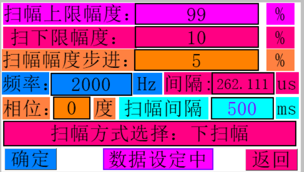

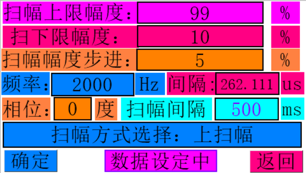

Function 2: Amplitude Sweep . The amplitude sweep function GUI
is shown in the figure below . In amplitude sweep mode, the following parameters can be set for amplitude control: 1. Upper sweep amplitude limit 2. Lower sweep amplitude limit 3. Sweep step amplitude 4. Sweep frequency 5. Sweep phase 6. Sweep time interval 7. Sweep DRC pin time interval 9. Select sweep mode: upper sweep, lower sweep, upper and lower sweep. Function 3: Phase Sweep . The phase sweep function GUI is shown in the figure below . In phase sweep mode, the following parameters can be set for phase control: 1. Upper limit amplitude of phase sweep 2. Lower limit amplitude of phase sweep 3. Phase sweep step amplitude 4. Sweep frequency 5. Phase sweep phase 6. Phase sweep time interval 7. Phase sweep DRC pin time interval 9. Select sweep mode: upper sweep, lower sweep, upper and lower sweep Harmonic modulation function Harmonic modulation GUI is shown in the figure below: Harmonic modulation function 1: FM modulation Harmonic FM modulation GUI is shown in the figure below: In this mode, the following parameters can be set for FM modulation 1. FM modulation start frequency 2. FM modulation end frequency 3. FM modulation amplitude 4. FM modulation phase 5. FM modulation slope sustain time Harmonic modulation function 2: AM modulation Harmonic AM modulation GUI is shown in the figure below: In this mode, the following parameters can be set for AM modulation 1. AM modulation start amplitude 2. AM modulation end amplitude 3. AM modulation frequency 4. AM modulation phase 5. AM modulation slope sustain time Harmonic modulation function 3: The PM modulation harmonic AM modulation GUI is shown in the figure below. In this mode, the following parameters can be set for PM modulation: 1. PM modulation start phase; 2. PM modulation end phase; 3. PM modulation frequency; 4. PM modulation amplitude; 5. PM modulation slope and duration. III. Hardware Design Description This project mainly consists of a CW32F030 microcontroller, an AD9910 module, a 4.3-inch HMI touchscreen, and a W25Q64 memory chip. The hardware does not contain complex digital or analog circuits; the most complex part is the AD9910 control board circuit. Detailed explanations can be found in other open-source projects under this account. The CW32 has few GPIO ports but relatively powerful functions, performing all functions except frequency hopping. Therefore, the hardware circuit will not be described in detail. The entire hardware system can be understood as: a CW32 minimum system (small blue board) + an HMI touch screen + an AD9910. The most difficult part is in the software code design. For ASK, PSK, FSK, AM, PM, FM, amplitude sweep, frequency sweep, and phase sweep, a deep understanding of high-frequency electronics and a certain awareness of practical applications are required... I don't know how to explain it, for example, determining the capacitance of a capacitor through frequency sweep... For specific implementation principles... please refer to relevant materials. A brief explanation of the power supply section of the hardware circuit: The power supply circuit of this project consists of a Type-C circuit and a battery power supply circuit. When the Type-C is floating, the battery provides power; when the Type-C interface is connected, the Type-C provides system power. The flowchart is shown below. The circuit structure is shown below . Power flow: from left to right. The circuit structure contains circuits that shield all interfaces; these are used for positioning hole drawing and 3D model drawing, and have no electrical significance in the actual circuit. For detailed circuitry information regarding the AD9910, please refer to my other open-source projects; it will not be discussed extensively here. The schematic for this project is very simple; the only complex part is the power supply circuit. The PCB design involves only two PCBs: the core board and an adapter board for the AD9910 interface. This adapter board converts the 2.54mm header connector to a PFC connector for connection to the FPC interface on the core board, forming an integrated system and avoiding the need for wire harness connections. An opening is created on this PCB to route the FPC cable. To reduce the board's actual height, it is designed to be as thin as possible; therefore, a thickness of 1.2mm was chosen during board fabrication. A large cutout area is created in the center of the main board to house the AD9910. The AD9910 can be perfectly secured using the cutout area and bottom screw posts. For cost-saving purposes, this part can be omitted; the bottom screw posts are sufficient for fixation. Boards larger than 10x10mm cannot use free PCB fabrication; double-layer boards cost over 40 yuan! III. Software Design Description: The software is the final step in the entire design. Hardware circuit design took an afternoon and over a month, involving many aspects. The software operation flow is shown in the following diagram. 4.3-inch HMI serial port screen code writing. The serial communication code flow is shown in the following diagram . The serial port screen operation flow is shown in the following diagram. All logic code follows the following principles: Due to limitations of the CW32's on-chip resources, some powerful RGB screens cannot be used. Therefore, the HMI serial port screen is selected for human-computer interaction. Experimental results show that the human-computer interaction is good and basically achieves the intended functions. The HMI serial port screen is only used to send data with a predetermined frame structure. The microcontroller performs the calculation and responds accordingly. The microcontroller does not perform any other control on the HMI serial port screen.

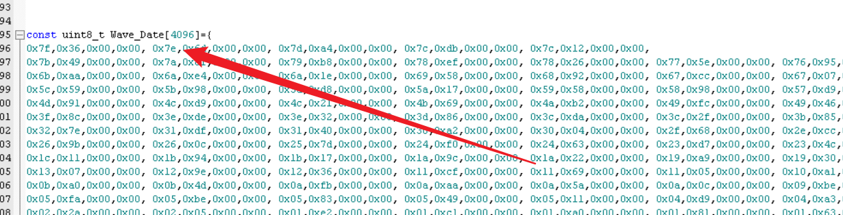

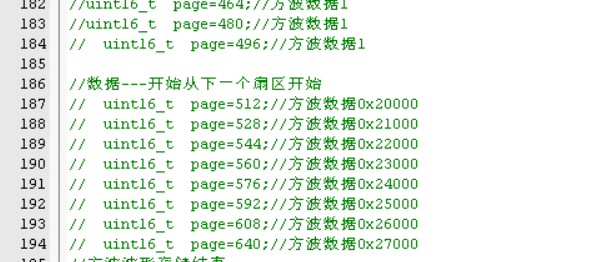

2. W25Q64 Code Development
: Due to the CW32 on-chip Flash issue, I could only use the W25Q64 for waveform data storage. Under the CW32, only a single 4096-byte data segment can be defined. Therefore, I had to write 4096 waveform data segments to the corresponding 4KB sector at a time.
When using the W25Q64, it's crucial to specify:
1. Which block (64 bytes per block) of 128 blocks to store the data in. Which sector (32KB), which region (4KB), and which page (256 bytes) address within that region.
This project uses linear storage, storing 4096 data segments at a time, equivalent to storing one region at a time. A 32KB sector can store 8 waveforms, and a 64KB block can store 16 waveforms. Therefore, approximately 3 blocks are needed for data storage. The storage structure is shown in the diagram below.
The waveform writing steps are shown in the figure below:
1. Store the waveform data in an array of size 4096: const uint8_t Wave_Date[4096]
2. Select the 4K sector to be written, represented by a decimal number, starting from 0 and incrementing upwards
. 3. Run the writing code to split the 4096-sized waveform data into 256-sized segments and write them in pages, which can just fill a 4K sector. The code is shown below.
for(i=0;i<256;i++) {Wdate[i]=Wave_Date[i];} W25Q64_PageWrite(Wdate,0+page);
for(i=0;i<256;i++) {Wdate[i]=Wave_Date[i+256];} W25Q64_PageWrite(Wdate,1+page);
for(i=0;i<256;i++) {Wdate[i]=Wave_Date[i+256*2];} W25Q64_PageWrite(Wdate,2+page);
for(i=0;i<256;i++) {Wdate[i]=Wave_Date[i+256*3];} W25Q64_PageWrite(Wdate,3+page);
for(i=0;i<256;i++) {Wdate[i]=Wave_Date[i+256*4];} W25Q64_PageWrite(Wdate,4+page);
for(i=0;i<256;i++) {Wdate[i]=Wave_Date[i+256*5];} W25Q64_PageWrite(Wdate,5+page);
for(i=0;i<256;i++) {Wdate[i]=Wave_Date[i+256*6];} W25Q64_PageWrite(Wdate,6+page);
for(i=0;i<256;i++) {Wdate[i]=Wave_Date[i+256*7];} W25Q64_PageWrite(Wdate,7+page);
for(i=0;i<256;i++) {Wdate[i]=Wave_Date[i+256*8];} W25Q64_PageWrite(Wdate,8+page);
for(i=0;i<256;i++) {Wdate[i]=Wave_Date[i+256*9];} W25Q64_PageWrite(Wdate,9+page);
for(i=0;i<256;i++) {Wdate[i]=Wave_Date[i+256*10];} W25Q64_PageWrite(Wdate,10+page);
for(i=0;i<256;i++) {Wdate[i]=Wave_Date[i+256*11];} W25Q64_PageWrite(Wdate,11+page);
for(i=0;i<256;i++) {Wdate[i]=Wave_Date[i+256*12];} W25Q64_PageWrite(Wdate,12+page);
for(i=0;i<256;i++) {Wdate[i]=Wave_Date[i+256*13];} W25Q64_PageWrite(Wdate,13+page);
for(i=0;i<256;i++) {Wdate[i]=Wave_Date[i+256*14];} W25Q64_PageWrite(Wdate,14+page);
for(i=0;i<256;i++) {Wdate[i]=Wave_Date[i+256*15];} W25Q64_PageWrite(Wdate,15+page);
4. Run the read code to check the data writing status. This will confirm whether the data is written normally. Data reading is unrestricted, reading 4096 bytes at a time.
`W25Q64_Read(Date,0x29000,4096);
for(i=0;i<4096;i++)
printf("Wave[%d]=%x
",i,Date[i]);
The above completes the data writing code. The waveforms need to be written one by one! This is a very tedious process, so be sure to keep good records!
Don't ask why it can't be written all at once; because the RAM is only 10K. If you define two arrays of size 4096, it will directly cause a hardware exception, and the chip will stop working!

//************** Sweep mode ****************************/
if(rxd_buf[0]==0x80){rxd_flag=27; printf("27 upper sweep limit
if(rxd_buf[0]==0x81){rxd_flag=28; printf("28 lower sweep limit
if(rxd_buf[0]==0x82){rxd_flag=29; printf("29 sweep step
if(rxd_buf[0]==0x83){rxd_flag=30; printf("30 sweep frequency
if(rxd_buf[0]==0x84){rxd_flag=31; printf("31 sweep phase
if(rxd_buf[0]==0x85){rxd_flag=32; printf("32 time increments
if(rxd_buf[0]==0x86){rxd_flag=33; printf("33 Time
if(rxd_buf[0]==0x87){rxd_flag=34; printf("34 DRC time interval
if(rxd_buf[0]==0x88){rxd_flag=35; printf("35 Scan mode
if(rxd_buf[0]==0x89){rxd_flag=36; printf("36 Scan on or off
if(Get_Stat()==0){MAS_REST_HIGH; } if(Get_Stat()==1){Init_ad9910();}

//FM mode parameters
if(rxd_buf[0]==0xF0){rxd_flag=47; printf("47FM starting frequency
if(rxd_buf[0]==0xF1){rxd_flag=48; printf("48FM ending frequency");}
if(rxd_buf[0]==0xF2){rxd_flag=49; printf("49FM step frequency
if(rxd_buf[0]==0xF3){rxd_flag=50; printf("50FM frequency slope time
if(rxd_buf[0]==0xF4){rxd_flag=51; printf("51FM amplitude
if(rxd_buf[0]==0xF5){rxd_flag=52; printf("52FM phase
if(rxd_buf[0]==0xF6){rxd_flag=53; printf("53FM on or off flag

if(rxd_buf[0]==0x30){rxd_flag=61; printf("61PM start phase
if(rxd_buf[0]==0x31){rxd_flag=62; printf("62PM end phase
if(rxd_buf[0]==0x32){rxd_flag=63; printf("63PM step phase
if(rxd_buf[0]==0x33){rxd_flag=64; printf("64PM frequency slope time
if(rxd_buf[0]==0x34){rxd_flag=65; printf("65PM frequency
if(rxd_buf[0]==0x35){rxd_flag=66; printf("66PM amplitude
if(rxd_buf[0]==0x36){rxd_flag=67; printf("67PM on or off flag
//Single-frequency modulation FM
if (rxd_buf[0] == 0x40) { rxd_flag = 68; printf("68 Single-frequency modulation FM start frequency
if (rxd_buf[0] == 0x41) { rxd_flag = 69; printf("69 Single-frequency modulation FM end frequency
if (rxd_buf[0] == 0x42) { rxd_flag = 70; printf("70 Single-frequency modulation FM step frequency
if (rxd_buf[0] == 0x43) { rxd_flag = 71; printf("71 Single-frequency modulation FM amplitude
if (rxd_buf[0] == 0x44) { rxd_flag = 72; printf("72 Single-frequency modulation FM phase
if(rxd_buf[0]==0x45){rxd_flag=73;stateFM=0;
printf("73 Single-frequency modulation FM on or off flag
if(Get_Stat()==0){Init_ad9910(); Break_FM=1;ad9910_reset(1); MAS_REST_HIGH;}
if(Get_Stat()==1){Init_ad9910(); Test(); MAS_REST_LOW; Break_FM=0;}
} //Calculate directly here, directly turn off

// Single-frequency 2FSK
if(rxd_buf[0]==0xD1){rxd_flag=86; printf("86 Single-frequency modulation FSK starting frequency 1
if(rxd_buf[0]==0xD2){rxd_flag=87; printf("87 Single-frequency modulation FSK termination frequency 2
if(rxd_buf[0]==0xD3){rxd_flag=88; printf("88 Single-frequency modulation FSK width 1
if(rxd_buf[0]==0xD4){rxd_flag=89; printf("89 Single-frequency modulation FSK width 2
if(rxd_buf[0]==0xD5){rxd_flag=90; printf("90 Single-frequency modulation FSK phase
if(rxd_buf[0]==0xD6){rxd_flag=91; printf("91 Single-frequency modulation FSK amplitude
if(rxd_buf[0]==0xD7){rxd_flag=92; printf("92 Single-frequency modulation FSK enable or disable flag
if(Get_Stat()==0){MAS_REST_HIGH; } if(Get_Stat()==1){Init_ad9910(); } }

The waveform file was generated by Matlab, requiring some basic Matlab knowledge. The waveform generation process is as follows:
1. Determine the desired periodic waveform.
2. Sample the amplitude of this periodic waveform, with sampling points ranging from 64 to 1024, and a maximum value of 65536 (two 0x00s were added after the data generation to just fill the 4096 array). (This is similar to the principle of using OLED for Chinese character encoding, where the corresponding waveform data is stored and then retrieved). During

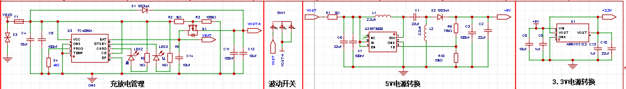

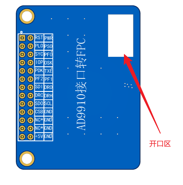

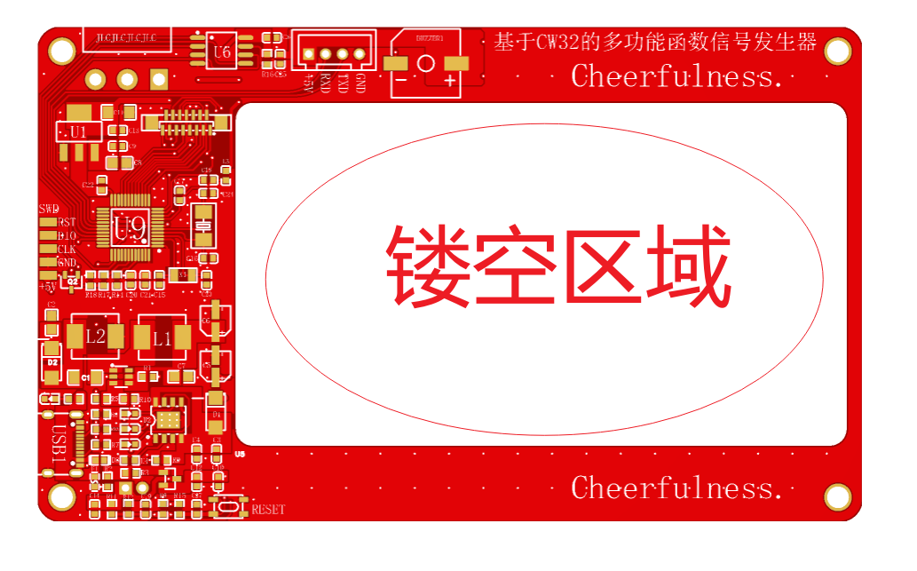

the first circuit board designed in this project was red, using a 1008 package inductor. However, during actual testing, it was found that it couldn't power the 4.3-inch screen. I disassembled it and replaced it with a larger package 6050 22uH inductor, and it worked fine. Therefore, in actual circuits, the selection of energy storage components is very important. Both the AD9910 and the 4.3-inch screen require a relatively large current supply, and the integrated buzzer also requires a significant current to drive.
