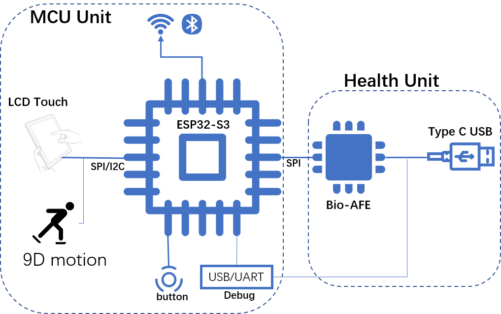

The design principle
         is shown in the figure. The project uses the Espressif ESP32-S3 as the main controller, supporting WIFI & Bluetooth 5 (LE) network connectivity; it connects to the 9D motion sensor, touchscreen, and charging/discharging management unit via the I2C bus interface; one SPI interface supports a 240x280 color LCD screen; another SPI interface connects to a health data acquisition unit to realize human health functions such as heart rate and blood oxygenation.
             A multi-functional external button is provided to enable power on/off, Home, and long-press reset functions.
             The device supports USB Debug functionality; leveraging the compatibility of the Type-C USB interface, it also supports the expansion of other hardware sensors: such as electrodes necessary for measuring ECG/EMG/EEG or impedance; or various new wearable cutting-edge technology hardware interfaces such as piezoelectric/resistance sensors.

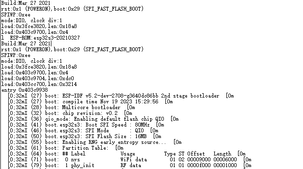

Software Description:
The firmware of the ESP32-S3 watch project is designed based on the Espressif ESP-IDF v5.2 development framework and can be ported and debugged based on the example esp-idfexamplesperipheralslcdspi_lcd_touch:
1> Hardware Driver Porting:
A> For the GUI, and related screen, touch, and button configurations, modify the component dependency file idf_component, adding the following content:

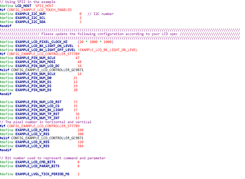

B> Modify the relevant hardware IO configuration, as follows:

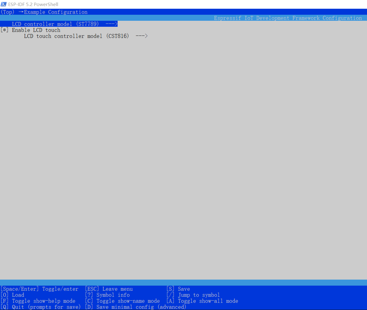

C> Configure the project predefined configurations through idf.py menuconfig:
2> UI Design:
Design the UI using the UI design tool SquareLine Studio 1.3.3 and generate the code.

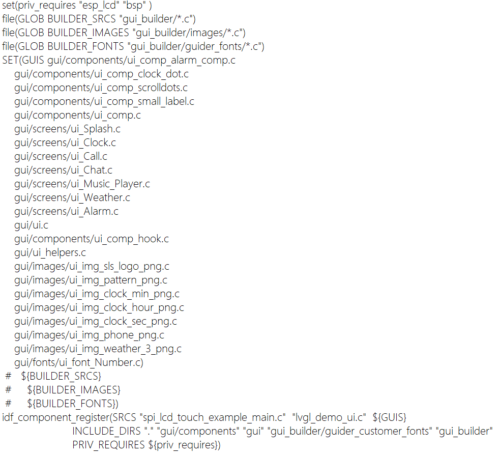

A> Modify the CMakeLists.txt file and import the generated code into the compilation project:

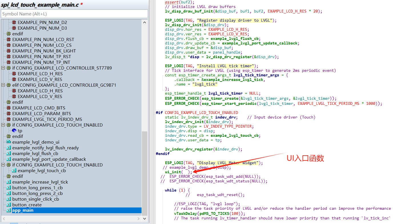

B> As shown in the image below, modify and add the UI entry function and compile the project:

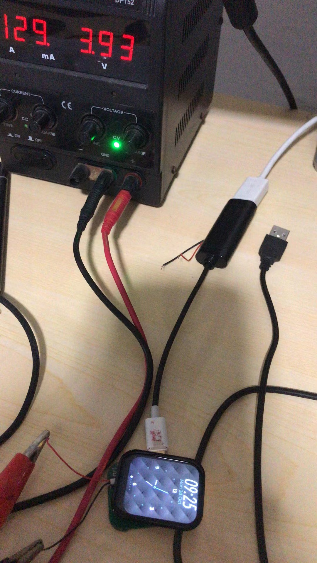

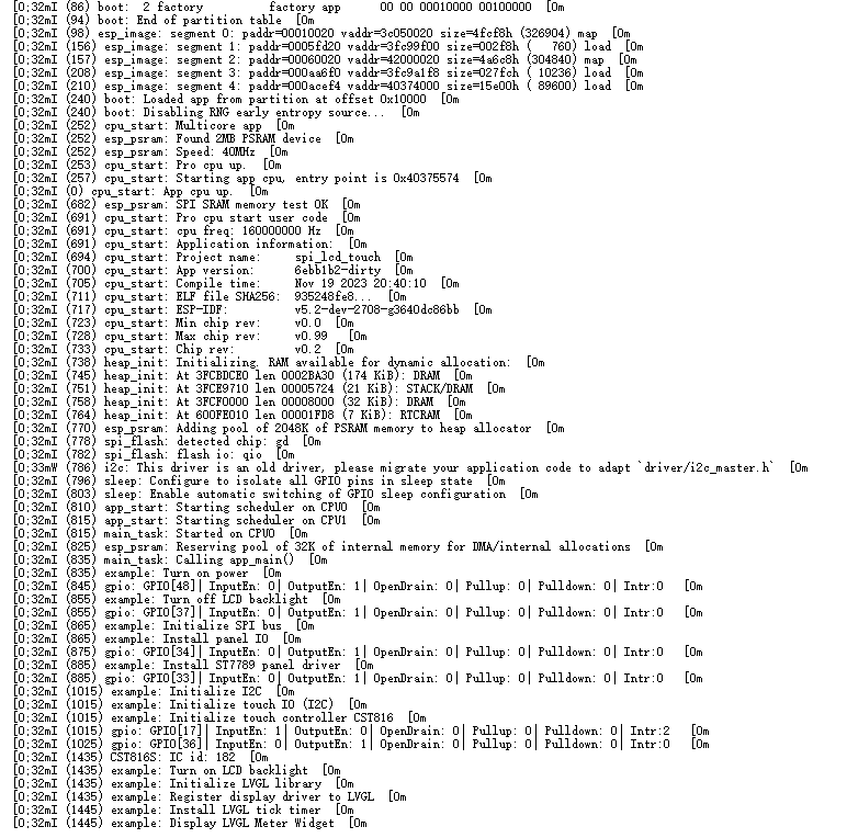

C> Debugging and running Logo illustration:
D> Software debugging scene images:

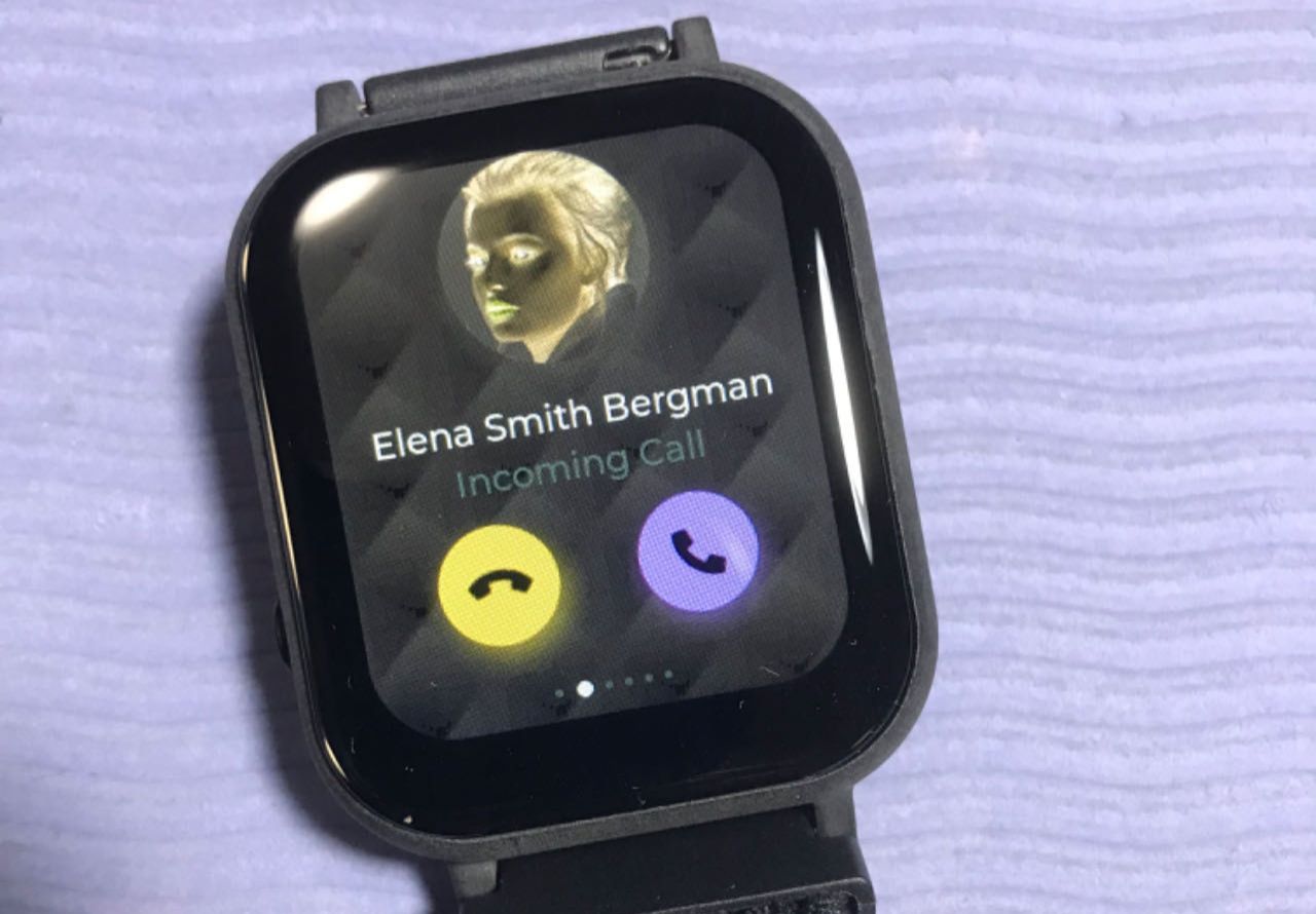

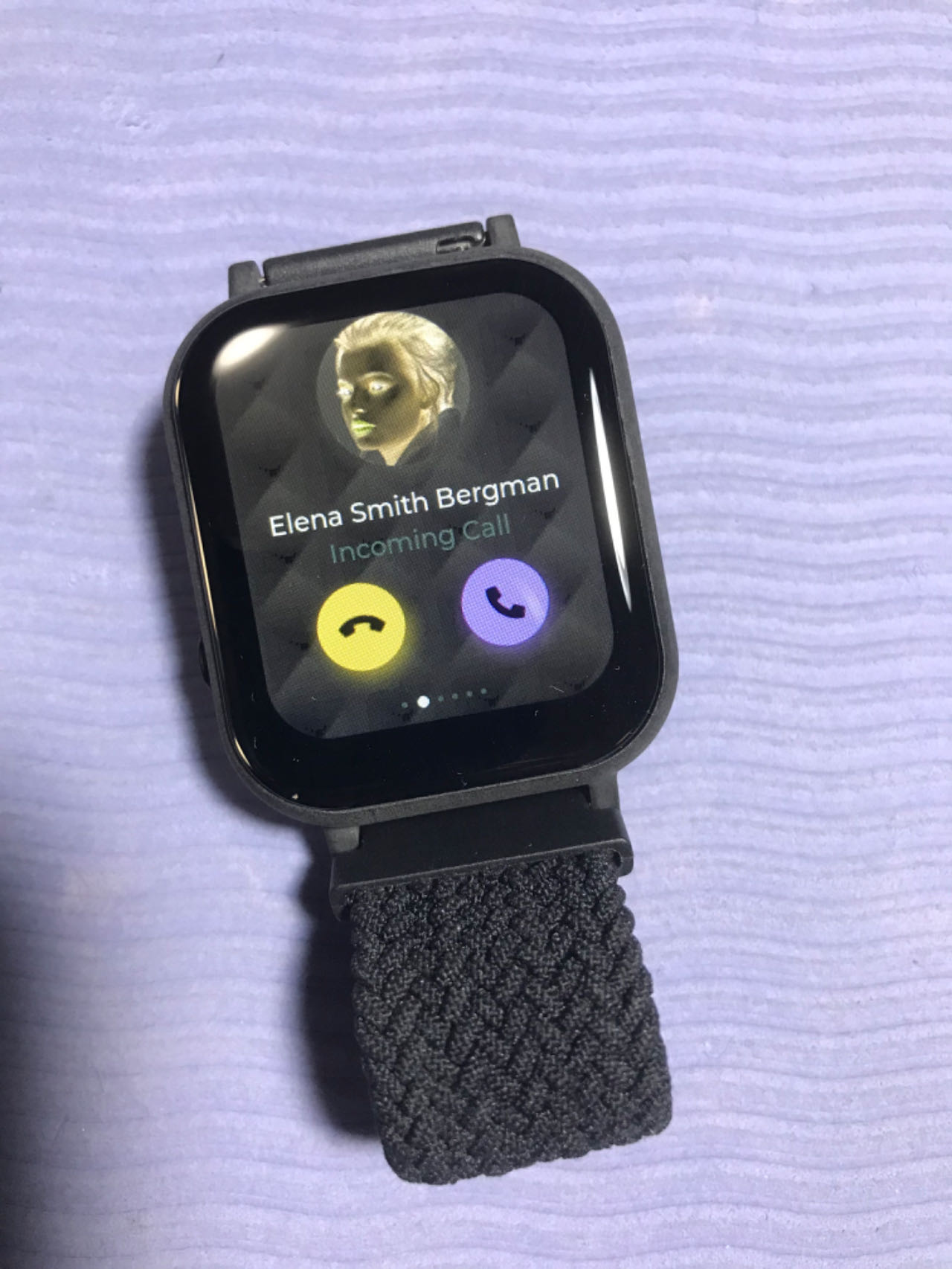

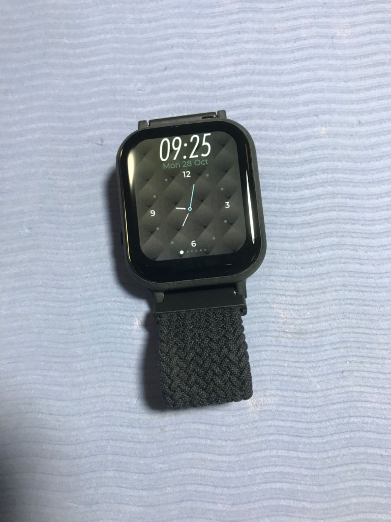

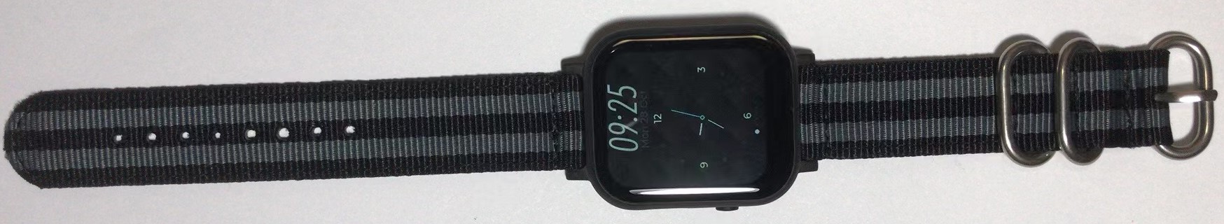

Physical watch demonstration
image 1:
Watch image 2:

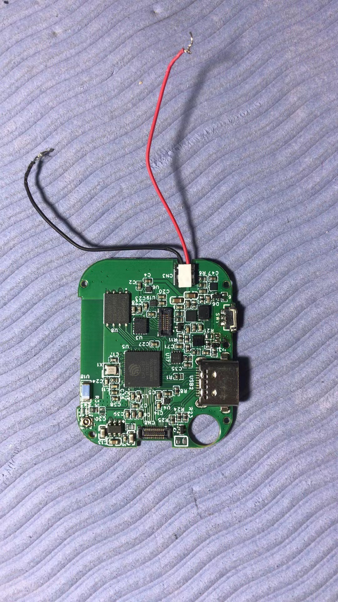

PCB motherboard:

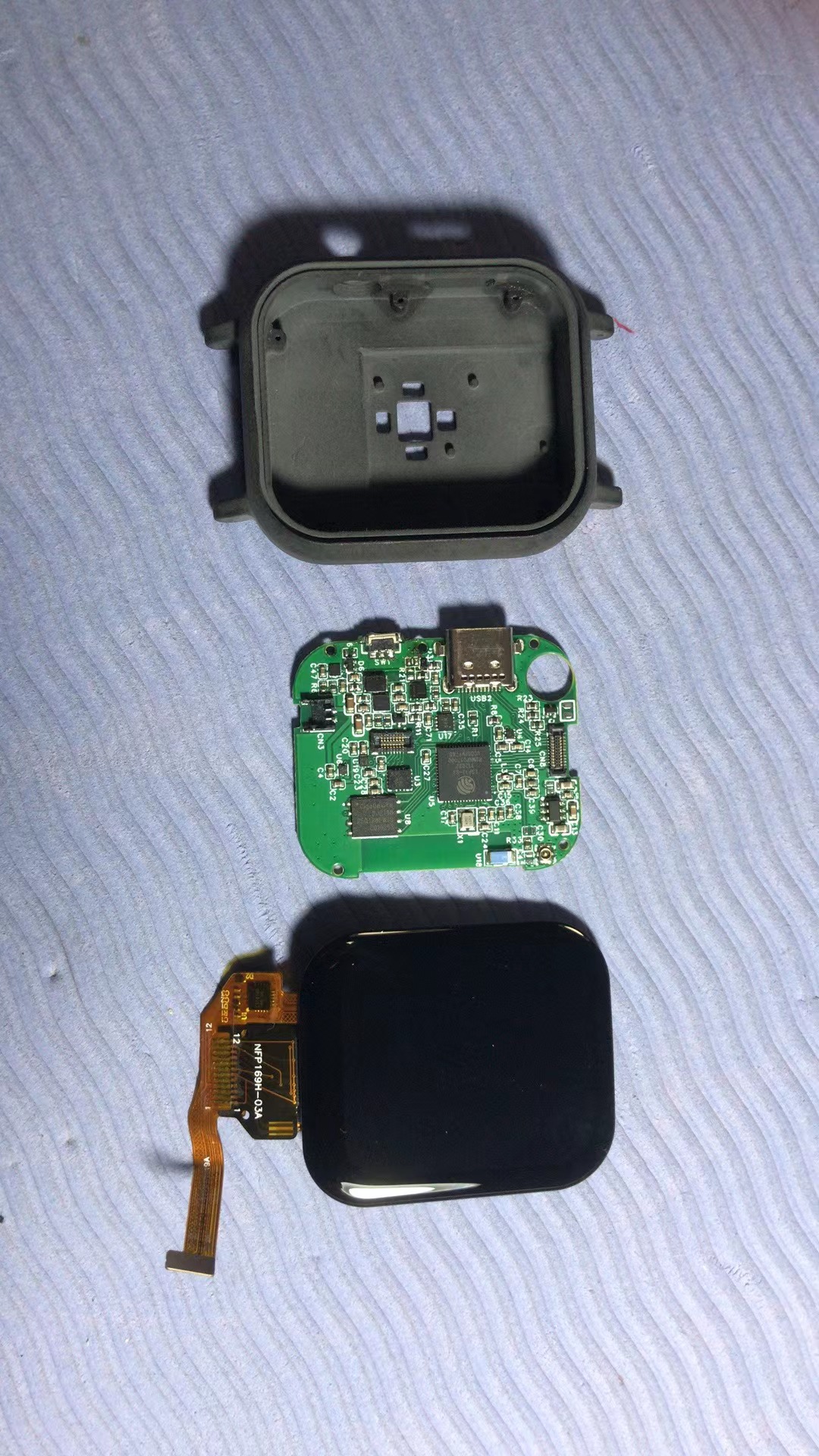

Watch structure physical object:
