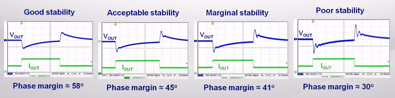

Dynamic loads can be used to generate (consume) controlled, rapidly changing currents, creating disturbances in the power supply's control loop. The response to step load changes provides an indication of the power supply's stability margin. Compared to using a loop tester to generate a Bode plot, dynamic loads are much simpler, faster, and less expensive.
The following diagram roughly illustrates the relationship between transient response and output phase margin (source: YouTube)

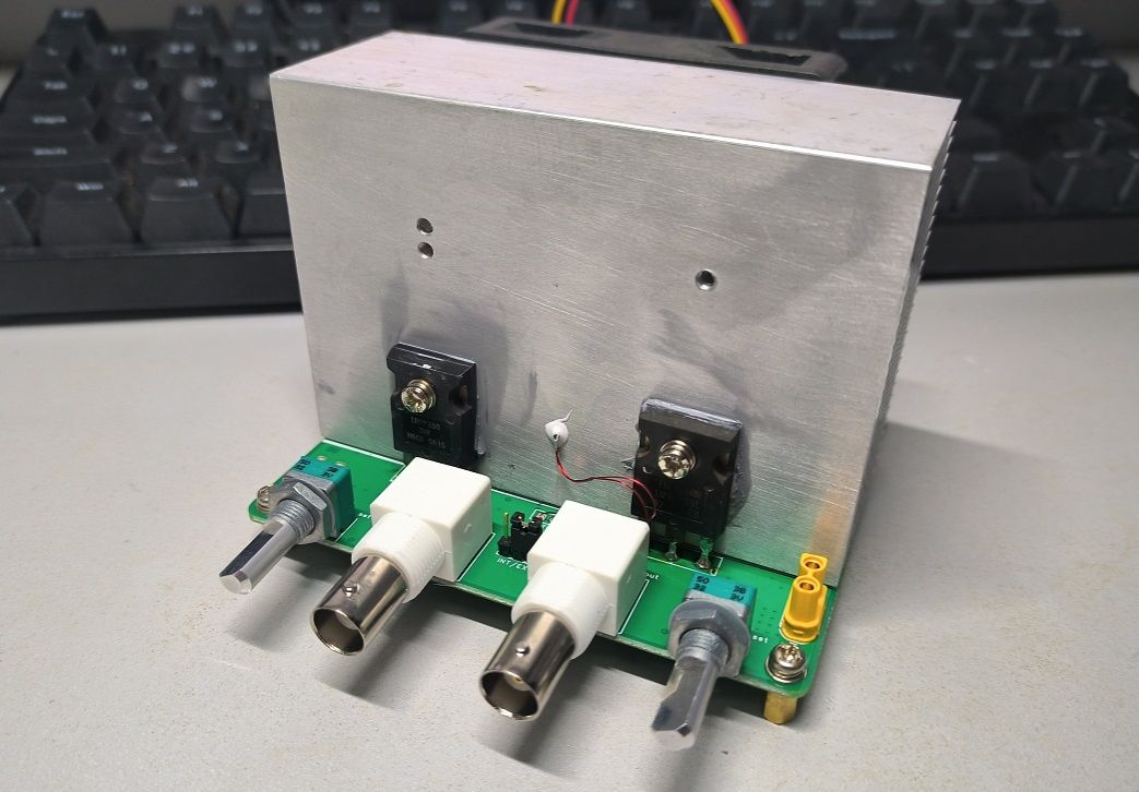

Parameters and Usage Instructions:
If mica insulation is not used (recommended not to use it for optimal heat dissipation), the heatsink should be connected to the positive terminal of the power supply under test. Be careful to prevent short circuits!
Input voltage range: 36V max (limited by input TVS:D3)
Maximum current: 12A
Maximum power dissipation: 120W
Step current: 6A
When using, first plug in a Type-C power supply to provide operating power (you need to manually measure whether you have successfully obtained 12V voltage). The blue LED is the operating power indicator. Connect the power supply under test (DUT) to the XT30 connector. It is recommended to use short, thick wires, or at least twist the positive and negative wires together to reduce parasitic inductance. The green LED indicates that the DUT is connected. First, adjust the left potentiometer knob to set a constant current, then adjust the right potentiometer knob as needed to set a step current. The pin header and jumper cap in the middle of the BNC connector can be used to set an arbitrary waveform current using the internal current setting or the input voltage of the left BNC connector, with a ratio of 100mV/A. The right BNC connector outputs the actual current detection value, with a ratio of 1V/A. When the heatsink temperature rises to a certain level, the cooling fan will automatically start. When the temperature continues to rise and triggers over-temperature protection, the red LED will light up, the load will stop working, and it will automatically resume working after the temperature drops.

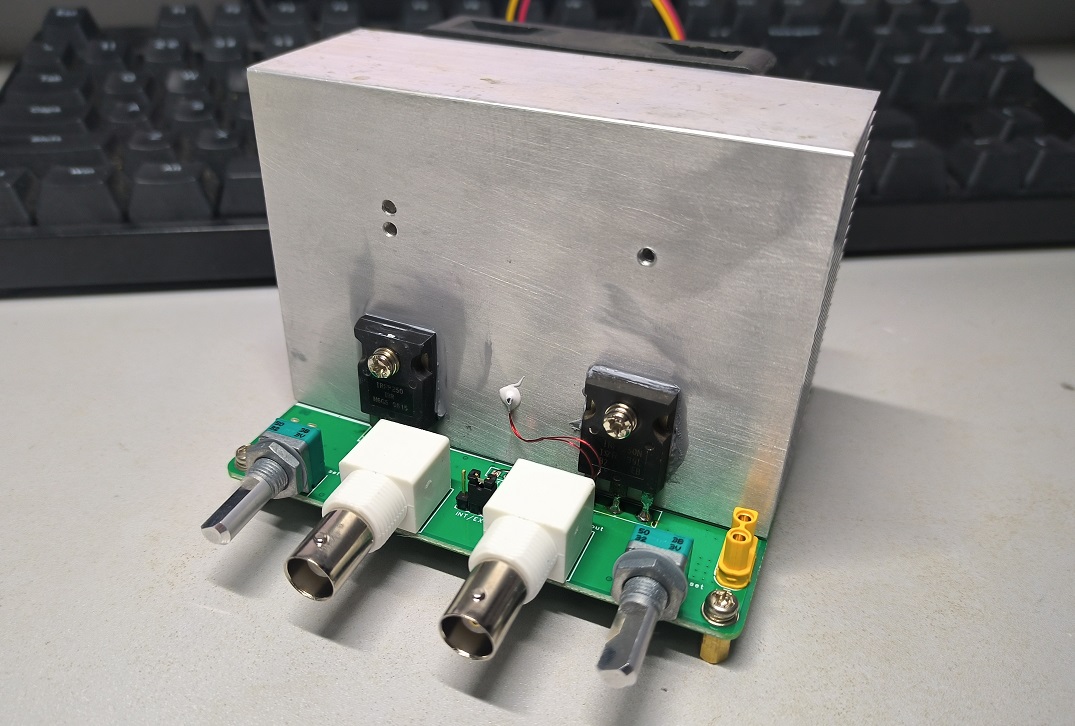

Assembly instructions:
In addition to the components in the schematic, the following accessories are required:

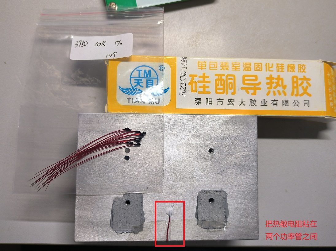

One 3950K 10KΩ NTC resistor (with wire);
two BNC male-to-male wires (monitor level is sufficient); one aluminum fine-toothed heatsink with input/output bandwidth
, measuring 100mm long, 69mm wide, and 36mm high, with holes drilled and tapped for mounting MOSFETs.

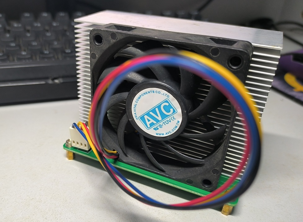

One 12V 7CM fan.
One Type-C fast charging adapter supporting 12V output.
Several M3 screws and copper pillars.
One
tube of thermal paste. One tube of thermal adhesive.
I actually used TP2274 and TP2272 op-amps. Using LM324/LM358 may affect the comparator threshold/loop bandwidth, so please pay attention when preparing the components.
After assembling the components, attach the NTC resistors to the heatsink with thermal adhesive (note that it is not thermal paste) as shown in the diagram, and solder them to the corresponding pads. Apply thermal paste (note that it is not thermal adhesive) between the MOSFET and the heatsink.
The fan can be directly attached to the PCB. Refer to the main diagram for the rest of the assembly.

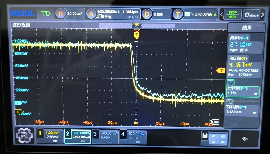

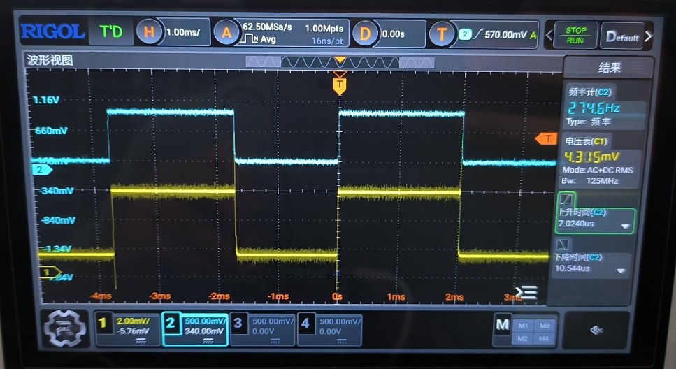

Test data:
CH1: Voltage across the sampling resistor; CH2: Total current monitoring output voltage (
16-point averaging enabled, magnified observation of falling edge, fall time 9.43µs)

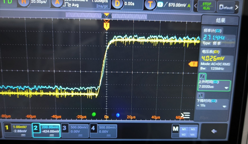

; CH1: Voltage across the sampling resistor; CH2: Total current monitoring output voltage (
16-point averaging enabled, magnified observation of rising edge, rise time 7.03µs)

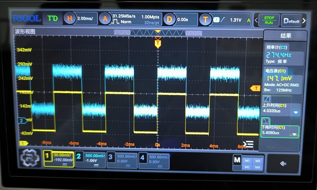

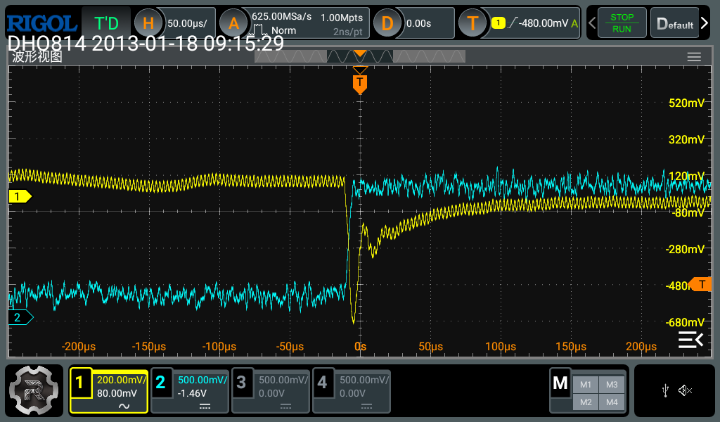

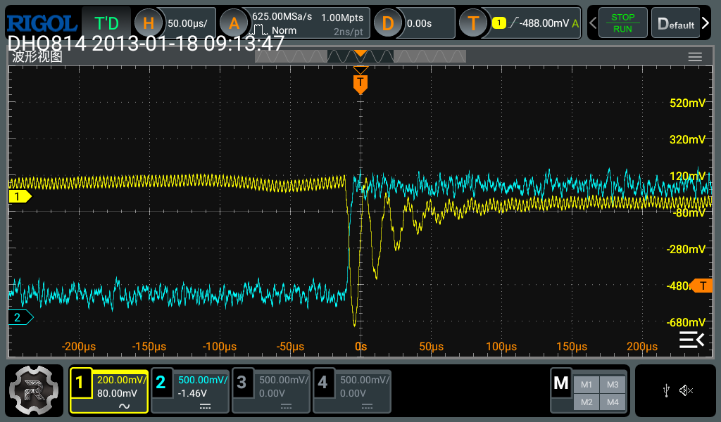

Regarding the transient response of this relatively acceptable step-down module, the voltage quickly recovers to a stable value without ringing. Based on the response time, the loop bandwidth can be approximately calculated.
CH1: Output voltage (AC coupled), CH2: Total current monitoring output voltage.

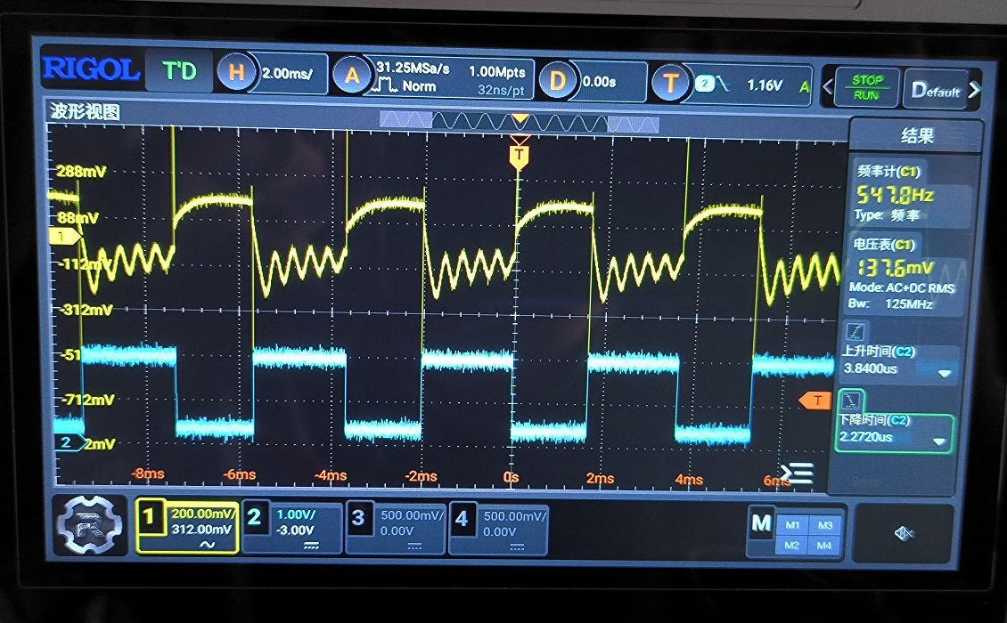

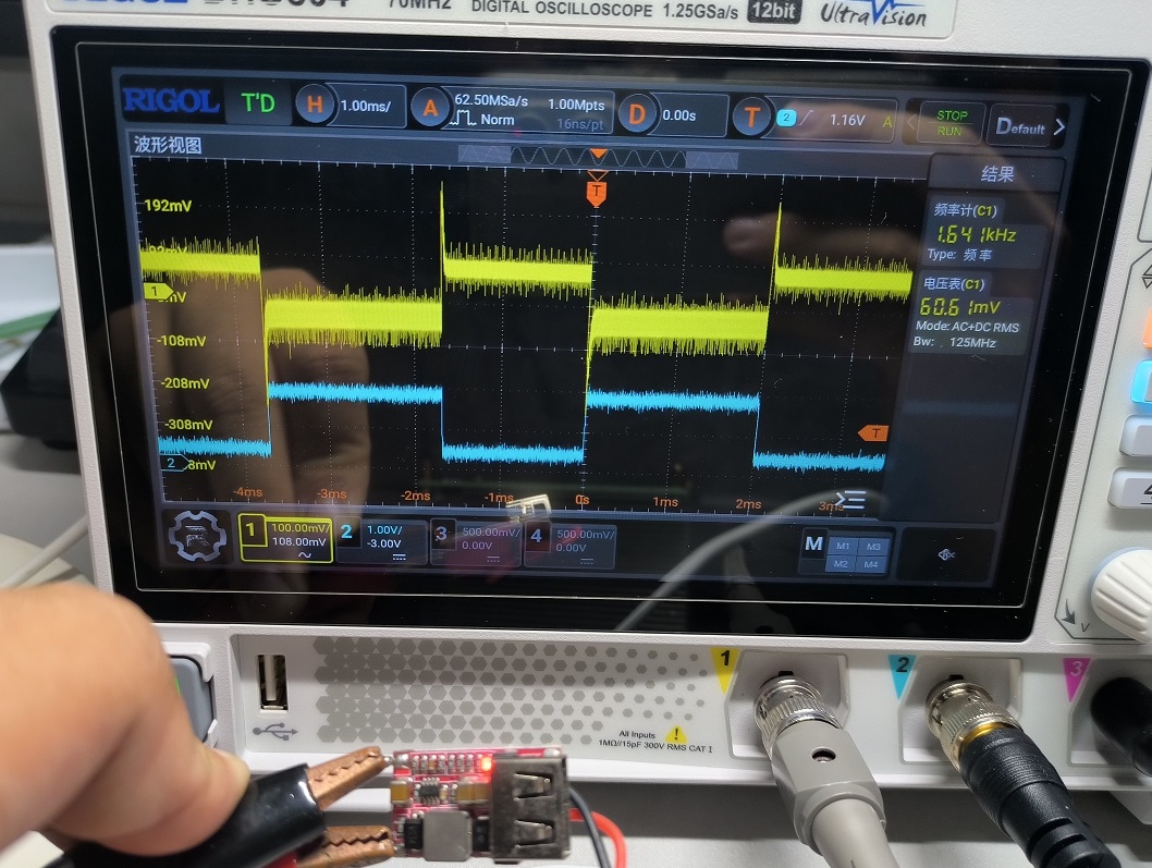

A poor transient response of a buck adjustable power supply exhibits significant output oscillation and a long settling time (unable to stabilize within one test cycle).

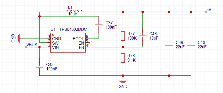

Example of use: The transient behavior

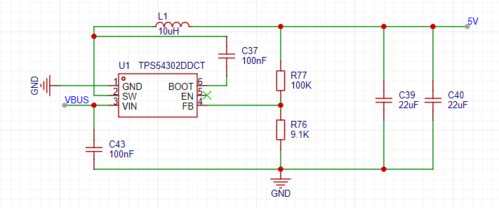

of a typical buck circuit is shown in the following figure: CH1: Output voltage (AC coupled), CH2: Total current monitoring output voltage. It can be seen that a significant oscillation occurs at the rising edge of the step current, a typical manifestation of insufficient phase margin. Next, following the datasheet, a feedforward capacitor (10pF) is added . The transient behavior after adding the capacitor is shown in the following figure:
CH1: Output voltage (AC coupled), CH2: Total current monitoring. The output voltage
oscillation has been significantly improved, but the phase margin is still insufficient, and the feedforward capacitor needs to be further increased (mainly because there is no suitable pF-level capacitor on hand, only a 10pF capacitor).
