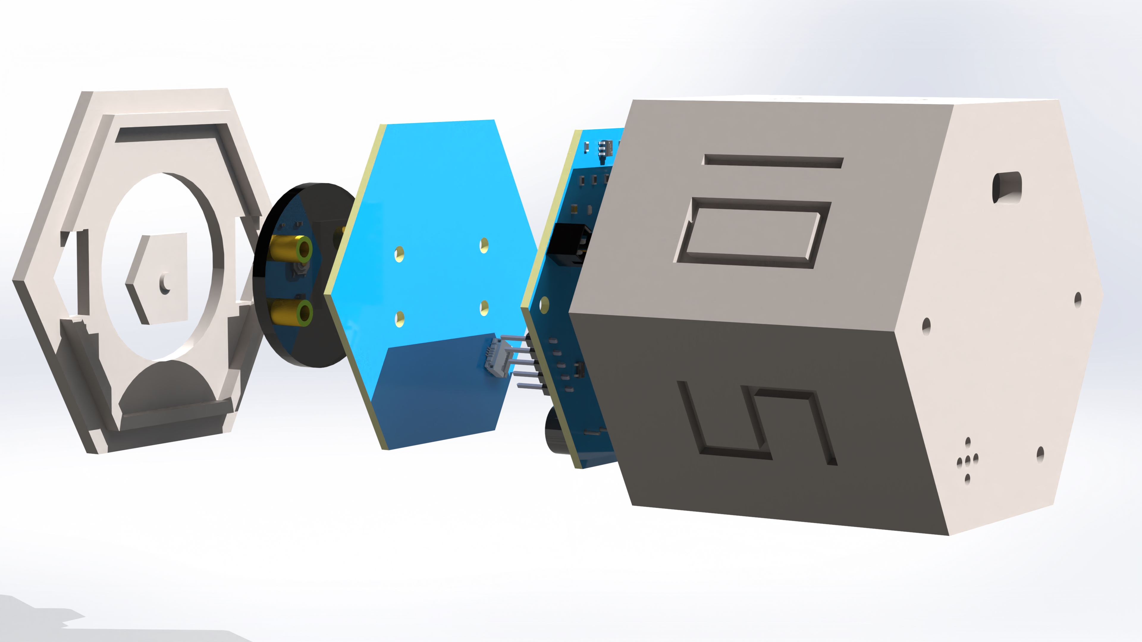

When conceiving the product, it was found that this product would require at least two boards to realize. My design is that the main board is located at the bottom and the secondary board is located at the top.

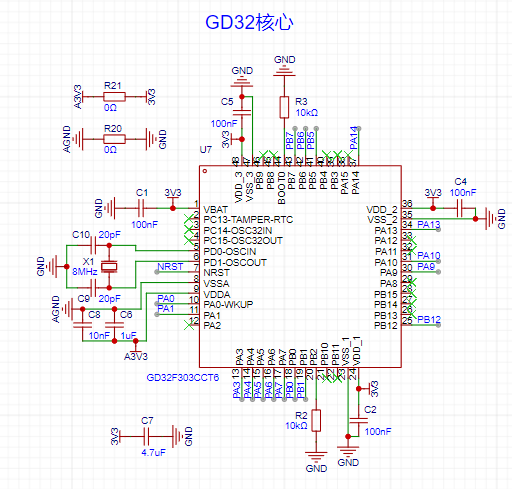

Regarding the choice of main controller, this product doesn't require many external devices, thus minimizing the number of pins. However, for the GUI, I chose the LVGL library, and for the MPU6050, I plan to port the official DMP library. These two libraries consume a significant amount of memory and CPU power, so a Cortex-M4 architecture and a model with ample memory are necessary. Ultimately, I chose the GD32F303CGT6. This model from GigaDevice has a 168MHz clock speed and 1024KB of RAM, fully meeting the needs of this project, and importantly, it's inexpensive.

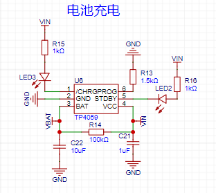

Because this product is powered by a lithium battery, charge and discharge management is required. The classic TP4059 chip was chosen, capable of achieving a maximum charging current of 800mA. If speed isn't sufficient, the TP4056 can be used, achieving a maximum charging current of 1A.

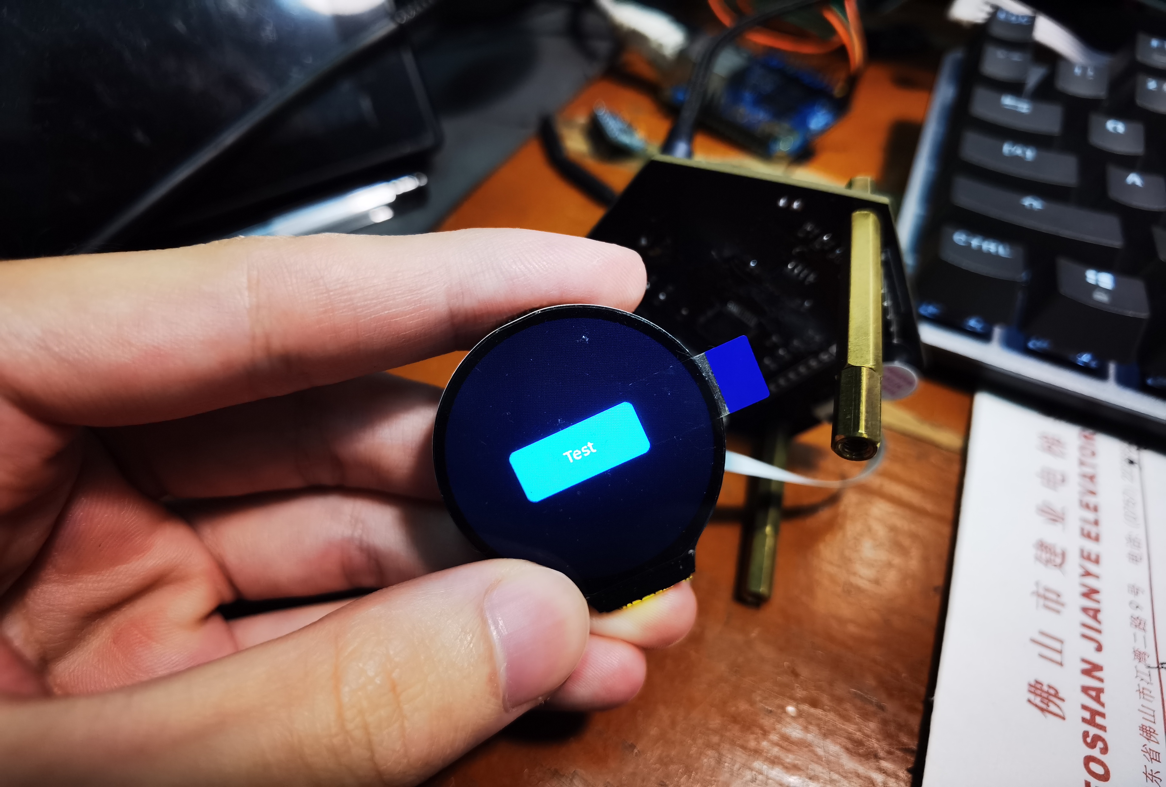

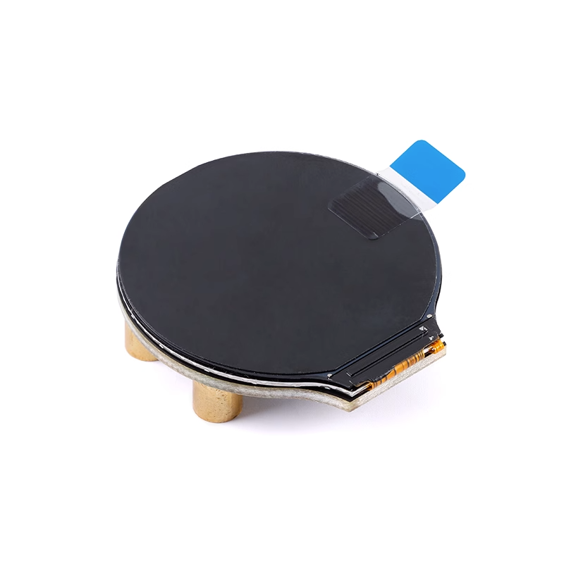

For the screen, a round LCD screen was chosen, with a GC9A01 driver chip, using SPI for communication, and a resolution of 240x240.
Screen purchase link: https://item.taobao.com/item.htm?spm=a21n57.1.0.0.5f5f523cr8s2nu&id=684295016053&ns=1&abbucket=3#detail

The lithium battery charging circuit can generally be drawn according to the datasheet. A 1.5kΩ feedback resistor (PROG) will provide a maximum charging current of 800mA.

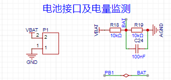

Battery power monitoring can be simply achieved using a series voltage divider, reducing the battery voltage by half. As long as the full-charge voltage is less than the microcontroller's 3.3V, it's sufficient.
2. Main Control Section
The main control circuit can generally be designed according to the datasheet, but an external crystal oscillator is essential because this product is a timer; using an external crystal oscillator ensures accurate timing. Additionally, the ADC power supply and ground are isolated using a 0Ω resistor, which improves anti-interference capability.

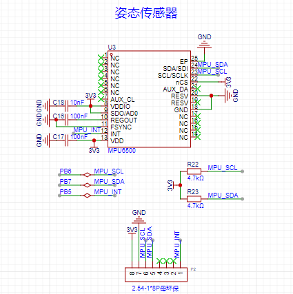

3. Attitude Sensor:
The attitude sensor used in the schematic is the MPU6500, which is essentially the same as the MPU6050 except for its lower price. A female header for the MPU6050 is provided. This design is because both the MPU6500 and MPU6050 are QFN packages, extremely difficult to solder by hand. Therefore, if hand soldering is not possible, a ready-made module can be directly connected nearby.

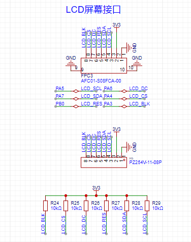

4. Screen:
The screen is fixed to the sub-board, so the main board has an FPC interface for connection. It was discovered early on that if hardware SPI communication with the screen is required, pull-up resistors must be added, which is quite inconvenient. Similarly, a female header is provided for screen connection, as FPC sockets are also difficult to solder by hand.

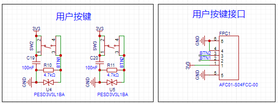

5. User Buttons:
The user buttons are also on the sub-board and connected to the main board via an FPC. All-metal waterproof buttons were chosen for durability, and a bidirectional transient suppression diode was added to the circuit for protection.

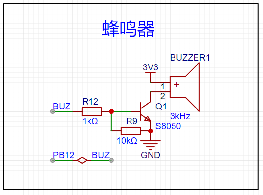

6. Buzzer
: I chose an active buzzer, since every component less soldered is a valuable asset. I simply used a transistor to control the switch.

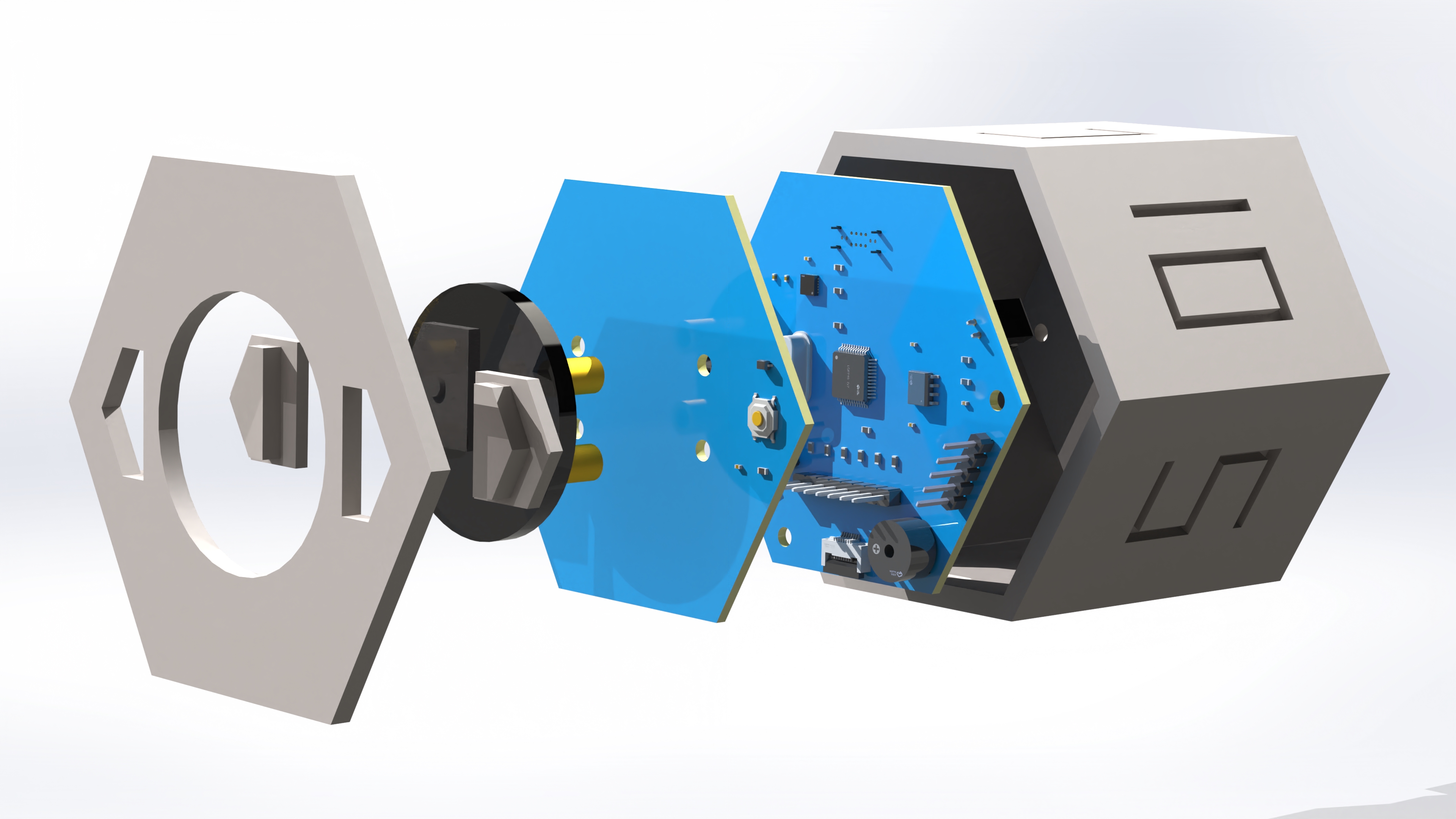

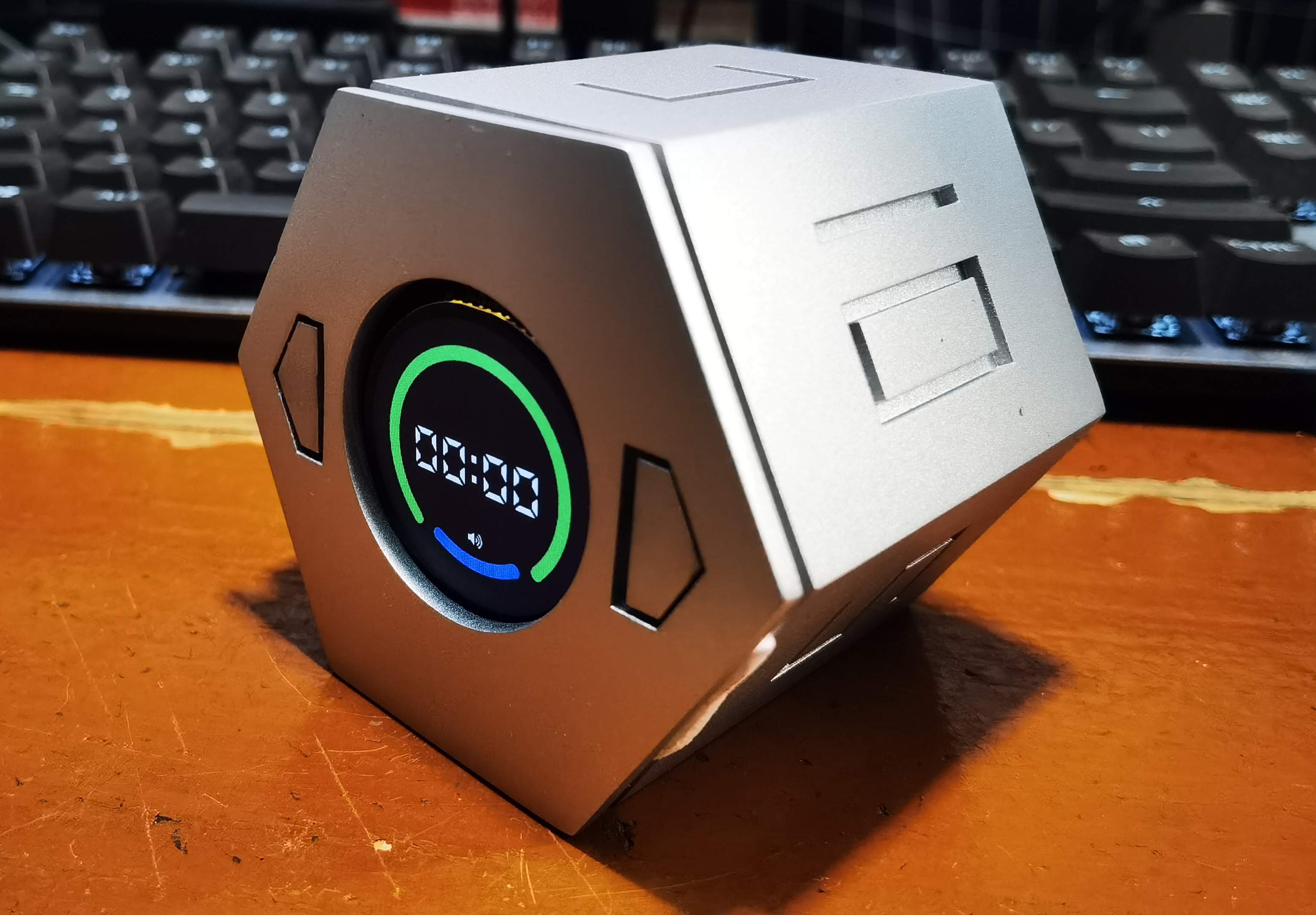

Appearance Design:
The appearance design is rather rough, as this was my first time designing a casing and I didn't have much product design experience.
The original design used aluminum alloy + diffuser plate + plastic, which was obviously a bit pricey. So, I devised a pure 3D printing solution based on my own ideas.

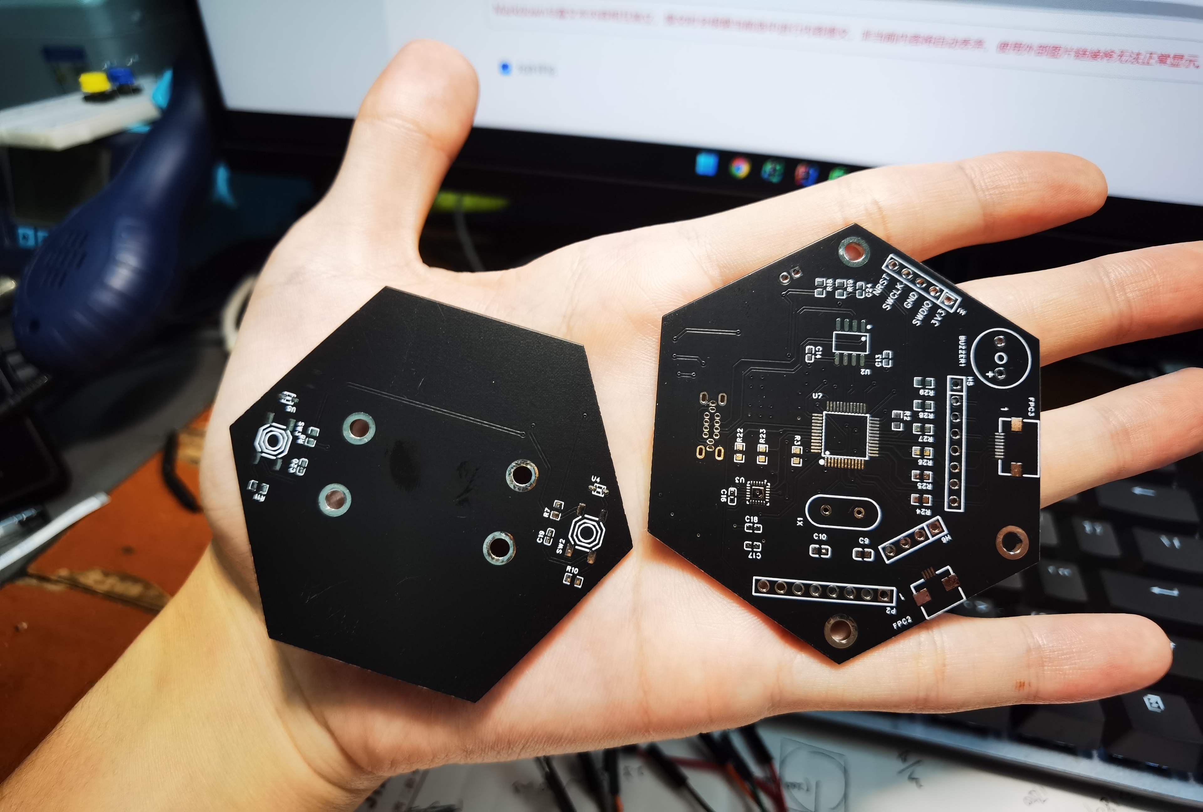

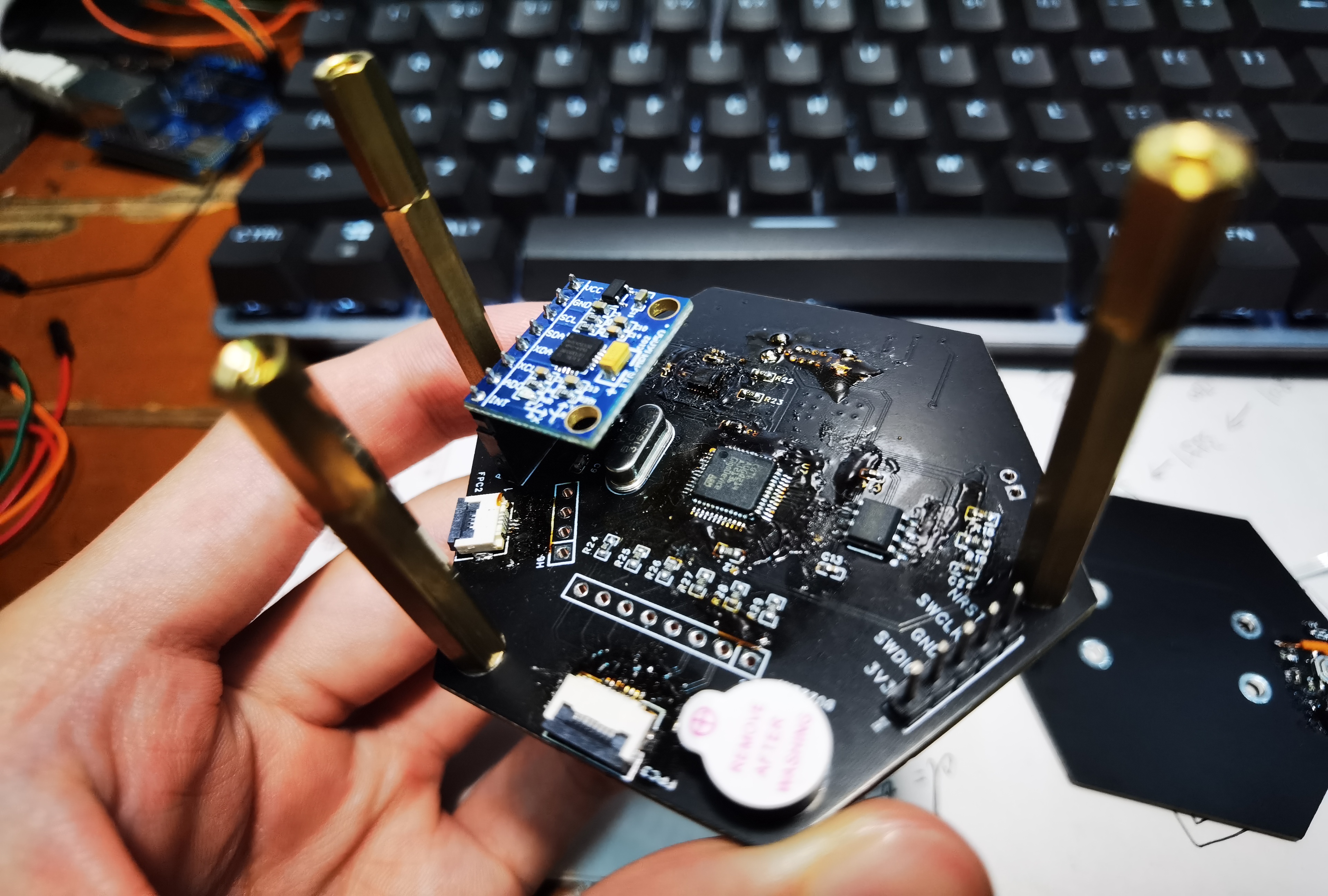

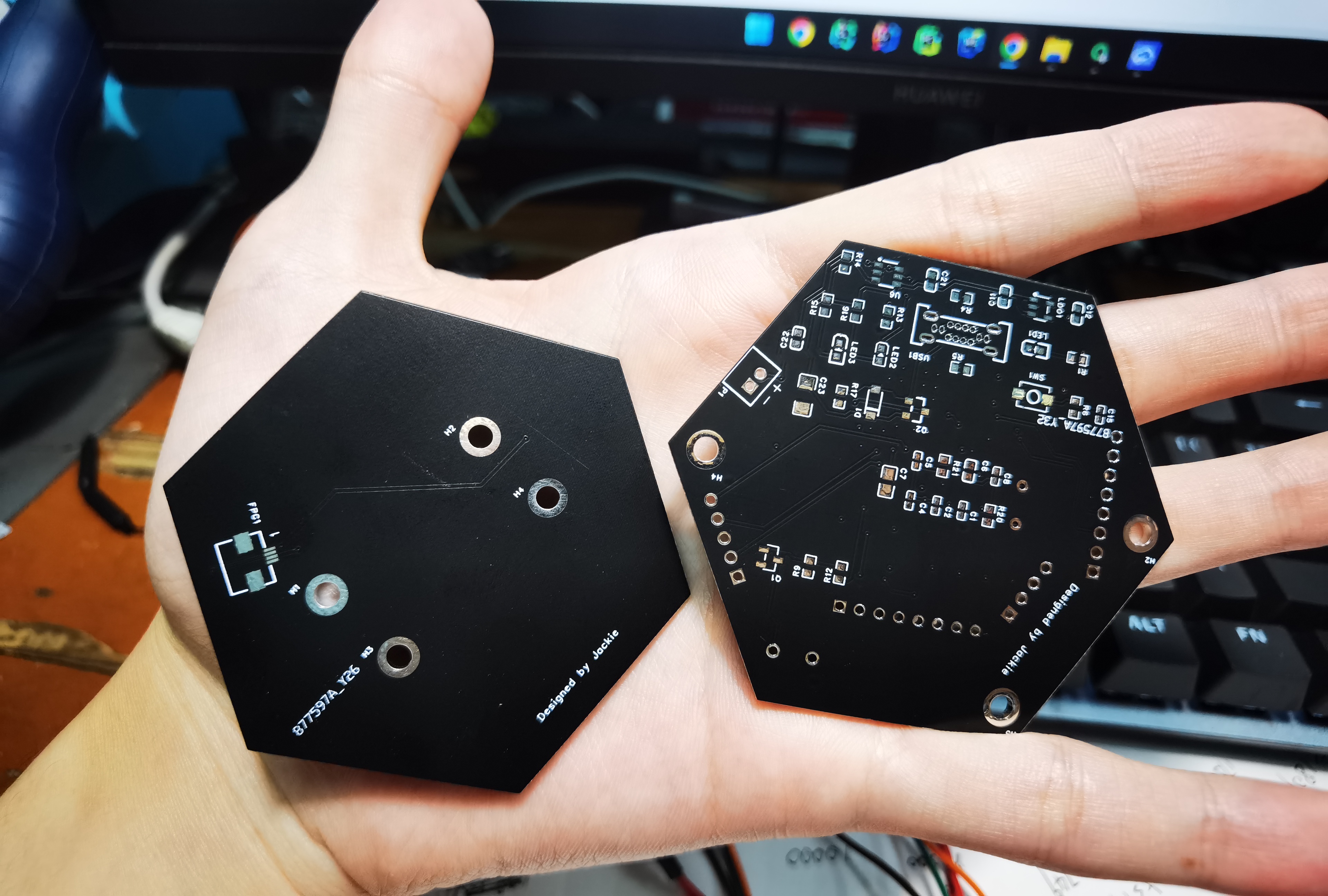

(Part 1): PCB
: Bare PCB board.

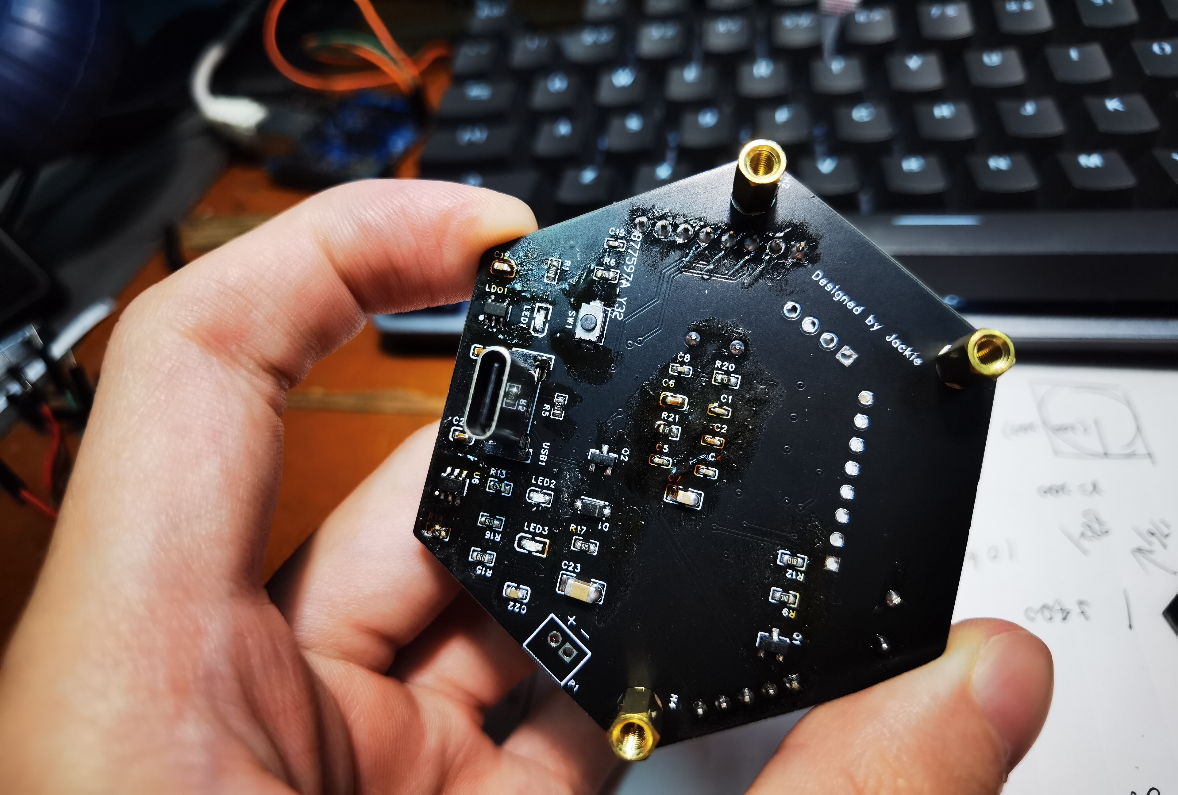

Soldered PCB board.
Simple LVGL port for verification.

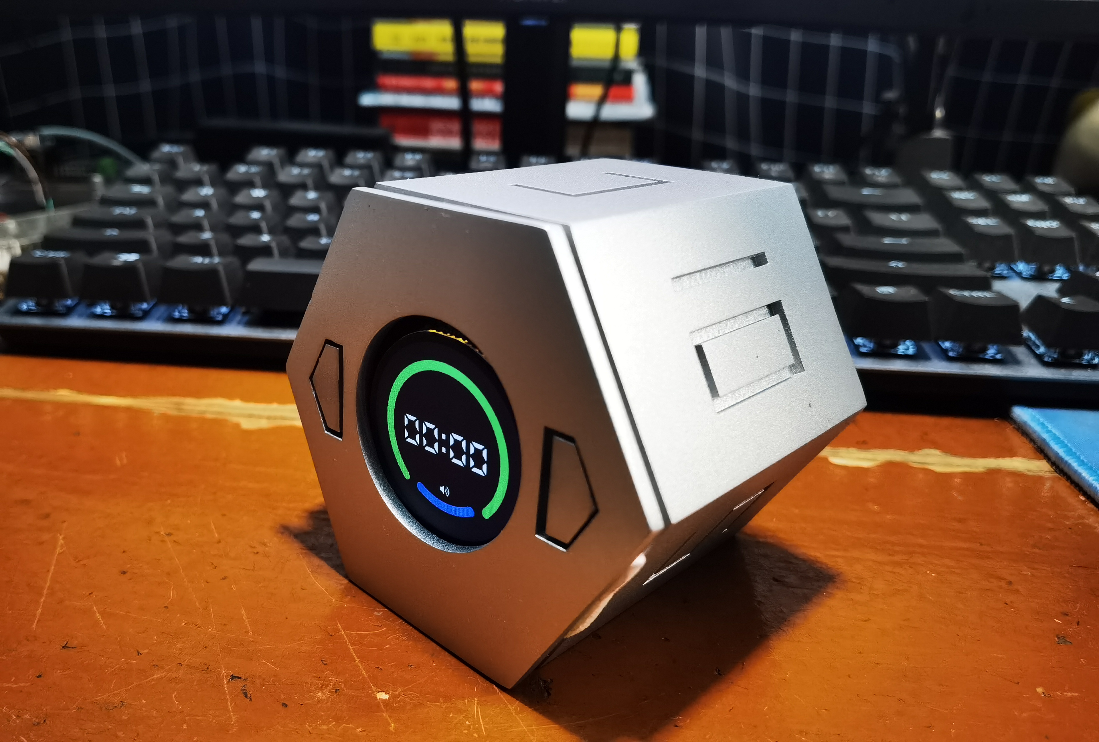

Actual product after assembly.
Summary
This Spark Program project was the most challenging project I've ever undertaken. I had to handle everything myself, from PCB design and casing design to component soldering and coding. For a complete novice like me who had never designed a product before, this was a huge challenge, and obviously, the final product wasn't perfect.
