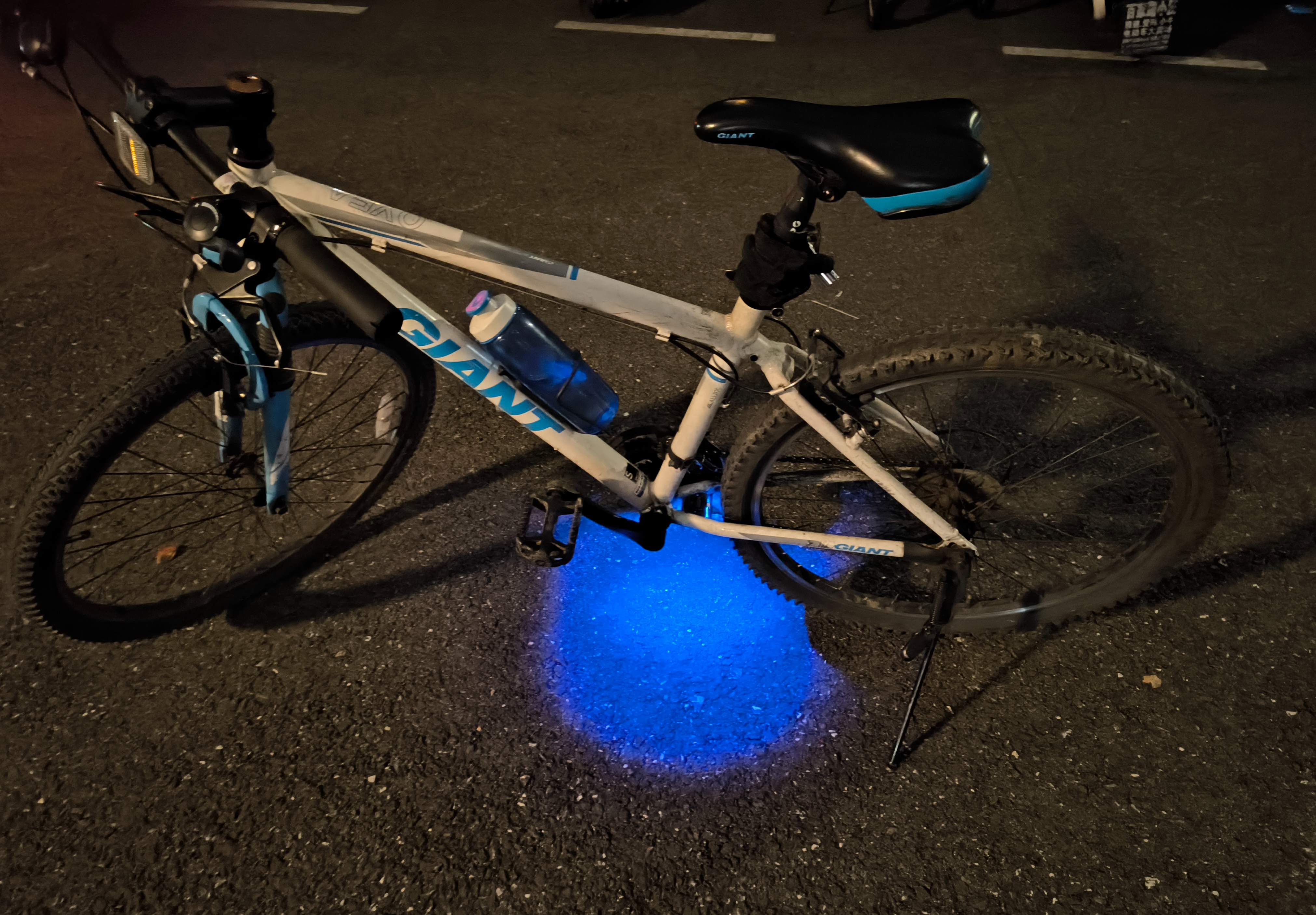

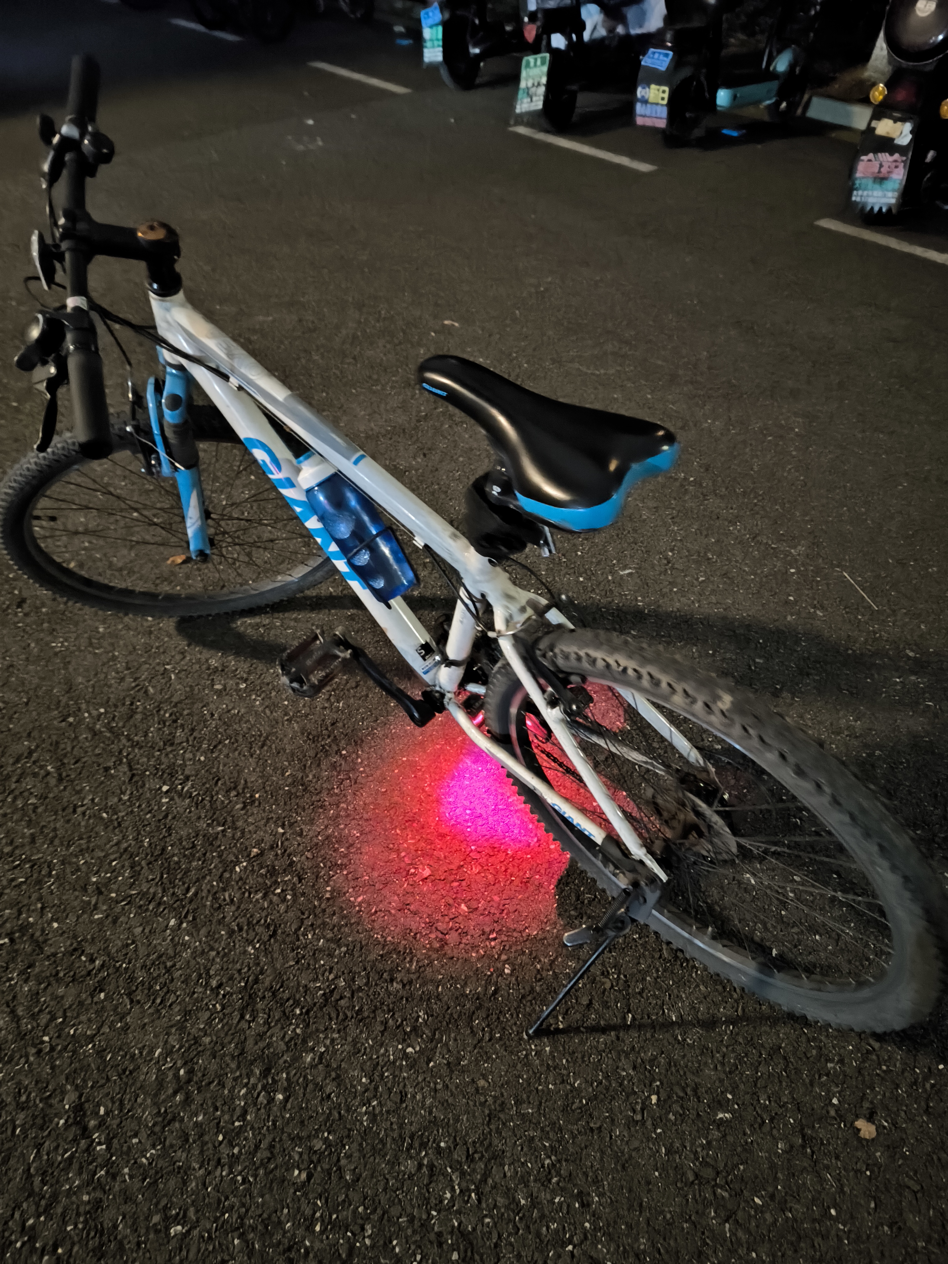

       This hardware implements a function that displays different lighting effects based on the bicycle's movement status, illuminating the ground near the bicycle to achieve a cool, aesthetically pleasing, and warning effect. Currently, the effect is a blue breathing light effect during normal riding, acceleration, and gliding; the light turns red when braking, and returns to the blue breathing light effect after braking ends. When the bicycle is stationary, an RGB scrolling light effect is displayed for two seconds before turning off and entering sleep mode. It will re-enter working mode if the bicycle resumes movement within two minutes. If the bicycle remains stationary for more than two minutes, it will automatically shut down and require manual restart.

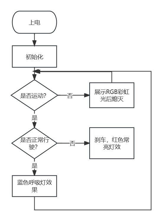

Overall Idea: A six-axis gyroscope is used to identify the current acceleration of the bicycle's movement, dividing it into two states: stationary and moving. Then, based on the magnitude and sign of the acceleration (mainly the Y-axis), braking and normal riding states are distinguished. After determining the different states, the microcontroller executes relevant code to control the two RGB lights to change the lighting effects.

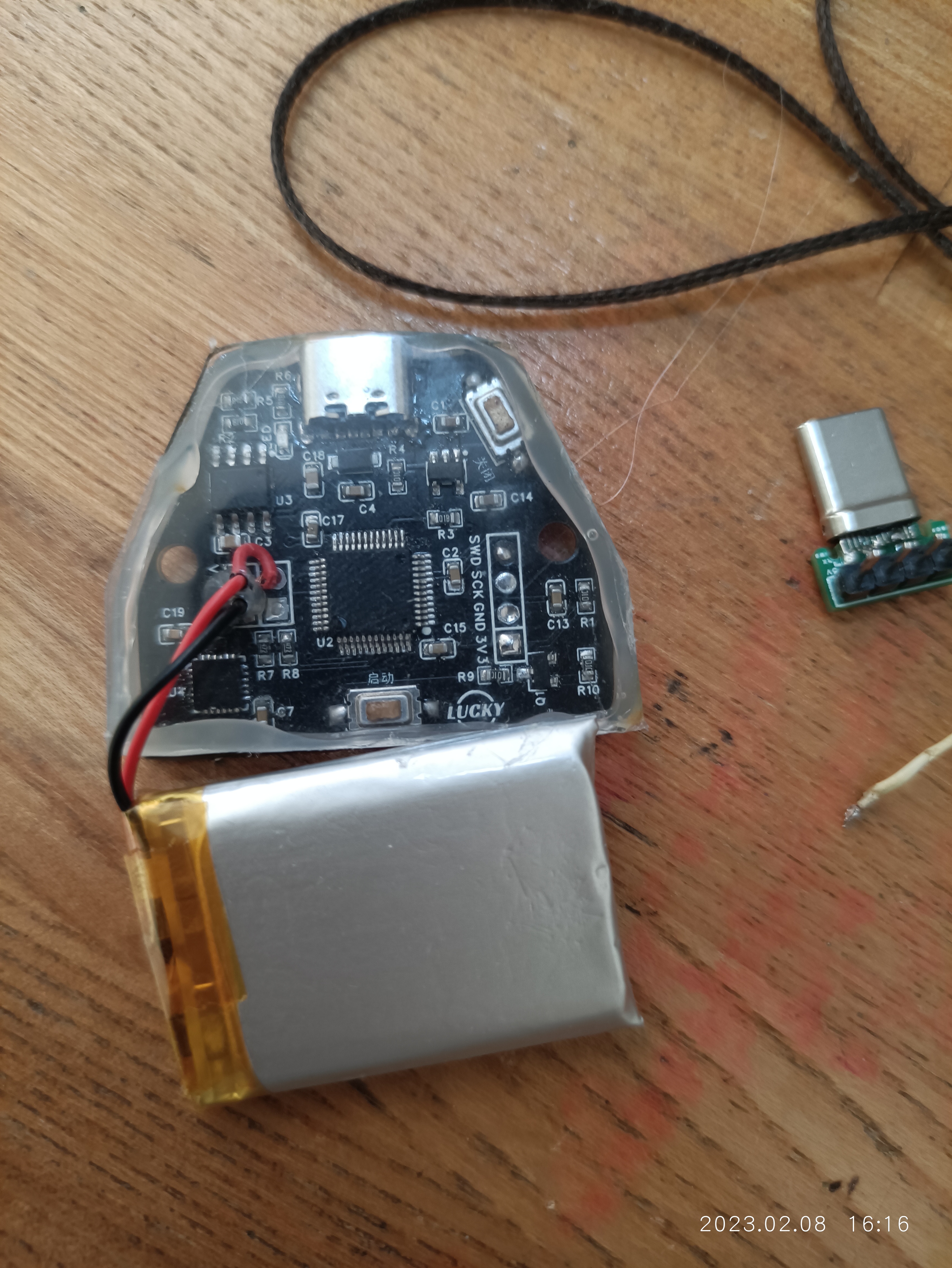

Waterproofing: Due to the nature of bicycles, especially the placement of this hardware, stability in outdoor operation is required. It must be waterproof, dustproof, and moisture-proof. The circuit board is sealed on both sides with conformal coating.
Board Shape: Because the bottom structure of each bicycle is different, the PCB board needs to be highly customized, with the shape designed according to the actual situation.

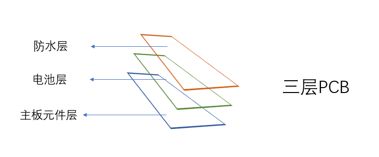

Structure: This device adopts a double-layer structure with three isolated PCB boards. The bottom board is the main board, with the LED lights below corresponding to the holes on the bicycle. The gap in the lower layer comes from the microswitch; with the middle board, the pressing device can be powered on. The upper layer houses the battery, which is led to the lower layer through holes on the PCB. The top panel is covered with a waterproof material (such as tape) for waterproofing and dustproofing. The gap between the upper and lower layers needs to be sealed to prevent water ingress; hot melt adhesive is used here. Hot melt adhesive is elastic and also makes it easy to press the switch. The Type-C charging port needs to be plugged with adhesive.

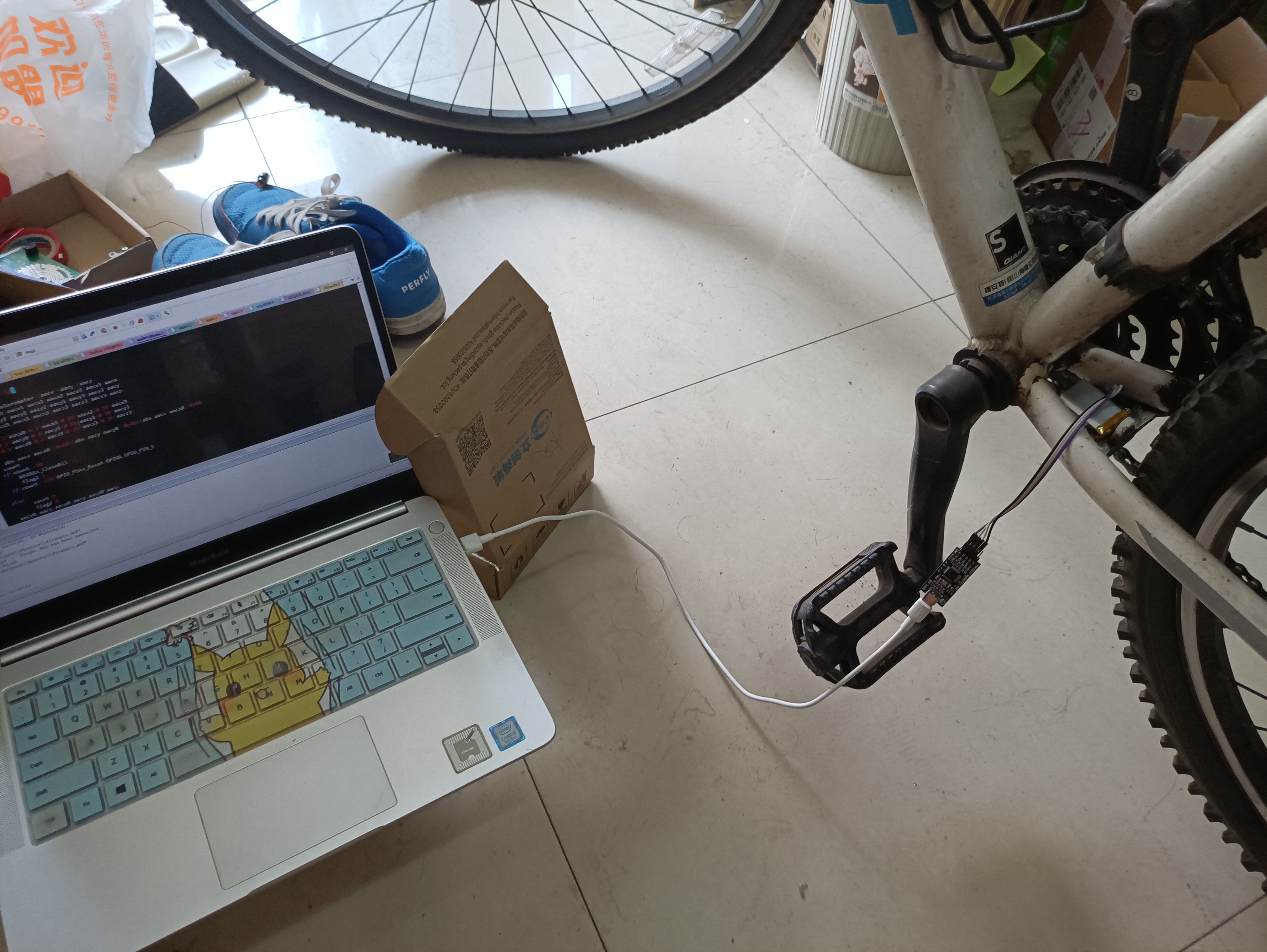

Debugging: The space under the bicycle is limited, making DAP debugging inconvenient. To debug the device on the bicycle, the SWD and SCK pins are connected to the Type-C port. A conversion PCB is designed to bring them to an easily accessible debugging location. (Connector)
