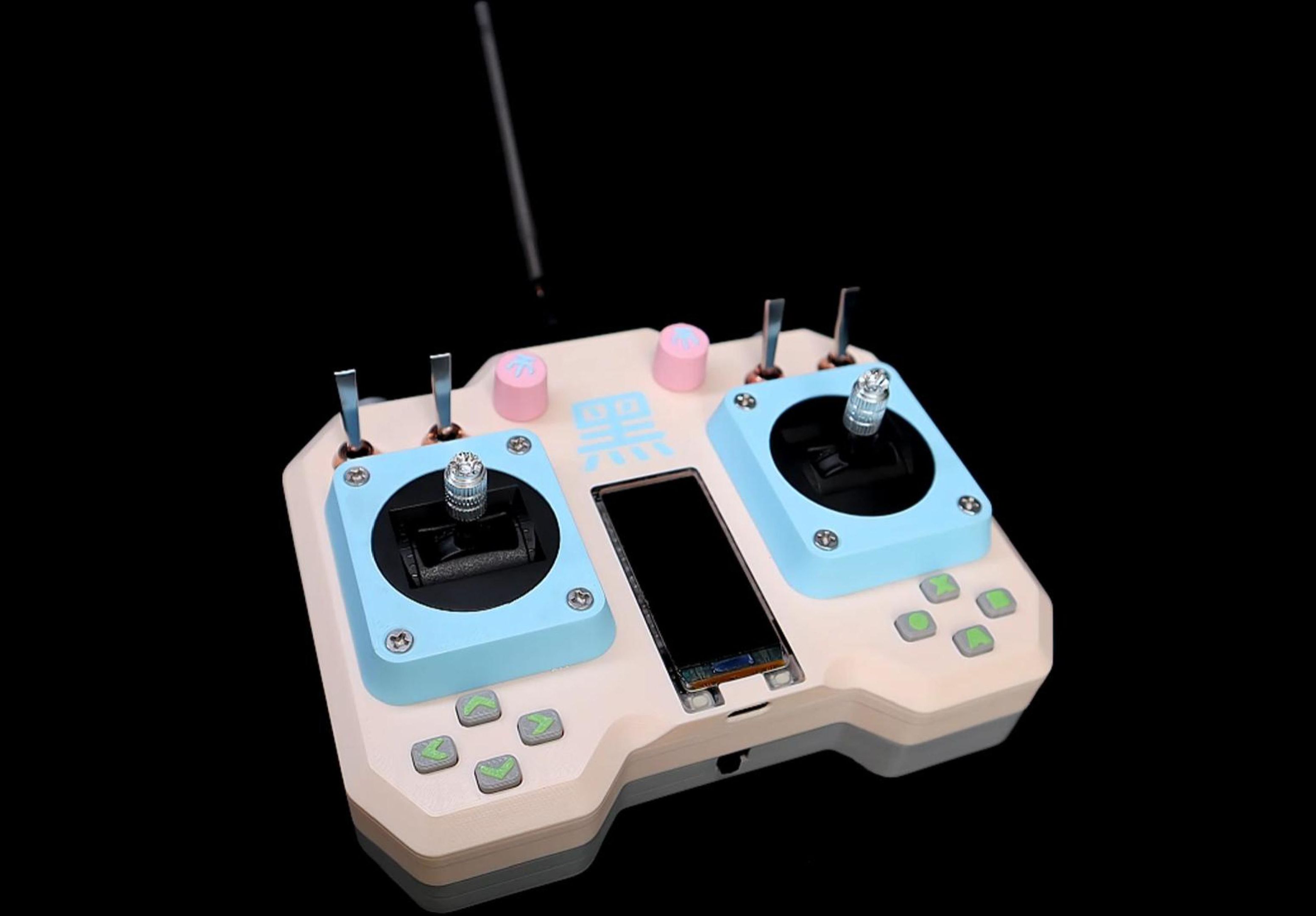

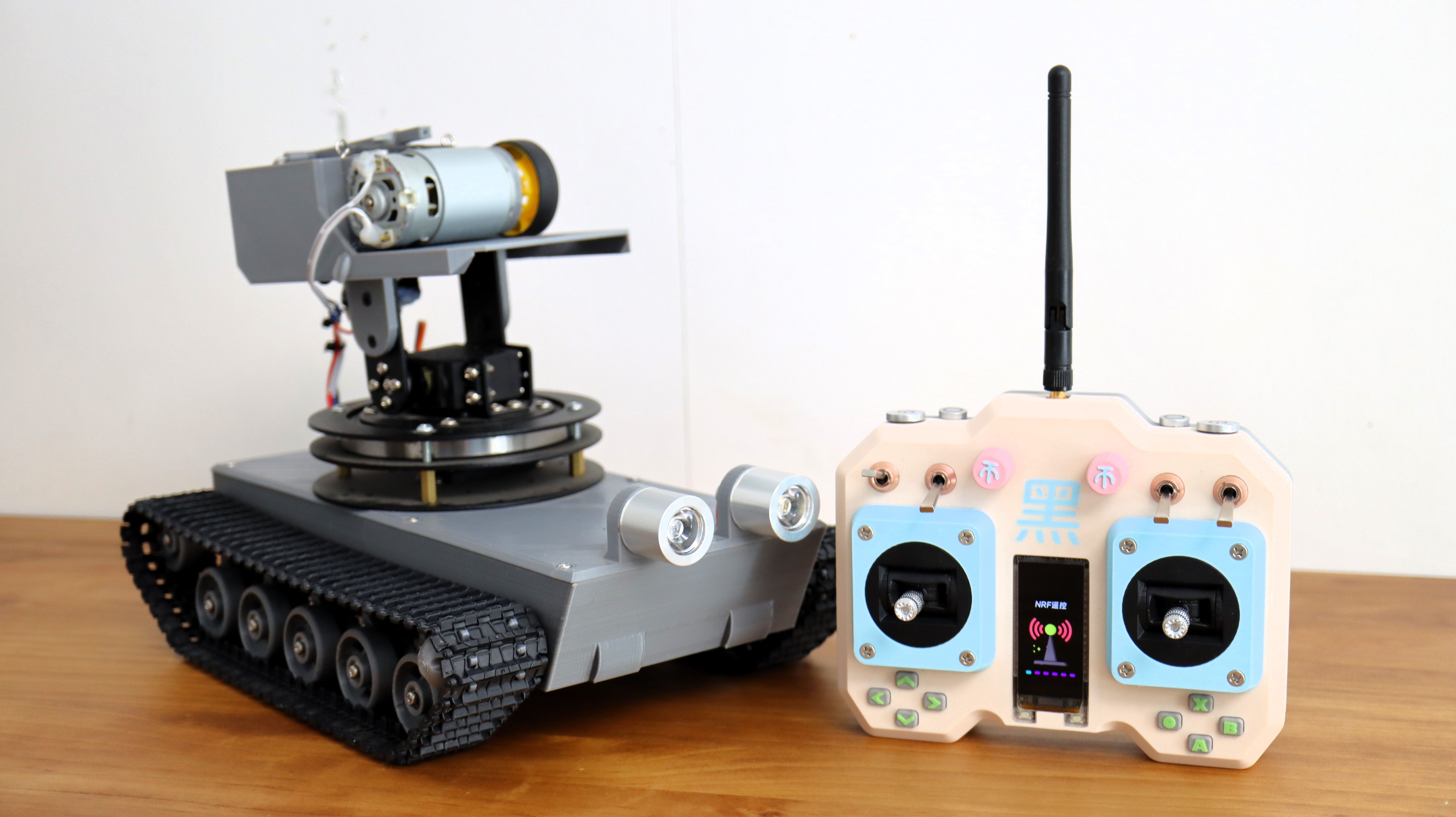

When playing with various RC models, robots, or other toys, each has its own remote control, which can be quite messy. Therefore, I wanted to create a universal, multi-functional remote control.
It can not only control numerous devices but also connect to a computer via Bluetooth to play AAA games as a Bluetooth gamepad. It can even be used to create and play small games.
Achieving the elegance of "one control in hand, the world at my fingertips!"
Project Features
: 1. This remote control is based on the ESP32-S3 chip. For ease of construction, a development board with a screen was used. The 1.91-inch screen boasts a high resolution of 240*536, providing excellent display quality.
2. The remote control features 4 standard buttons, 4 toggle switches, 2 potentiometer knobs, 2 high-precision RC joysticks, 8 function buttons, 2 onboard buttons, and 1 MPU-6050 electronic gyroscope.
3. The communication module uses a 20dBm nRF24L01 module, paired with a 3dBi gain antenna, achieving a remote control distance of over 2000 meters.
4. Two 2600mAh high-capacity 18650 lithium batteries ensure long battery life for the remote control, and the development board integrates a charging and discharging module, eliminating battery anxiety.

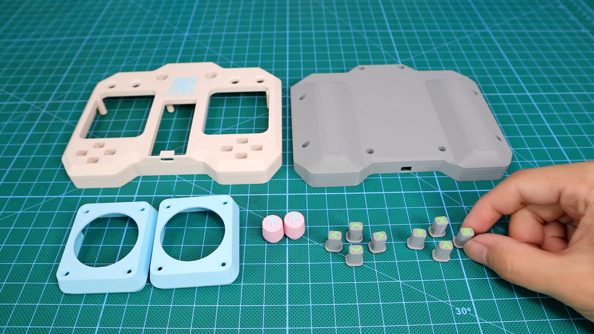

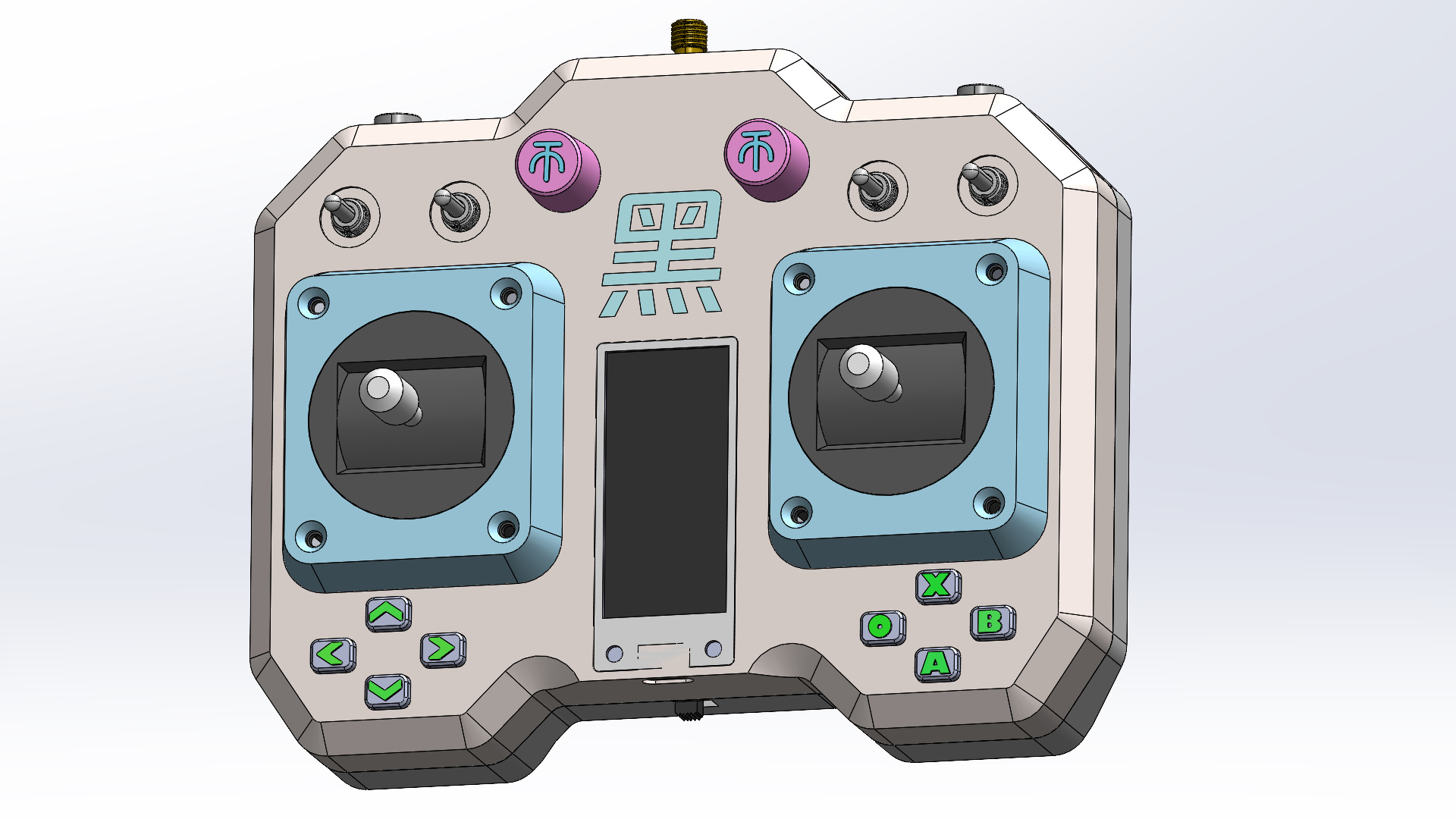

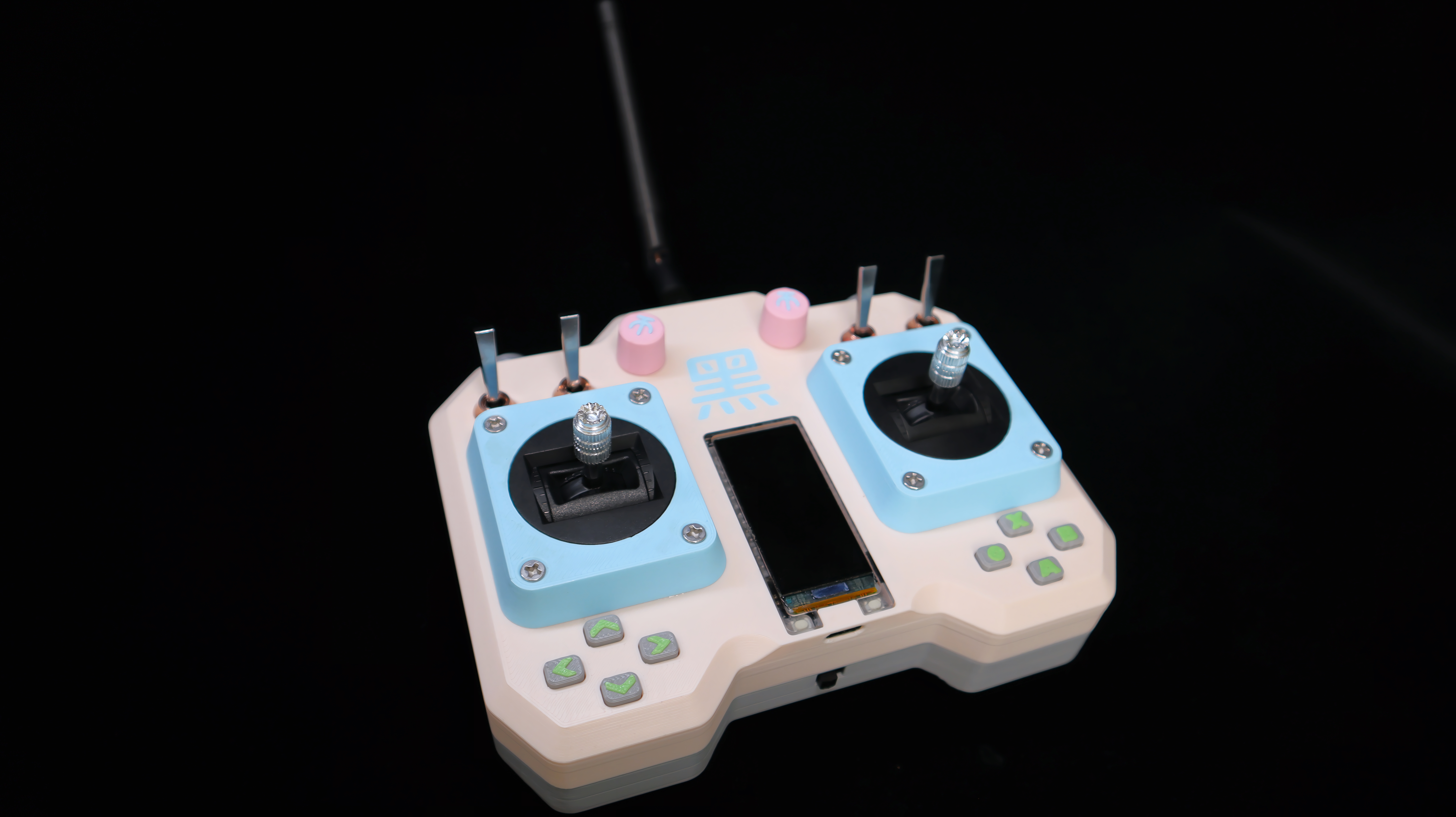

Shell Design:
The shell design has three requirements:
1. Comfortable grip:
    Numerous chamfers and rounded corners conform to the hand, preventing gripping and slippage.
2. Ease of manufacturing
    : Irregularly shaped parts are separated into components, maximizing flat surfaces for subsequent 3D printing. Separate components also facilitate multi-color printing.
3. Aesthetics:
    While meeting the first two points, strive for a visually appealing design, or add some unique features.

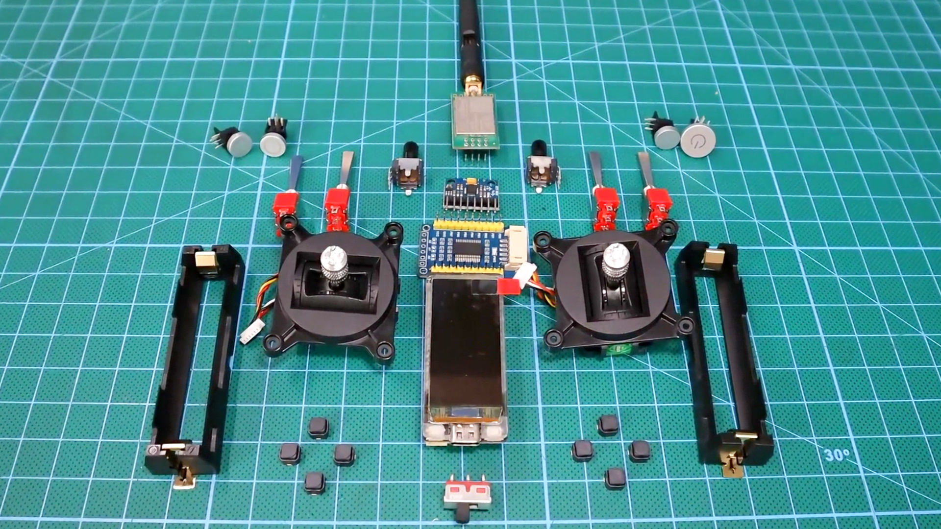

: 1. First, purchase all components from the assembly list (detailed list in the attachment).

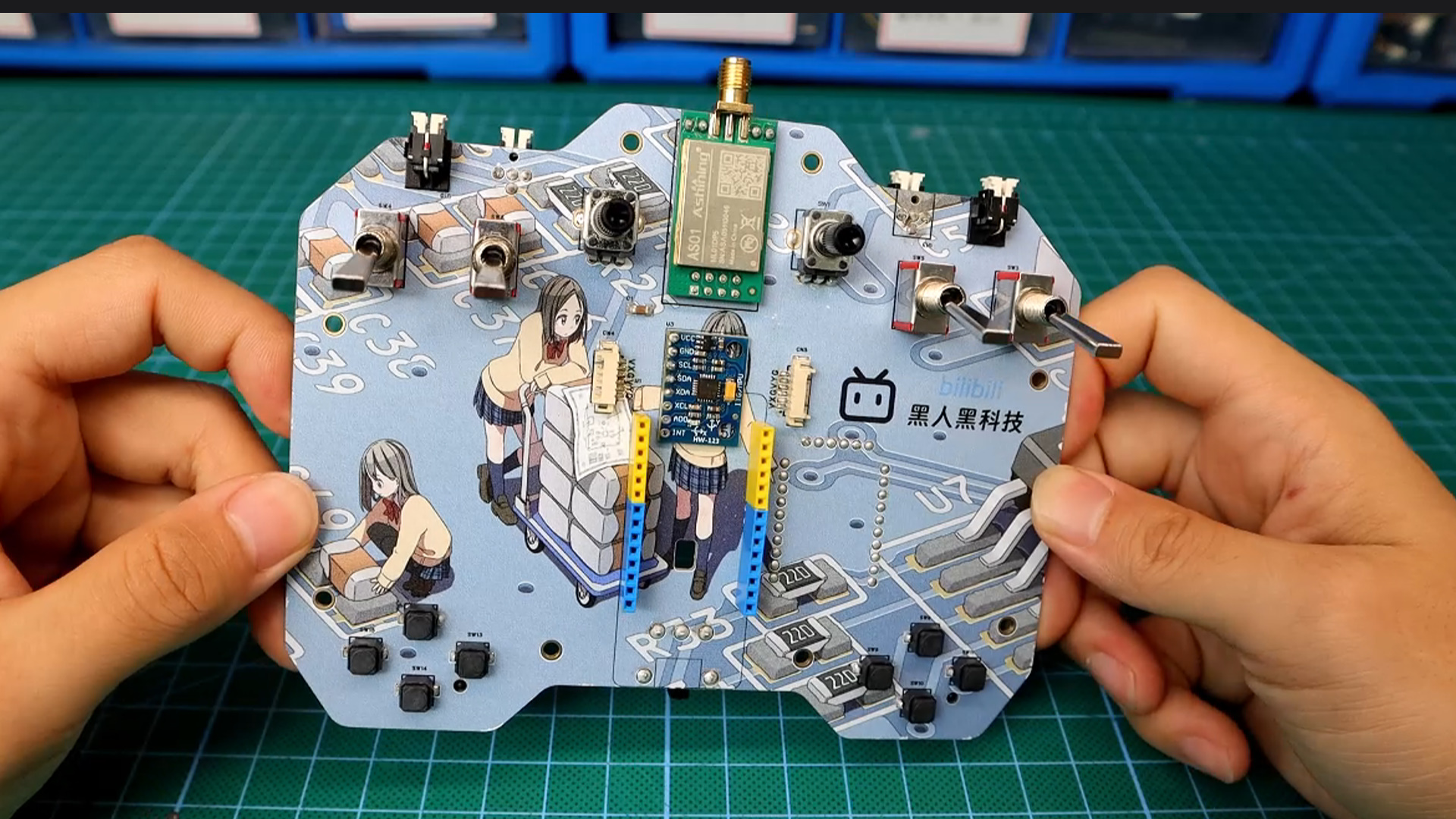

2. Solder the components onto the pre-made PCB (component list in the attachment)
    and install the development board and battery onto the board. Connect the development board and PCB power supply through the central hole using a wire.

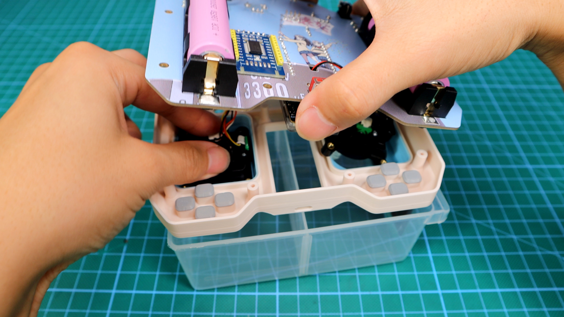

3. 3D print the outer shell and all buttons and knobs (printing files in the attachment; the outer shell includes a blank version).
4. Install the electronic components onto the outer shell (like putting an elephant in a refrigerator).
5. Finally, install the button caps and antenna; the remote control hardware is now complete.

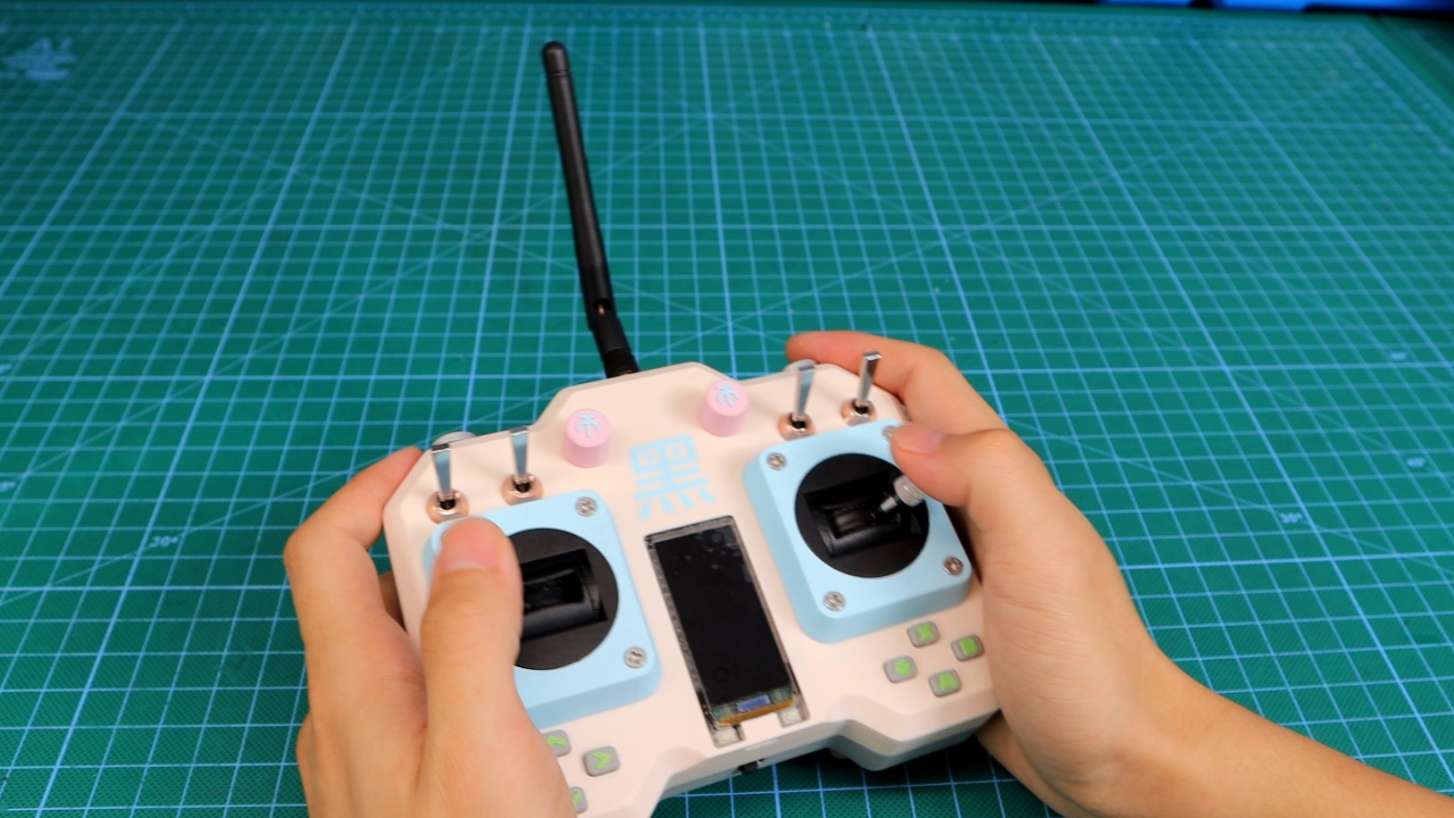

Actual Test Results:
You might wonder why the small screen is facing down in the test video below.
For details, please see the video: DIY Universal Remote Control_Bilibili_Bilibili

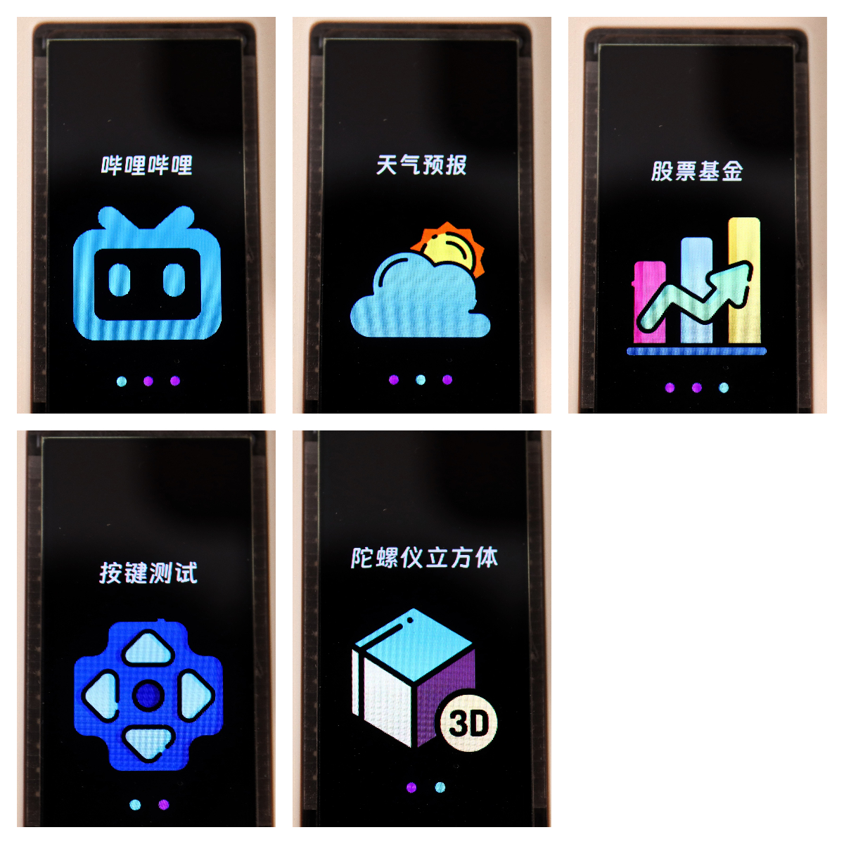

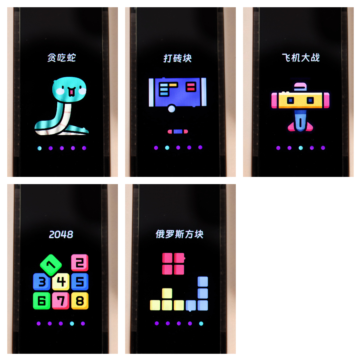

Updated September 27, 2023:

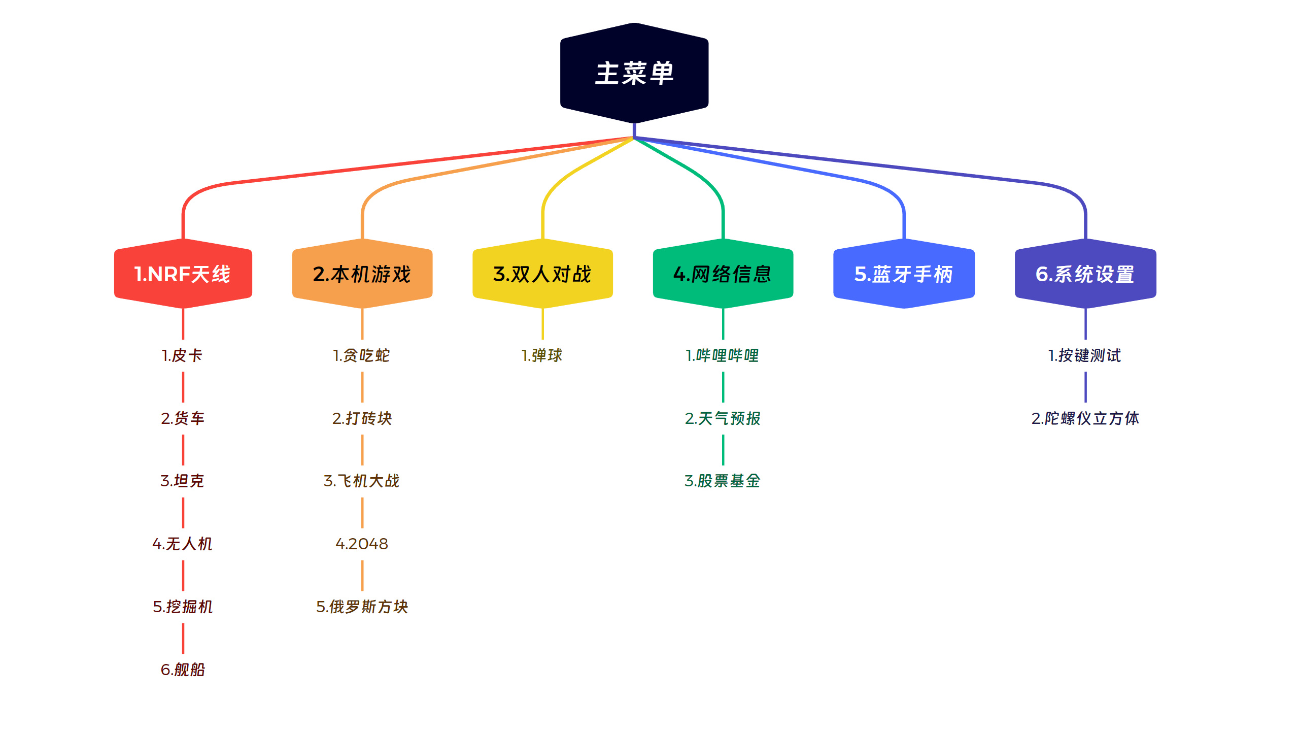

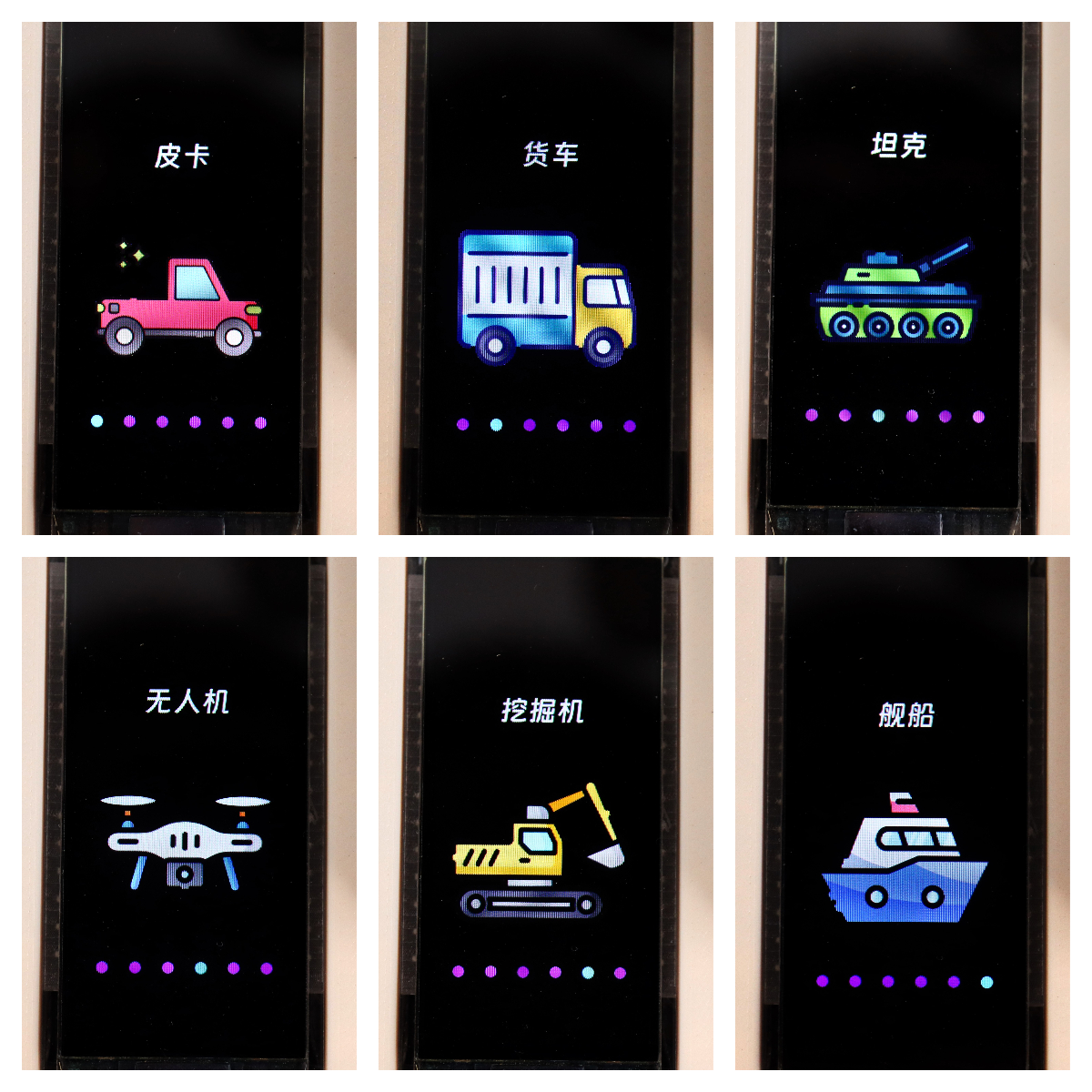

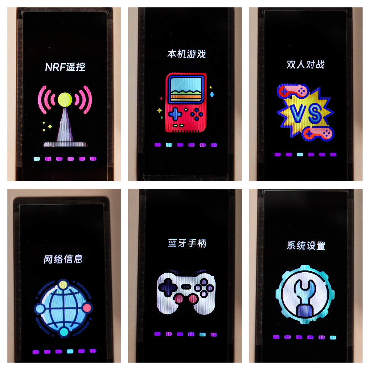

Menu System Structure -
First and Second Level Menu Preview -
First Level Menu:
Partial Second Level Menu:
Menu and Remote Control Effect Test.
I used a previous tracked chassis for testing, and the results were good.
See the Bilibili video for details.
