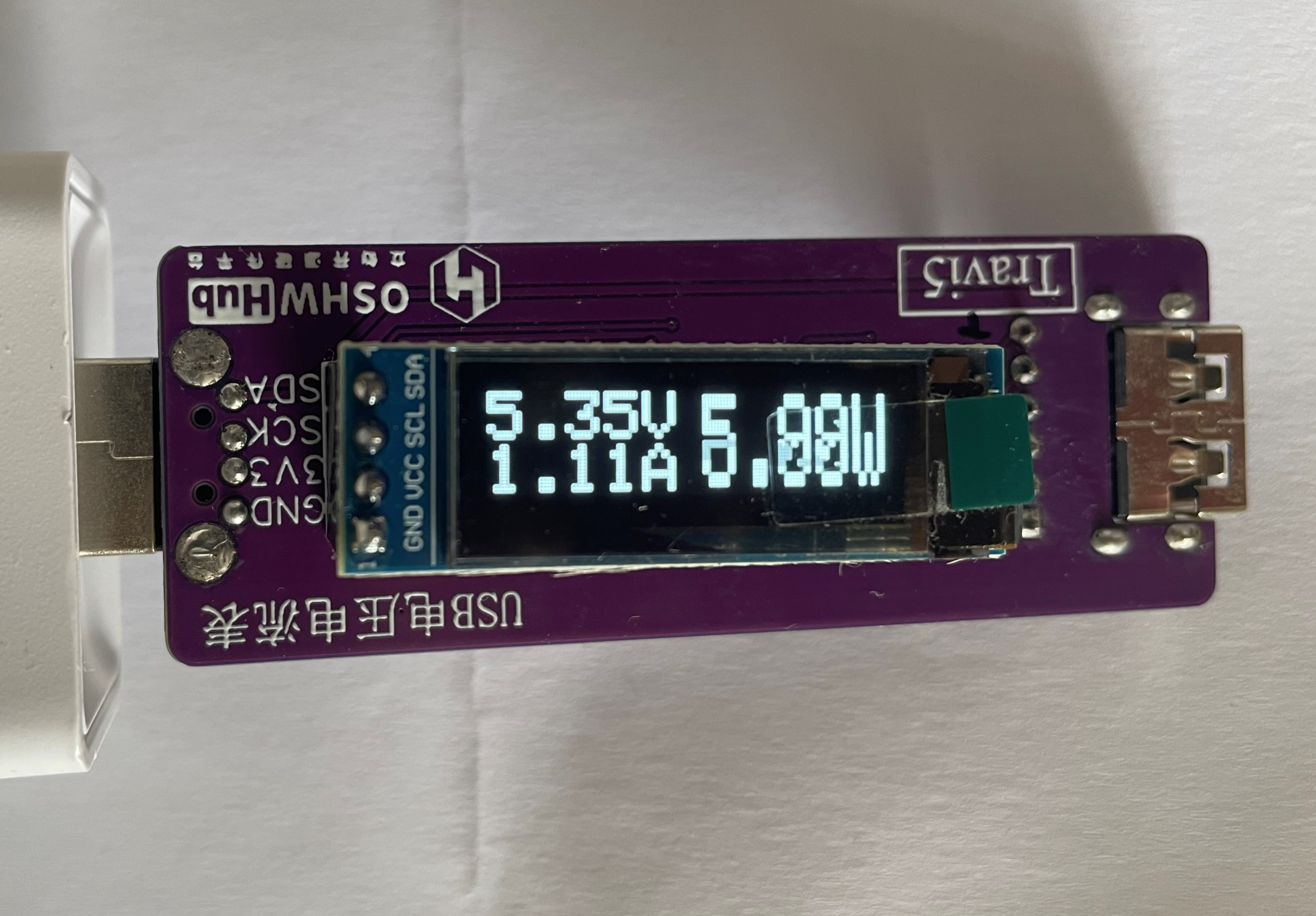

Based on N32G430C8L7+INA199 power supply voltage and current detection, power calculation, 0.91-inch oled display

Refer to the official case of the training camp (5V version) to design [Official case of the training camp] USB ammeter - Jiali Chuang EDA open source hardware platform (oshwhub.com) The
main control
N32G430C8L7 microcontroller product adopts a high-performance 32-bit ARM Cortex™-M4F core, integrated floating-point unit (FPU) and digital signal processing (DSP), and supports parallel computing instructions. It should be noted that each power pin of the chip needs to be connected to an additional 100nF external filter capacitor, and the 1st pin of the chip needs to be connected to an additional 4.7uf filter capacitor.
The
current sampling part is the INA199B1DCKR current sensing amplifier (also called current sensing amplifier), which is often used for overcurrent protection, precision current measurement for system optimization, or closed-loop feedback circuits.
