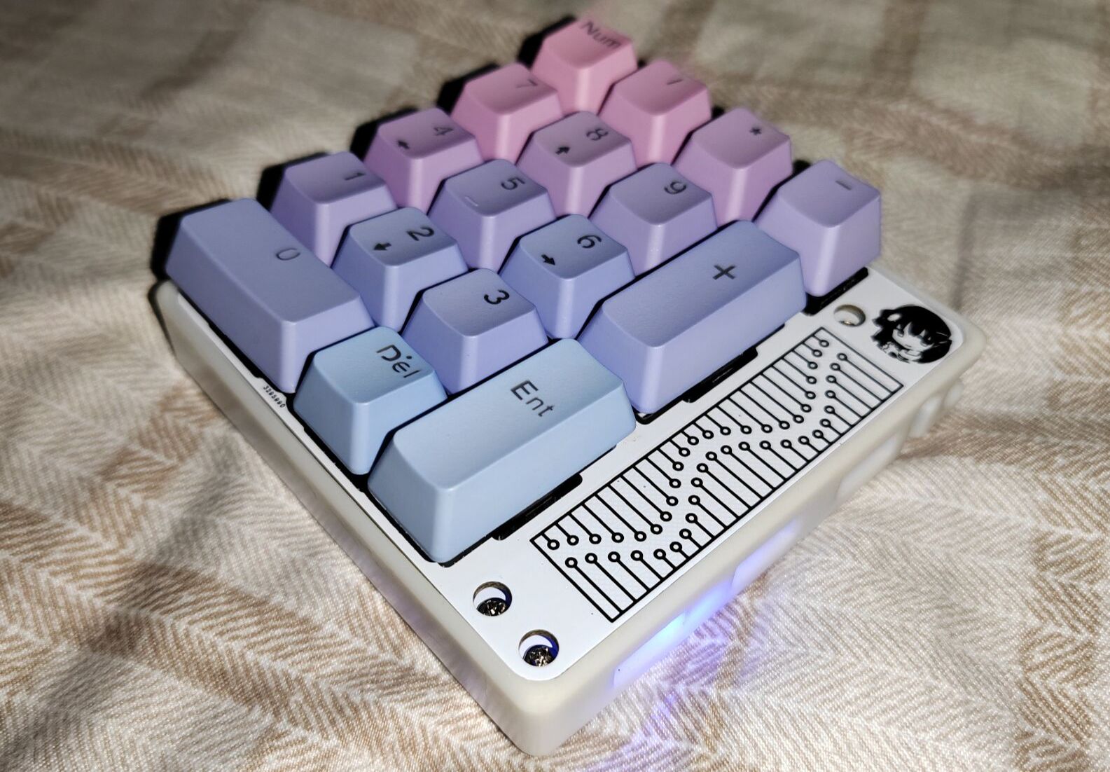

A dual-mode (or perhaps tri-mode) version of the most basic keyboard
, perfectly compatible with the basic 17+4's shell and mounting plate. It retains the valuable free shell and mounting plate,
and the frame and switch layout are taken from the most basic 17+4TPRO mechanical keyboard - JLCPCB EDA Open Source Hardware Platform (oshwhub.com).
The program is mainly modified from the CH579M Dual-Mode USB Bluetooth Keyboard with RGB - JLCPCB EDA Open Source Hardware Platform (oshwhub.com).

CH579M is a QFN package. It's relatively difficult to solder, so I suggest soldering it first.
During debugging, I encountered a situation where it wouldn't start. If this happens, you can solve
it by shorting the non-ground terminals of the two capacitors immediately next to the chip. The program is very messy, so I won't post it here to avoid misleading newbies.
However, you're still welcome to ask me for the program for secondary development. Upgrading to tri-mode and porting to touch is up to you! I'm just making
a promise; if you haven't started prototyping yet, you can wait a little longer. The tri-mode version of the basic 17+4 is on its way and should be available in ten days (or longer).
The space under the casing is limited; it seems it can only fit a thin battery of about 800mA, but the CH579M is low-power and can last a long time.
