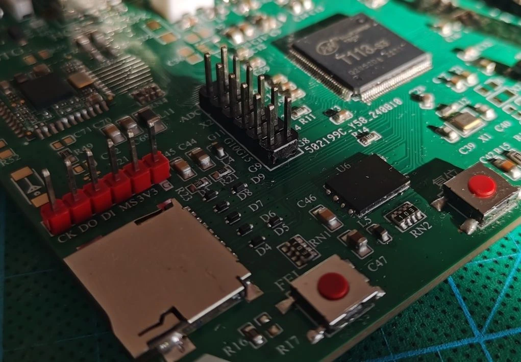

Allwinner T113 verification board
Video Link:
Bilibili Video -- Function Demonstration and Introduction.
Welcome to watch my videos, 7 videos in total.
Project Introduction:
This project is a verification board based on Allwinner T113-S3, featuring TF card, NAND FLASH, RGB screen, USB OTG, HOST, headphone and speaker, and wireless network card (RTL8723BS).
Version Status:
2024.9.2 V0.2, not yet board-made, see the project update for specific updates.
2024.7.28 V0.1, board-made and verified.
Pinouts:
ADC, resistive touchscreen X1, X2, Y1, Y2;
E0, E1, E4-E13;
AVCC (1.8V), 3.3V, GND;
JTAG CLK, DO, DI, MS interfaces (no JTAG available, not tested);
Hardware Specifications:
PCB size 80x50 mm, easy to solder.
This project uses three MT3520 chips as the main power supply, providing 0.9V (core), 1.5V (memory), and 3.3V (peripherals) respectively.
The first LDO (1.8V) integrated into the T113-S3 power supply powers the RTC, PLL, LVDS, and DRAM 1.8V; a second LDO is not used.
The screen backlight is an MT9284-28J with PWM dimming.
Serial ports 0 (E2, E3) are brought out as debugging serial ports, using header pin connections, which can be easily switched to other serial ports for different firmware. The serial port chip is CH340N.
The external speaker uses an NS4158 chip, and the anti-distortion function can be enabled as needed.
Because there are many 0805 components available, the PCB is mainly based on 0805 components, with a small number of 0603 components.
TVS diodes are added to the USB and TF card interfaces (I'm not sure if this is correct; please correct me if I'm wrong).
Some circuits have been annotated with my own understanding; please correct me if I'm wrong.
Version 0.2's headphones and microphone use the Chinese standard 3.5mm plug, meaning from the outside in: left channel, right channel, microphone, and ground.
