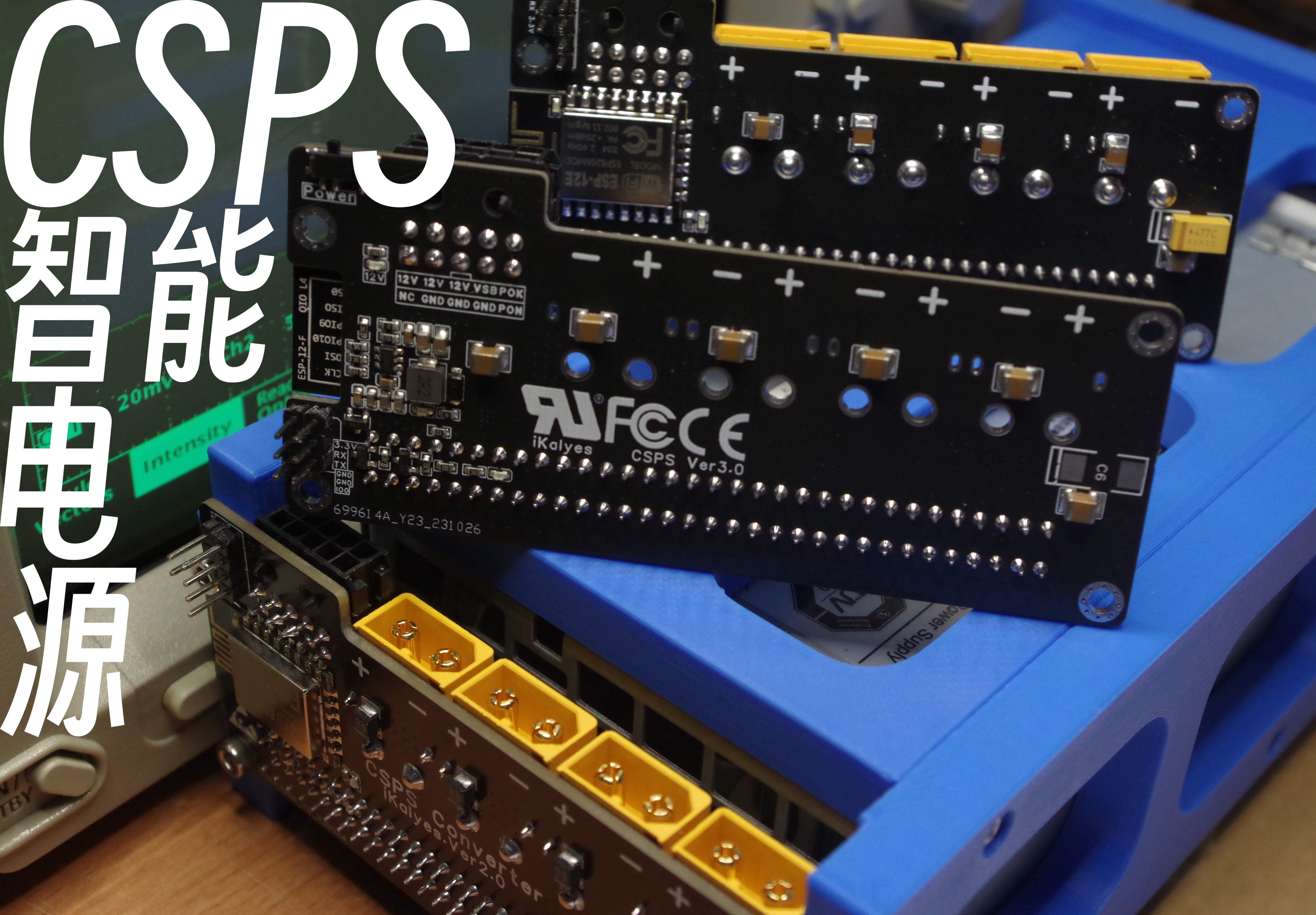

I. Project Overview
The project includes:
Power interface board (ATX3.0)
Core board (ATX3.0)
II. Detailed Introduction
1. Power Interface Board (ATX3.0)
        It adopts a Noguchi 64P input, 4 XT60PW-F and MX3.0-10P (ATX3.0 standard) outputs.
        The DC-DC main controller uses TPS563201DDCR, SMF3.3A (or ZMM3V3) for overvoltage protection
        , 2N7002 for I2C level conversion, and
        ESP8266 (ESP-12F or... ) After the ESP-12E is linked with Home Assistant, it can be remotely started and its voltage, current, power, efficiency, and
        other data can be read in real time. More power data can be read through custom register addresses.
        Compatible power supplies: EPW750-12A, PS-2751-7H; other power supplies have not yet been tested.
        Due to size and cost limitations, the recommended total power of this power board is no more than 600W.
       A copper busbar soldering position (6mm (width) * 50mm (length)) has been reserved.
       A forced output shutdown function has been added, which requires Home Assistant. Firmware must be flashed to force IO2 to go high; otherwise, the physical switch will not work. See Figure
 2 for details. Core Board (ATX3.0):
        The main circuits of the core board have been windowed.
        One PW22ASAB is used for both 5V and 3.3V outputs, and one ZXDN10 is used for 5VSB.
        The main control chip is either WT7510 or TPS3510.
