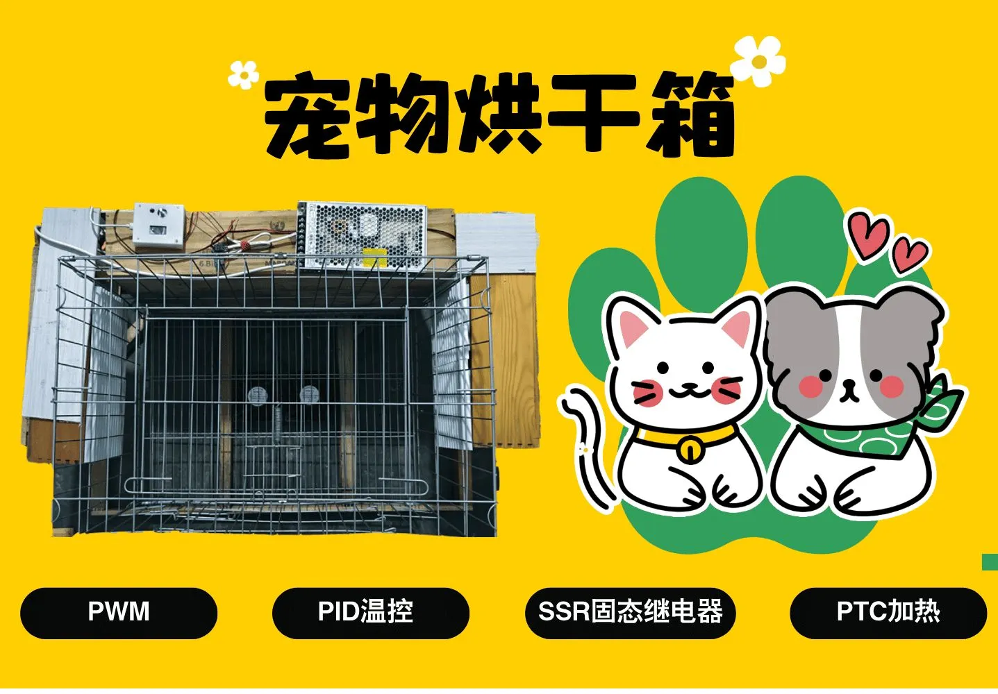

Pet drying box
Video Link:
Bilibili Video -- Function Demonstration and
Project Introduction

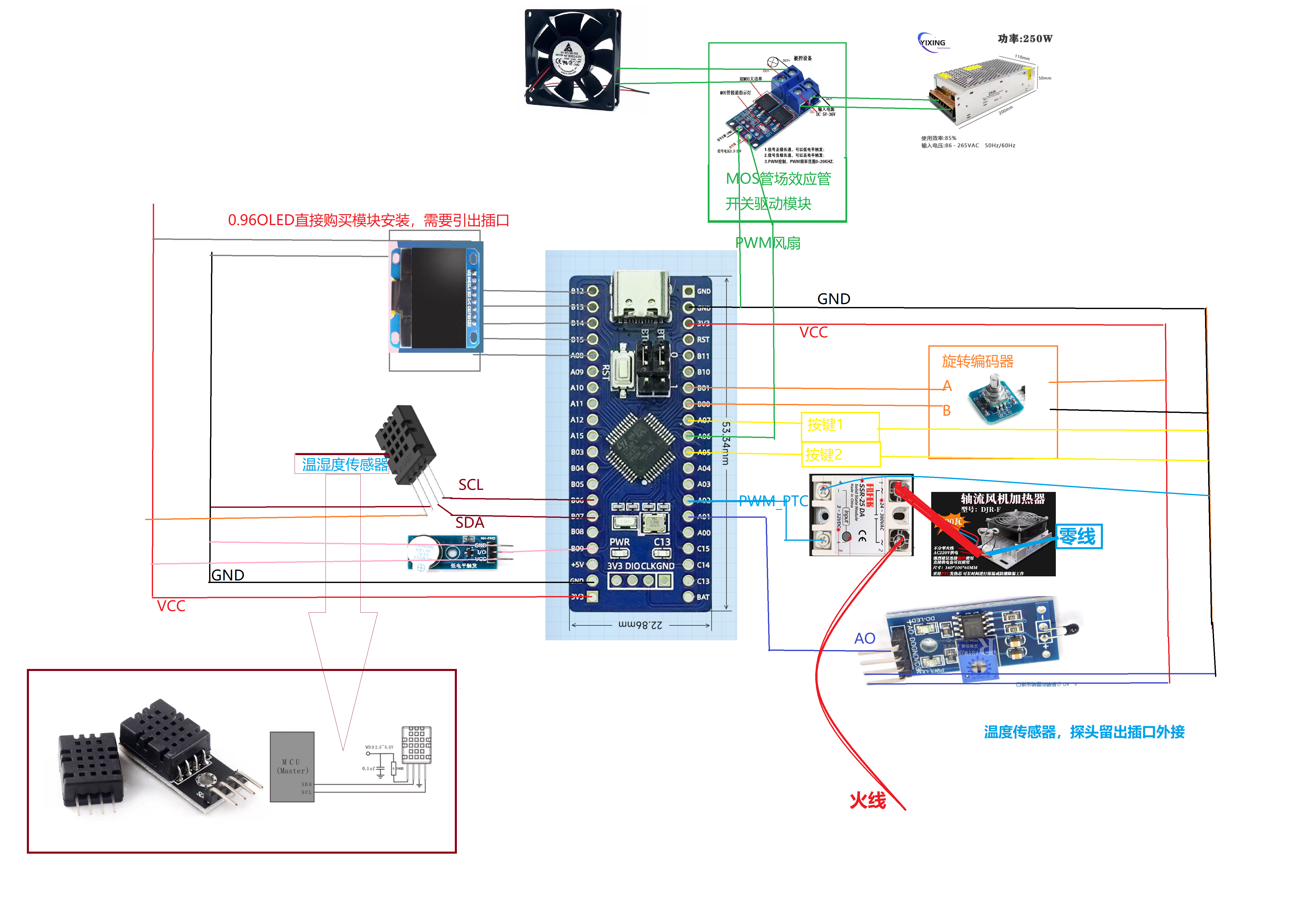

This project is a pet drying box based on the STM32F103C8T6 microcontroller, featuring timer and automatic drying functions.
The project
uses the STM32F103C8T6 microcontroller as the main controller, outputting PWM to control the on/off state of the SSR solid-state relay. The heating power of the PTC heating plate is controlled by changing the PWM duty cycle. A DHT20 temperature and humidity sensor monitors the temperature and humidity inside the drying box. An NTC thermistor can also be added for supplementary temperature measurement. An air duct is designed inside the pet drying box; it only needs to maintain the blown hot air at the set temperature, not the internal temperature. Multiple axial fans blow hot air to dry the pet. PID temperature control is implemented to ensure temperature stability. The PID strategy here is to ensure temperature stability and prevent overshoot, which can sacrifice some heating time; the temperature can only be low, not high. The on/off time of the SSR solid-state relay
in this project
is 10ms, therefore the PWM period for controlling the SSR solid-state relay is set to 20ms. The advantages of SSR solid-state relays include long lifespan, high reliability, high sensitivity, low control power, good electromagnetic compatibility, and fast switching. However, their disadvantages include large voltage drop after conduction, leakage current after semiconductor device turn-off, sensitivity to overload, influence of ambient temperature on load capacity, and higher cost. Note that the load terminal of the SSR solid-state relay must not be short-circuited; a short circuit will burn it out. Major online shopping platforms offer discounts for new users on SSR solid-state relays, making them available for as low as 1 to 3 yuan.
    Controlling an axial fan involves using a microcontroller to output PWM to control the on/off state of a high-power MOSFET, thereby controlling the fan speed. The PWM control for the fan uses a MOSFET switching driver module with a maximum frequency of 20kHz. High-power MOSFET-triggered switching driver modules offer advantages such as fast switching, high efficiency, and simple control; however, they also have disadvantages such as high cost, complex driving, and sensitivity to external interference.
    Both PWM control methods used above are heat-sensitive, but in this system, the operating power is low and the ambient temperature is not high. As long as it is not used directly on a PTC heating element, it is more than sufficient for this system.
    The 0.96 OLED screen uses a 7-pin SPI interface; an 8-pin version is also available. Converting to a 4-pin interface is very simple; just replace the driver file.
    The STM32F103C8T6 minimum system board in this system comes from the JLCPCB DiKuoXing open-source project. It is strongly recommended that those who are replicating this system purchase this ready-made minimum system board. Simply plug it into the corresponding pins. Hand-soldering double-sided boards with 0402 components is troublesome and prone to problems. The STM32F103C8T6 chip on the LCPCB website costs around 8 yuan, while the DiKuoXing ready-made board costs only 10.91 yuan. Alternatively, a domestic 32-bit development board, such as the DiWenXing CW32, can be used, which has excellent performance and stable operation.
Principle Analysis (Hardware Description)

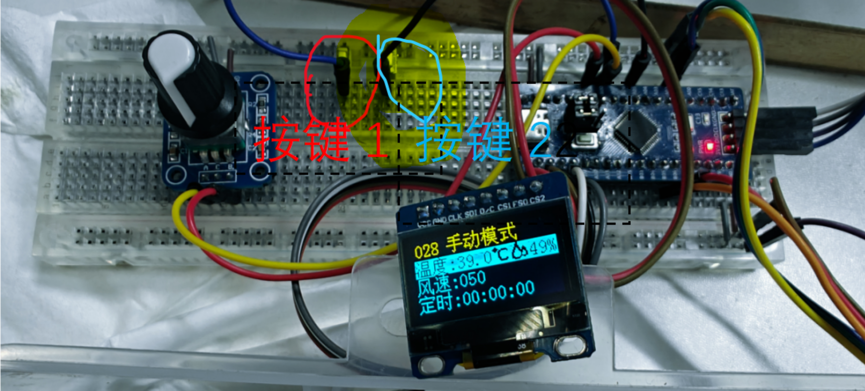

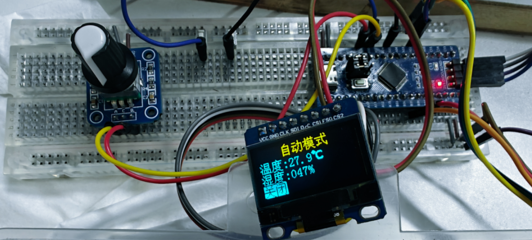

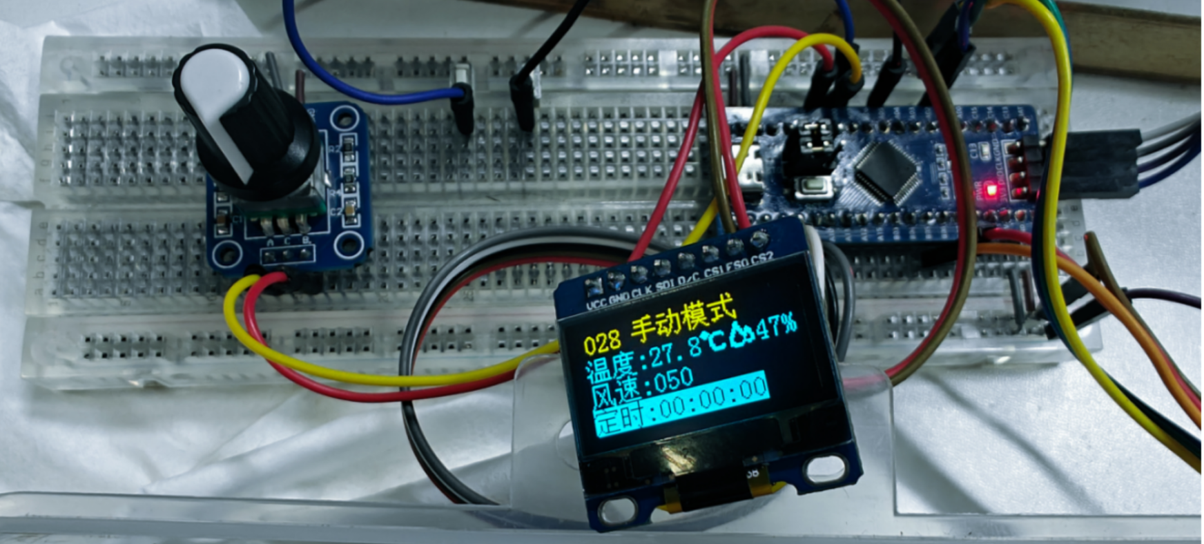

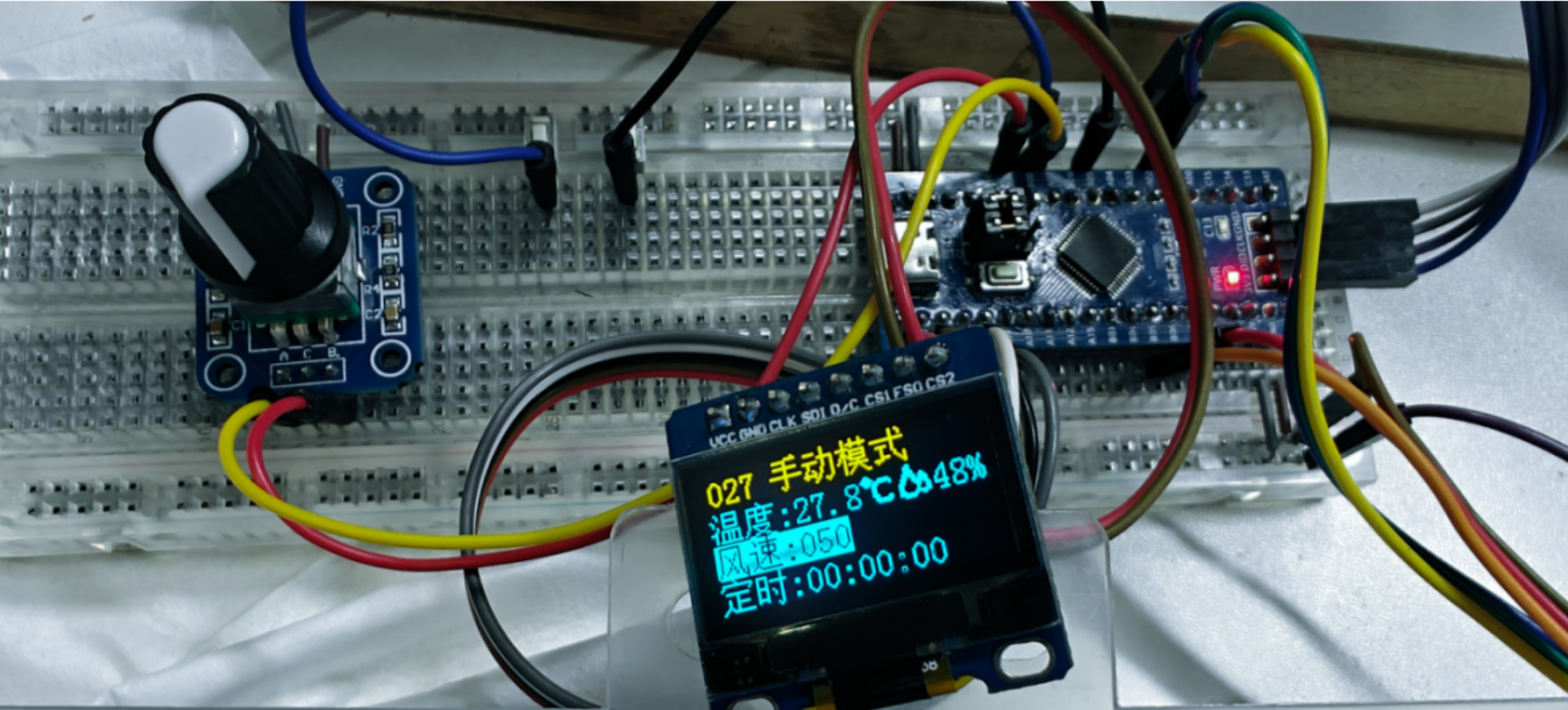

Experimental Circuit Operation Logic
: The following is a breadboard demonstration of the operation logic:
The upper left corner displays the temperature measured by a thermistor; currently, the code only shows this data, not used for temperature control.
Power-on starts temperature adjustment, default 39°C. The rotary encoder adjusts the temperature in 1-degree increments, up to a maximum of 60°C. Humidity data is displayed on the right. When exiting the temperature setting, the temperature and humidity sensor readings are displayed. Heating begins when the timer is not 0. Pressing button 1 for the first time switches to fan speed adjustment; the default is 0, and the fan will rotate as long as it is not 0. Pressing button 2 switches to time adjustment; heating begins when the time is not 0. Pressing button 2 switches to seconds, minutes, and hours, adjusted by the rotary encoder. Pressing button 1 a third time switches to automatic mode, sets the temperature to 39 degrees Celsius, and uses the rotary encoder to adjust the on/off state. The idea is to automatically stop based on humidity data, but the humidity data fluctuates significantly, requiring further testing to confirm its feasibility (code not yet written). Currently, the temperature is set to 39 degrees Celsius, the fan is at 90% capacity, and it runs continuously. Pressing button a fourth time returns to the first state.

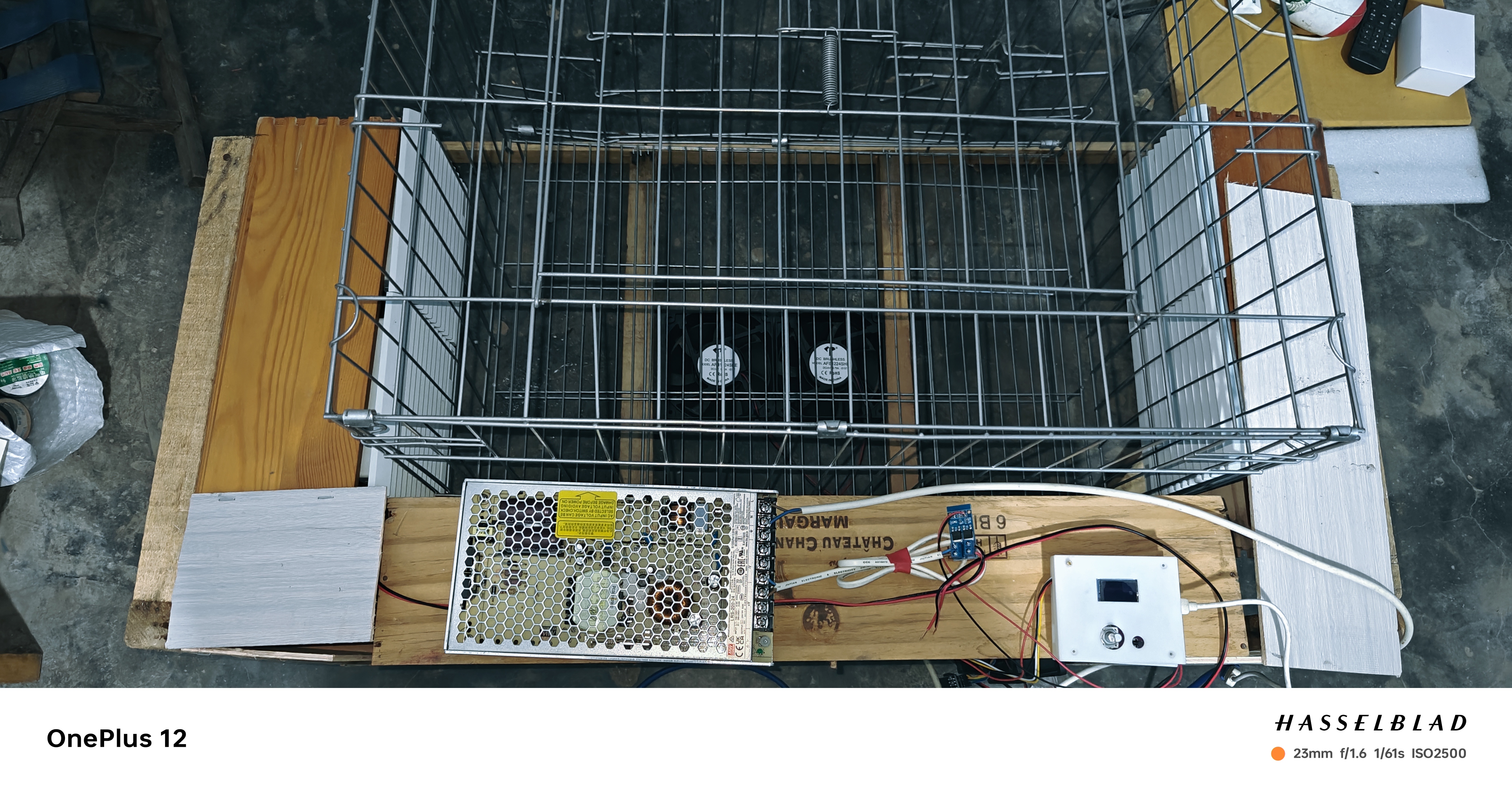

For the assembly process
, feel free to use your imagination to design the air ducts, etc. This project uses old wooden strips as the frame and thin wooden boards for the air ducts, resulting in lower costs. Aluminum profiles can also be used for the frame. It can be used as a pet cage for everyday use or designed as simple furniture.
As mentioned in the video, the entire unit can be made into a large cage; the fan has a thick filter that won't harm the pet, eliminating the need for a separate inner cage.
A picture of the actual product
shows a box of newborn puppies.
