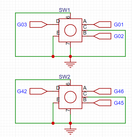

In the first version, I put four buttons, but I felt they weren't very user-friendly, so in the second version, I added two rotary encoders. I plan to write a low-sampling-rate oscilloscope mode in the software; the knobs on the oscilloscope are indeed more convenient.

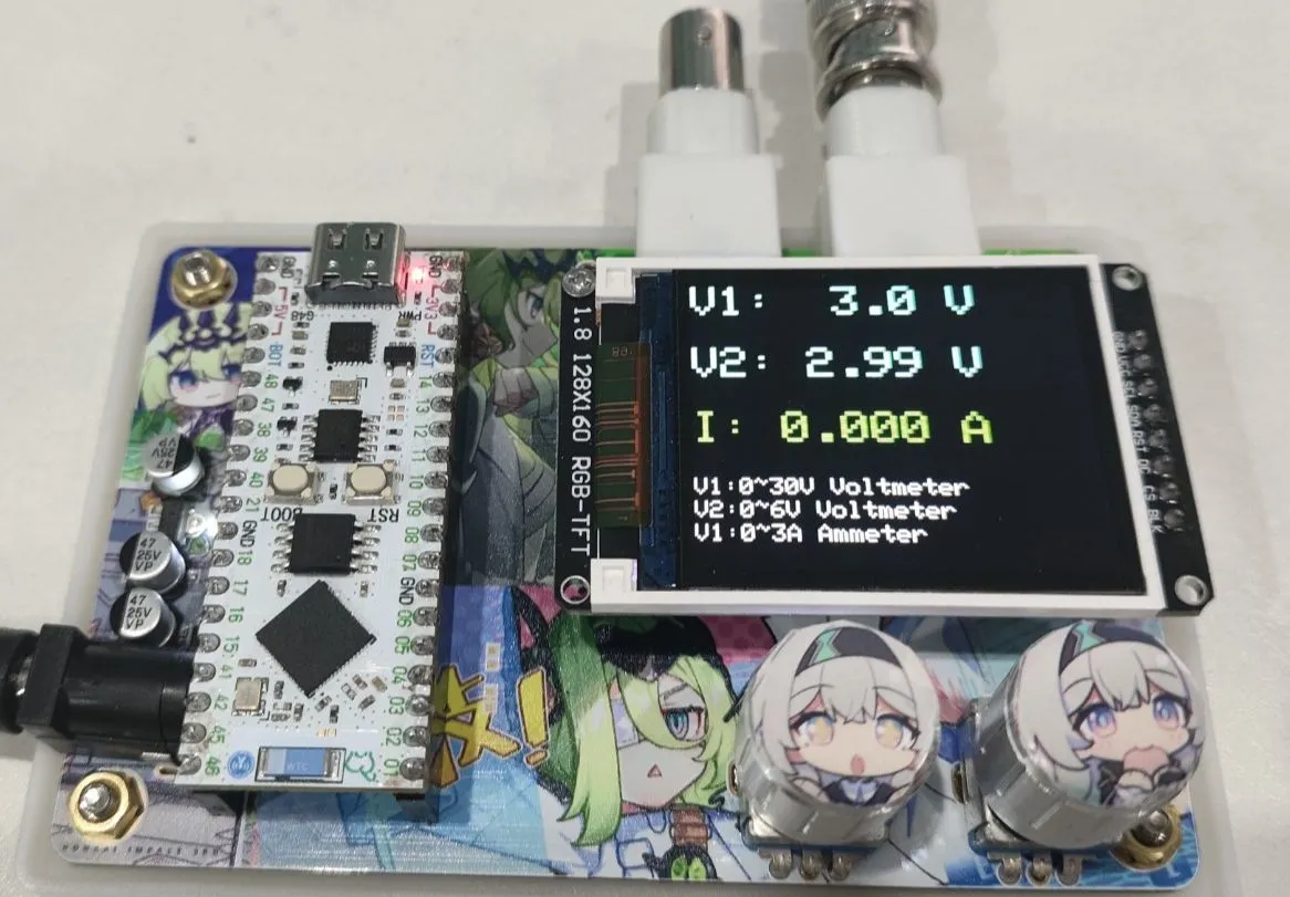

To coordinate well with the subsequent silkscreen printing, the rotary encoders are placed in the following two positions:
Graphical User Interface, Application<br>Description has been automatically generatedApplication<br />Low credibility description has been automatically generatedAt the same time, some space is reserved to prepare for adding other functions later.
Computer screen display<br />Medium credibility description has been automatically generatedAlso, in the second version, I placed the power supply section on the left side, with separate copper plating, to provide some isolation.

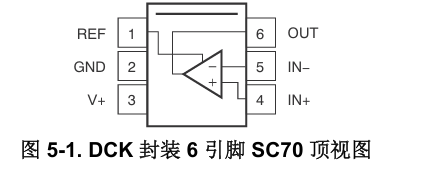

. The silkscreen of the chip itself is shown in
Figure 3-2: Chip silkscreen .
Through these, we can roughly infer that the orientation of the dotted silkscreen is the same as the horizontal line on the chip, but it is not accurate. Therefore, we need to find the corresponding pin definition in the chip datasheet and compare it with the pin on the PCB.
Figure 3-2: Chip datasheet pin definition
. Here, through the comparison of the pins, we can find that the horizontal line is indeed in the same direction as the dot.
At the same time, when soldering this chip, due to its small pin spacing, it is easy to bridging. Remember to test whether there is bridging between the following two pins after soldering (only use a multimeter in continuity mode to connect between the two pins). Also, since pin 1 (REF) and pin 2 (GND) are both connected to ground, they are connected to each other.

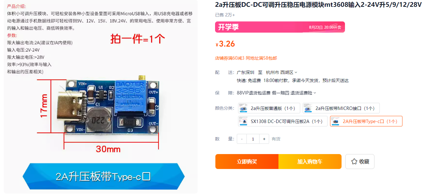

This voltage test uses a boost module powered via Type-C. We can easily draw 5V from the input terminals for the current sampling circuit and 5~30V from the output terminals for the voltage sampling circuit.
Figure 3-3 Boost Module

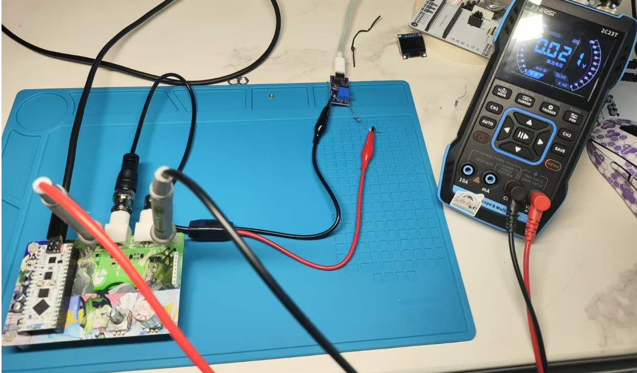

3. Current sampling circuit: After soldering, first test the pin bridging of the current sensing amplifier chip. After passing the test, test the continuity between GND and the 3V3 and 5V networks to prevent short circuits from damaging the core board. This is because the chip requires the 3V3 power supply from the core board for this test.
Then measure the output power supply of the boost module (or directly use its input power supply) and record its value (e.g., 9.241V during the test). Then calculate the appropriate resistance value based on the power and current (100 ohms were used in the test; if the supply voltage is lower, the resistance can be lower, the current can be larger, and the test current range can be larger).
Through calculation, we can obtain that the output voltage should be equal to: Input voltage / Circuit impedance * Sampling resistor impedance * Sensing amplification factor = 9.241 / 100 * 0.005 * 50 = 0.231V.
The following are the actual measurement results:
Figure 3-4 Current sampling module test results.
It can be seen that the result differs from the calculated result by about 0.02V, which translates to a measured current of 80mA. This is not the maximum measurement error, but it can provide some reference.

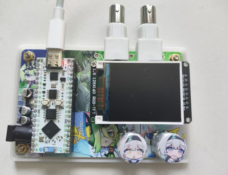

1. TFT Screen Test

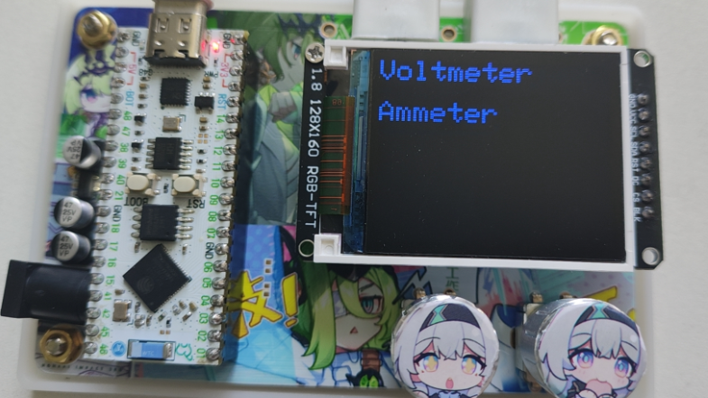

Insert the development board into the corresponding socket as shown in the figure, and insert the TFT screen into the corresponding socket as shown in the figure. Connect it to the computer via the Type-C interface.
Figure 3-5 Connection Diagram
Compile and burn the "TFT_TEST.ino" file, and observe whether the TFT screen displays normally (as shown in the figure below).
Figure 3-6 Test Results Figure

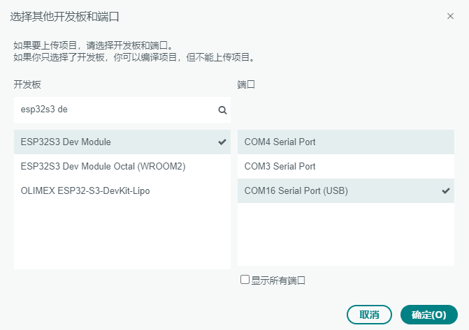

Here I choose to use Arduino to develop for ESP32.
Most ESP32 development methods are IDF, Arduino, and MicroPython. IDF and Arduino compilation speeds are relatively slow, and debugging will consume a certain amount of time. Although MicroPython can be executed after the hardware is uploaded, the code execution time is longer, and compiling firmware is also more troublesome. Using Arduino for development allows for easy calling of pre-written libraries. Although the compilation time is slower, the overall time consumption is the shortest, and it also allows for more flexible operation using low-level code instructions.
After connecting the hardware, select the corresponding port device:
Figure 4-1 Port Selection

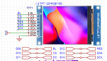

4.1 Hardware Pin Connection
Figure 4-2 TFT Screen Connection Pins
Figure 4-3 Rotary Encoder Connection Pins
Illustration, diagram<br />Description automatically generatedFigure 4-4 Sampling Circuit Connection Pins
After arranging the pins, the hardware pins of the TFT screen are: G09-BL, G10-CS, G11-DC, G12-RES, G13-SDA, G14-SCL. The hardware pins of the rotary encoder are: G01-A1, G02-B1, G03-D1, G42-D2, G45-B2, G46-A2. The sampling section pins are: G06-ADC_V_3 (0~3V voltage sampling), G05-ADC_V_30 (0~30V voltage sampling), G07-ADC_I (current sampling).

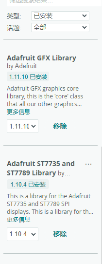

Here I'm using the Adafruit ST7735 library. In Arduino, you need to select "Library Manager," search for "Adafruit GFX Library," and install it. Then, similarly, search for "Adafruit ST7735 and ST7789 Library" in the Library Manager and install them. Below is the display after installation.
Figure 4-5: Adafruit ST7735 Library Installation Completed .
Using this library requires referencing "Adafruit_GFX.h" and "Adafruit_ST7735.h" beforehand. The code is as follows:

4.3 Encoder Control
, I used pins 1 and 2 for the encoder module, not noticing that these two pins are mainly used for UART0. Here, I intend to prevent the encoder from occupying UART0. Also, since only one rotary encoder is needed for interaction besides the oscilloscope, I only used the rotary encoder pins 45 and 46 in my program. The two buttons on the rotary encoder module are enabled, used as needed.
I used the Encoder library, which can easily process rotary encoder signals and calculate the direction and position of rotation. In the Arduino IDE, select the Library Manager (Sketch -> Include Library -> Manage Libraries). Search for "Encoder" and install Encoder by Paul Stoffregen.
In this library, we need to use its own `read` function to read the changed level each time the level changes, in order to determine the current state. Therefore, we use hardware interrupts to read the state.
The following are the configuration functions for the hardware interrupts on pins 45 and 46:
`attachInterrupt(digitalPinToInterrupt(46),handleEncoder2,CHANGE);//Encoder 2A phase` `
attachInterrupt(digitalPinToInterrupt(45),handleEncoder2,CHANGE);//Encoder 2B phase`

`void IRAM_ATTR handleEncoder2() {
    // Interrupt service routine code
    myEnc2.read();
Here, `IRAM_ATTR` is a compiler instruction specific to ESP32 (and ESP8266) used to place functions or variables in the ESP32's internal RAM (IRAM). Its main function is to optimize the execution speed and response time of interrupt handling functions.
Note that the size of this RAM is limited; try to only put hardware interrupts in it, and also pay attention to the code size.

However, when using the timer, the timer configuration function reported an error. After investigation, it was found to be an SDK version issue. Simply follow the tutorial to set the SDK version to the same version.
The previous version was 3.0.3; after uninstalling and changing the version number on the left to 2.0.14, the function compiled correctly. It's speculated that the library functions in the SDK were modified. Since Arduino development is chosen for its simplicity and speed, it's better to directly change the SDK version than to investigate the underlying issues.
Figure 4-7 shows the ESP32 SDK version .

Due to time constraints, and because this is my first time writing ESP32 Arduino code, oscilloscope mode and spectrum analyzer mode were difficult to complete within the time limit. Therefore, I first wrote a simple display interface.
Later, I will update the oscilloscope and spectrum analyzer modes, adjusting them through the encoder, and also change the encoder pins to make the right encoder usable. (The underlying implementation is already possible; the main challenge is writing the interface. If you are interested in this project, please help me write it!)
The program is stored in "VoltmeterAndAmmeter.ino". See the demonstration video for a tutorial.
The top layer of the 3D shell is relatively thin; it is recommended to thicken it, otherwise the printing effect will be poor. The layer thickness has little impact after adding the panel. (Just like phone case back covers, some are poorly made and some are well-made, but once you put a phone case on, they all look the same.)
The panel is under improvement; you can add other panels in the file to avoid waste.
