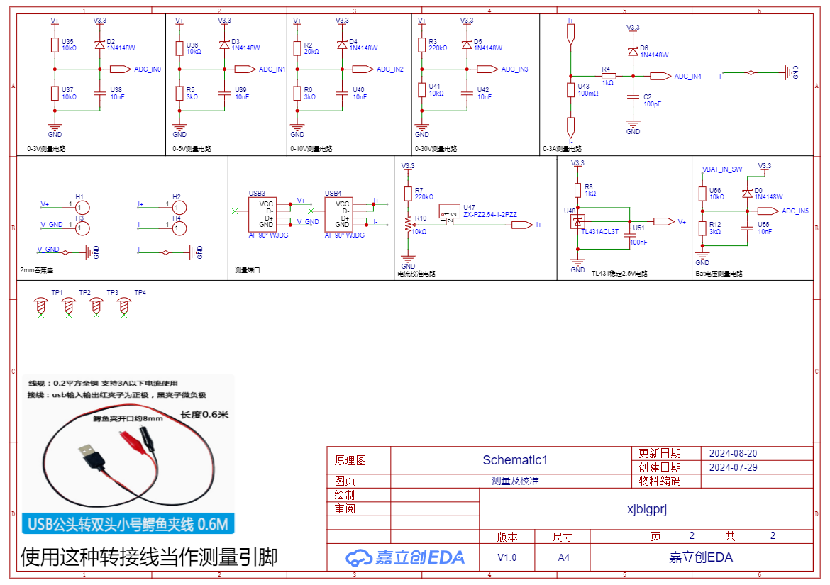

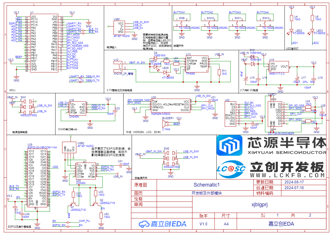

. Due to the large number of components required, it is divided into 2 boards. Board 1 contains the development board and external modules, as shown in Figure 2, including an MCU, power input, push-button switches, LED indicators, a 3.7V lithium battery charging circuit, a 3.7V to 3.3V converter, a power selection circuit, a CH340N to USB converter, peripheral circuits, an ESP32 and its peripheral circuits, and a main power switch circuit. The 2P circuit is for measurement and calibration, as shown in Figure 3. It includes 0-3V, 0-5V, 0-10V, 0-30V, and 0-3A measurement interfaces, a 2mm banana plug port, a USB measurement port, a current calibration circuit, a TL431 2.5V stabilization circuit, and a 3.7V lithium battery measurement circuit.
Figure 2 shows the development board and external module schematic
, and Figure 3 shows the measurement and calibration schematic. For the

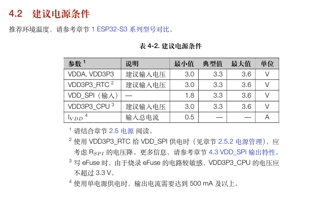

is shown in Figure 4. Since the ESP32S3 requires at least 500mA of current to power on, while the SE8550 can only output 250mA, an LDO was needed to support the ESP32S3. Okay, the first problem arose: an LDO capable of supplying high current could not withstand excessively high measured voltages, and an LDO capable of withstanding excessively high measured voltages could not supply high currents. Unfortunately, one cannot have both. Ultimately, I abandoned the power supply for the measured power source and used only USB power and a 3.7V lithium battery power, sharing an AMS1117-3.3V chip to provide 3.3V voltage to the entire system. The power supply method was selected via a switch.
Figure 4 shows the recommended power supply conditions for the ESP32S3.

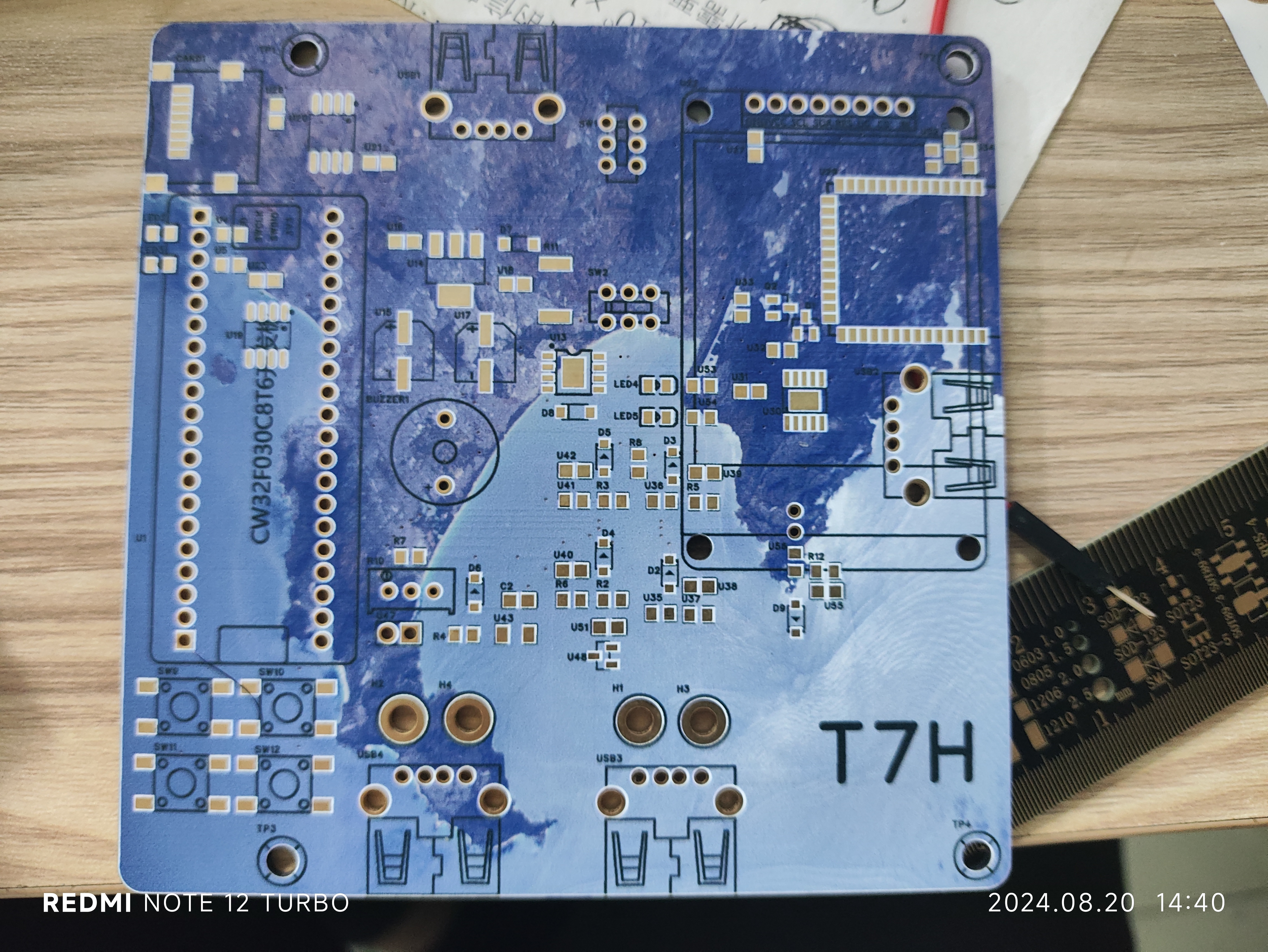

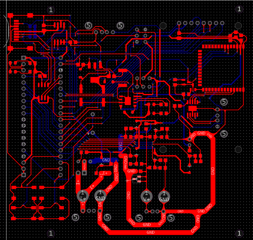

Layout issue: Let me show you my PCB traces, as shown in Figure 5: [
Figure 5 PCB traces]
Keen observers will have noticed that the ESP32S3 is on the right side of the PCB, while the CW32 is on the far left. They are connected via RX and TX lines. The data on these two lines travels a long distance from the CW32 to the ESP32S3, and then the ESP32S3 simply doesn't recognize the signal. Yes, it simply doesn't recognize the signal. However, if a line is run from the CW32 to the ESP32S3, the ESP32S3 can receive the data. I have no cold solder joints! No cold solder joints! No cold solder joints! An ammeter shows continuity at both ends! It's quite absurd. My current guess is that there are too many signal lines crossing in between, causing severe interference between the RX and TX signals. Okay, the Bluetooth function is also included. There are a lot of software issues.

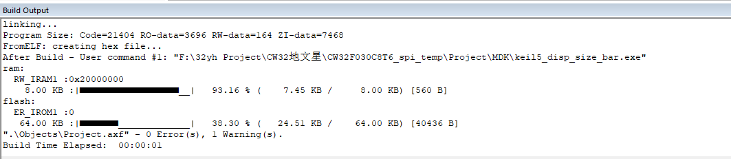

First , there's FreeRtos. The CW32 only has 8K of RAM! 8K! I've never had such a limited memory. After porting FreeRtos, the CW32 even crashed. That's right, I allocated too much memory to FreeRtos, causing the crash. I later changed FreeRtos's `configTOTAL_HEAP_SIZE` to 5*1024 before it could boot normally, but see Figure 6 in the VCR: Figure 6: Program memory usage. This tool is called `keil5_disp_size_bar`, and the author has open-sourced it on Gitee (https://gitee.com/nikolan/keil5_disp_size_bar). Then another problem arose: the 1.8-inch screen with a resolution of 128*160 was reflected in the program, where the display thread consumed a huge amount of memory just to display the GUI correctly. As shown in Figure 7: Figure 7: FreeRtos thread usage.
Then FreeRTOS only had 76*4 bytes of memory left. Okay, the FatFs15, which I hadn't even been able to test yet, is now gone.

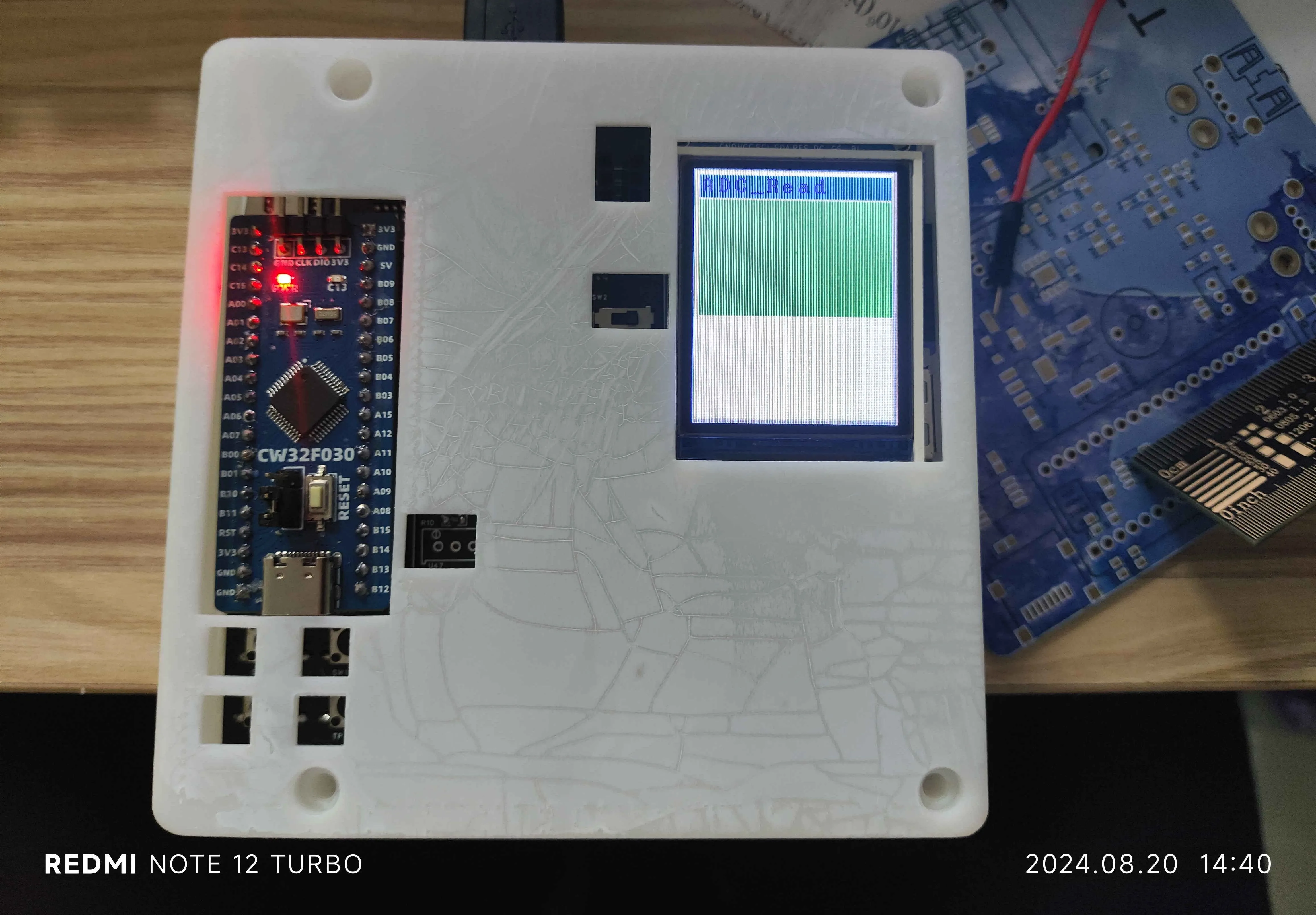

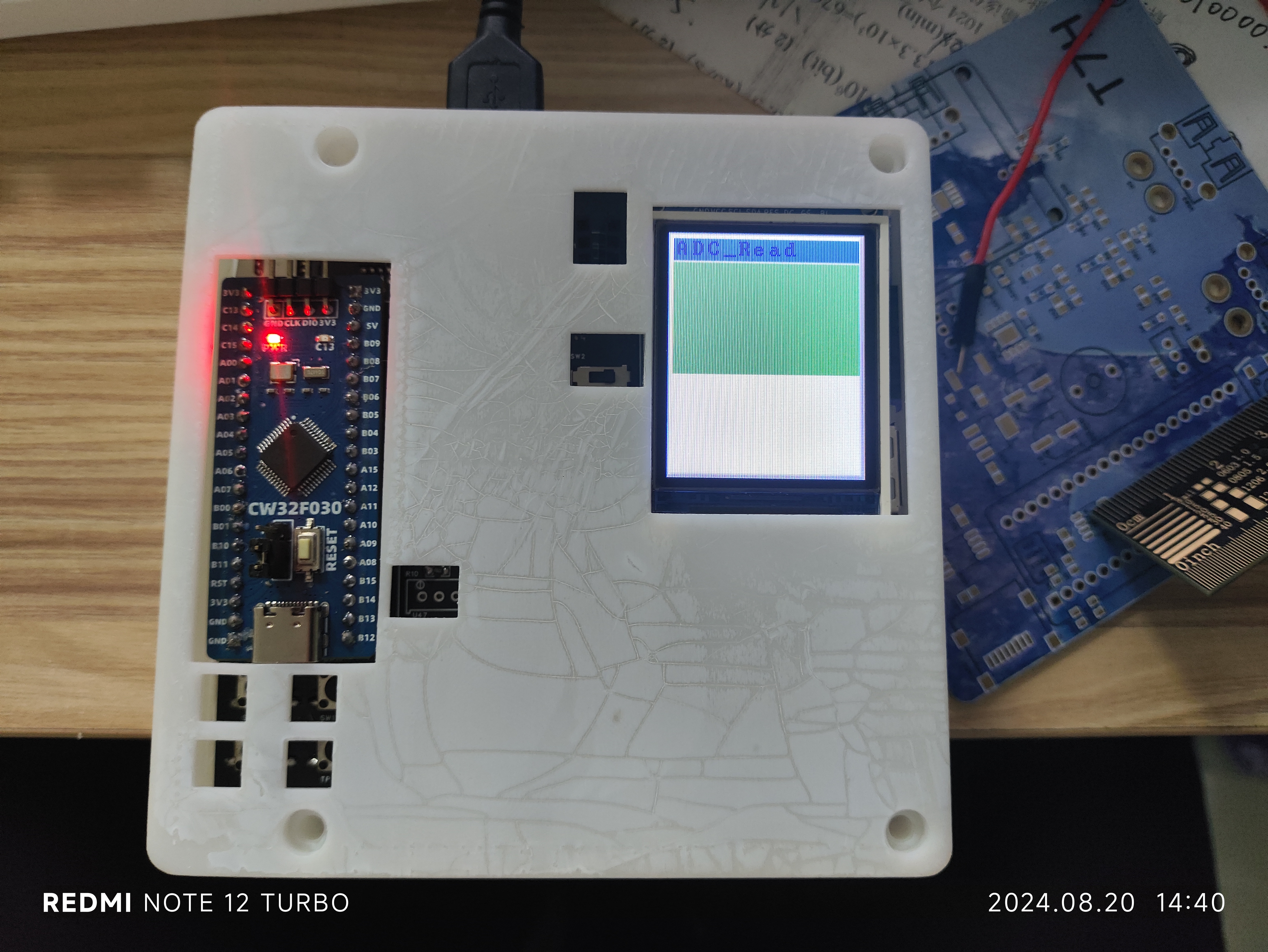

textThe final implemented functions

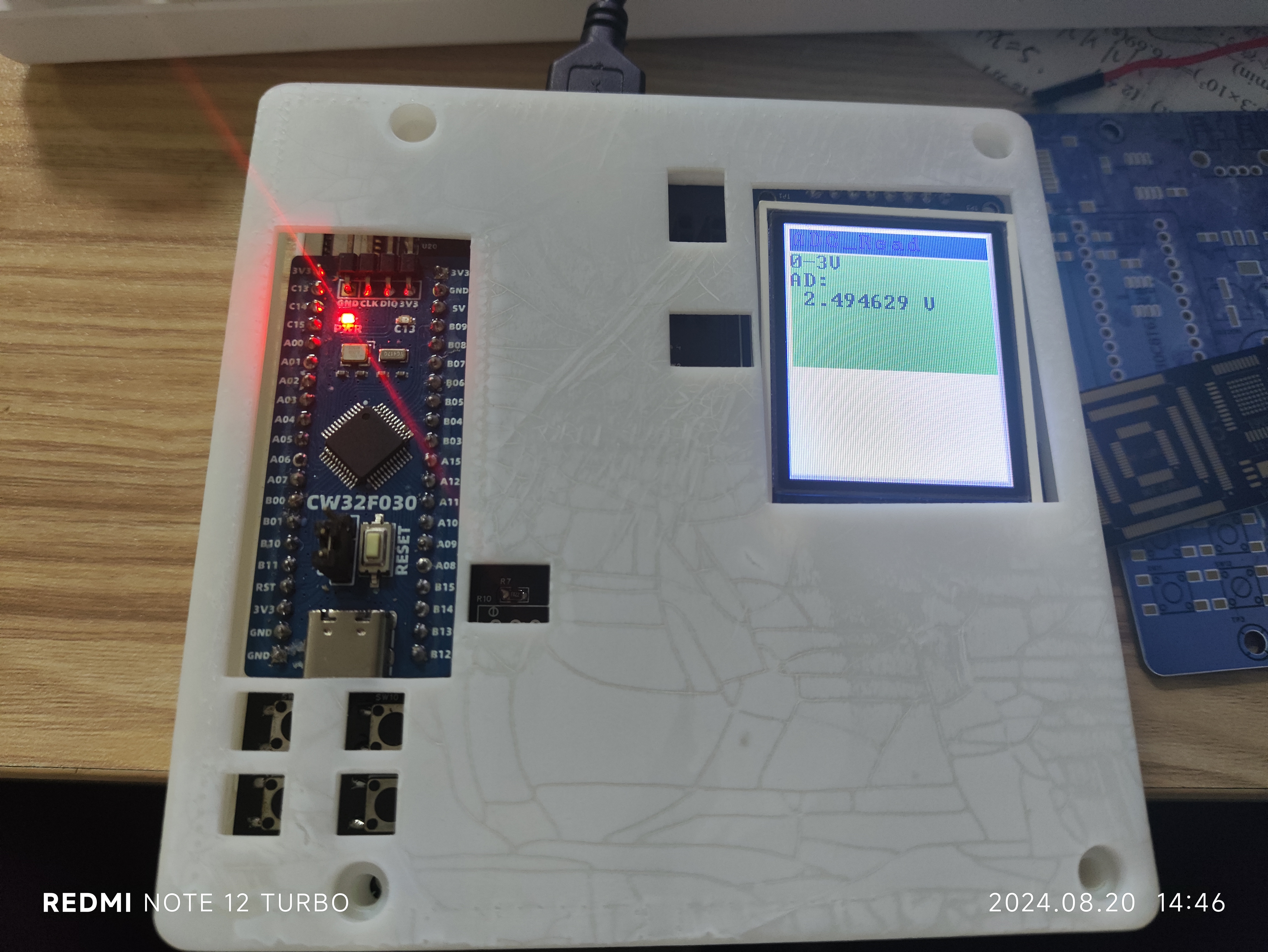

currently include 0-3V, 0-5V, 0-10V, 0-30V, and 0-3A voltage and current measurement and range switching. The measurement data can be displayed on a 1.8-inch TFT screen.

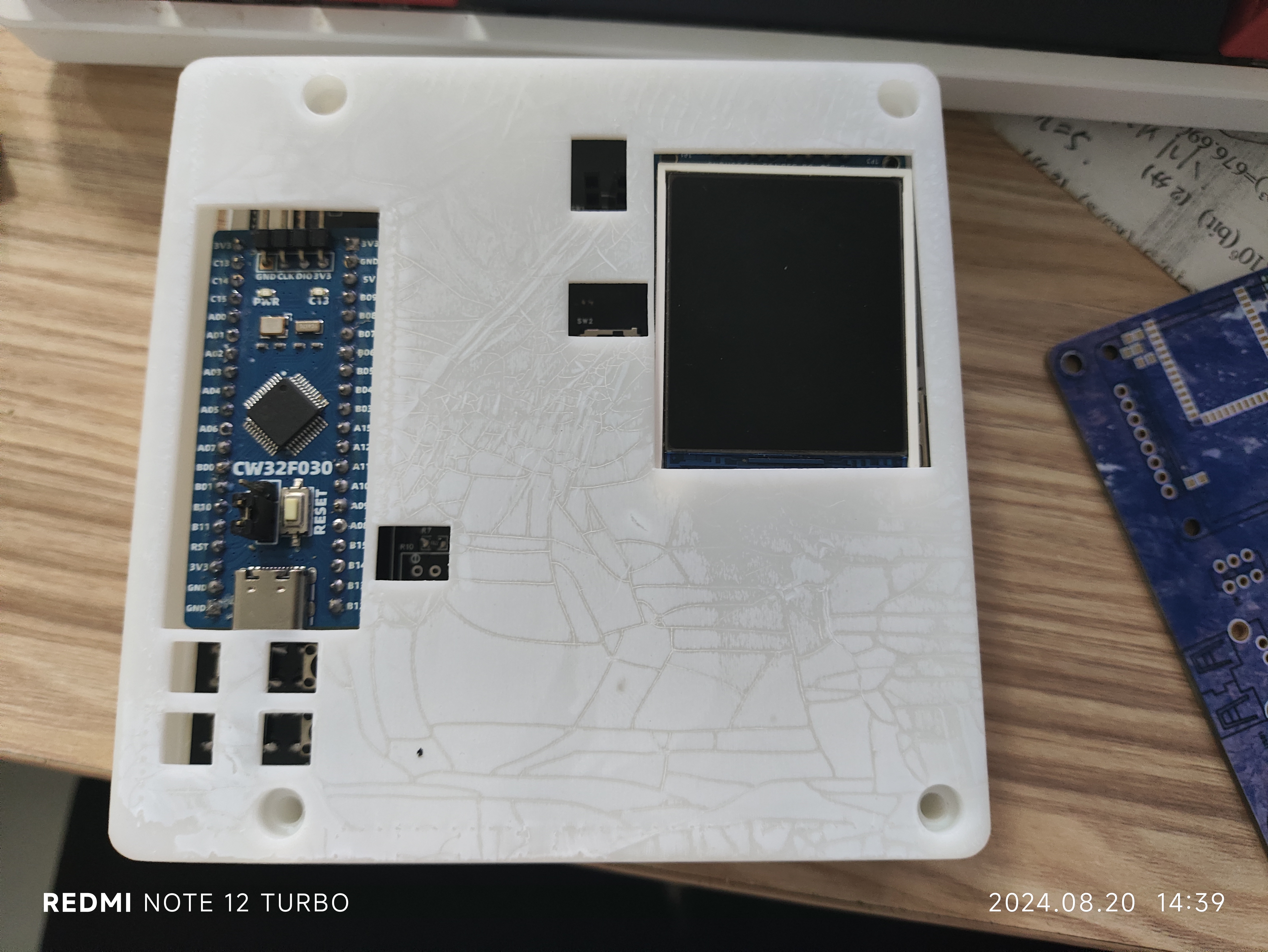

Ugly front view:
Power on: The buttons and switches are incorrectly soldered and packaged.
Voltage measurement:

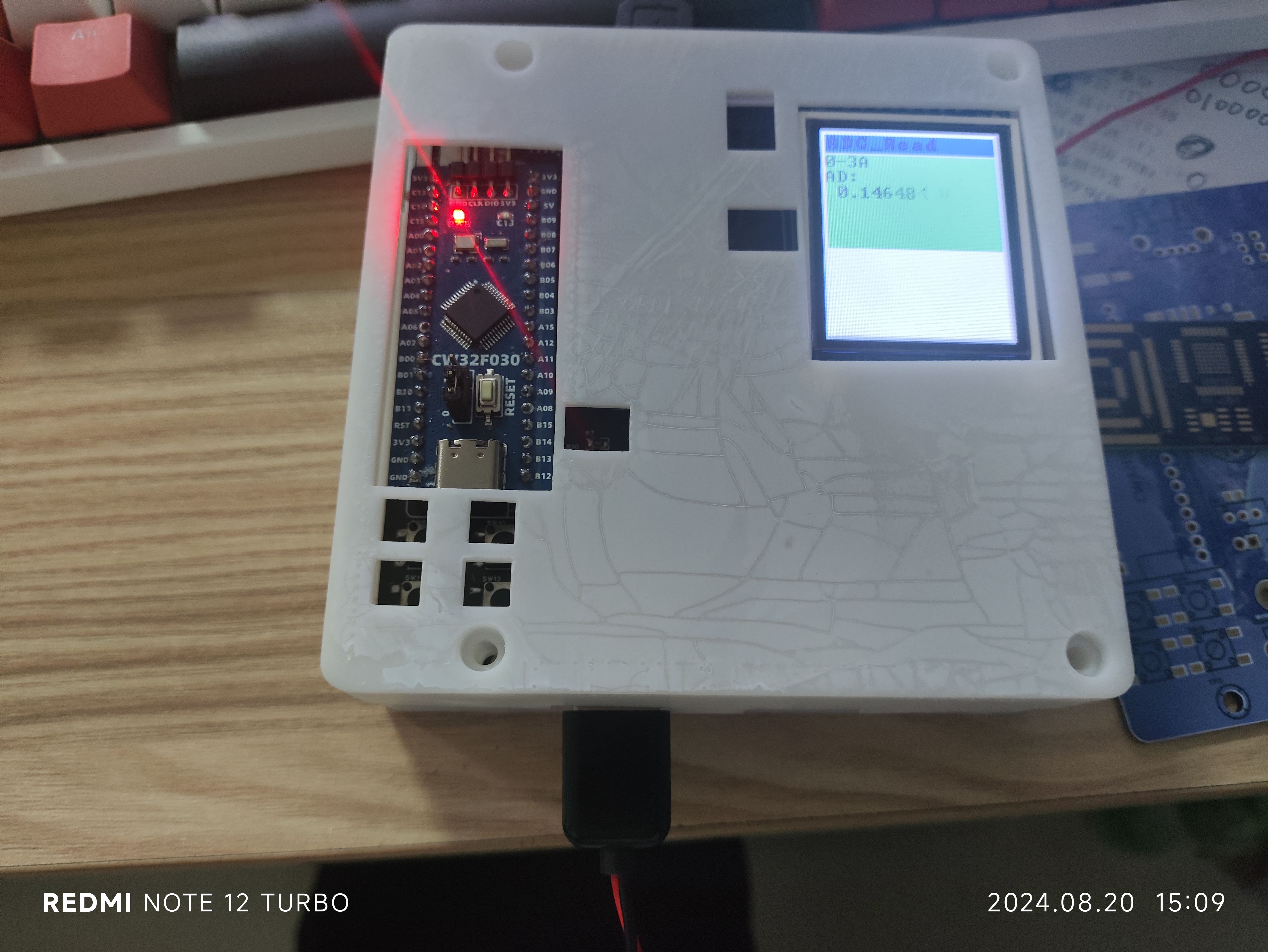

Current measurement: It looks like voltage, but it's actually current; I just forgot to change the V to A
in the color silkscreen. Because this version has a bug, I have to re-make the board. I'll add the remaining functions
later
if I have the chance. I hope I can get a certificate of completion.
