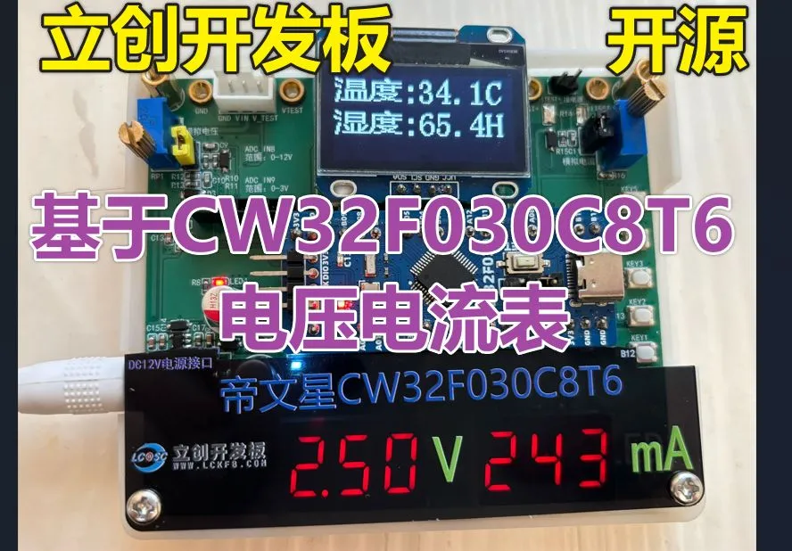

Voltage and current meter detection
To save I/O resources, I used an SN74HC595 shift register to drive the LEDs in the hardware design

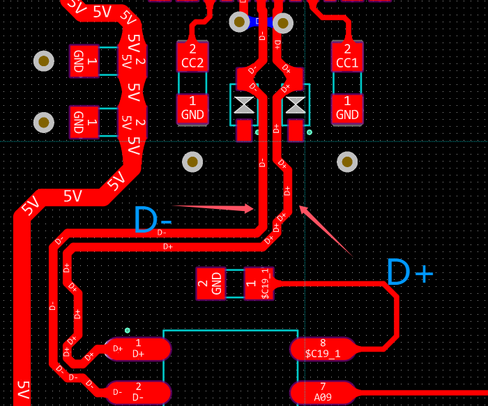

This is a USB-to-serial module for convenient debugging. Note that CC1 needs to be connected to a 5.1k resistor. The D+ and D- differential signal lines must be of equal length. The CH340 is a USB-to-serial converter.
Set the differential pair in the rules, and then adjust

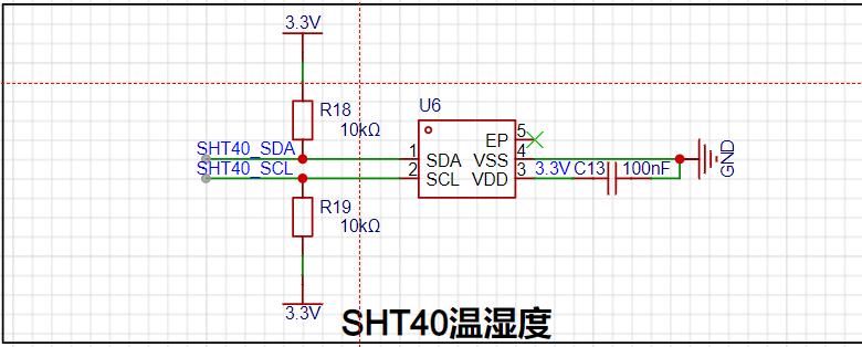

the SHT40 temperature and humidity module with equal length. Here, SDA is the data line and SCL is the clock line. The PCB traces should be differential. The R18 and R19 should be appropriately selected; general values ​​are 4.7k and 10k. The specific values ​​depend on the actual requirements.

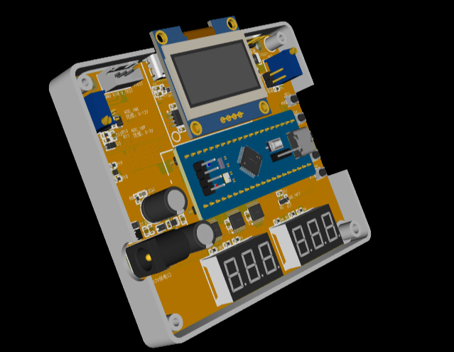

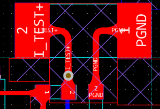

This is the current sampling module. R14 is the sampling resistor, using a 2512 package with a power rating of 3W. In the PCB design, Kelvin wiring is required, as shown in the PCB 3D image,

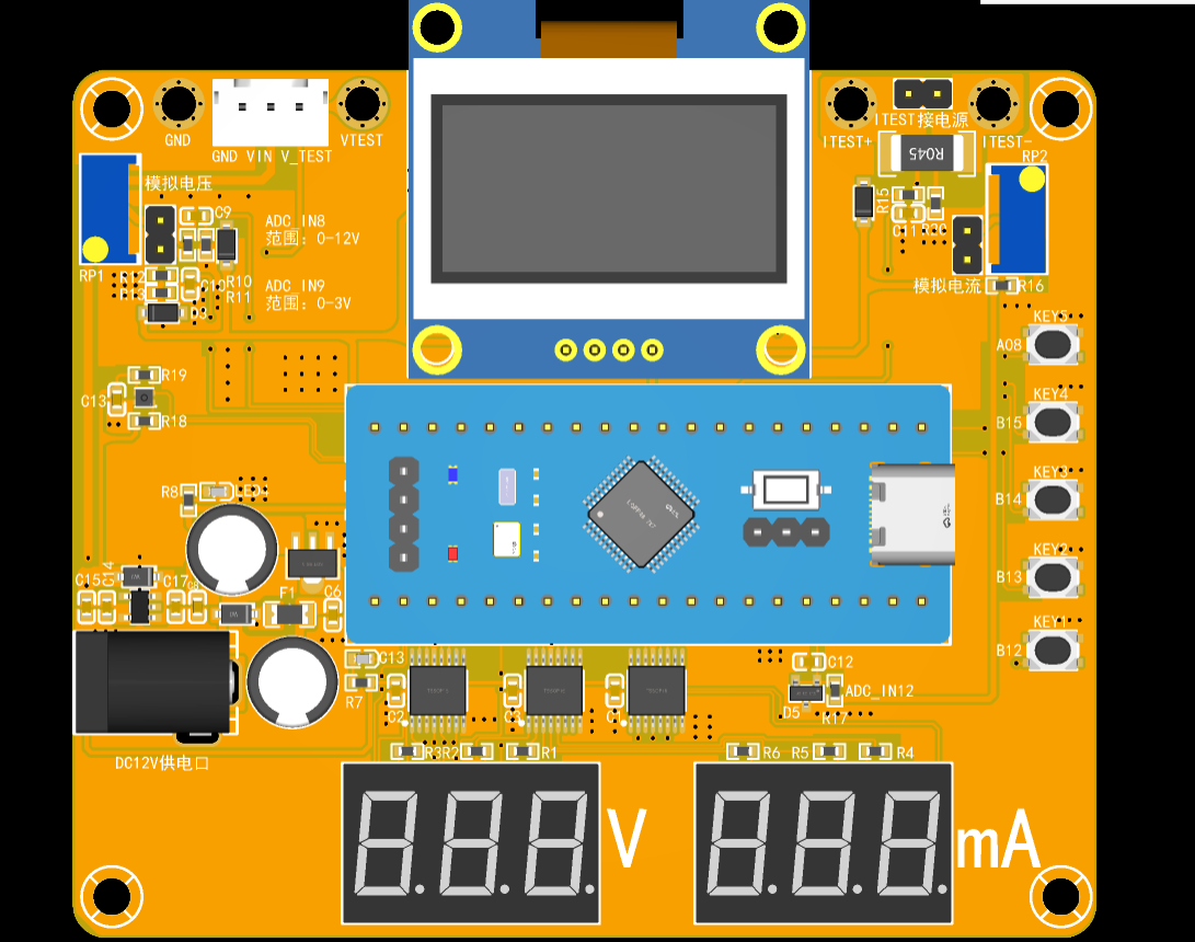

3D casing
effect image, and

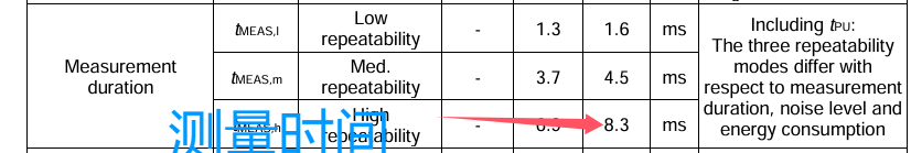

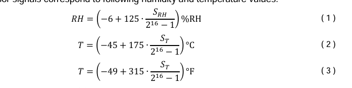

. `void SHT40_GetData(SHT40_t *sht40){ SHT40_I2C_Start(); SHT40_I2C_Write_Byte(SHT40_WRITE); SHT40_I2C_WaitAck(); SHT40_I2C_Write_Byte(SHT40_Read_Mode); SHT40_I2C_WaitAck(); SHT40_I2C_Stop(); delay_ms(10); SHT40_I2C_Start(); SHT40_I2C_Write_Byte(SHT40_READ); SHT40_I2C_WaitAck(); for(uint8_t i = 0; i` sht40->read_data[i] = SHT40_I2C_Read_Byte(); if(i == 5){ SHT40_I2C_NoAck(); }else{ SHT40_I2C_Ack(); } } SHT40_I2C_Stop(); sht40->Temperature = (1.0*175*(sht40->read_data[0]*256 + sht40->read_data[1])) / 65535.0 - 45.0; sht40->Humidity = (1.0*125*(sht40->read_data[3]*256 + sht40->read_data[4])) / 65535.0 - 6.0; sht40->Temp = (uint16_t)(sht40->Temperature*10); sht40->humi = (uint16_t)(sht40->Humidity*10);}
Here I wrote my own protocol using software I2C. After sending the address, there must be a 10ms delay. The chip manual says that reading the protocol is very simple. Send the address and command. Here I choose repeated measurement, then read the data, and finally
convert it according to the formula.

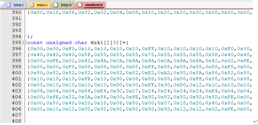

Display part
OLED_ShowChinese(0,0,0,24,1);OLED_ShowChinese(24,0,1,24,1);sprintf((char *)OLED_Data,":%.1fC",sht40.Temperature);OLED_ShowString(24*2,0,(uint8_t*)OLED_Data,24,1);OLED_ShowChinese(0,24,3,24,1);OLED_ShowChinese(24, ... *)OLED_Data,":%.1fH",sht40.Humidity);OLED_ShowString(24*2,24,(uint8_t*)OLED_Data,24,1);

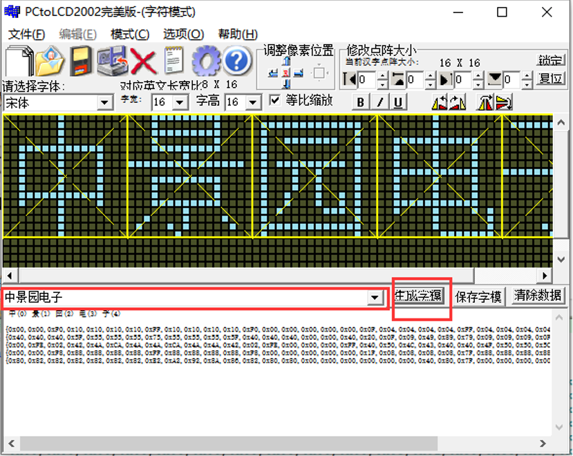

Chinese characters are extracted using PCtoLCD2002. For easier data display, I use sprintf here. The usage of sprintf is similar to printf.
Open the extraction software and
extract Chinese characters.

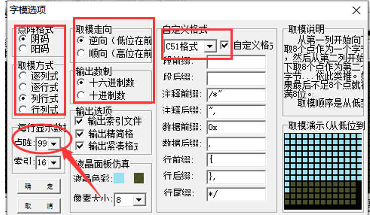

2.1 Click Mode, select Character Mode
. 2.2 Click Options, set the settings
as follows: manually enter 999 for the numbers in the dot matrix, and then click OK.
Taking the generation of 16x16 Chinese characters as an example:
3.1 Select 16 for character width and height.
3.2 Enter the Chinese character to be extracted in the input field (only Chinese characters are allowed), and then click Generate Character Model.
Copy the generated character model to the h array.

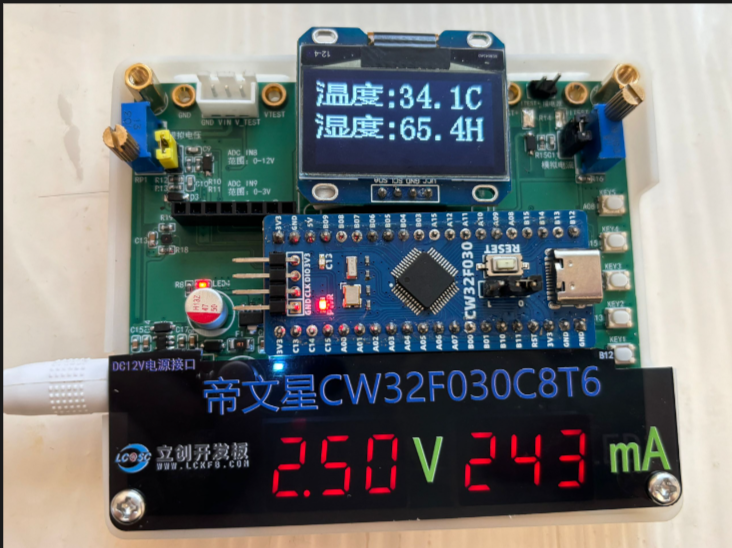

This is the voltage and current display part and voltage and current calibration. The data needs to be filtered to remove the maximum and minimum values, and then the average is taken. After calibration, the error is about 0.01V.
