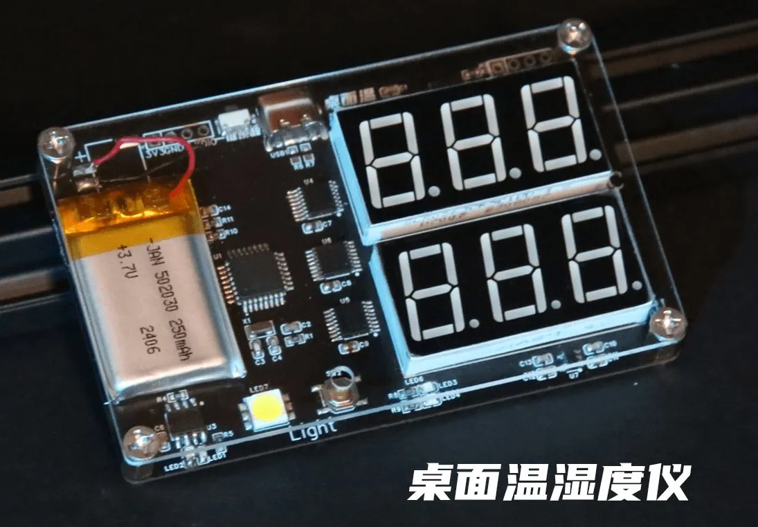

This project is a desktop temperature and humidity sensor based on the STM32G030K6T6.
The sensor used is the Swiss Sensory SHT40-AD1B, which has the advantages of low power consumption, high accuracy, and small size, making it very suitable for onboard use.
The display section uses an SN74HC595+ three-digit LED display.
The power supply section uses a 4.2V lithium battery.

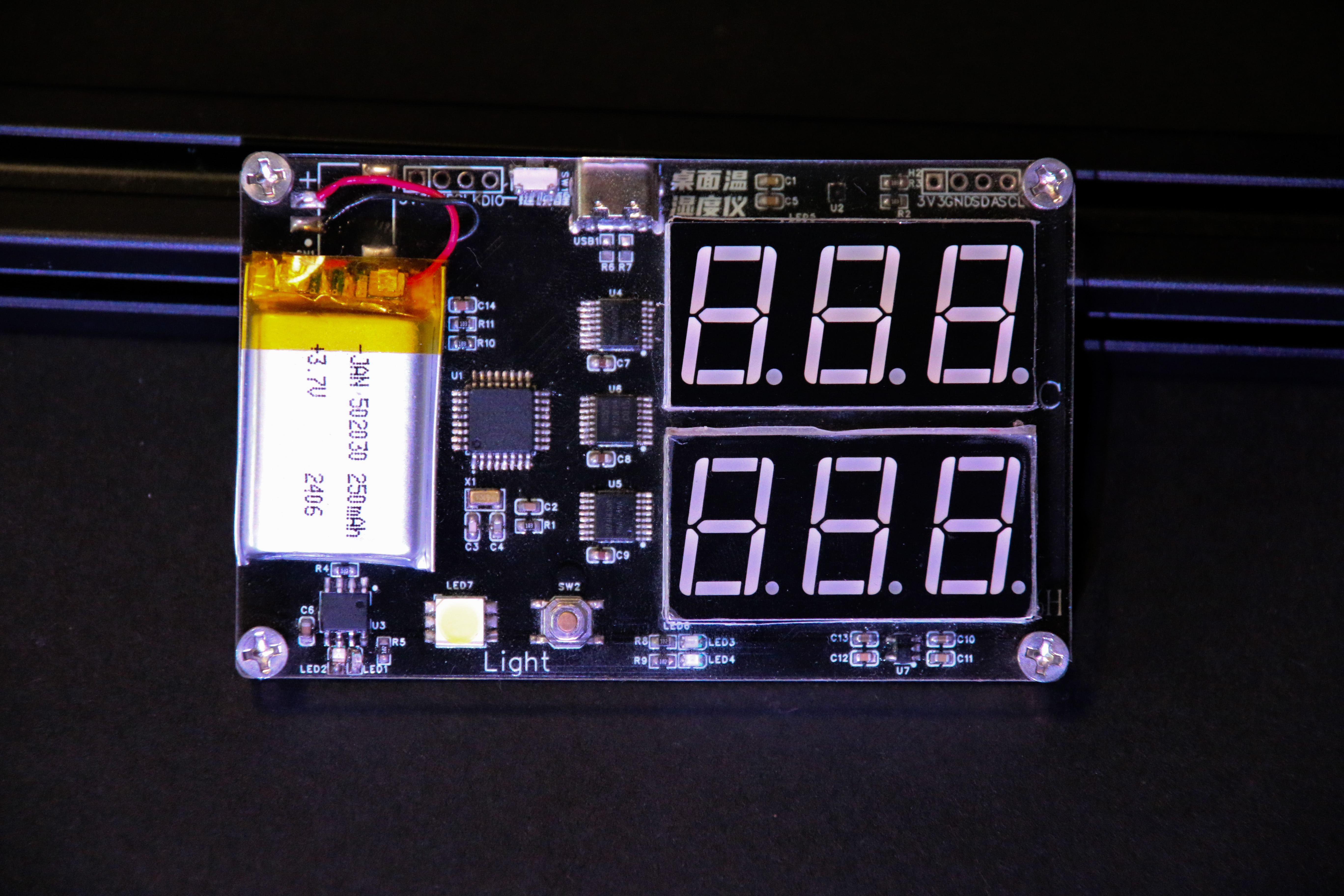

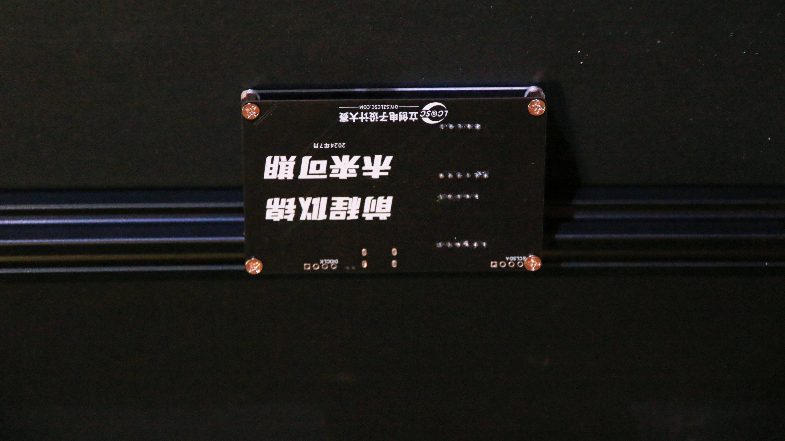

1.2 Physical Display:
Front and
Back

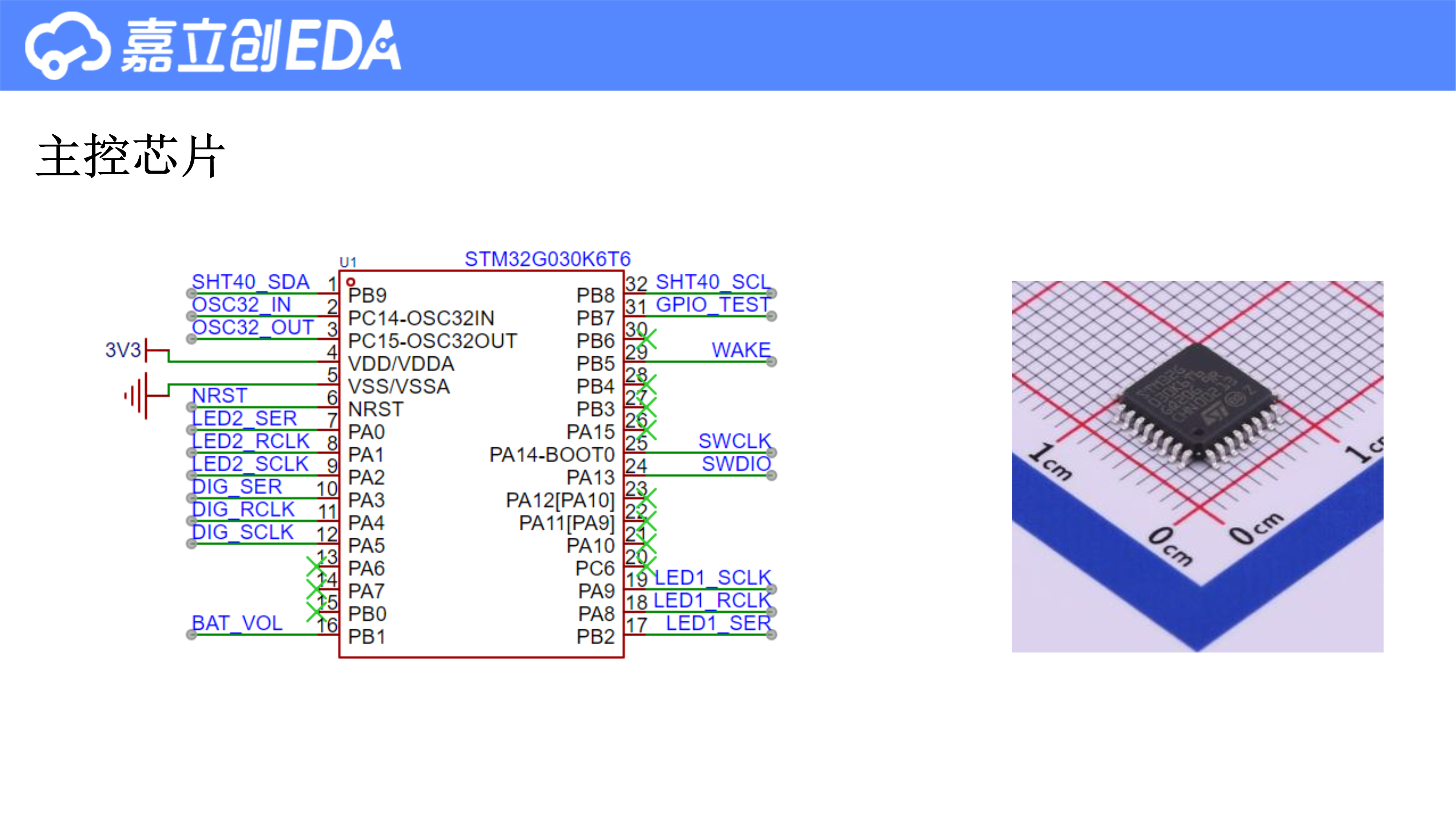

3.1.1 Main Control Section
: The main control uses an STM32G030K6T6.

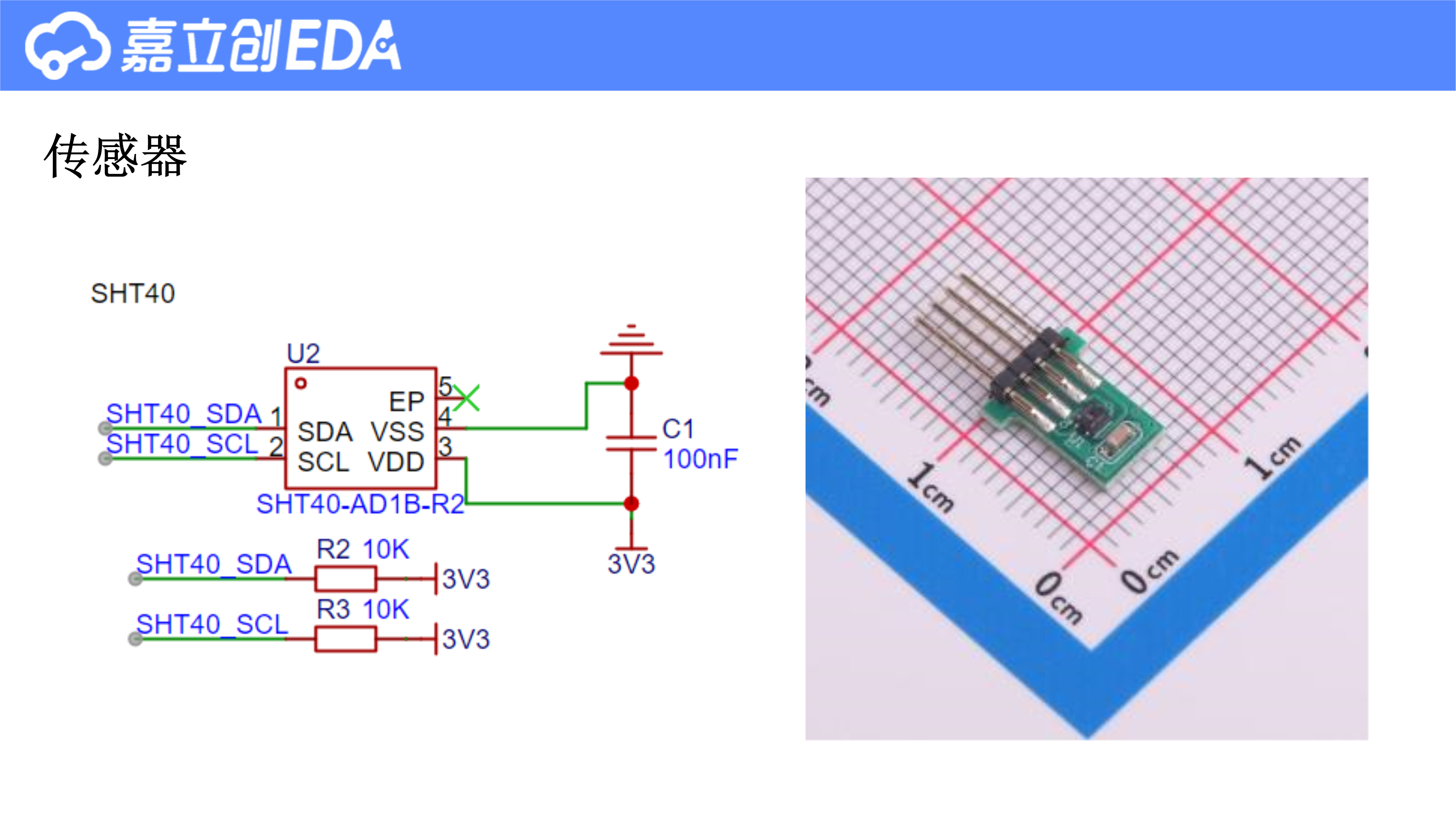

3.1.2 Sensor Section
: The sensor uses a Sensirion SHT40-AD1B from Switzerland. Compared to the module, a filter capacitor C1 and bus pull-up resistors R2 and R3 need to be added.

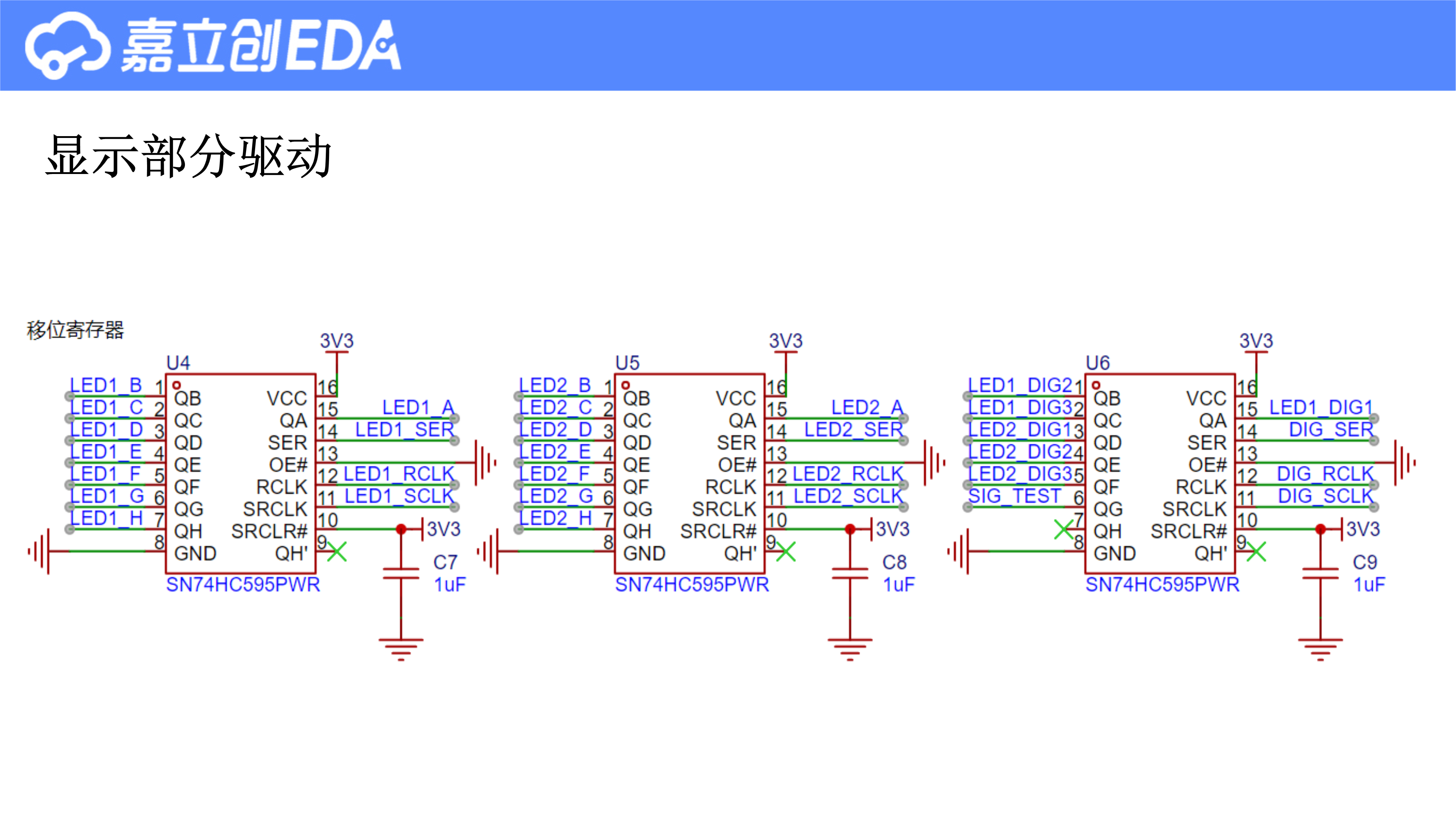

3.1.3 Shift Register
: The LED display shift register uses a 74HC595.

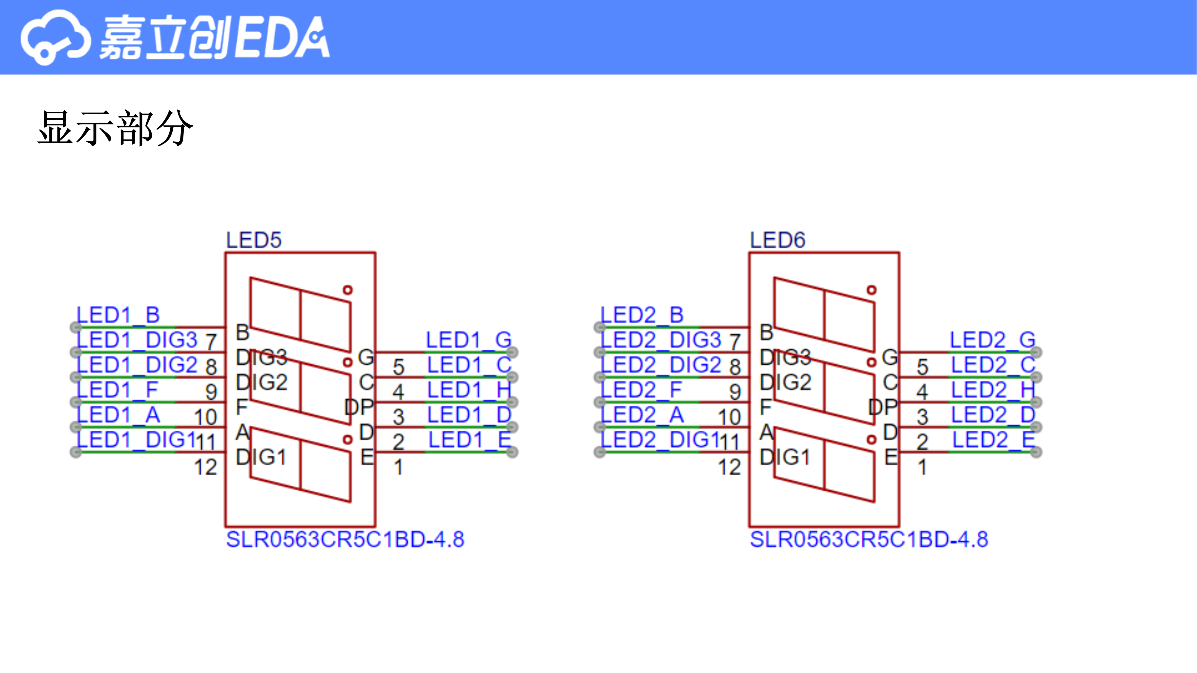

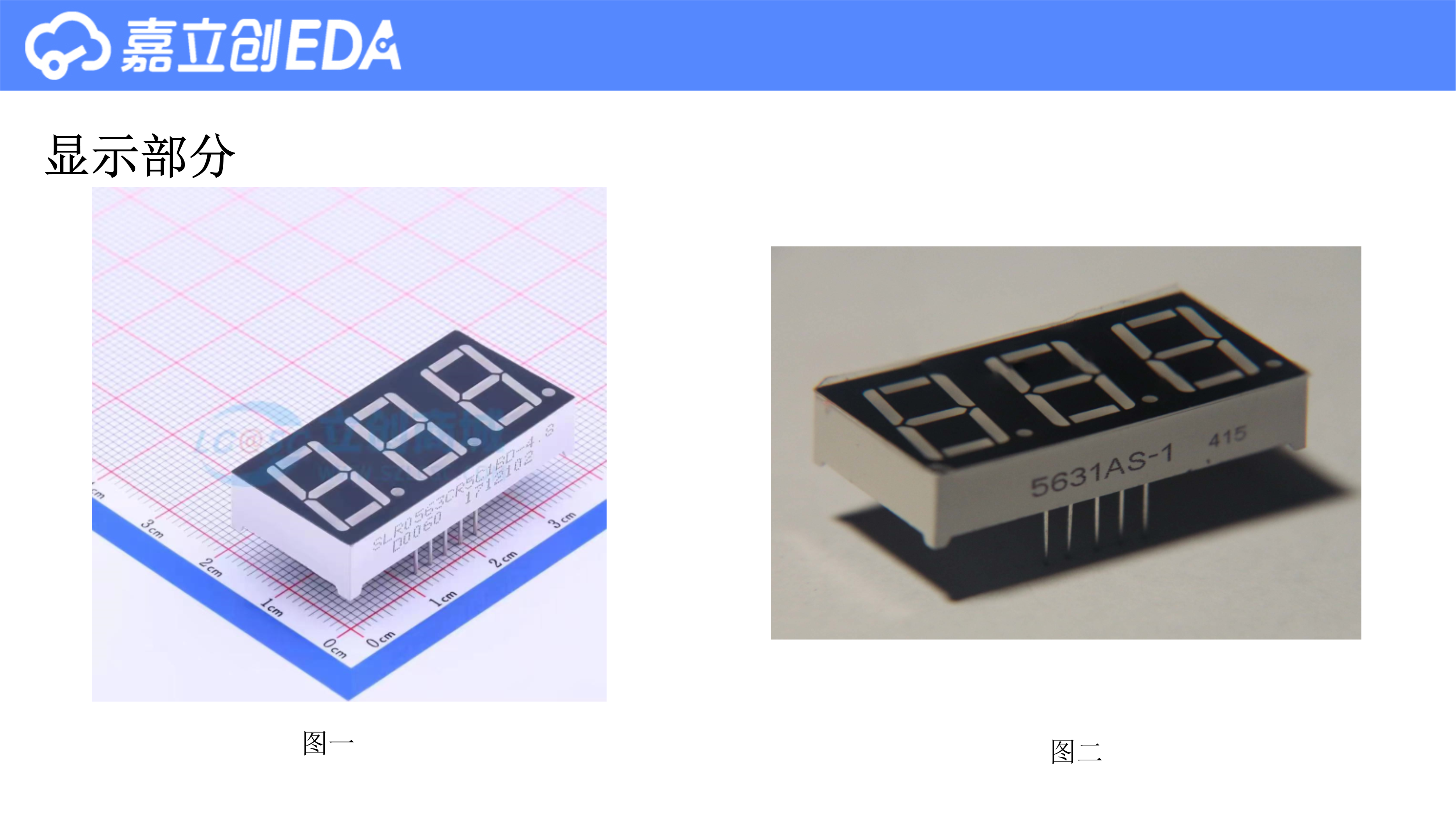

3.1.4 Display Section
The display section uses a 0.56-inch three-digit LED display.
Originally, I used one purchased from LCSC Mall (as shown in Figure 1). I bought six, but only one was left. So I had to buy one from Taobao (as shown in Figure 2). The price was one-quarter of that in Figure 1. The soldering temperature was slightly higher and it was perfectly fine. Unlike some other types, it would break as soon as it was soldered and was also ridiculously expensive.

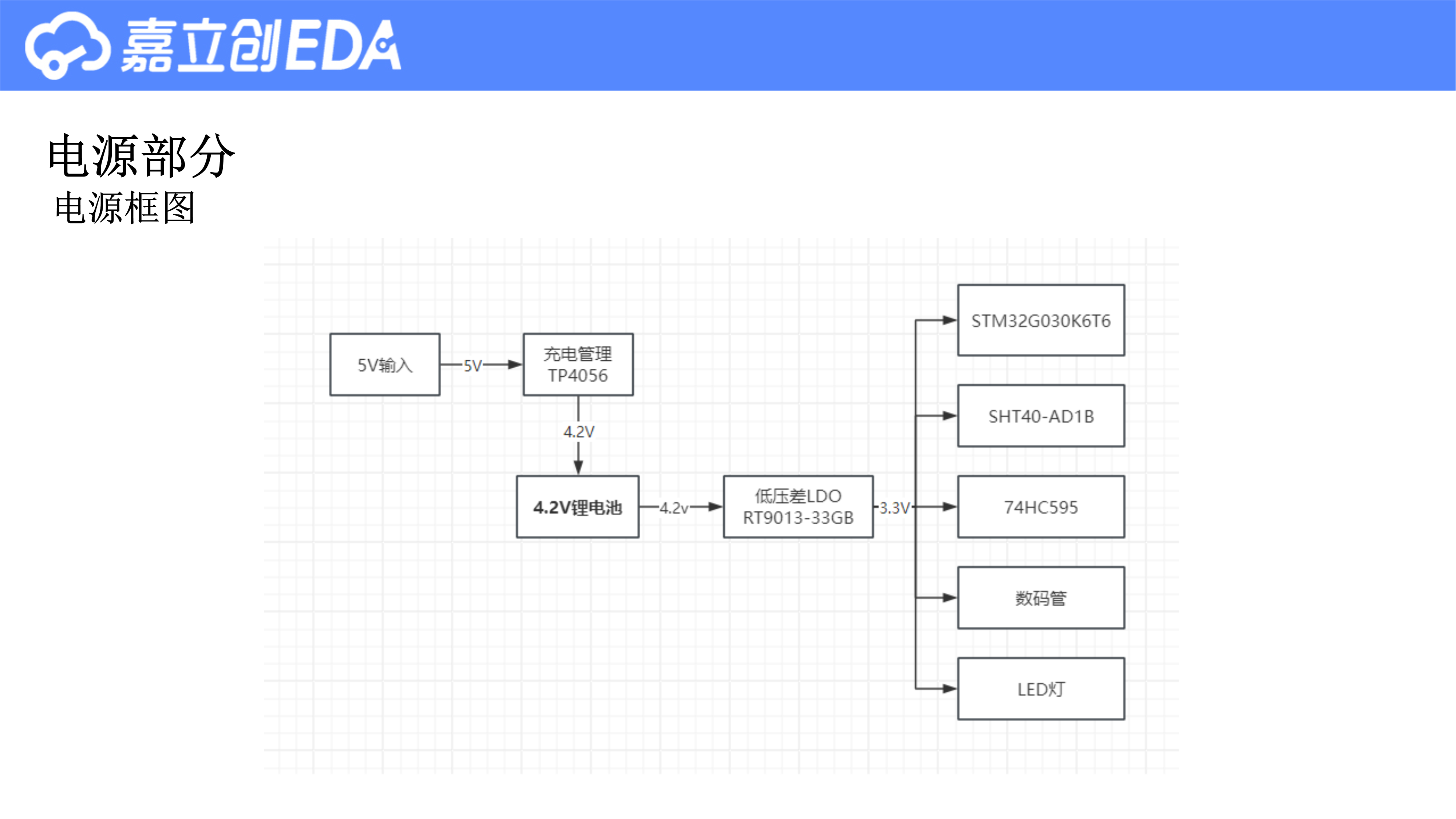

3.1.5 Power Supply Section
(1) Power Supply Block Diagram

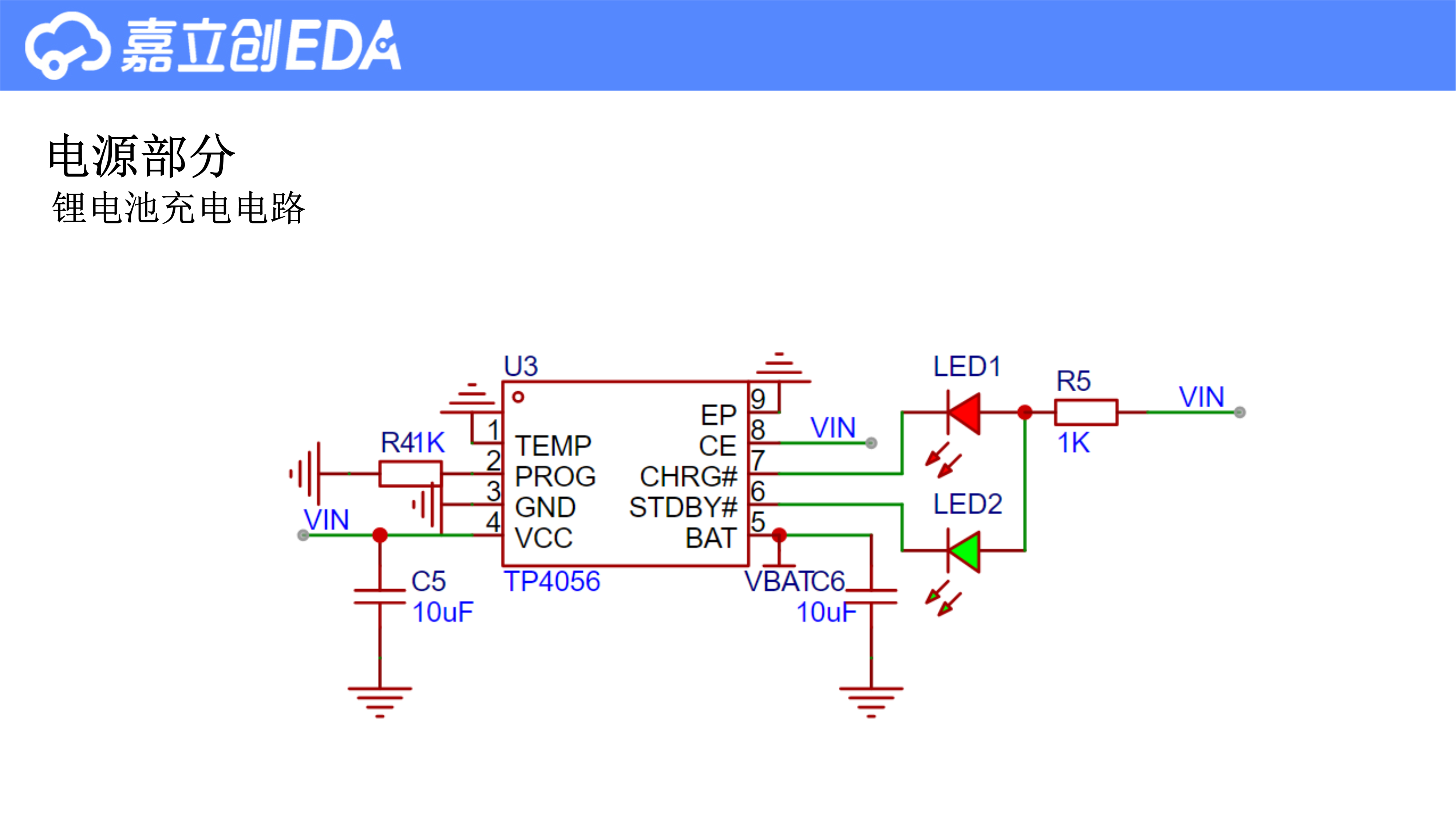

(2) Lithium Battery Charging Circuit
I believe everyone is familiar with TP4056, so I will not introduce it.

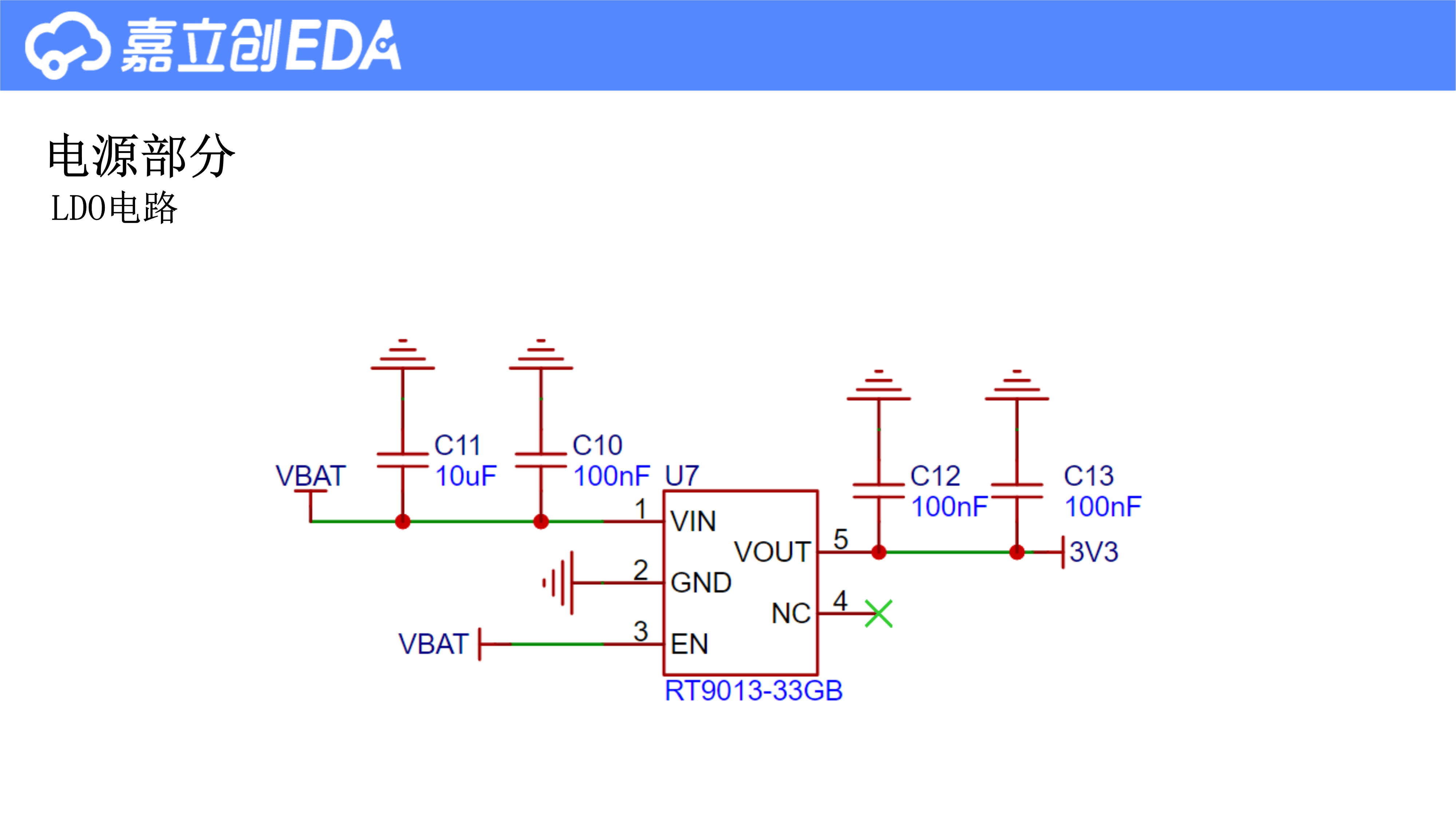

(3) LDO Circuit
The LDO used is RT9013-33GB.
Note that since the voltage of lithium batteries is between 3.3-4.2V, ordinary LDOs (such as AMS1117-3.3) are not suitable because their voltage difference is too large, around 1V. The voltage difference of RT9013-33GB is smaller, so RT9013-33GB is selected.
ME6211C33 can also be used here, as the circuits are basically the same. However, I have more RT9013-33GB (obtained from LCSC 16-15) and few ME6211C33, so I chose RT9013-33GB.
DC-DC is more efficient, but the cost is higher, so it is not chosen.

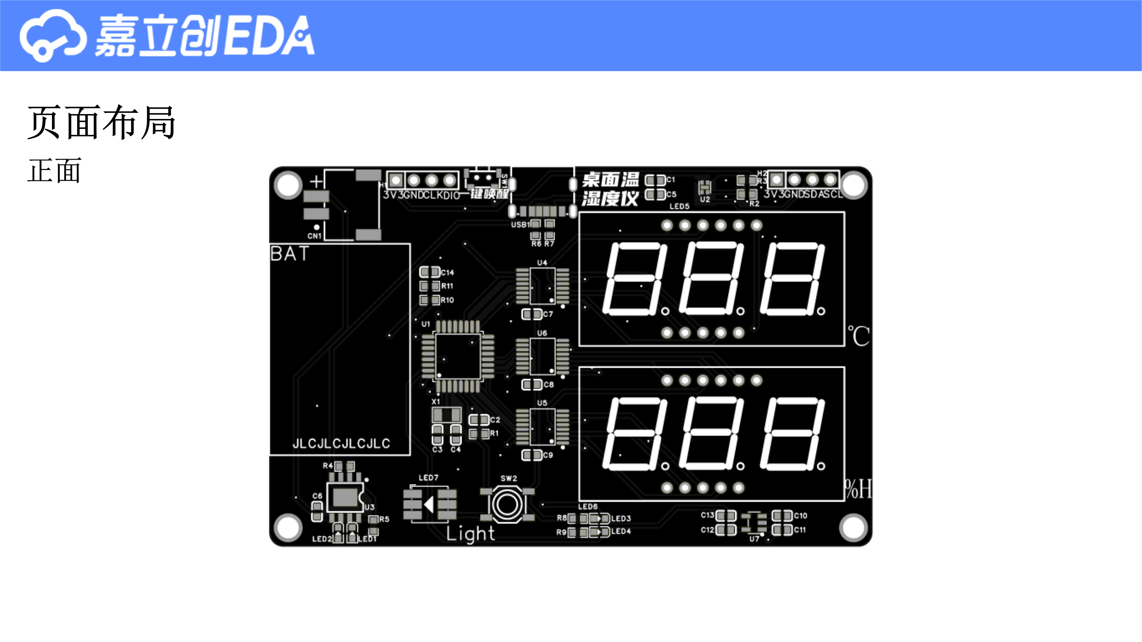

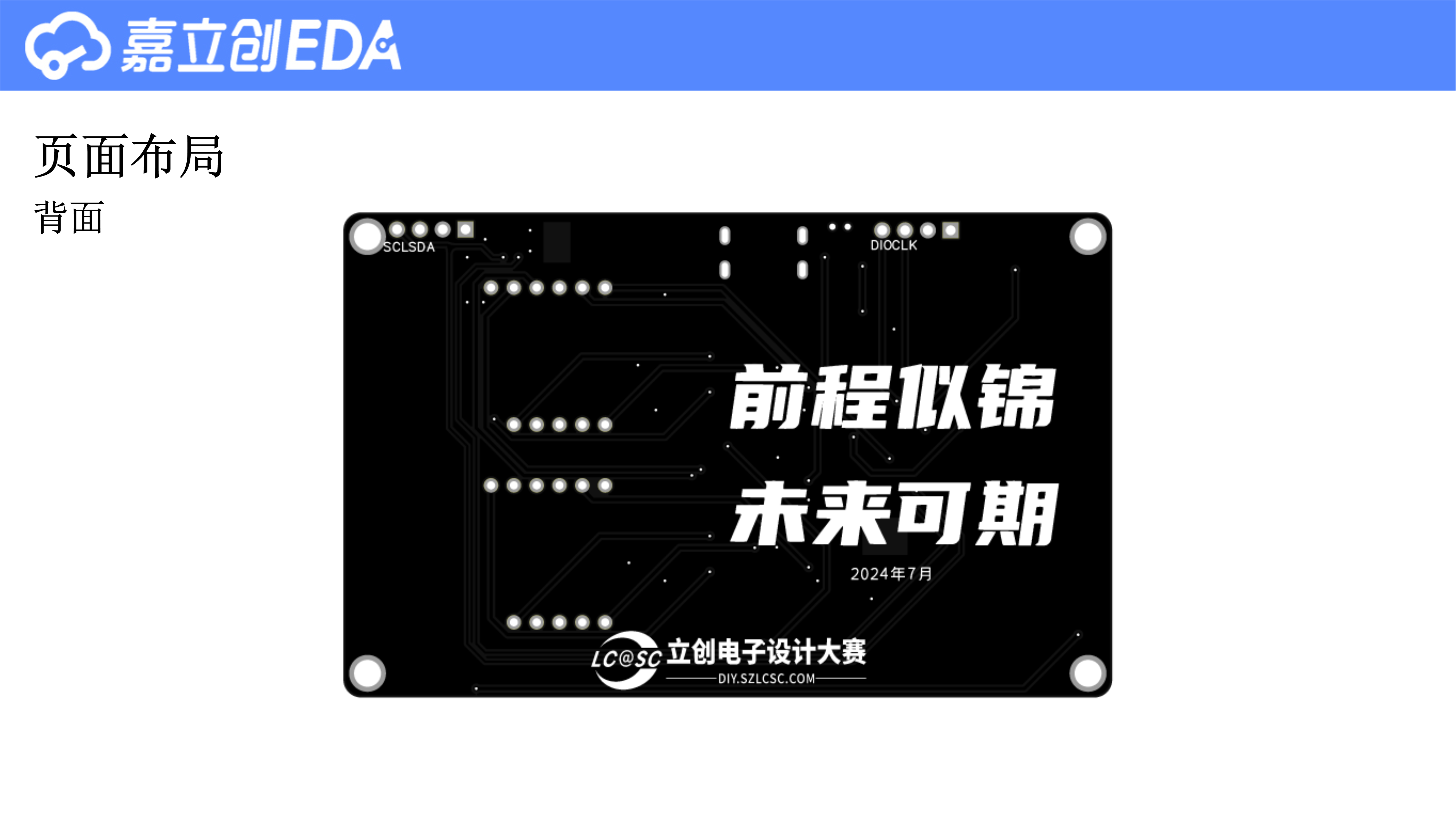

3.2.1 Page layout
The front
and back
are made of 1MM board, and the overall use is surface mount as much as possible. Resistors and capacitors are all 0603.

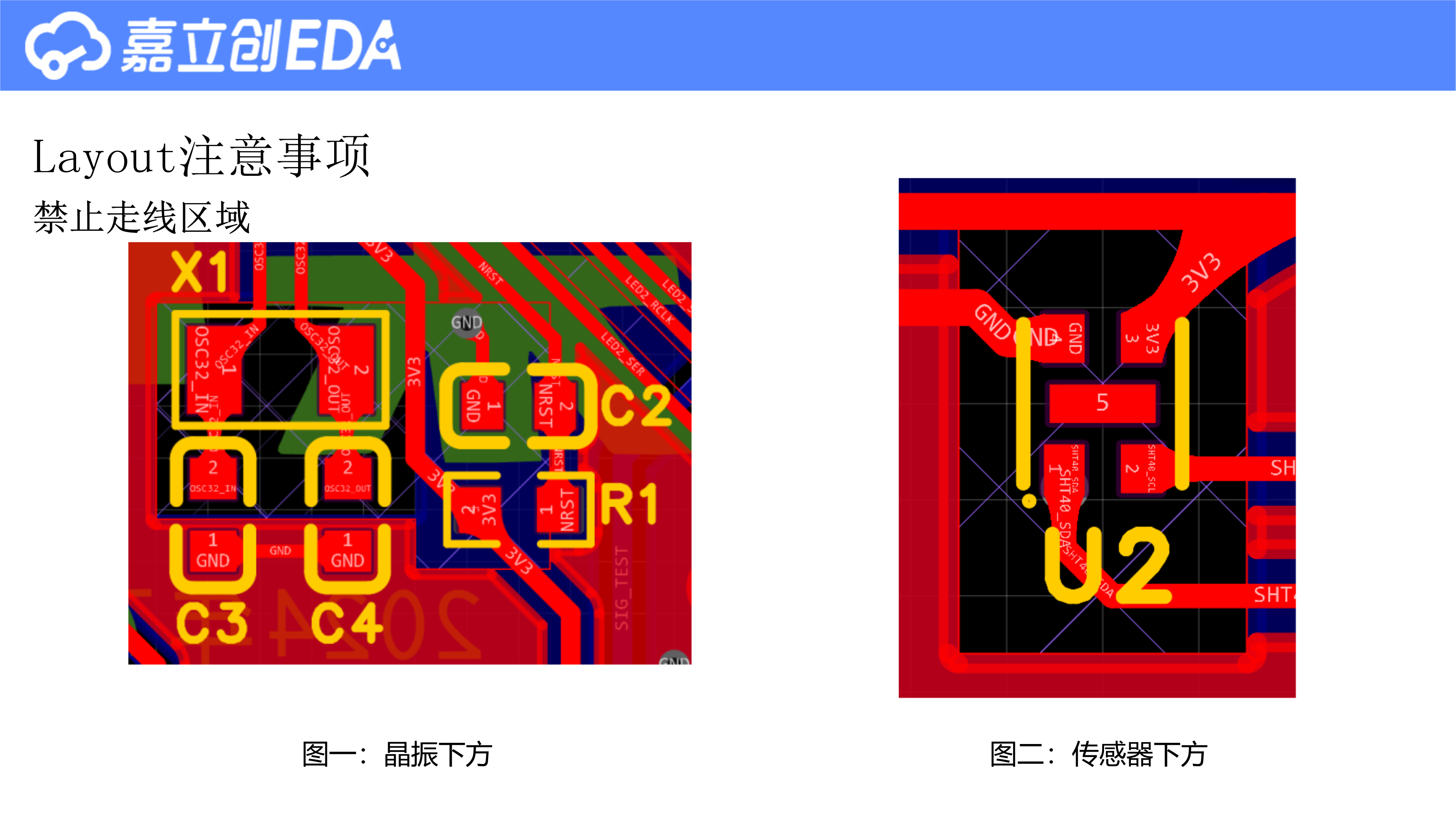

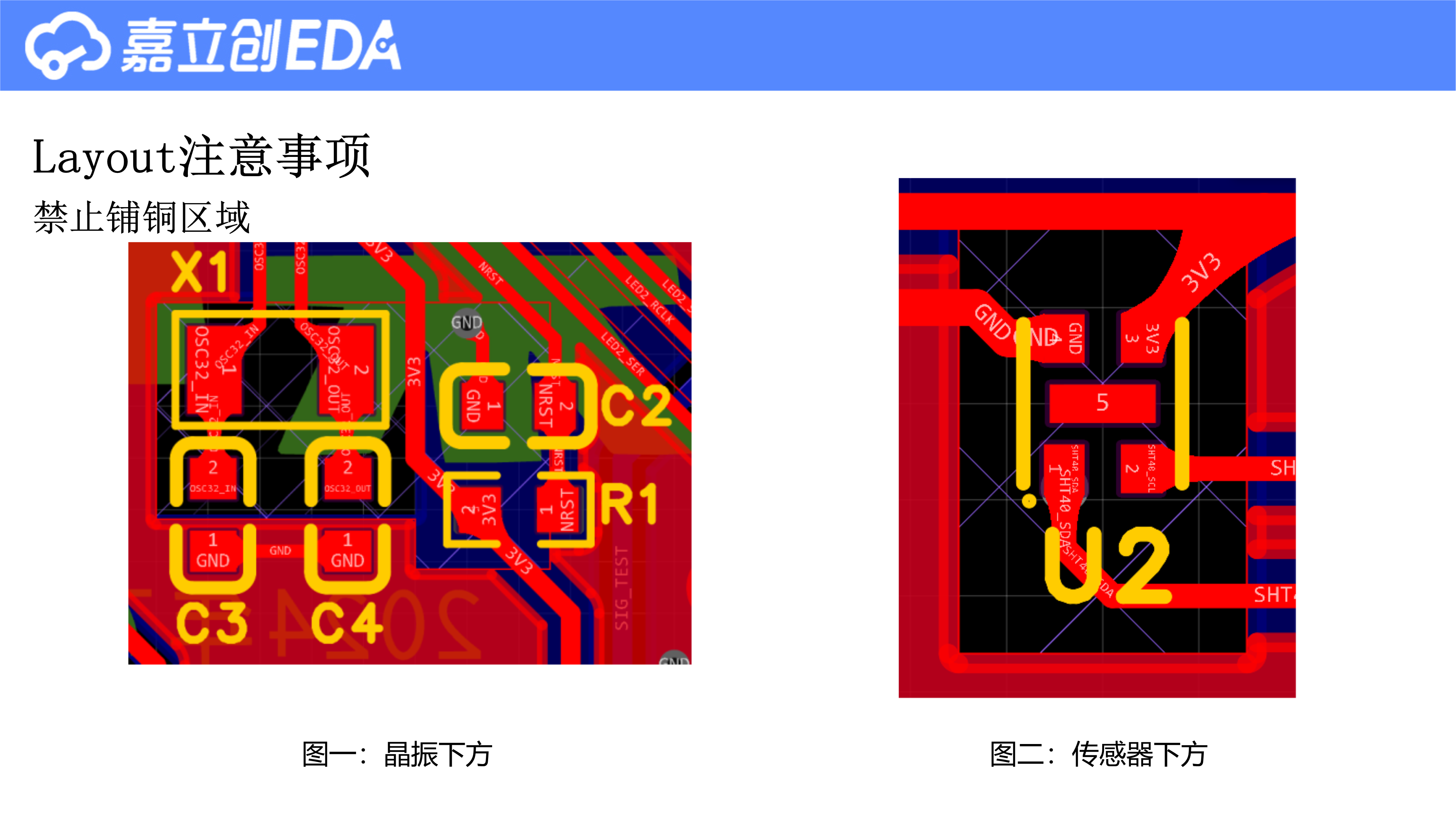

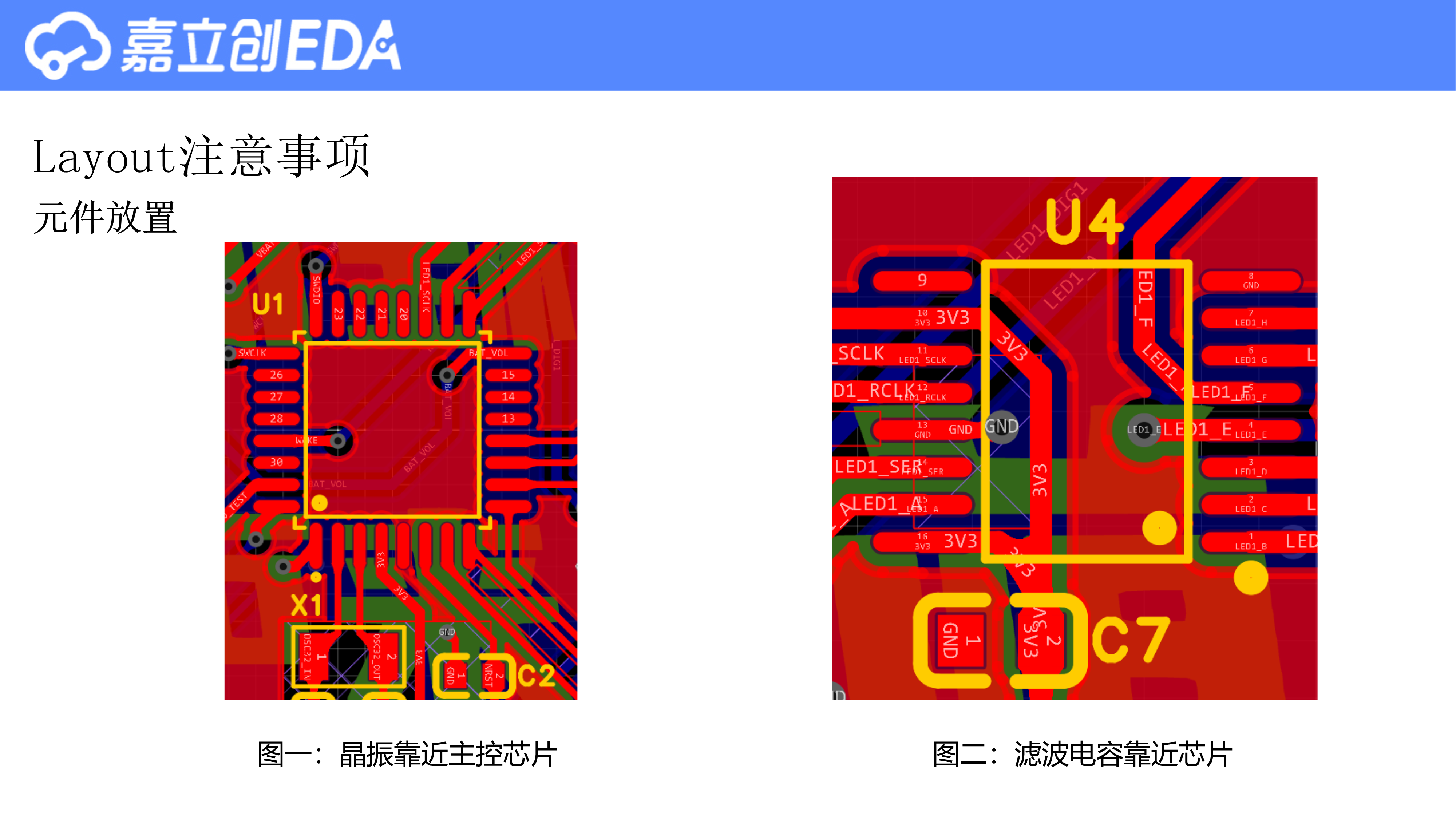

3.2.2 Layout precautions
(1) Copper-layout prohibited area
(2) No-trace area

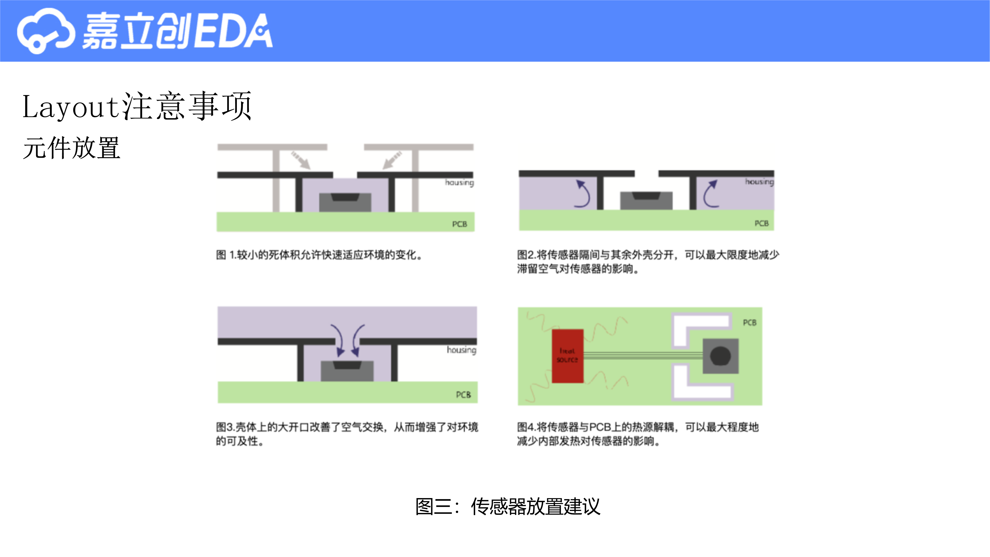

(3) Component placement
Sensor placement suggestions

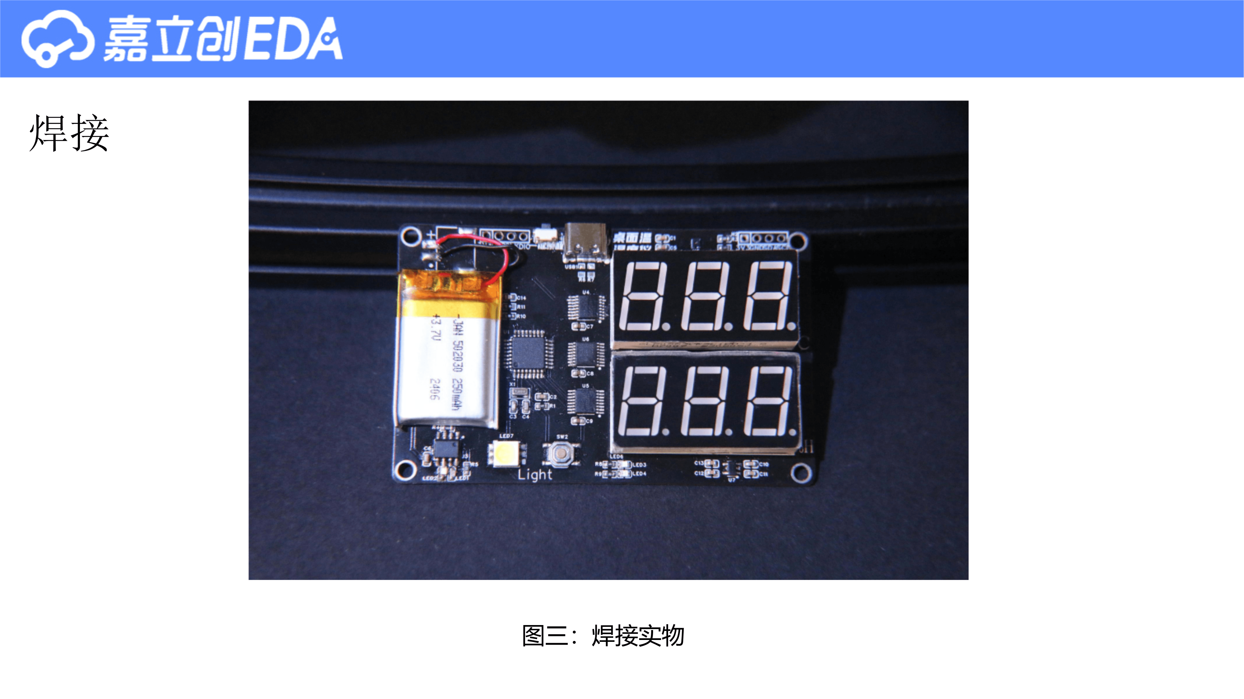

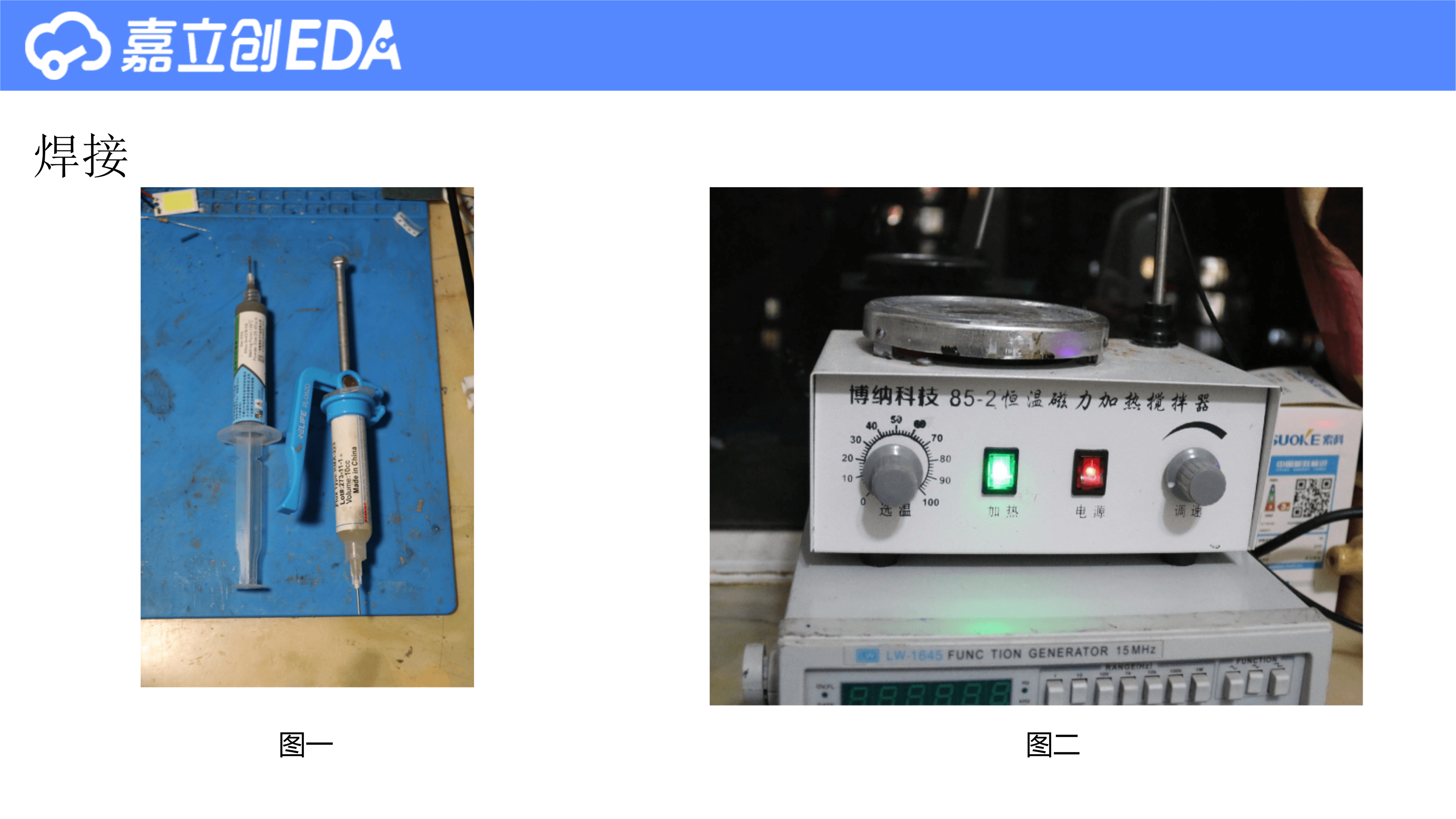

3.2.3 Soldering
solder paste and soldering oil (as shown in Figure 1), then use a heating table (as shown in Figure 2) and hot air gun for surface mount soldering, and then use a soldering iron to solder the plug-in. My heating table was damaged, so I used a constant temperature magnetic heater, which has a temperature of two or three hundred degrees, which is sufficient.
Soldering finished product

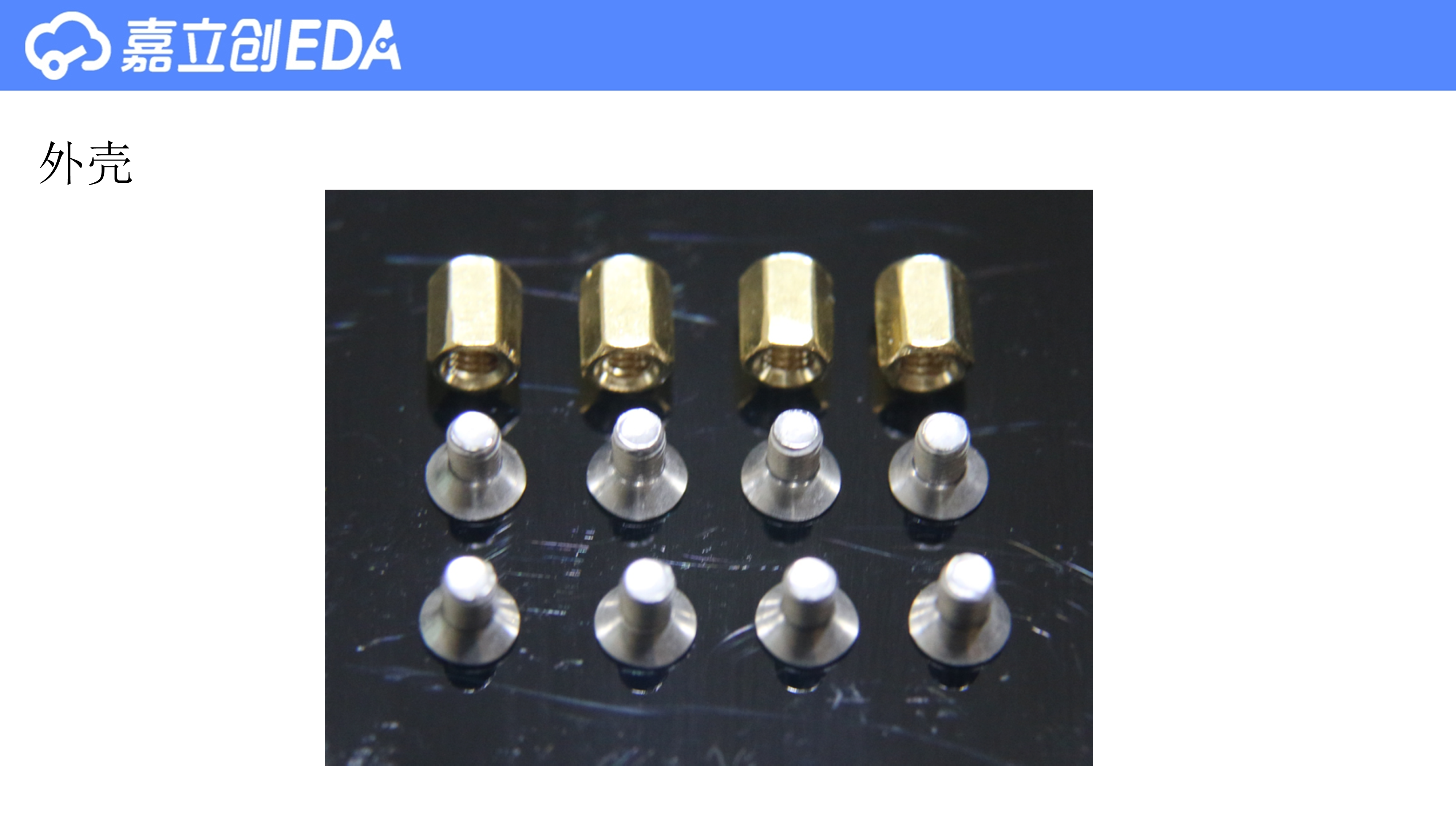

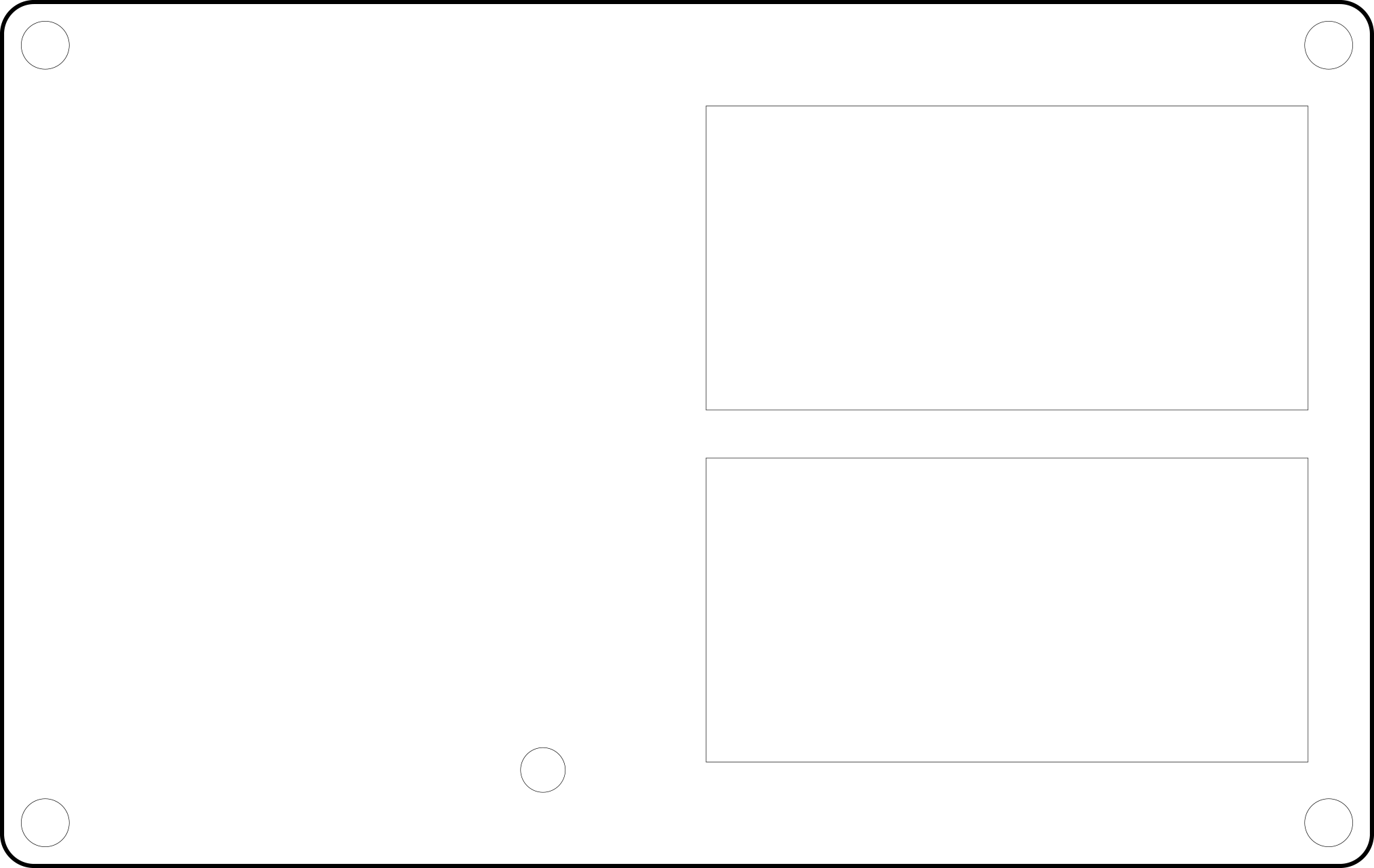

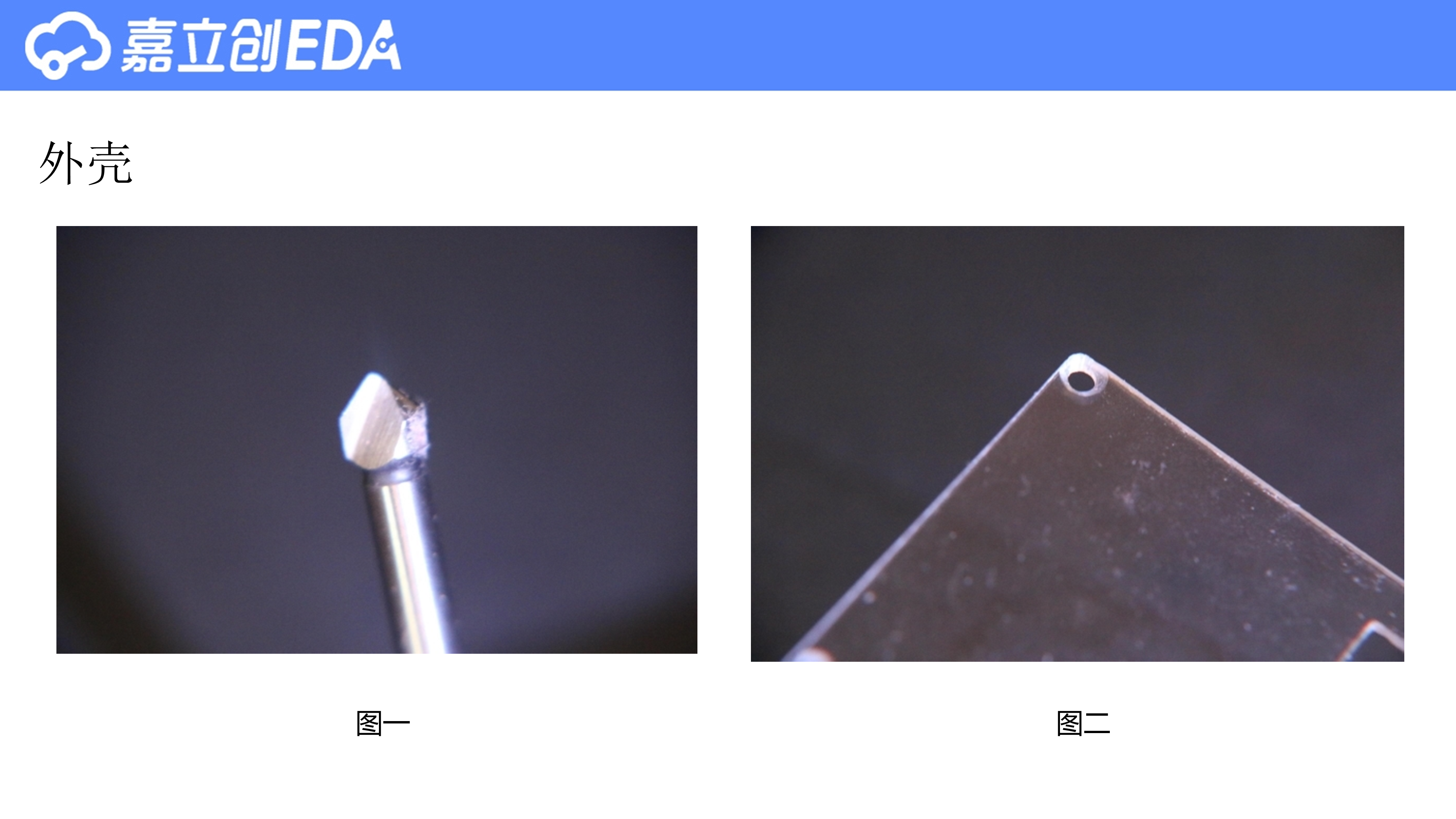

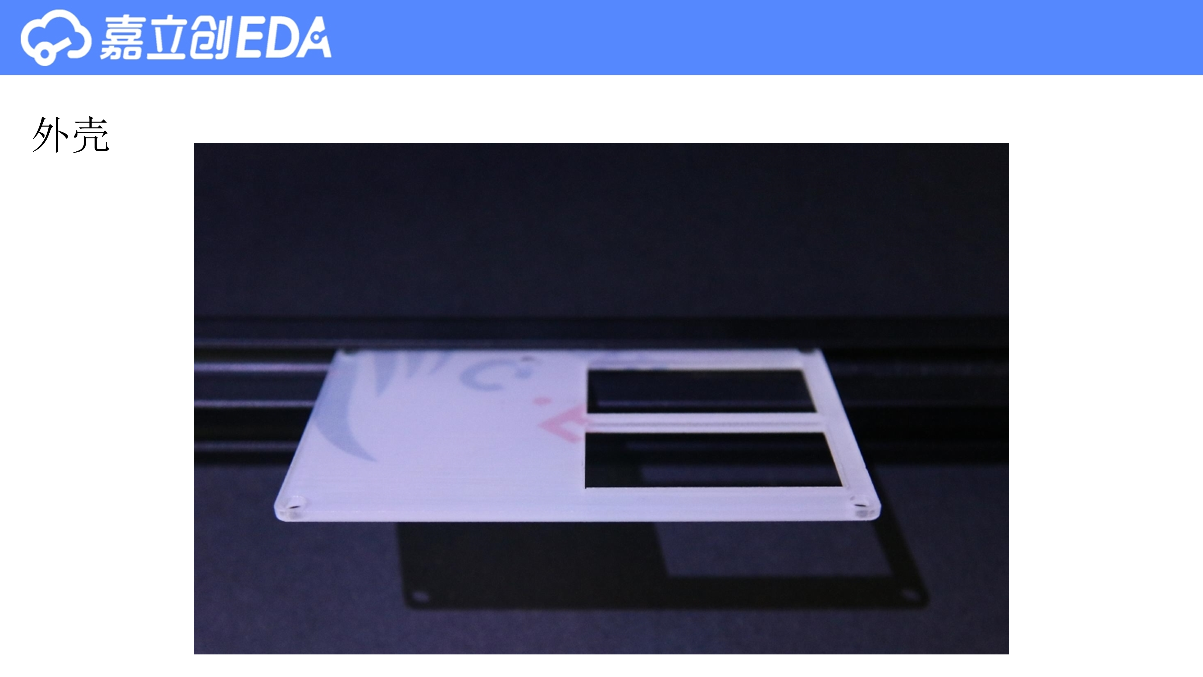

3.3 Outer
shell The outer shell is made of 2MM acrylic.
Use a single-edged tapered drill bit (as shown in Figure 1) to drill four countersunk holes in the acrylic (as shown in Figure 2). Since I am using a hand drill, I used a single-edged one.
Assemble the M3-5mm countersunk screws and M3-6mm copper posts.
