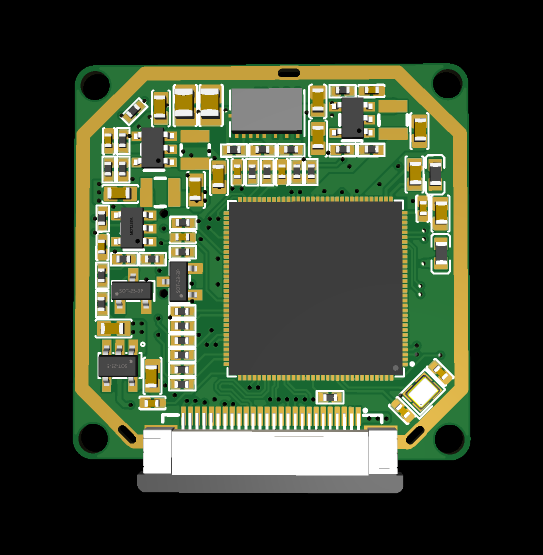

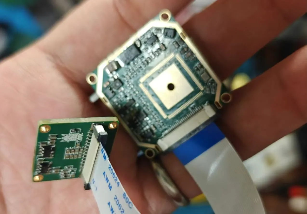

DigitalFPV_338+335 is based on the OpenIPC project.
===========20241028 Update============
One FB resistor in the 3515 in the IBOM file was incorrectly labeled; the output was previously 3V3, now it's changed to 5V0.
============20241017 Update===========
New Attachment: Gerber_Ultima_LAN_Board_2024-10-17.zip A small RJ45 network board to be used with the motherboard. Simply connect it to the motherboard's reserved interface using a 4-pin 1.25mm reverse cable
. The motherboard files have been updated to v.0.13.4. The circuitry for the reset button has been modified, and a silkscreen for the LAN interface has been added.
===========20241011 Update============
New Attachment: DigitalFPV_SSC338_0.13.3_2024-10-11.zip
The motherboard section has been updated with the CH340E power supply circuit.
Impedance Selection: JLC06161H-3313 (Free/Finished board thickness 1.60mm, emphasizing robustness)
This project is extremely difficult to solder; beginners are not recommended to replicate it.
DIY involves risk; please order with caution. The author is not responsible for any accidents or losses that may occur.

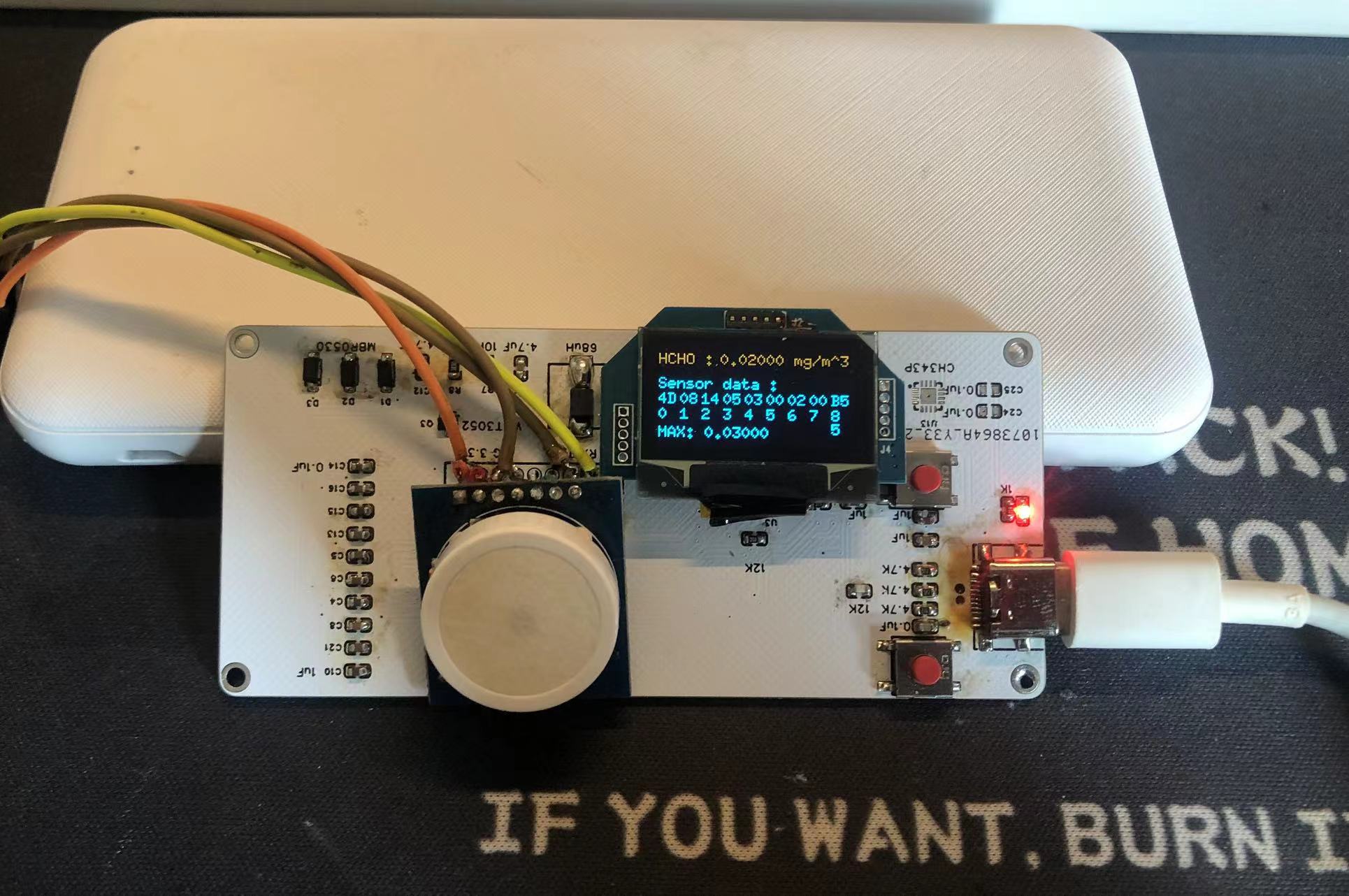

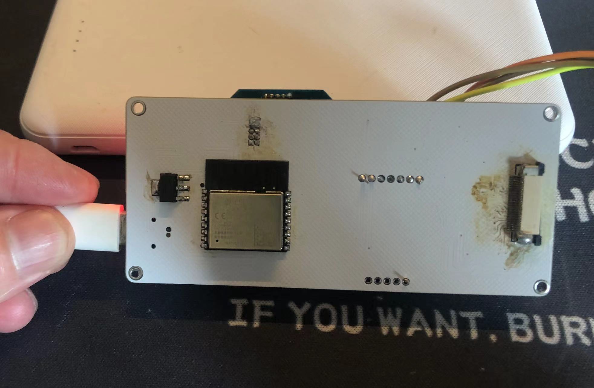

1. Overall Appearance:
From right to left on the front, the components are: USB-Type-C port, download/reset button, OLED display, and HCHO sensor.

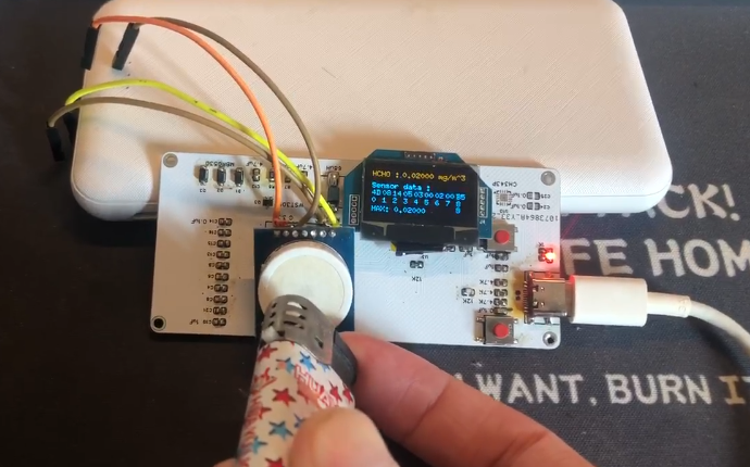

2. Function Introduction
: The device starts working immediately upon plugging in the USB-Type-C port and powering on. The OLED display shows the formaldehyde content value output by the HCHO sensor on the first line. The second, third, and fourth lines show the serial data received by the processor, allowing for easy monitoring of serial communication with the HCHO sensor.
The fifth line displays the maximum measured formaldehyde content value. The reset button clears this information.

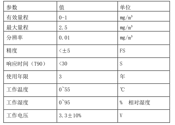

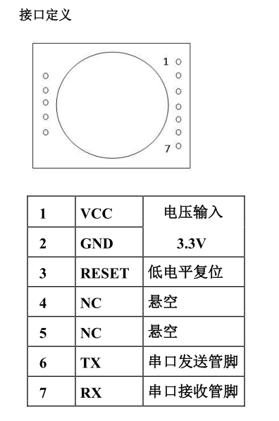

3. Hardware Introduction
: HCHO Sensor: The DS-HCHO is a highly integrated, high-precision, and highly stable digital output formaldehyde sensor. It uses an electrochemical method to detect formaldehyde content in real time under various application scenarios. It features accurate measurement, small size, and ease of use, making it suitable for both home and industrial applications. It can also be applied to various media such as automobiles, air conditioners, and televisions.
2.1 Processor
: The processor used is the ESP32-C3, which is compact, powerful, and has WiFi RF capabilities, offering various programming methods.

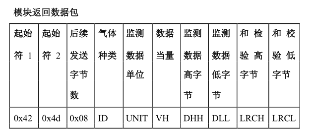

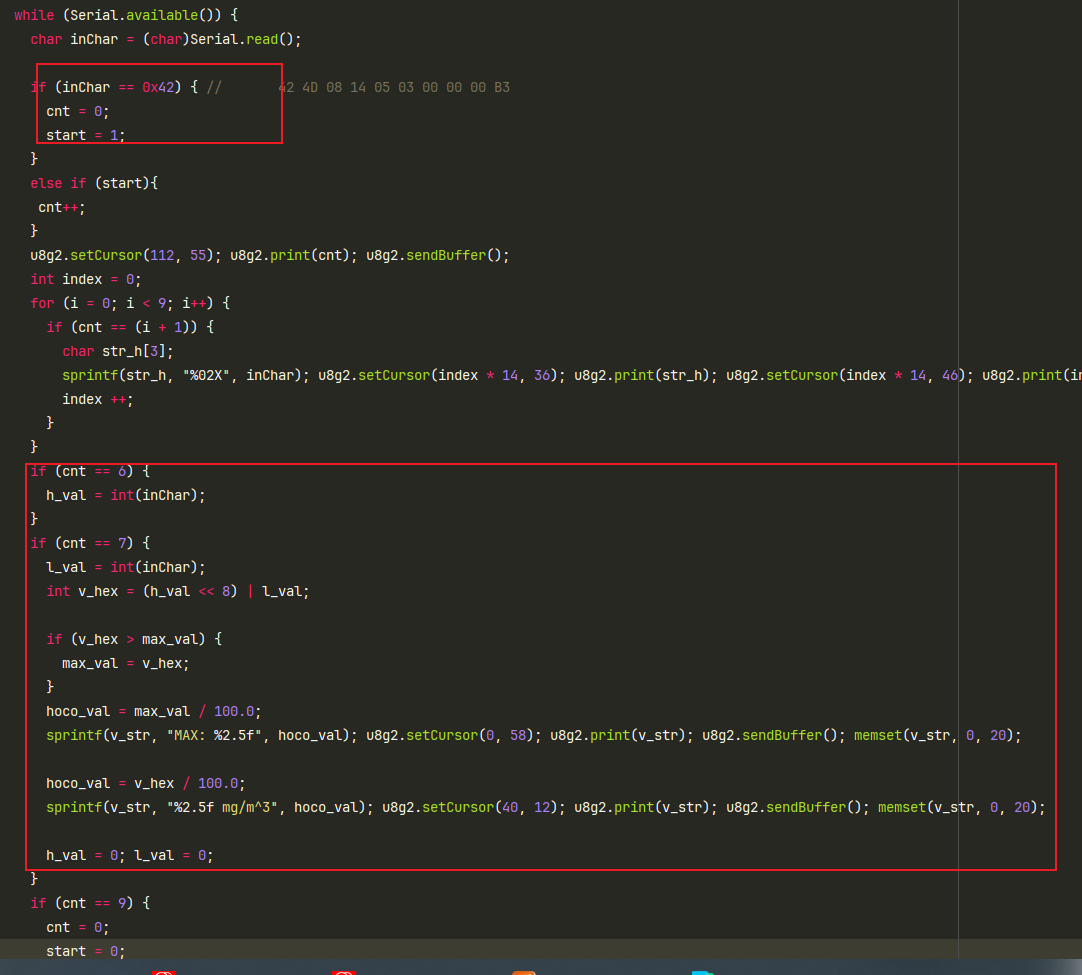

3. Software Design:

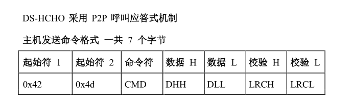

The ESP32 send query command code
module returns a total of 10 bytes, defined as shown in the diagram above. ESP32 receiver program:
Formaldehyde calculation formula:
4. Effect Test:
During the test, a lighter is used to spray gas at the sensor, and the numerical changes can be observed. The maximum value is recorded on the screen.
The video is attached .
