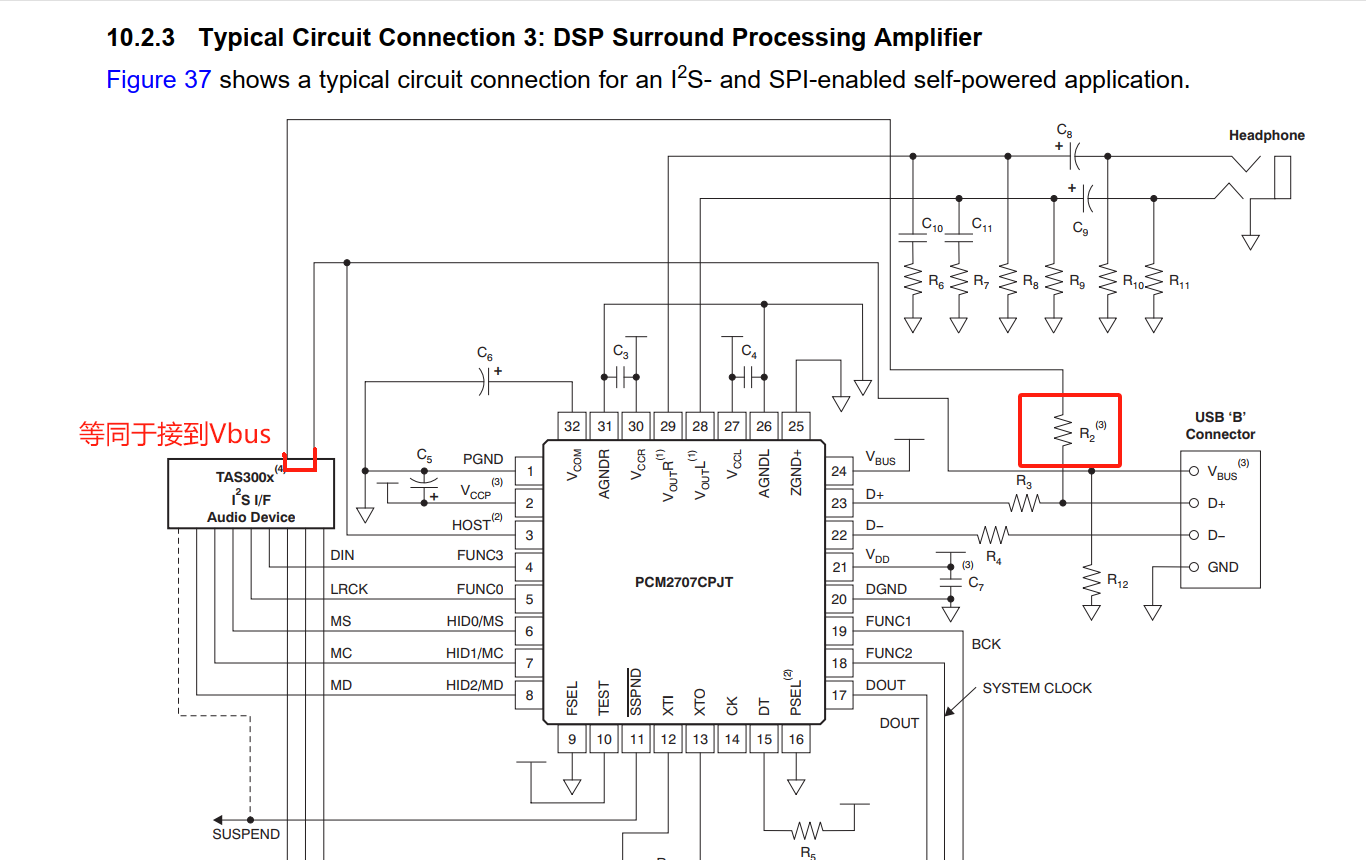

The 1.5K resistor here must be pulled up to VBUS; otherwise, the PCM2706 will not work (pay close attention to the schematic).

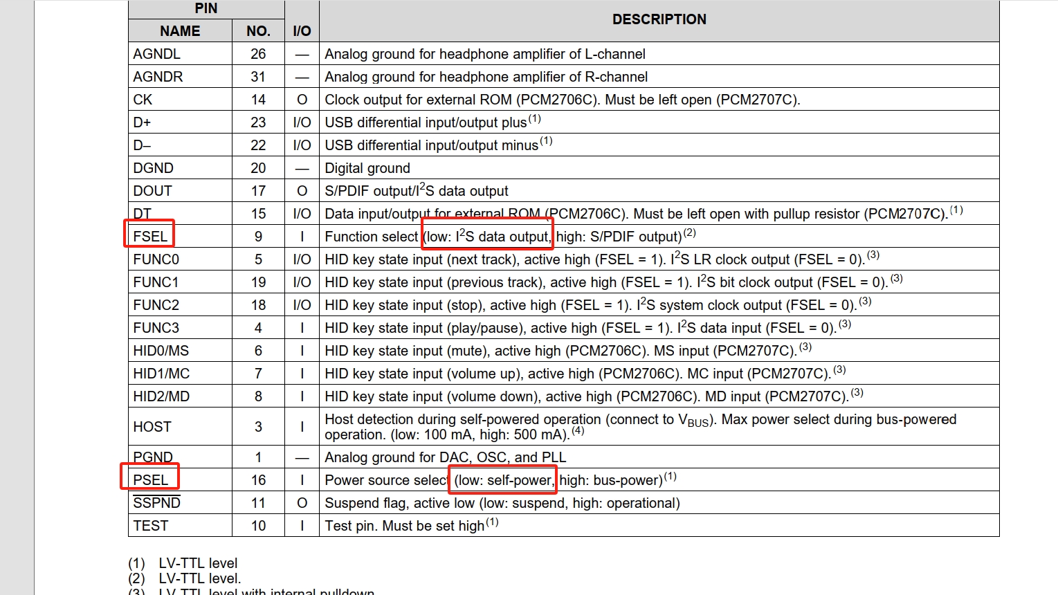

FSEL and PSEL should be pulled low. Pulling FSEL low controls the output I2S signal; pulling PSEL low uses self-power mode.

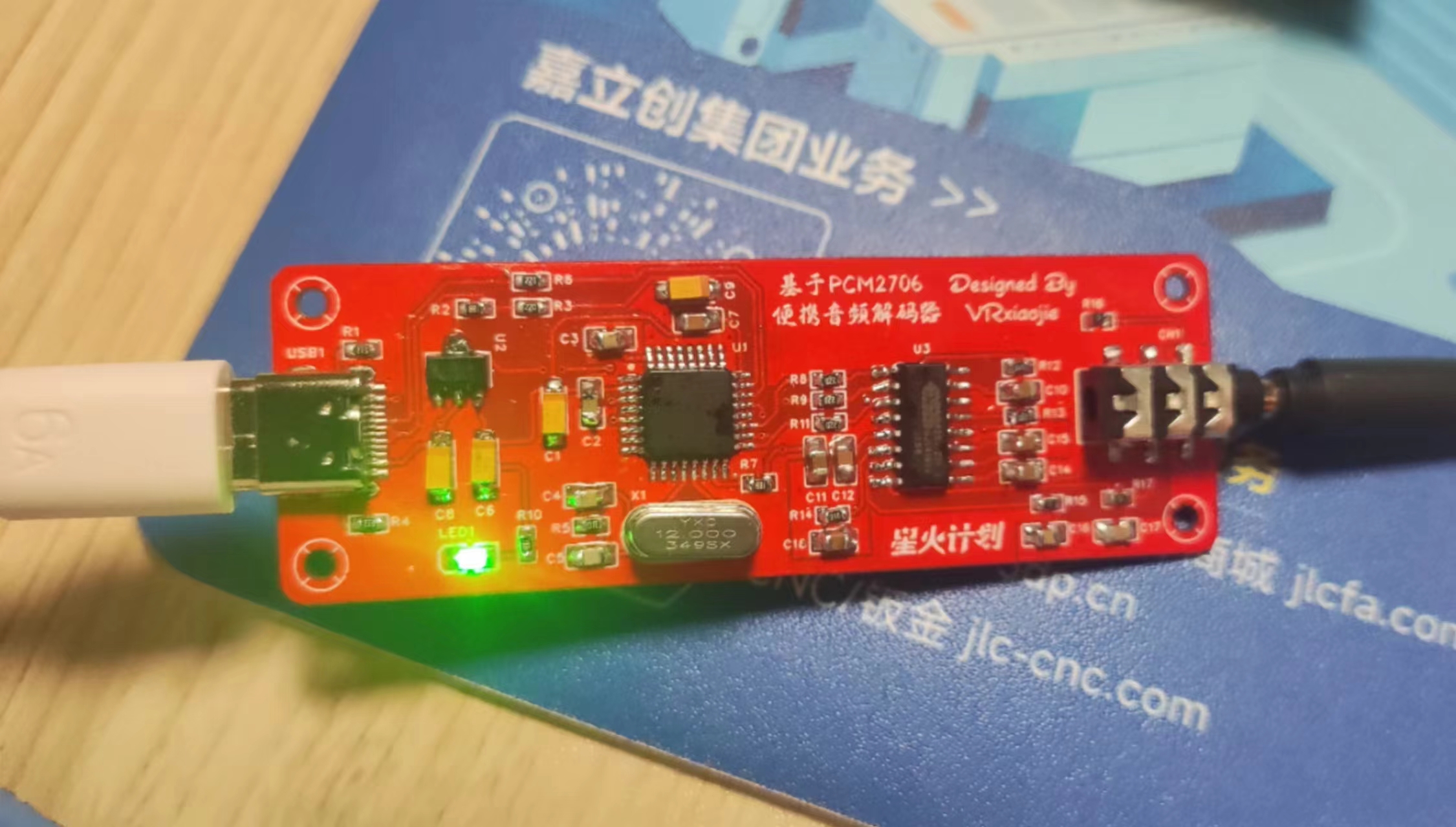

Bare Board Appearance:

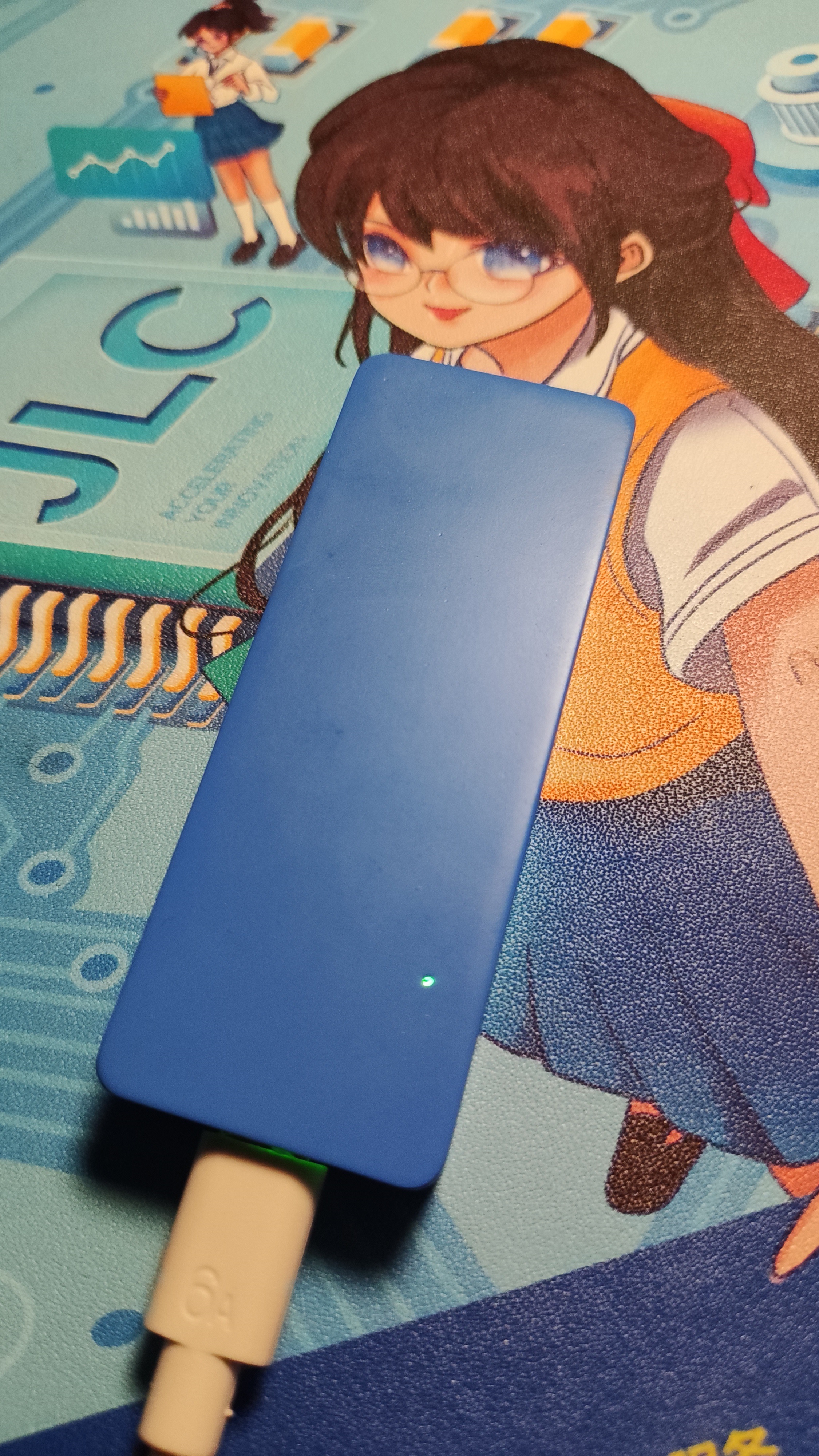

Add a 3D printed shell;
