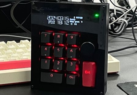

I'm using a leftover ESP32-WROOM-32D from a previous project to make a simple Bluetooth keyboard.
Only a little hands-on skill is required :)

The left side of the screen displays the year, month, day, and time. The upper right corner displays Wi-Fi, Bluetooth, battery/charging indicator, below which are the weather, weather symbols, and temperature. The life tips are scrolling and can be swapped with the temperature symbols below.

[Assembly and Network Configuration]
First, solder the PCBA (RGB chips, switches)
. Assemble the switches, positioning plate, and PCBA. Be especially careful not to break the satellite stabilizers, as acrylic is brittle. Small local breaks are okay.
Arrange the acrylic layers roughly in the following order: top layer, bottom layer, frame * n, positioning plate, frame * n, bottom plate; insert the baffle between the bottom plate and bottom layer. Trim the screen pin length and adjust the number of layers used. Plug in the screen, keeping it as close as possible to the top and bottom layers. Secure the end furthest from the screen socket with foam.
Tighten the four 2mm Allen screws.
Power on; the first time connecting to the network requires downloading the Esptouch app on your phone and connecting to the same Wi-Fi network for pairing. Subsequent power-ups will automatically connect.

Low power consumption is not implemented. A 1000mAh battery with Wi-Fi and Bluetooth fully enabled only lasts about five to six hours. It's mainly used as a clock via USB.
Changing the city string in the weather API settings to "ip" will automatically connect to the current city.
String url_weather = "https://api.seniverse.com/v3/weather/now.json"; String url_life = "https://api.seniverse.com/v3/life/suggestion.json";
String city = "Jiangsu Suzhou"; //This could be changed to "ip" to automatically obtain the current city . The
knob may cause errors when turned up and down quickly; this could be optimized.
Modify the buttons to an array, allowing for combination. Then, add a menu in the code, allowing adjustment of RGB colors, displayed content, etc.
The USB port is at the top, causing light to leak onto the screen. The PCBA and frame could be modified to allow the USB port and switch to come out from the side.
