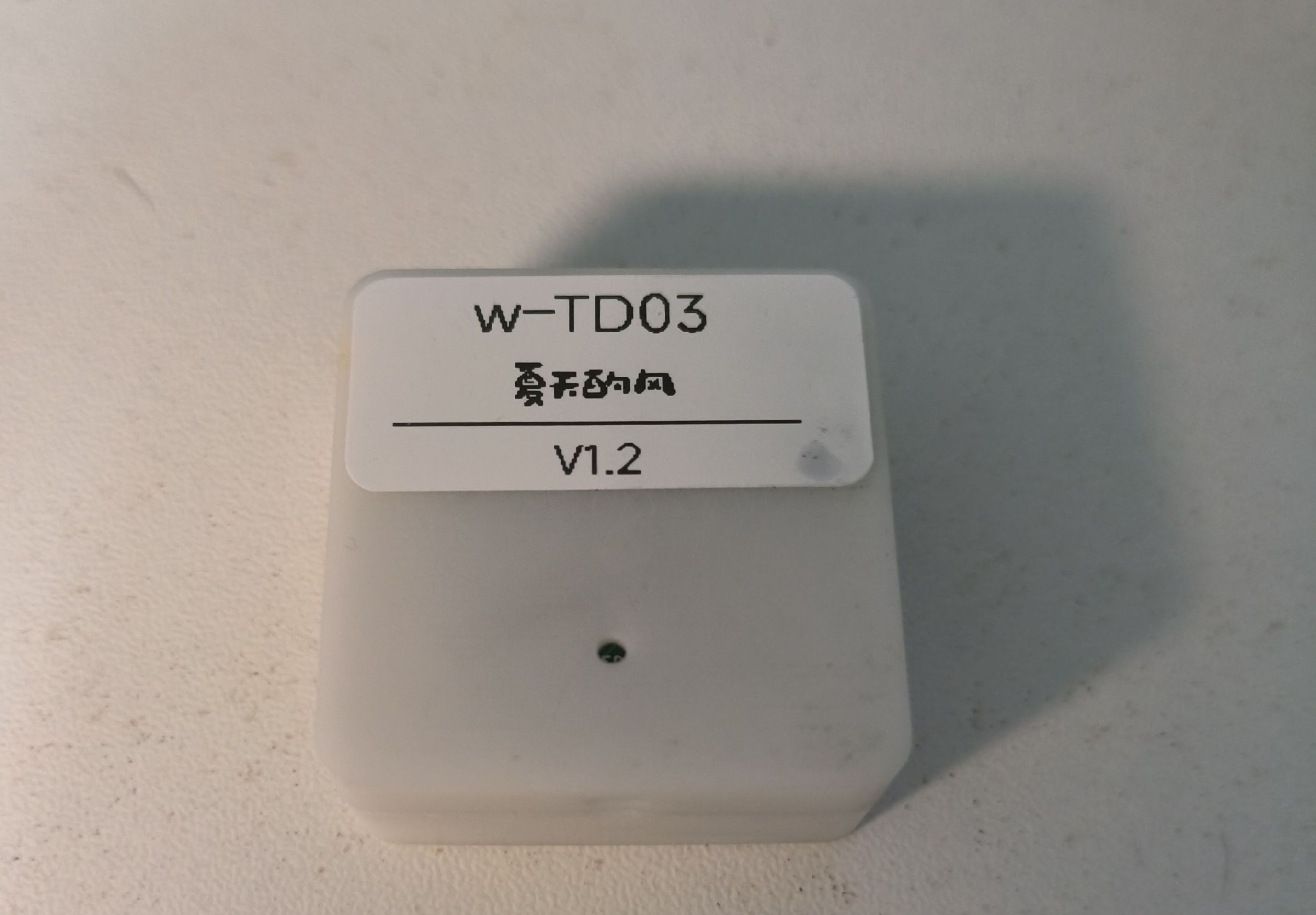

actual product images
. Don't say I didn't test them; the three boards in the images are all different. PCB

Version V1.2 User Manual:
Supports temperature, humidity, and door magnetic functions.
For first-time use, press and hold the button until the indicator light illuminates, then release. The device will automatically search for networks; remember to enable Z2M beforehand to allow network access. If the device fails to join the network, press and hold the button again.
Once the device successfully joins the network, a single button click will report the latest temperature and humidity data, which can be used to test network access.
Users can modify the temperature and humidity reporting interval.
Users can choose to enable reporting only when temperature and humidity exceed a threshold, and can also set the temperature and humidity threshold range.
The device supports automatic network recovery after gateway power failure (in my tests, the gateway was powered off for up to 3 days, and the device automatically resumed data reporting within one day).
This version only supports four Zigbee channels: 11, 15, 20, and 25; other channels are not enabled.
It only supports the SHT3x series sensors; compatibility with others has not yet been implemented.
