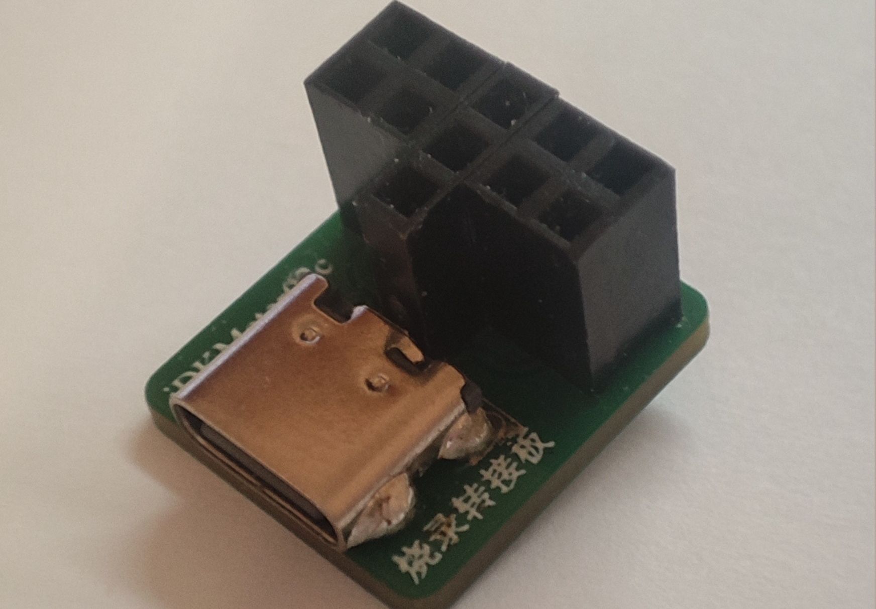

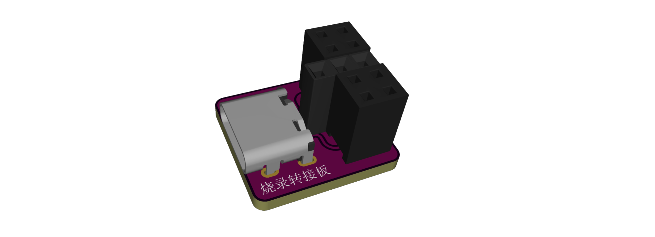

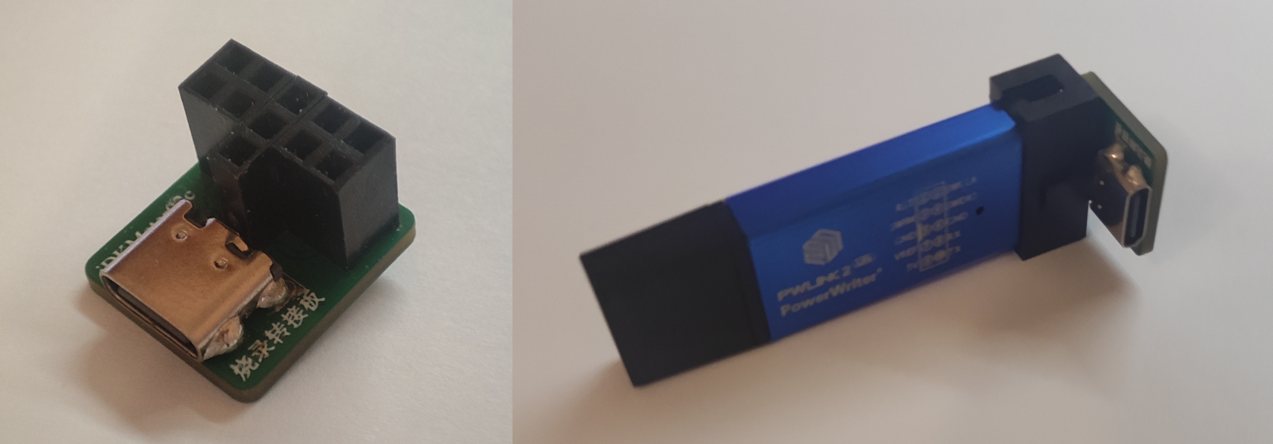

PWLINK programming adapter board
I. Introduction
* This design utilizes SBU1 and SBU2 of a Type-C interface, which are multiplexed as SWCLK and SWDIO download interfaces respectively, such as in the iDKMeter02C
. * The middle GND has three rows of anti-reverse connectors; either 2 (2x2) + 1 (1x3) or 1 (1x5) + 3 (1x2) female connectors are acceptable
. * The male connector of the clamp has a correct orientation when inserted; only one side can be programmed
. * Due to its small size, it is somewhat awkward to use; I will modify it when I have time.
